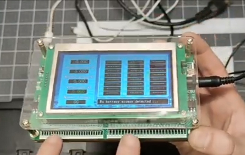

Yes, that is the video. The person at Indy RC was able to find a contection for a 13S, for the battery charger. I don't have the instrument to read the individual cells, the balance charger, nor the connector. I am looking at roughly about 1/2 for the cost of the battery to purchase those items. I need to locate the individual instruments, possibly rent them locally.
Tomorrow I plan to reach out to another ebike rental company as well. BTW the recharging of the bike light brought the power capacity down 1 volt. I won't leave items plugged into the battery while we sleep.
I don't have the instrument to read the individual cells,..
Do you happen to know what this instrument is and where I can find it?
I want one. 😂
I don't really need it, but I think that it's fricken Cool 😎. 😂
