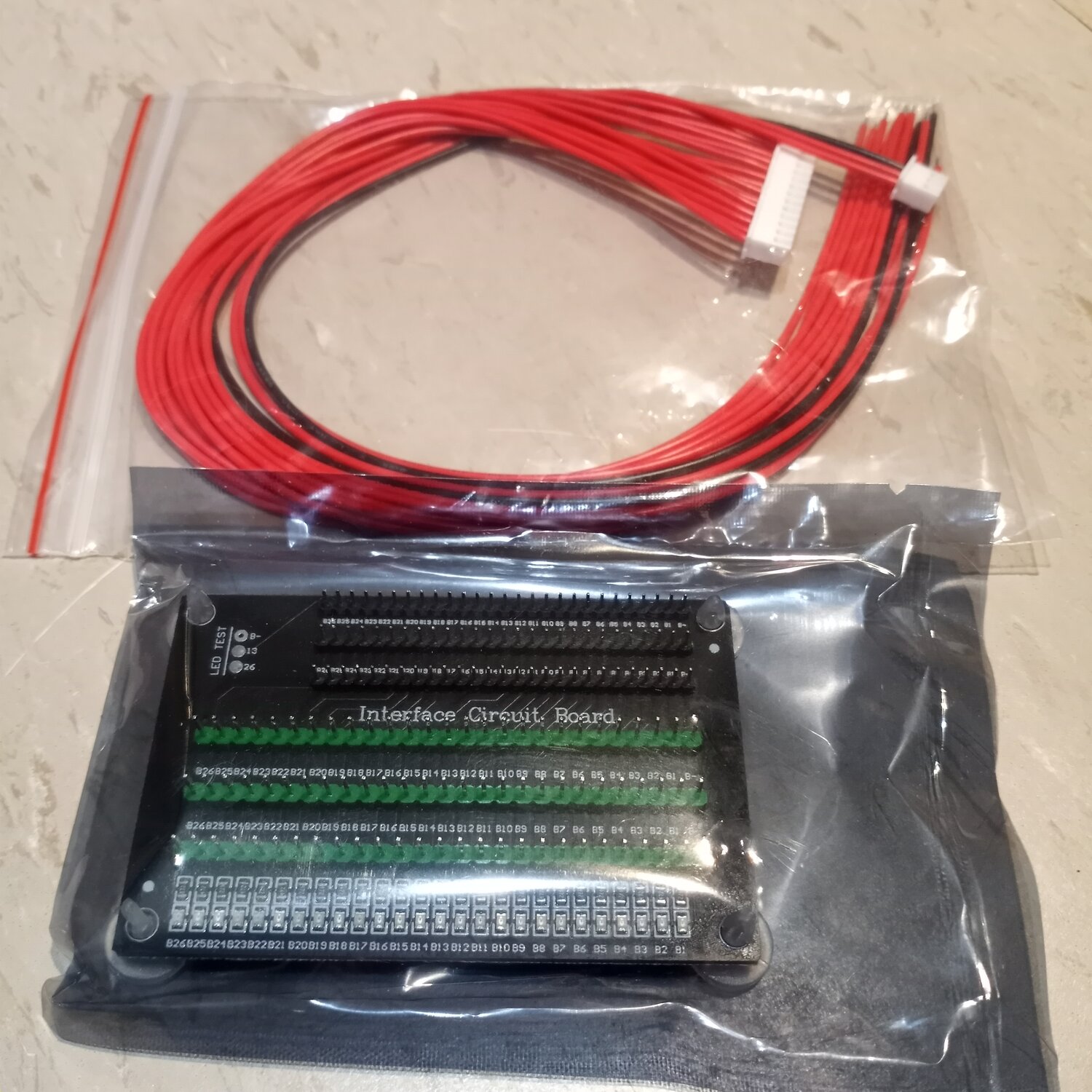

My new BMS testing equipment arrived.
I hope my battery goes out of balance.
Then I'll have a chance to use it.
I don't want to tear into my healthy battery just to try it out. 😂
You must be a good person, because Santa brought you a great gift. 😂
