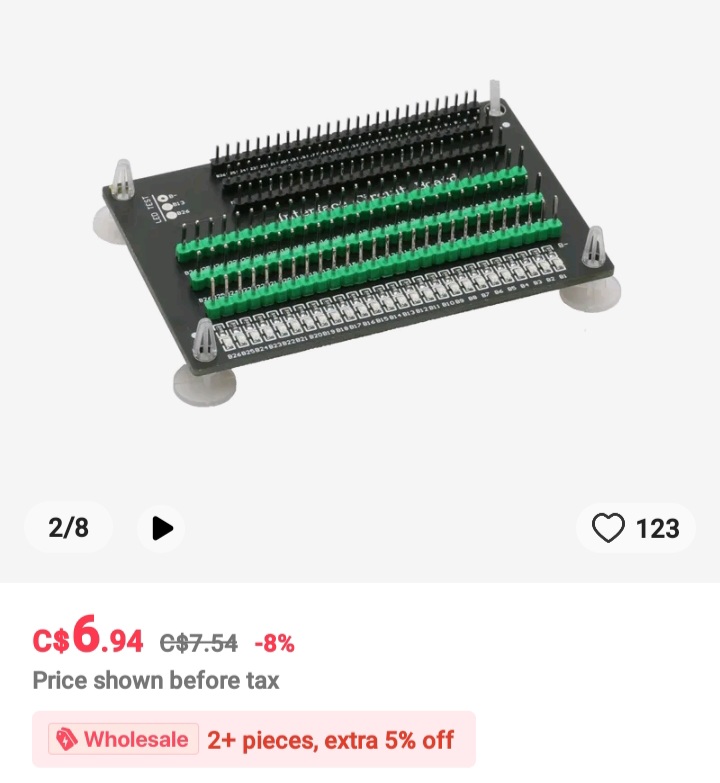

I don't have the instrument to read the individual cells, the balance charger, nor the connector. I am looking at roughly about 1/2 for the cost of the battery to purchase those items. I need to locate the individual instruments, possibly rent them locally.

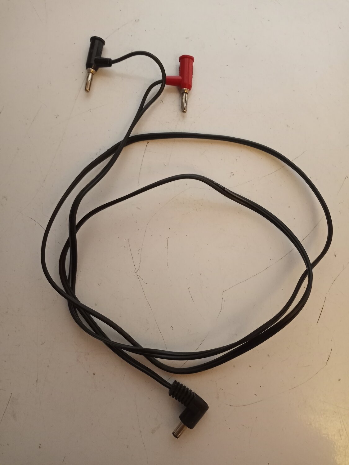

I had to make a simple cord to plug my battery into my power supply.

Keep in mind that all you need is this,..
And this,..
And and a 2 pin connector like this,..
Then you can balance your battery yourself.
