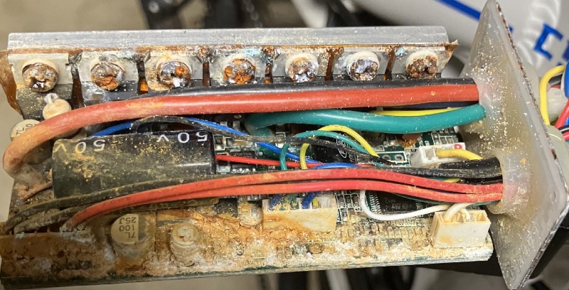

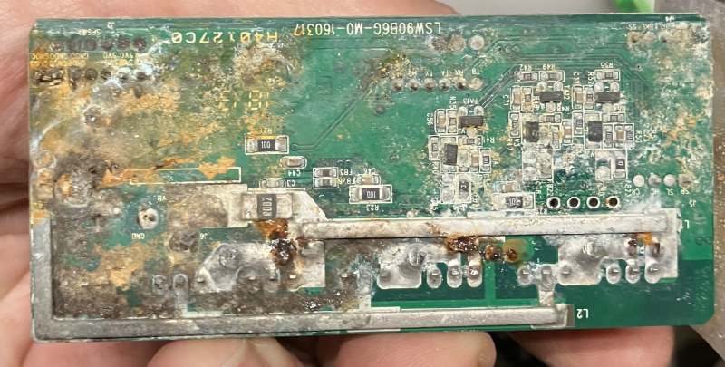

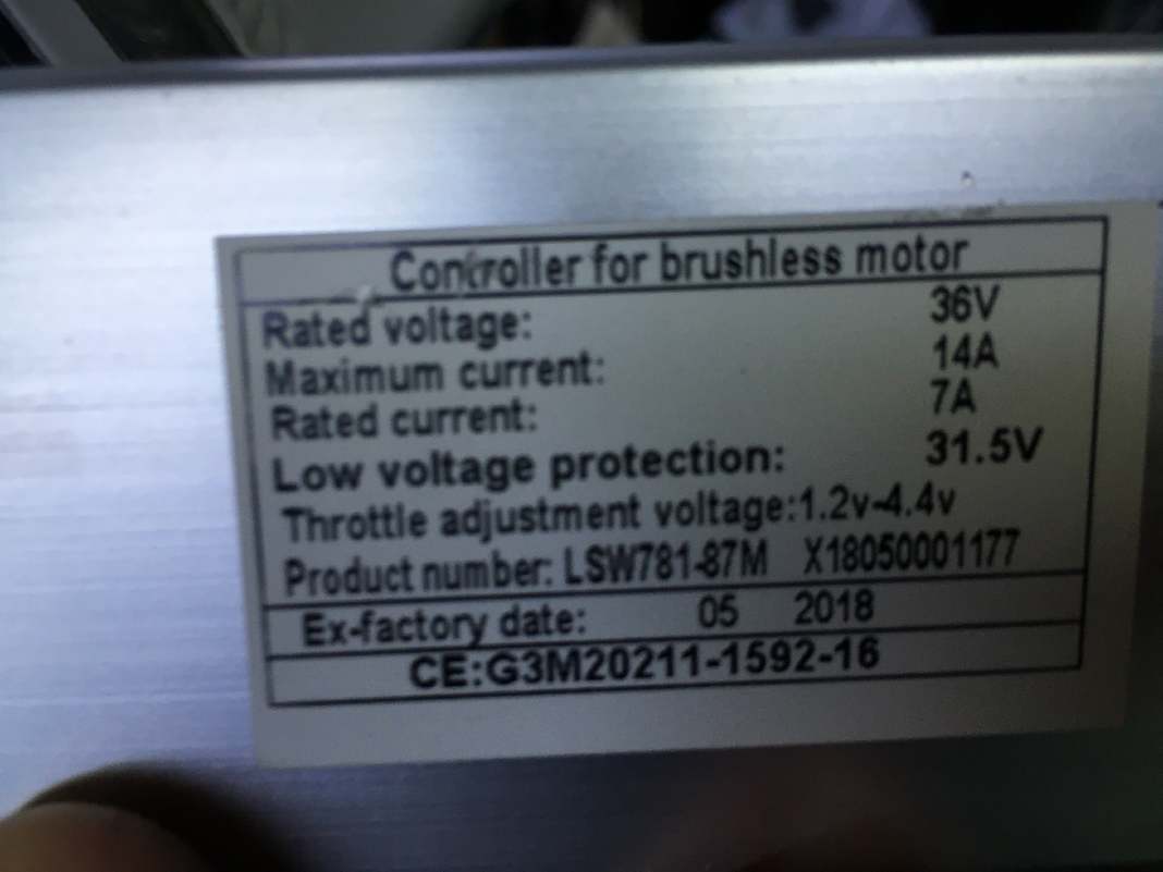

That controller has a bad case of moisture damage. Probable an internal short on a board surface. Replace it.
You should match the intended voltage and approximate the current rating. As 36 v 14 A. Slightly larger current is okay, but I would not go over 22 A. Many replacement controllers are 36/48 v. The processor senses the start voltage at power up. I buy controllers on ebay.

I think that debris is from the inside of the large black electrolytic cap. One of it's leads is completely gone leading me to believe there was a lot of current flow at some time.;)
