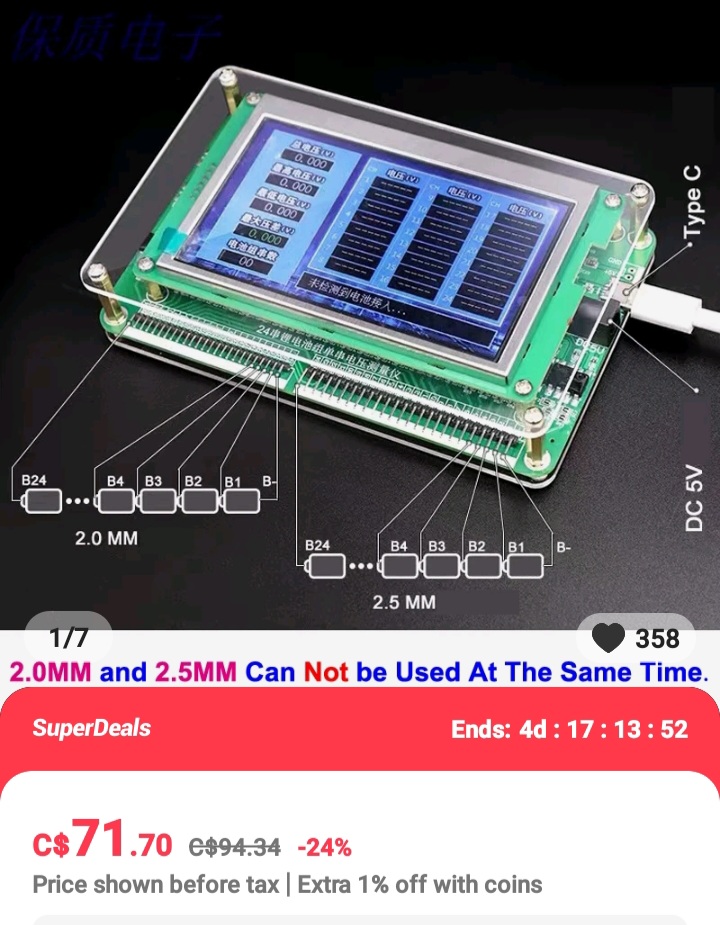

Thanks.
I tried searching for it, but I didn't know what to call it.
It's kind of expensive though, and I don't really need it.

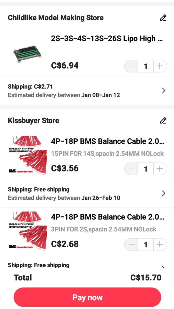

I think that if it comes to it, I'll just charge up the individual cell groups directly at the BMS connector.
I would only need my voltmeter and my bench power supply.

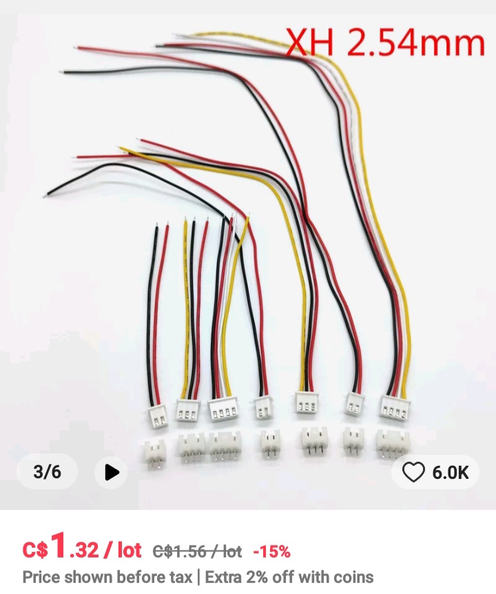

I might get this pinout board to plug my BMS cable into, and a 2 pin connector to feed in voltage from my bench power supply.
That would make checking and charging all the cell groups easier and safer.

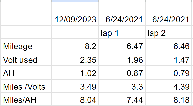

I was able to get a 8 mile bike ride in bebore it started to rain. The bike felt easier to pedal at power level one, than the last time I rode the bike at level 1. Below is today's data and 6/23/2021. Both sets of data are from the watts meter.
1st Stop 2nd Stop
Date. 12/09/2023 06/24/2021 06/24/2021
Miles travelled. 8.2 6.46 6.47
Volts Used 2.35 1.96 1.47
Amphours 1.02 0.87 0.79
Miles/Amphour 8.01 7.44 8.19
Mile/Volts. 3.49 3.30 4.40
My thoughts: The 2023 are comparible with 2021 data. The 2021 route was most likely in the eastern section of Eagle Creek Park, today route was through the local nieborhoods. ECP route is flatter and more protected from the wind.

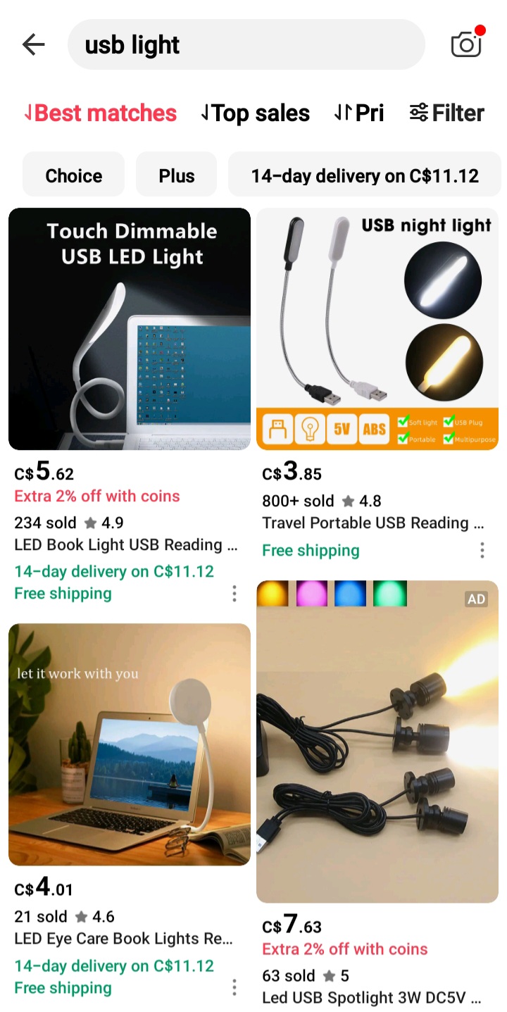

I was thinking a usb light like this.
Do you have a cell phone?
You could probably charge it with your bike battery.
