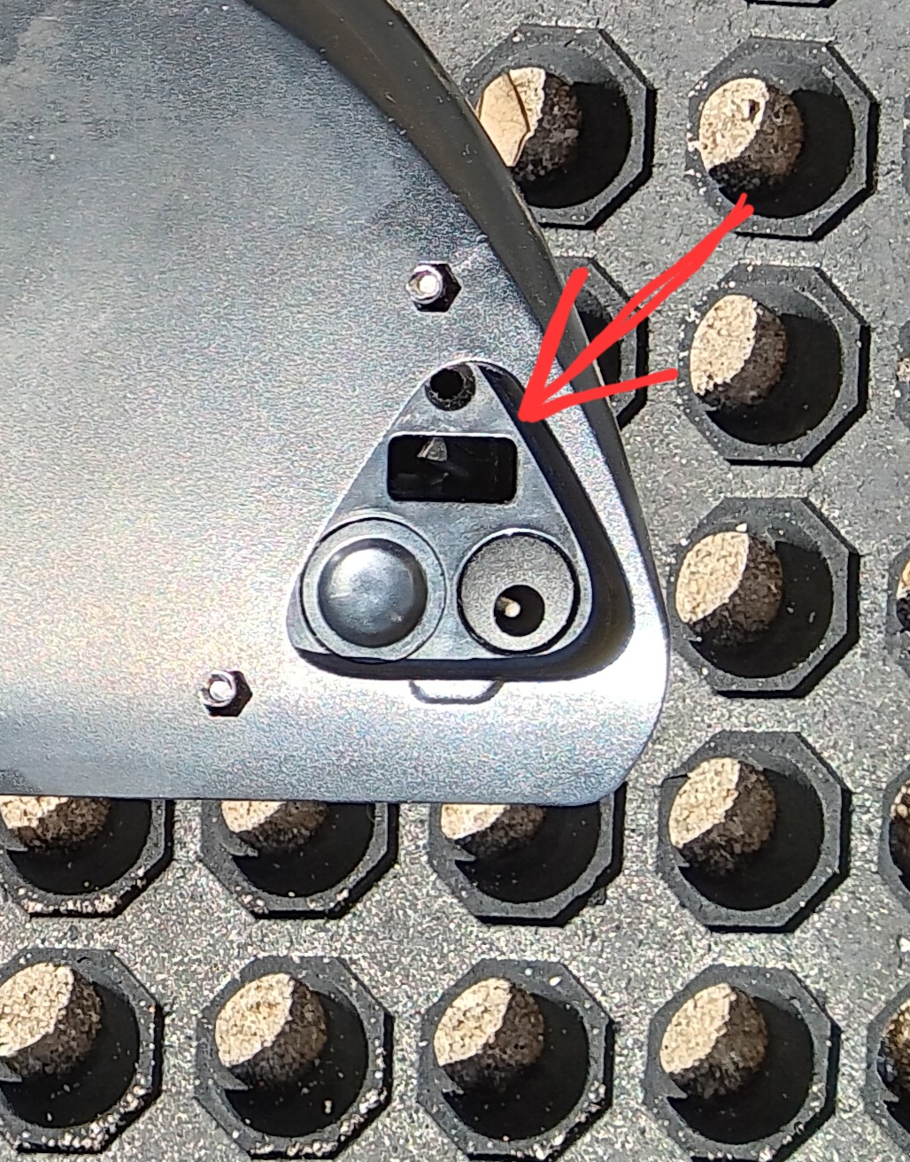

One last question for now concerning an Eahora x3. It is a 36 volt system with 36 volt 10.4 amp battery, without the charger. I borrowed one from a friend who also has a 36 volt, 10.5 amp battery so should be basically the same. The charger says it's output is 42 volts, 2 amps. While the charger is NOT plugged into the wall, when I plug it into the battery I get a a few Sparks at the connection initially (similar to what you would get discharging a capacitor by shorting it). Still not plugged into the wall the indicator on the charger shows a green light. When I do plug it into the wall the charger shows a red light and then when fully charged turns green (which is what I would expect). Under the same circumstances the other person's bike whom I borrowed the charger from shows no light when the battery is plugged in as long as it's not plugged into the wall and also does not spark at all when plugging into the battery itself. I have included a photo that shows a hole on my battery pack where there might have been an on-off switch in the past. If anybody is familiar with this model bike or if this battery looks familiar and you can verify what is supposed to be in that area please let me know. Also any ideas about the sparking right when plugging in or the indications before even being plugged into the wall. Thanks

This is new to me. With the charger off, I guess it sparked because of a capacitor in the charger. Apparently, antispark connectors have a resistor path make contact before the zero-ohm path.
,.. While the charger is NOT plugged into the wall, when I plug it into the battery I get a a few Sparks at the connection initially (similar to what you would get discharging a capacitor by shorting it).
,.. Also any ideas about the sparking right when plugging in
I've got three interchangeable batteries, and four chargers.
On one battery, if I connect the battery to any charger without plugging in the charger first, I get One HELL Of a spark. 🌩
The spark actually melted and vaporized some metal on the battery's charge port. 😂
I started plugging the chargers in first for all my batteries and that stopped the sparking.
(even though the instructions for my first battery and charger said to plug the battery in first.)
My 48V 4A charger was the worst with it's Huge capacitors.
The BMS allowed current to travel backwards from the battery, through the charge port to charge the empty capacitors in the charger. In about half a microsecond.
I was doing a bit of arc welding. 😂

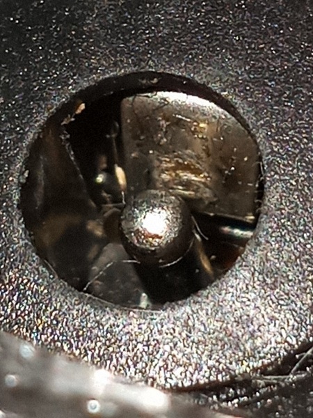

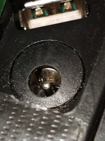

Doing it bas-ackwards worked. No more Spark. Doesn't leave me that warm fuzzy feeling, but if it works .... As others implied, when building a bike on the cheap you don't waste money on silly things like resistors and diodes!😆 Thanks for the education, all.

Sparking at both the AC and DC connectors is quite common with these chargers and will vary with different battery/charger combinations. It can cause damage to the DC connector over time though. A couple of my chargers spark and to eliminate possible DC connector damage, I usually plug in the DC side first. This moves the arcing to the AC plug, which is far easier and cheaper to replace if damage does occur.

The sparking and green light when unplugged suggest your Eahora X3 battery lacks a battery disconnect switch (that hole you see likely held one). Without it, the battery stays “live,” so when you plug in the charger, its internal capacitor discharges instantly—causing a spark and tricking the LED into lighting up.
Your friend’s bike probably still has the switch (or a BMS that cuts standby power), so no spark, no light when unplugged.
✅ Fix:
  • Don’t worry—the spark is normal if the battery is always live, but it can wear connectors over time.
  • Consider installing a battery on/off switch in that empty spot to match the original design.
  • As long as the charger turns red when plugged in and green when full, it’s working correctly.
