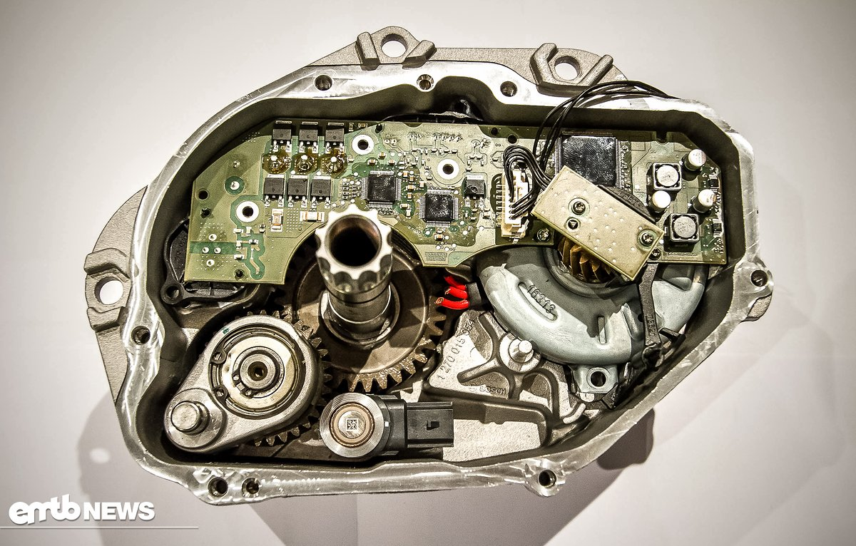

Here is the circuit board for Bosch:

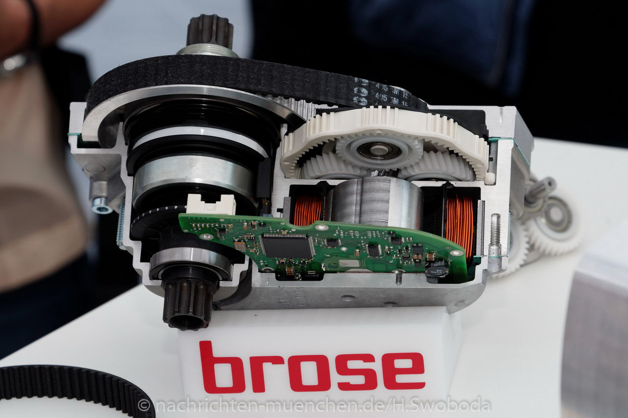

Here is the circuit board for Brose.
As you can see, the circuits boards are different for Bosch and Brose.
Very different sensors, circuitry even though both are similar spec E-bike motors.

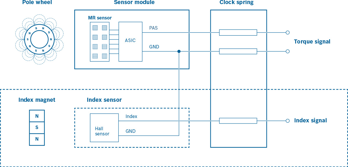

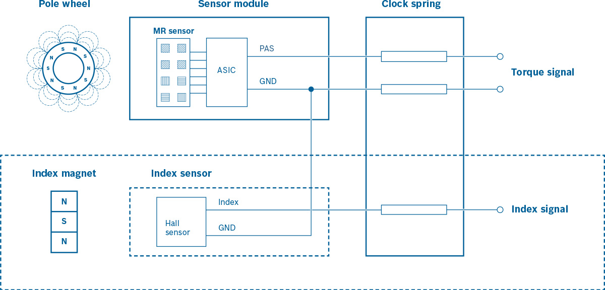

The following a diagram for a torque sensor used in Bosch steering systems for cars. I think they use a different system for E-bikes but what I was trying to convey is that, not every sensor is made equal.
