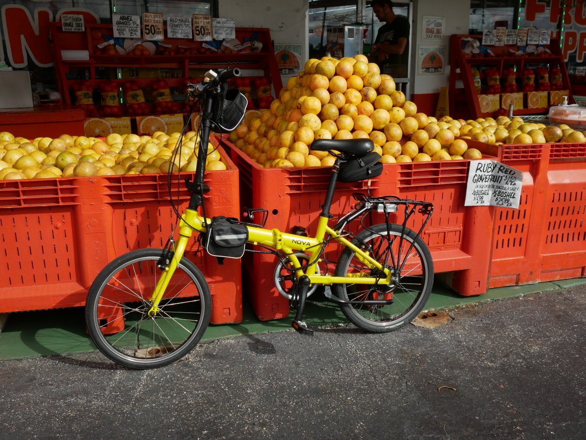

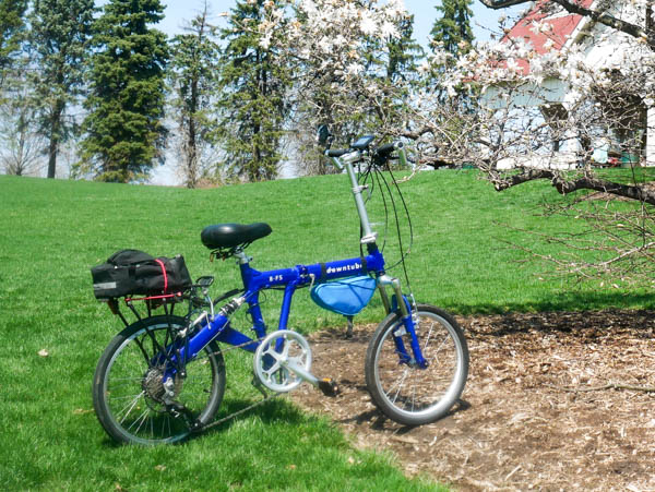

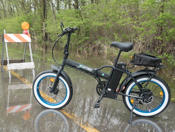

We like 20" bikes. We have two folders, a minivello style, and a 20" folder fatbike. All are electric although the first three were home DIY conversions. The fatbike is an Ecotric, similar to the Radmini and Lectic XP, but no suspension and 36V. The 20 x4.0" tires are about 3" taller than a 20 x2" tire, and with a longer frame the fatbike looks huge compared to a regular folder. THe ECotric is 60 pounds, while our other 20" bikes come in 33-40 pounds.
I don't ride on dirt, and knobby tires howl on pavement, so I put smooth tread 20 x3" tires on the fatbike. Lowers the bike a little, The tires roll better and it's less work with pedal assist. Your typical street folder (not talking about fat tire folders) are not suited for trail riding. All the shocks/bumps are not good for the frame and stem hinges. With 20 x 2.2" tires, they work well on packed gravel though,
A 26"/700ccc tire will have a more comfortable ride, but a full suspension folder like my wife's bike is pretty good. Me, I look ahead and stand up on my folder when I see bumps coming. The smaller bikes have a smaller turning circle and feel pretty maneuverable. Standard folders don't get ridden much past 18 mph because the gearing limits how fast you want to spin the pedals. A motor doesn't change that, so the upright position allows a more relaxed ride. There are times when I prefer the smaller folders and times when I take my 26" bike. The 20" bikes are what we take when we travel though, as they pack better either inside a minivan or on a platform rack.
I bought the Ecotric on Amazon for $769, and think it's a well made ebike. Had some rattles to cure. I upgraded the front suspension. In the picture below, it seems small, but it's around 4-6" longer than the other two.
