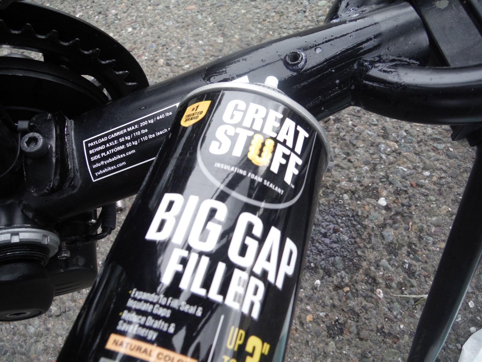

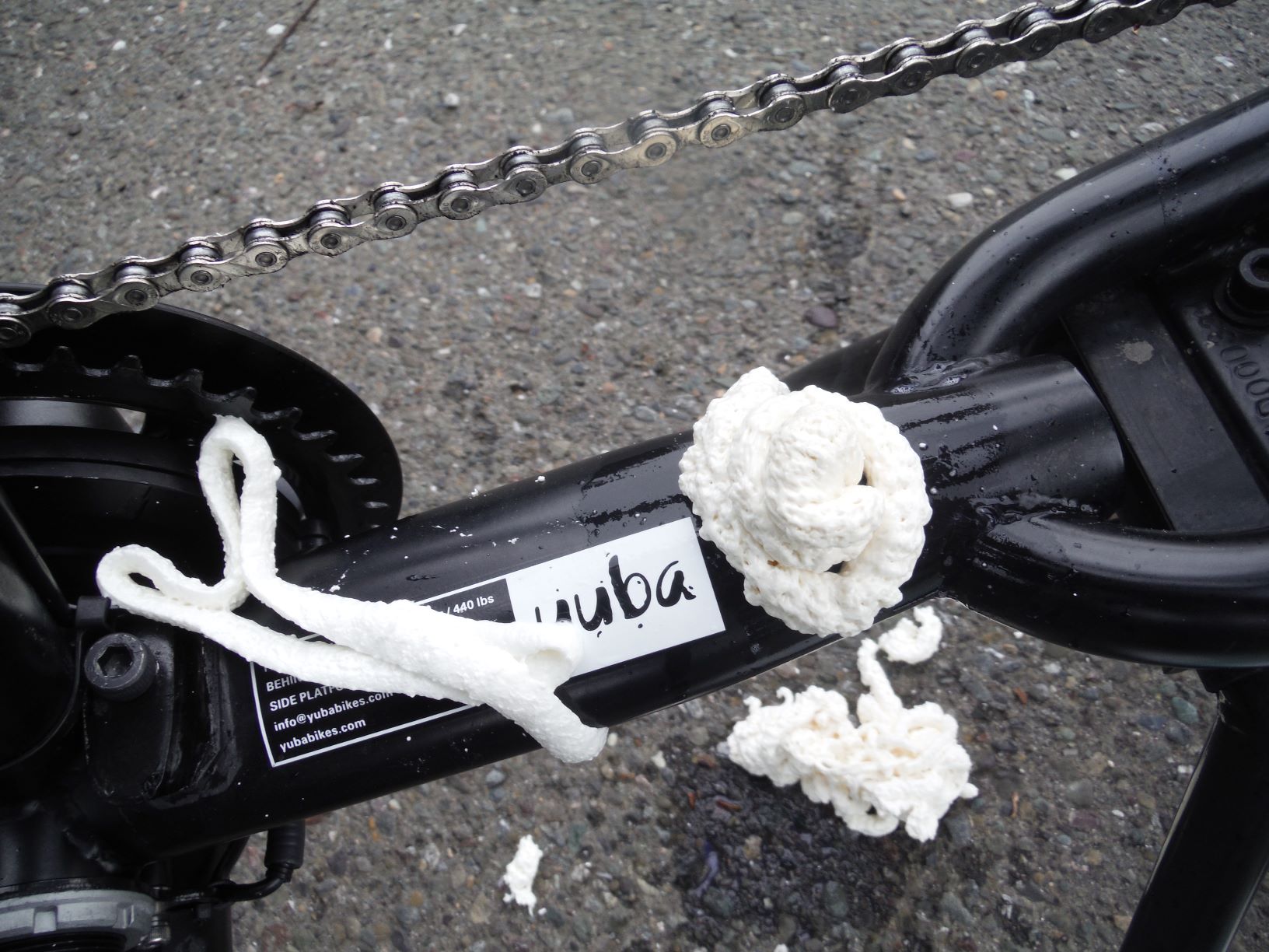

That was the first time I used Great Stuff to quiet a bike. I had on a brand new black cashmere sweater. I wreaked it. Great Stuff expanded out nearly invisible vent ports at the back of the bike and onto the rotor and chain. But it worked. The next time I did the prep and had on junky work cloths.

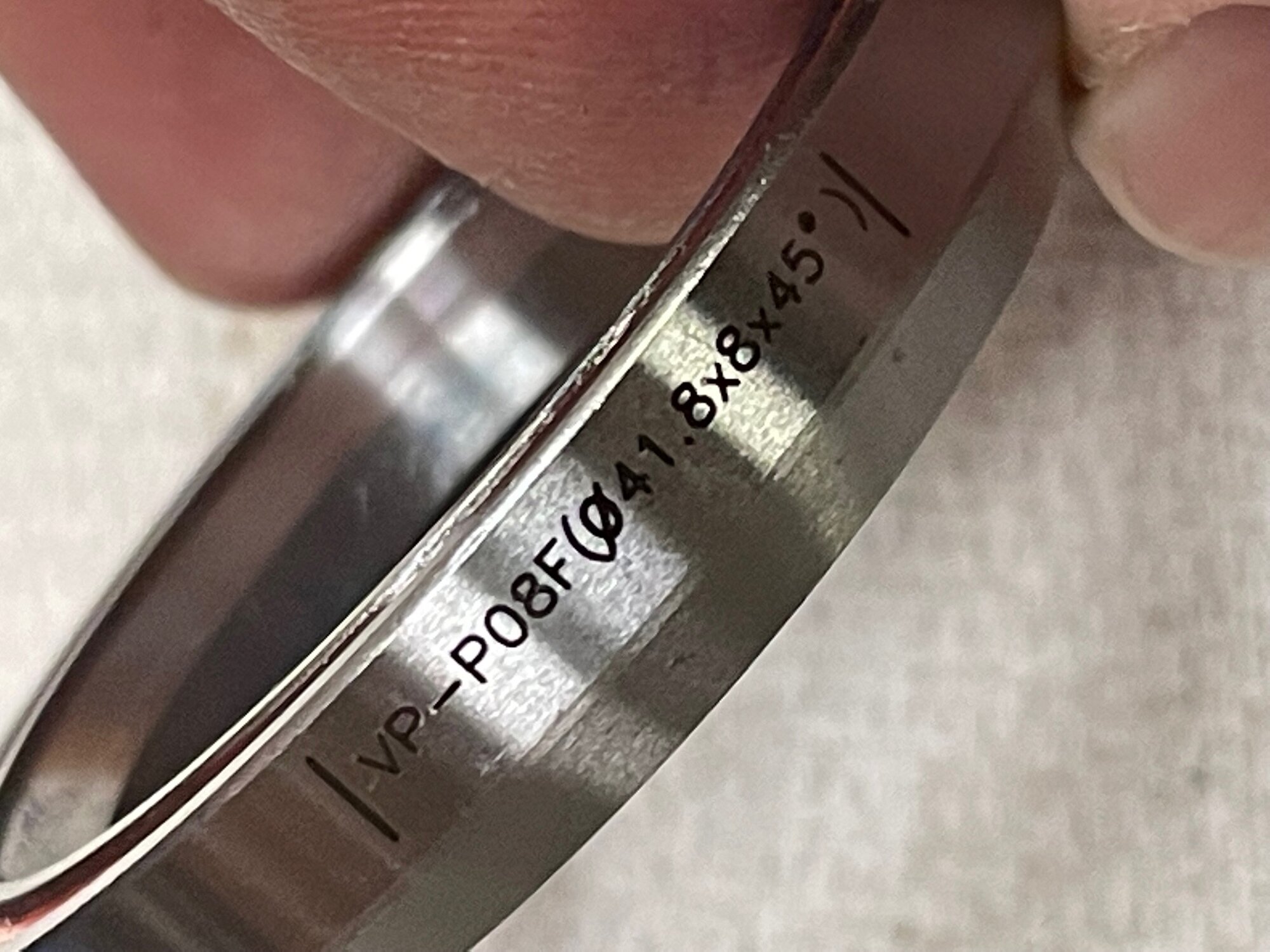

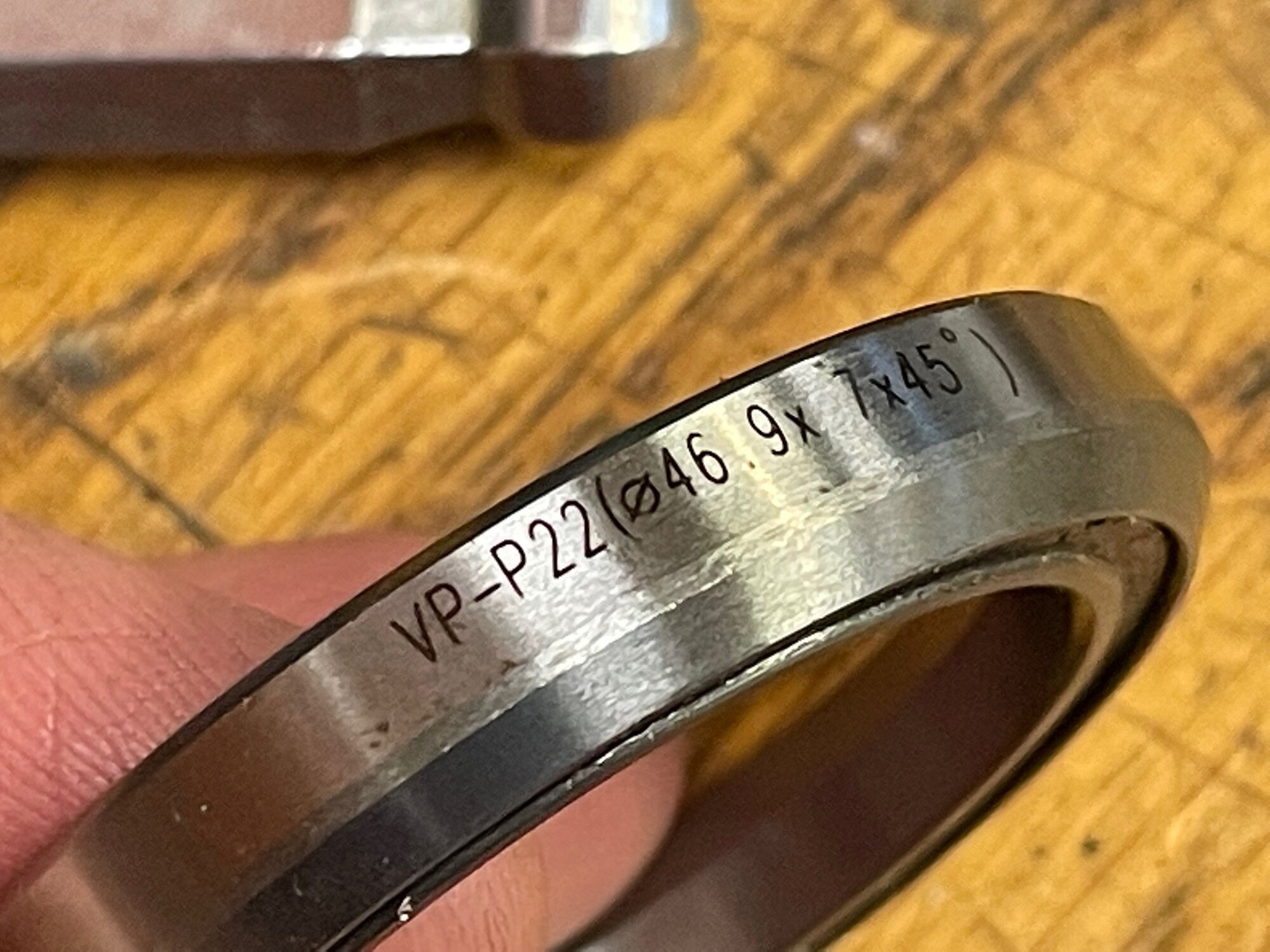

FYI: Headset bearing Civante:
Upper bearing VP-P08F (41.8x8x45)
Lower bearing VP-P22 (46.9x7x45)
No they didnt use common 1.125 to 1.50 tapered steerer. They used 1.125 to 1.25 --- so it is hard to find local fork to fit. Both the bearings and the fork are hard to find. If anyone has suggestion for fork- please post.

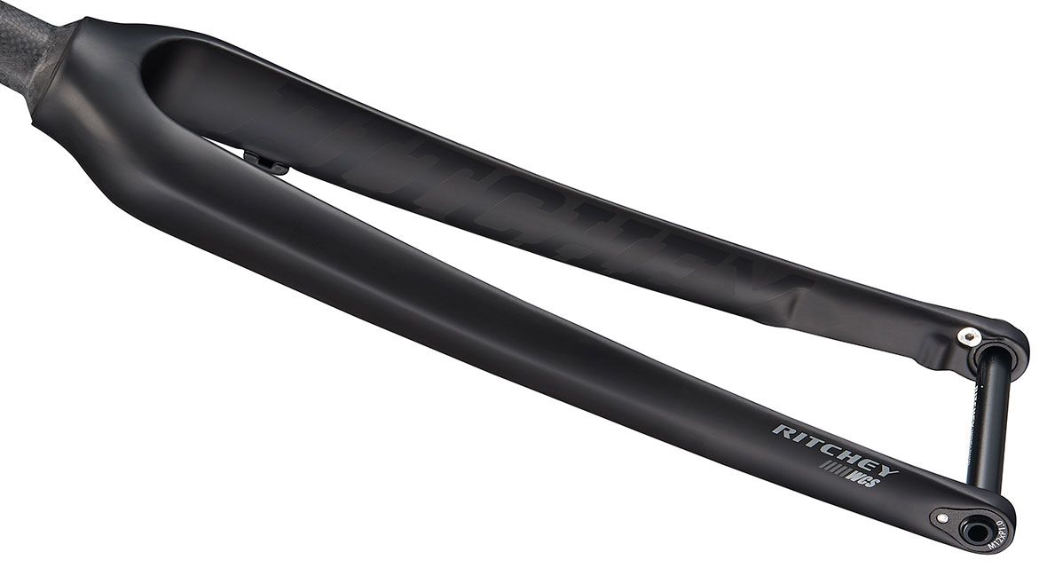

Thats more of an oddball size, but forks do exist.
Quick search didn't find anything cheap, but maybe theres something out there. Cannondale did that size fork for a while.
Could also look into a spacer to reduce the bottom race to 1-1/8, which is a much more common size and has a lot more available. If I wanted to go down that road I'd email Cane Creek and ask if one of their crown race adapters might work. Like this: https://www.worldwidecyclery.com/pr...oy-47-30-conversion-crown-race-1-1-4-to-1-1-8 (use as a crown race on a straight 1-1/8" fork and the angular contact connects with your 1-1/4" bottom bearing). Not sure if the dimensions line up though.

Jaberwocky, thanks for the links to the forks. Civante has the crown race taper machined directly into it. Those looked like the crown race is missing and instead would use a pressed on crown race that came with the headset ---IDK ???? The Richey one looked like it had a taper there but not machined. Those are also expensive. But I was wanting to change it to carbon anyway. I will follow up with those companies for explanation how adapt it.
