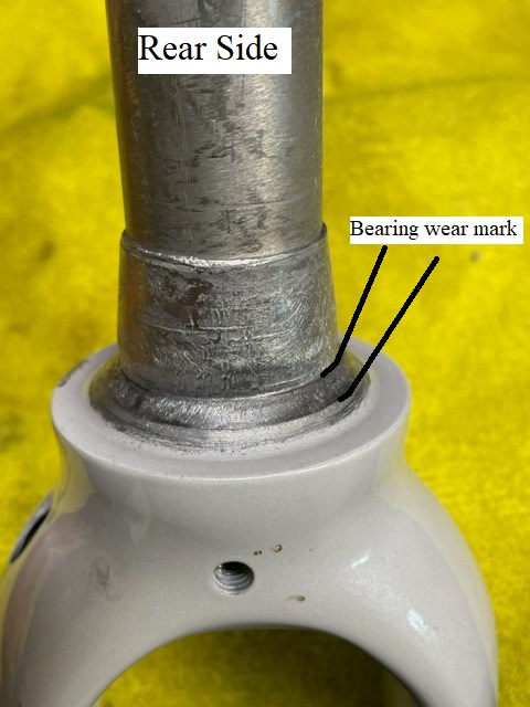

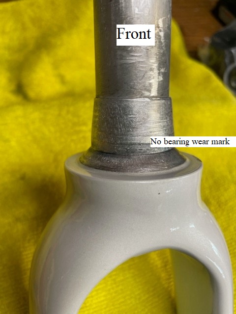

Without any help from Yamaha customer support to figure this out -- I fixed the creaking / snapping noise by replacing the fork with aftermarket one. If anyone else experiences similar noise from the headset, I will make a seperate post about swapping the fork.
The stock fork uses non replaceable crown race, The crown race is cast into the fork and then hand sanded to clean up. In other word the lower bearing mating surface on the crown race is not an accurate surface. This mismatch is what causes the rattle/creaking/snapping noise. Noise may be suppressed temporarily by over-tightening the the stem compression bolt. If over tightened what eventually happens is the star nut just loosens up in the steerer tube and the noise comes back.
Attached pictures shows the hand sanding scratches from forks manufacture and also the wear mark into the crown race caused from the lower bearing. The lower bearing is supposed to mate onto this taper evenly. In my case it is apparent the bearing was not sitting on the crown race evenly, and as such I believe it was shifting which caused the noise.
