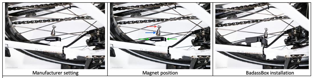

The SpeedClip/Bada$$ Box has been great. Easy to install and remove when needed and they supply a replacement wing nut for the spoke magnet.
There is no speed cutoff above 20mph and the power delivery is unchanged. Here is a quick photo summary of the installation process.

FlatSix911- Magnet position has to be dead on. Took a few tries to get it exactly in the correct position per your diagram. Now I am flying to over 30mph with even a bigger smile on my face. This unit rocks! Changes the whole experience. I'll hookup my Cateye speedometer for accurate readouts.:p;)
