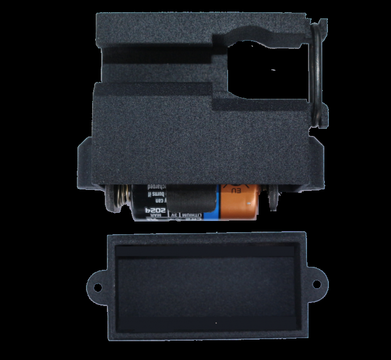

Did you purchase from a vendor in the UK or AUS? I think the 3.4 version uses button cells, correct? If so, how often do you have to change out batteries?

The CR2 photo battery is used and has a mileage range of about 4000-5000 km.
