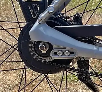

The typical 15 mm bike wrench won't fit around my rear axle bolt (Gazelle Ultimate with IGH). The torque spec is 30-40 nm.
Should I just buy a torque wrench? Any other recommendations welcome!

What you have is a cone wrench, which isn't supposed to be used on an axle nut. If you are talking about wanting to remove the rear wheel, a set of sockets, or a 15 mm socket at least, and a ratchet handle would be my go-to tool. There are other possibilities.... I'd recommend that first, and if you want to torque things right, add a torque wrench. You could just get the torque wrench, and the sockets, but there's a lot of wrench work that doesn't require measuring torque, and torque wrenches can be somewhat delicate and are best left for just making final torque adjustments. (Not for the grunt work of loosening or tightening every nut or bolt all the way down.
If you are adjusting your bearings, you still need to loosen your axle nut first, so your cone wrenches are still needed -- but there are two jobs there. Loosen the axle nut, and then adjust the cones. Two tools.

I have a torque wrench that maxes out at 12 nm. Just wanted to see if it were necessary to buy a new wrench for this one bolt. Bike shops told me they don’t bother, but idk.
You're going to need another wrench. Your cone wrenches are for hub cones, not for axle nuts. I'm going to go out on a limb and say that most people probably don't use a torque wrench on their axle nuts, but there's a saying that torque wrenches are for amateurs -- pros don't need them for jobs like this. So if you have no idea how to feel about the right tightness for your axle nut, get a torque wrench.
I completely agree with @m_robertson that everyone who works on bikes should have a torque wrench though. If the one you have only goes to 12 nm, you need a bigger one for this job, but more than that, you need a set of sockets and a ratchet. If this is the only nut you're ever going to deal with, you can get a dedicated 15 mm wrench that will work. but once you have a socket set you will probably find a million other things you can do with it.

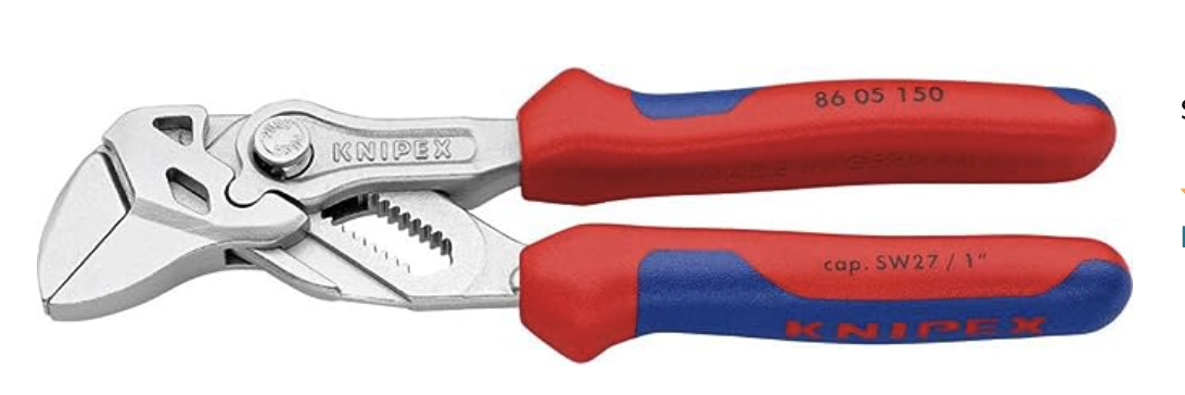

For my hub bikes, which are pretty much the only ones with bolts on the axles, I used to carry a single stubby box end wrench. Its good enough to torque the bolt enough to get me from the side of the road to home, and the box end makes solid contact. Its not unusual to need the open ended side on the drive side due to lack of clearance. Its dedicated to a single size, but I only need one size on the whole bike for that one nut/bolt. In more recent years, I have gone to small Knipex pliers which can apply almost the same level of grip as a fixed wrench, and they are adjustable in case I need them for something else. But nowhere near as cheap as a simple box end.
The problem with Knipex pliers or cone wrenches, or adjustable wrenches is getting them around the nut. (Look at the picture in the original post.) Even if you could get them on the nut there probably won't be enough room to turn them at all.
There are all kinds of wrenches and pliers, but they don't all work properly, or even at all, in every situation. Of course that's exactly why there are so many varieties. There's usually a right tool for any job. A lot of the compromise tools will work in a pinch but they are often exactly how nuts get rounded and ruined or knuckles get scraped, tools broken, etc.
Yeah sure, but the OP's photo shows an Enviolo hub with belt drive, which means just loosening the axle bolt may not be enough by itself to remove the wheel. For a short time I had a bike with such a hub, and my recollection is that I also had to loosen the two hex bolts visible in that photo to be able to slide the wheel forward enough to get the wheel off and on properly. Which means you're re-tensioning the belt in the field.
Good points, but not really relevant to how or what tool to use to loosen the axle nut. Maybe very important to how or even whether to try to remove the rear wheel in the field. @AvelancheRun didn't ask about that, although it was almost certainly implied, I agree.
