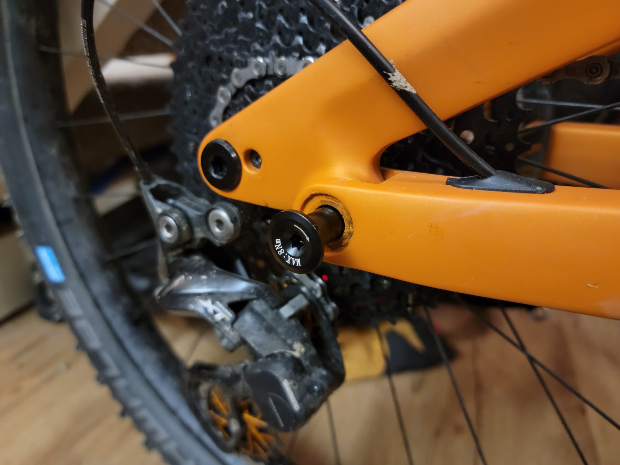

Acme is right, the nut inside my rear swingarm pivot fell off in just a few weeks. Need to blue loctite and torque check all the pivots, shock attachments and other fasteners that need it.
That makes sense, the nuts with the bike are machined to have a wide-smooth flush fit in the suspension recess to avoid grabbing anything but peace of mind and carrying backup nylon nuts would be handy. Do you have the threading and size for most of the pivots?

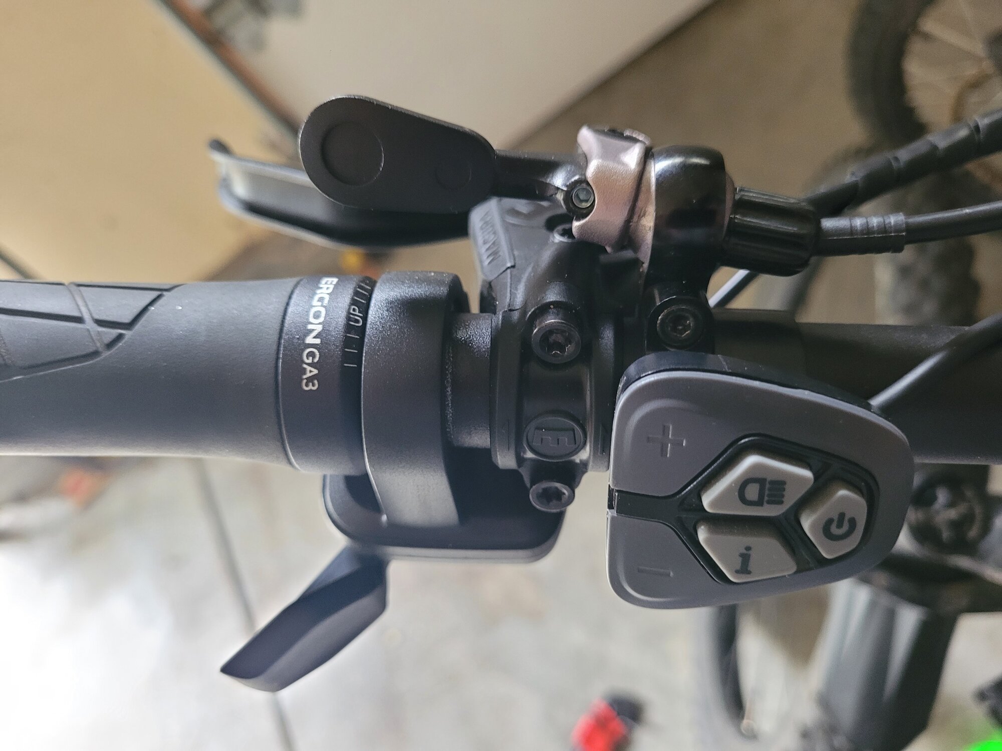

Got the left hand throttle bexamous recommended and it's smooth with ability to feather power in gently. Ergonomics feels better than stock as well. Here's a pic of it with the Highline dropper remote I have mounted above bar.

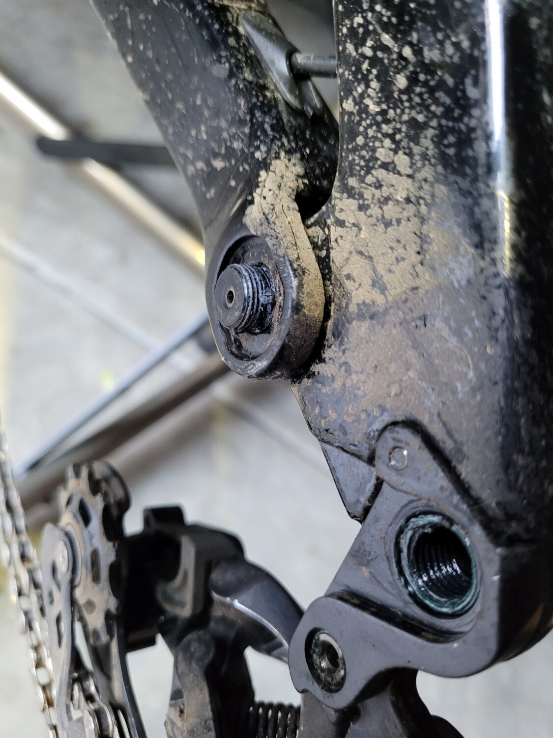

There are ALWAYS more bolts. I was riding and kept hearing a noise I couldn't place, after looking 50 times I finally see it, a bolt in rear triangle is almost fully backed out. In fact I see it, I stop and get off bike, and me getting off bike the the final straw and falls out. Good timing on my part, haha. The bolt an inch from rear axle. It is covered in grease, but I'm seeing no locktite on threads. There is a ton of dirt on threads, so I think the nut actually fell off on a previous ride and I just hadn't noticed.
I just pushed bolt back and and rode home looking back frequently, it never shifted a mm riding calmly on smooth straight trail.
But now I need to find a replacement... anyone know where to get the 12mm nut that goes on other side?
That's the nut that fell off mine. Would suggest submitting a ticket with WW. They might be able to help.
When the nut came off in my case it was a cyclical metal on metal grinding sound on wheel rotations. Not sure exactly what was grinding but probably brake disc on something. Good to check the bike on any unfamiliar noises. Last week I heard a light clicking on the 50T rear cog, tuned the shifting and still heard it. Lubed the chain and it went away, lots of wet/grimy rides lately. I'm in Carmel, would be good to get some bay area Hydra folks together for a ride.
