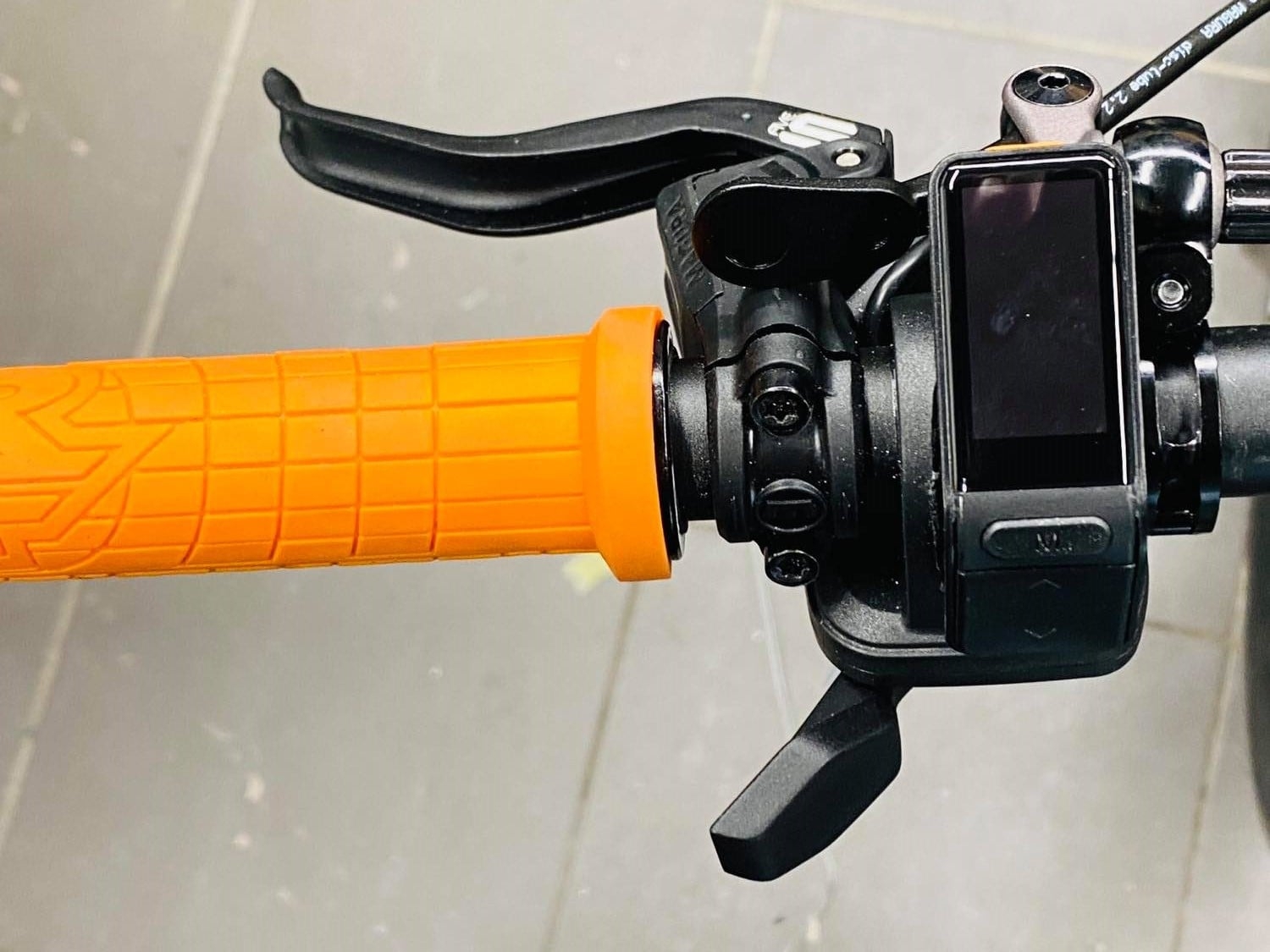

Forgot I ordered this left-thumb throttle awhile ago: https://california-ebike.com/shop/bafang-standard-thumb-throttle-left/
I'd gone throttle-less and didn't miss it, but this showed up so might as well try it.
I can't tell if this is any less on/off than the stock one was, I turned down throttle from 1500w->500w which also makes a big difference.
But anyways its not pretty but I got everything to fit.. there is very little room for adjustment, everything has to rotate together, and it felt like a puzzle trying to find a way to tighten all the screws down.

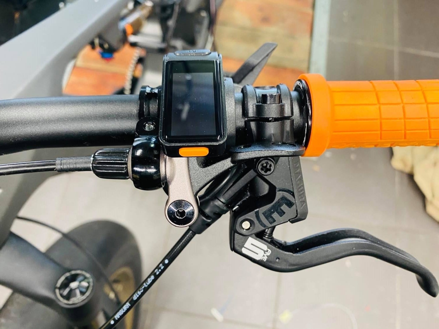

I'm hooking up that same left throttle this weekend. Previously switched to the Highline Dropper remote above bar which I think works well and allows any mounting position if needed. Got the idea from Lode Crommen on the FB Bafang G510/M620 group.
The ergonomics and feel of the throttle feel better than stock. May need to replace the hall sensor to really get it to put out a smooth signal. With the Archon power it would be great to have smooth throttle control ability in rocky or rutty situations where pedal movement is limited.
