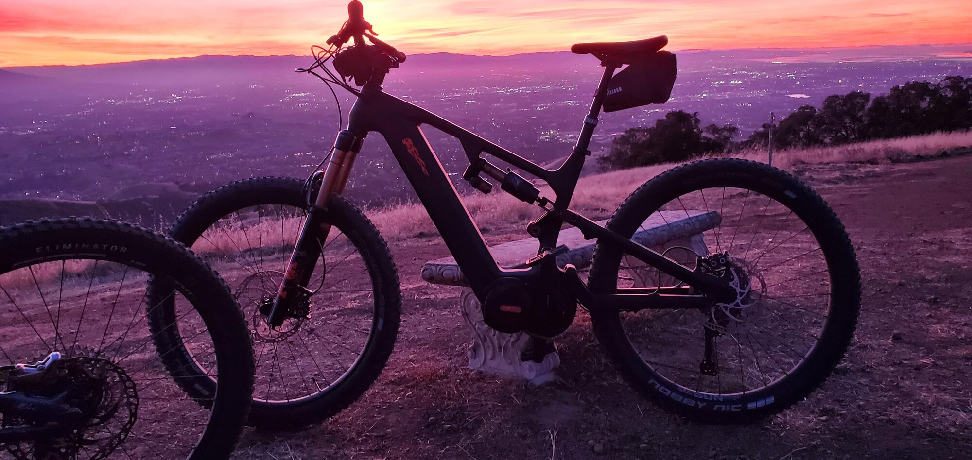

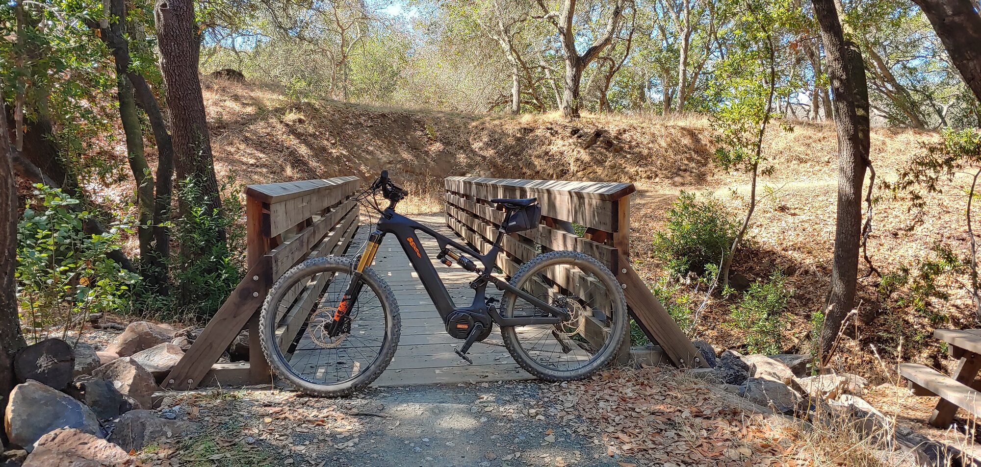

These are photos from my first and second rides; total of about 35 miles and 4700 feet of climbing.
The Bafang Ultra motor with the Innotrace controller is no joke. Does anyone go above Eco2 for technical trail riding??
I'll use Eco 3 for the steepest climbs but it is a challenge keeping enough weight on the front wheel for steering. I'm usually on Eco 2 for technical trails. I use sensitivity torque level 0 and motor torque level 0 for all assist levels. This gives smooth, nearly instantaneous assist when starting on an incline.
Eco1 or 2 on trails depending on much effort I want to put in or how much adrenaline I want to produce. Sometimes jam into eco3 when trail gets steep or starting off at the base of a hill and need quick acceleration.
I've only come across one hill that I think I would need sport mode to get up- not sure if it's too steep to stay on the bike though. I took a few runs at it in eco4 and bailed out about halfway up where it steepens. Next time I'm out there I'm going to run at it in Sport without stopping to think about it first.
