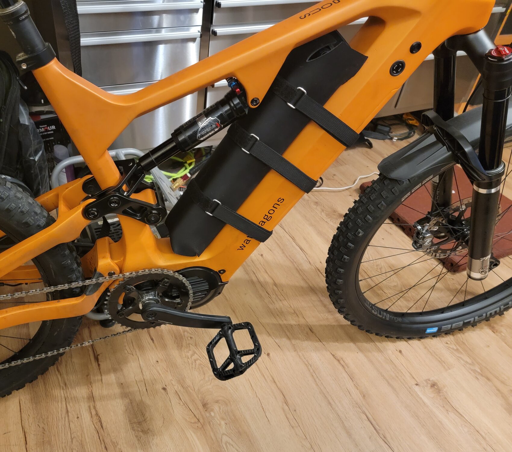

Got 3 velcro straps to hold battery in place. Picture below was testing straps out.. work well. I've now gone on two rides with 2 batteries. One ride I took two dead batteries rather than waiting on charger. 2nd ride took a 2nd battery just-in-case, probably could have gotten home without it.. well certainly woudl have gotten home but maybe I'd have a unpowered bike for last couple miles. Few things:
- 3 velcro straps work well. 3 is nice for some redundancy. Also makes it easy to tighten the straps, two can hold battery so can always undo the 3rd to pull it tighter. Can then kinda seqentially though thrm them pulling htem tight.
- Mouse pad + strap setup works great.. there is zero movement possible in battery, no way to wear on paint with vibration or whatnot.
- I can't tell when I'm carrying 2nd battery.. bike starts off heavy and with 2nd battery its still heavy. I don't notice its heavier. I'm kinda surprised I can't notice an extra 10 pounds.
- Its nice having 2nd battery. With single battery being conservative can get 40-45 miles, but not being conservative more like 30-35 miles. So if I set off with single battery and not sure if I'm going to go 30 or 40 miles.. I kinda need to be conservative just in case. With two batteries was nice to be wasteful.
- I think setup looks 'fine'. It doesn't look like I have a wierd battery setup.

You might be able to get some small, lightweight ratchet straps to avoid having to readjust the velcro straps on your setup. If the rubber side of the mousepad is face the frame then it's not sliding anywhere

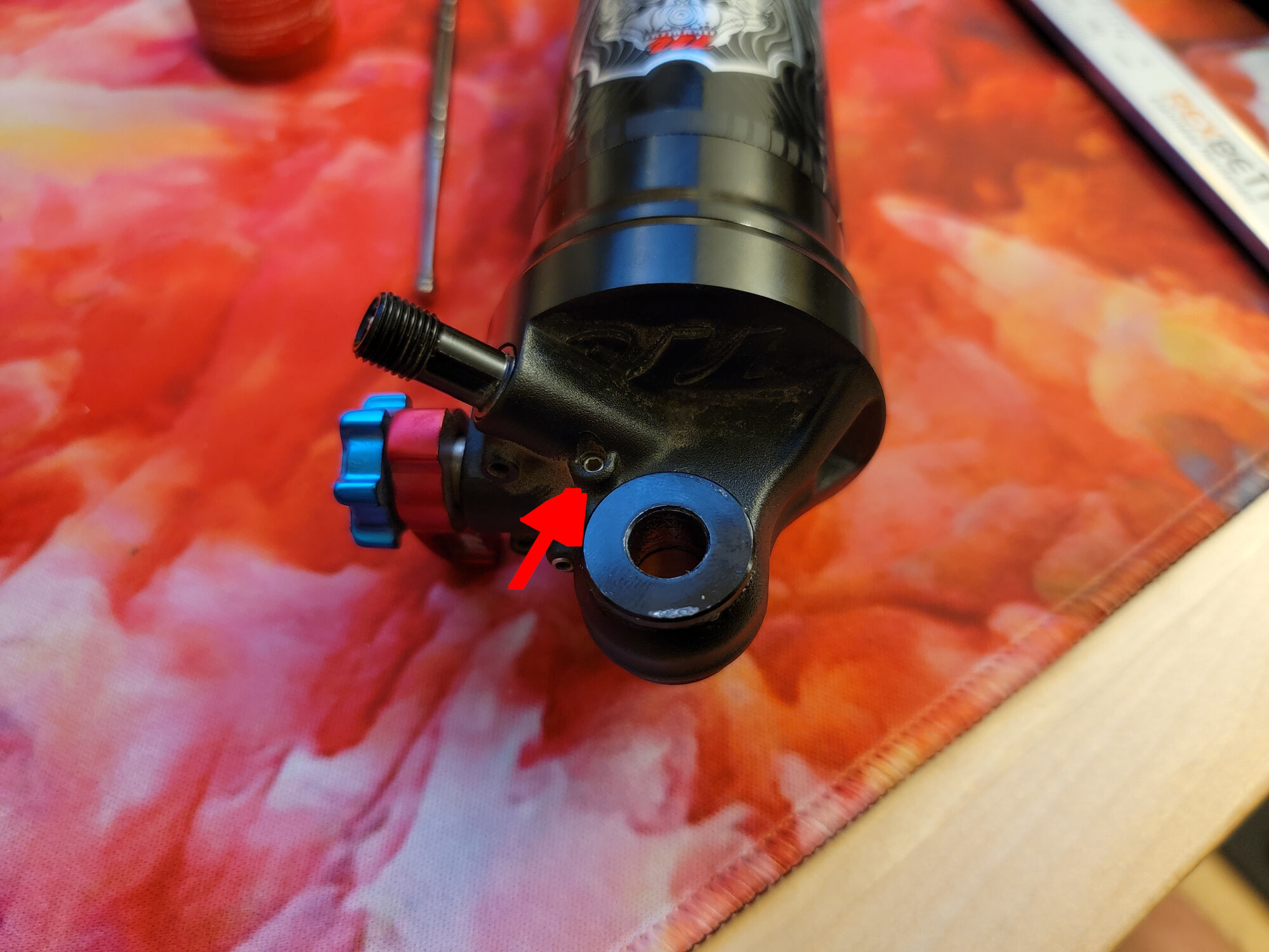

If you were able to invert the shock then I don't see any clearance issues with a model that has an external bladder either.
The bottom shock mount makes it a little difficlut, eg Mara shock mounted inverted doesn't work.. see picture below. The arrow points to little bit that hits. Its so close. Could probably modify the rear mount to make room.

On my frame too looks like I'm unable to invert atleast the DVO shock - the rebound adjust and bladder probably won't even allow it to mount let alone travel. I know they (Dengfu) experimented with trunion mounts on the E06 at some point but it wasn't working out - I think this was before they moved to a single solid linkage between the shock and suspension arm and may work with the solid piece they now use. I've seen at least one person here with a Hydra that has the trunion version of the shock I have and the benefit of that type of mount is being able to squeeze a larger shock into a smaller space, but can't be inverted since the trunion mount is directly on the shock body.

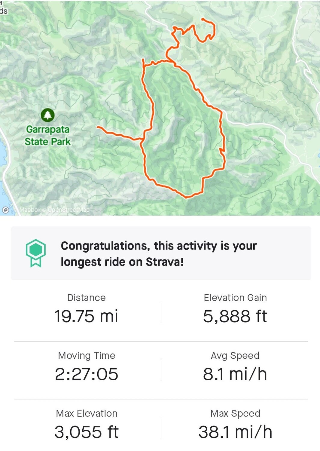

Despite all the harsh rhetoric going around got a tough ride in recently and was impressed with what the Hydra with Innotrace Archon controller can do. Almost 6k vertical feet and almost 20mi with a little over 30% battery left.

Nice.. I had taken data from like 30 rides, just miles, ft-elevation, and watthours charger put back in when I got home. Best fit is: watthours ~= 6.828 * <miles> + 0.094489 * <ft-elevation>
That ride for me would be near 691wh+-5% probably. Theoretically that'd be 81.2% of if pack is really 850wh, a more realistic like 780wh.. 88.6%.
Elevation is what really kills my battery. I weight 220lbs which doesn't help, lol. And over time I've started to use more and more motor on climbs. Used to be more happy be in low level and use 250watts and be in lowest gear and just slowly go up climb.. but more recently I've tended to quickly go to 750-1000watts and I'll still pedal and keep my heart rate up but I'll be going at 10-12mph on like a 15degree cilmb. If I do 200 watts or something pedaling when limiting moror to 250 watts I'm doing like 45% of the work up a hill.. but when using 1000 watts get up hill so fast I've done ust 16% of the work.
