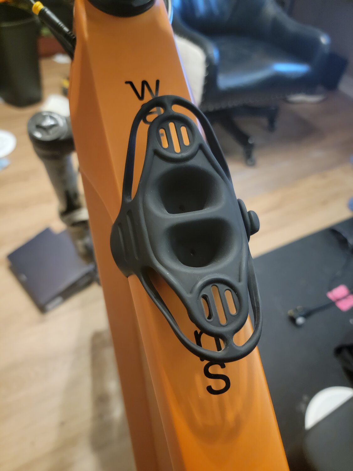

Okay got two things...
First is battery holder: https://www.amazon.com/dp/B08BRNWBMR
It just barely fits around huge top tube. Easy-enough to put phone in and least with my Samsung S22(?) Ultra I can't imagine it coming out ever. It is a little annoying how it covers the 4 corners of phone, so sometimes hitting buttons in corners is hard. Not saying this is best battery holder, but this is at least one that works.

Word of advice, I've been warned by others to be careful with mounts that fix your phone to the frame or handlebars like that. Even with rubber material more than one person has mentioned that the constant shock and vibrations from riding affected the focus or zoom on their camera. A lot of the newer phones have mechanical zoom in some of the cameras and those tiny moving parts don't like that. But I mean I go hiking alot and my phone has launched itself out of a chest pocket more than once onto ice, granite, roots, and wildlife and I still get good pictures - so maybe it's all paranoia. Or maybe my photographer's eye sucks.
It's a little disappointing to read this about the torque sensor but reading that thread it seems like it has a higher resolution than the sensors that go to ~100kg. I had initially thought 40kg = 40kgf = 392Nm which would be plenty - more than you'd put out standing on the pedals - but alas it's 40kgs on 175mm crank arms (or 43.75kgs on 160mm cranks). But you're right in that once you're in motion you're putting out far less force to keep the bike going, so the higher resolution sensor may be better than having a wider range of input force. You'd just have to be mindful of your assist levels if you want to get a full work out, or pedal at a higher cadence in a lower gear.
Yeah read about that a bit but my phone's screen is cranked and at this point I don't care. Haha. If it breaks it breaks. :) So far so good.. maybe.. few hundred miles since I got it. No issues so far.

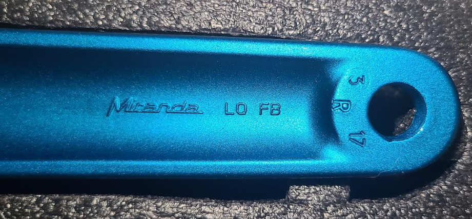

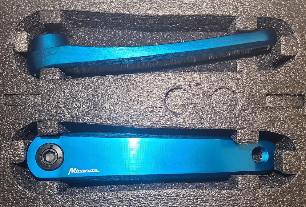

@bexamous do those cranks seem sturdy? Have you thought about what may happen if they take a rock strike with your full weight on them? The two pair of Mirandas I got are too narrow for my E06 frame so I bought another pair after they reopened their webstore after a long closure, and the drive-side crank has a profile where there's a lot less material along the thickness of the cross section - to clear super tiny chainrings I suppose - but it kind of worries me about breaking. Luckily I did find a source for single crank arms and can just order the non-drive side full thickness one if this does break, but it makes me a little anxious to snag a throttle before I go on any serious adventure just in case... A real shame the 152mm set I ordered a just a couple mm too narrow to clear my chainstays with confidence because I could probably pedal so fast on those little shorties.
here you can see the difference - I'm not a heavy guy but I'm not light either so it does not inspire confidence. At least they switched their packaging to fully recyclable and much smaller box...

I got power meter pedals, still have 160mm WattWagon-branded Miranda crank arms. I'm super paranoid about pedal strikes, lol. Not going to run these 100% of the time on Hydra. Just doing it now for fun and while they're on here being super careful, haha. Eventually going to get a gravel bike, pretty sure, and they'll end up on it.

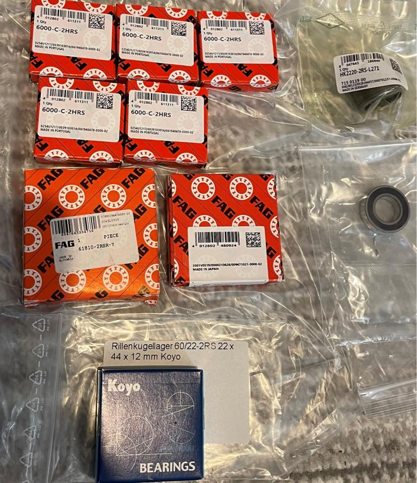

Anyone tried to replace bearings in an Ultra motor? Or know what bearings there are?
Have 2500 miles on bike. Only thing that bugs me.. there is tiny bit of play with the axel, somehow? Pulling crank arms side to side I can see movement in gap between chainring and frame.. and I can hear it a little, more when I'm riding though.
Gearbox sealing and bearing quality is really disappointing in these bafang motors. Definitely recommend the Bafang M620 FB group for bearing info. A great contributor there designed a 3d print cover for the worst area around the crank on the drive side. This post is one of many, lots of folks have seen problems with the bearings (image is from Markus Rubin there, agree with him best strategy is replace the bearing set with good quality ones-his experience was FAG brand superior to SKF bearings but beware of many FAG bearing fakes)
I've got the bearing set to swap into my motor but have kind of been hesitant to open it up and swap them... I have a bearing puller for swapping enduro max compliments into the suspension pivot points for my frame. I did have an IGUS print for one of the motor bearings as I couldn't find an ABEC 5 in that specific size - I can check that list but the printed part presses into the bearing so it can fit on a slightly smaller shaft. My X1 came packed with SHC100 that I'm sure as I can see a little and definitely smell it. I'll check the print files for those seals as that's something I'm really interested in - I notice a little play in my chainring spider but it's a slight rotational play, not axial. I've got a mix of bearing but some of those exact ones. I did pick up several backup motor gaskets and I have a tube of SHC100 on-hand though. Bearing King in the UK was a good source for me. A bit of a bummer to hear about the SKF's as I do have a few of those in the lot - but oh well they are wear parts and they do get replaced. I think it was around $90 or so for everything? I matched the same seal code as the original bearings though, so I'm not sure if that would be any reason of concern. Different bearings are packed with different greases as well which also has a bit to do with sealing. If I open up the motor, I'll probably swap 10awg power leads onto the controller with about 8" extra wire and an XT90 end. Easy enough to do since the controller uses bolt on lugs instead of soldered wires (at least the stock one does and the X1 reuses the stock wires)
Wow awesome info, thank you so much.
Guess I'll be ordering a set of bearings... and bearing puller. :)

I find it strange that the cranks WW gets from Miranda don't have the self-extracting bolts. I greased up my axles nice and good to avoid this issue. I think you can get the self-extracting bolts to add to the cranks, the little assembly screws into the bolt cover threads and has the free-spinning bolt captured inside. You can't get a good grip on the bottom of the 'stub' (pictured on the top crank in the first image)
@bexamous I've got a set of 170mm Deltas in Double Diamond blue I can sell for $80 shipped - they're about ~$92 shipped from Miranda or $114+$24 shipping (wtf!) from Ridewill. But of course may or may not fit the color scheme you have. I'm hanging on to my black 152mm Double Diamond black set in the hopes of another bike with chainstay clearance for them. My E06 frame is crazy wide. I wish they fit on mine, love the finish. I think after I bought these too they did a redesign and now the drive-side cranks have a weird cutout in them to clear tiny tiny chainrings or bashguards - and tbh I don't know how I feel about the reduced cross-sectional area where this new feature is on the crank...
