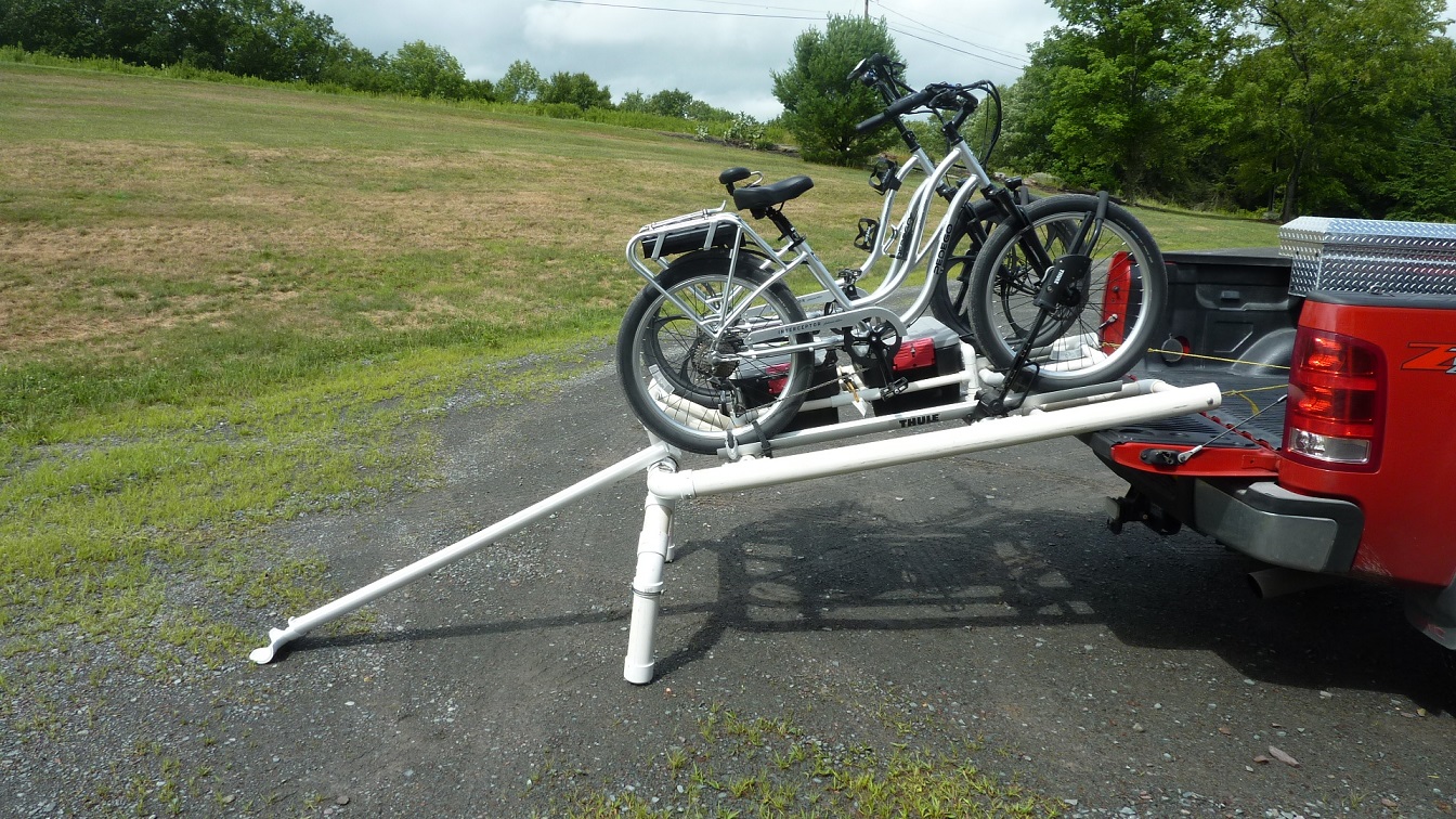

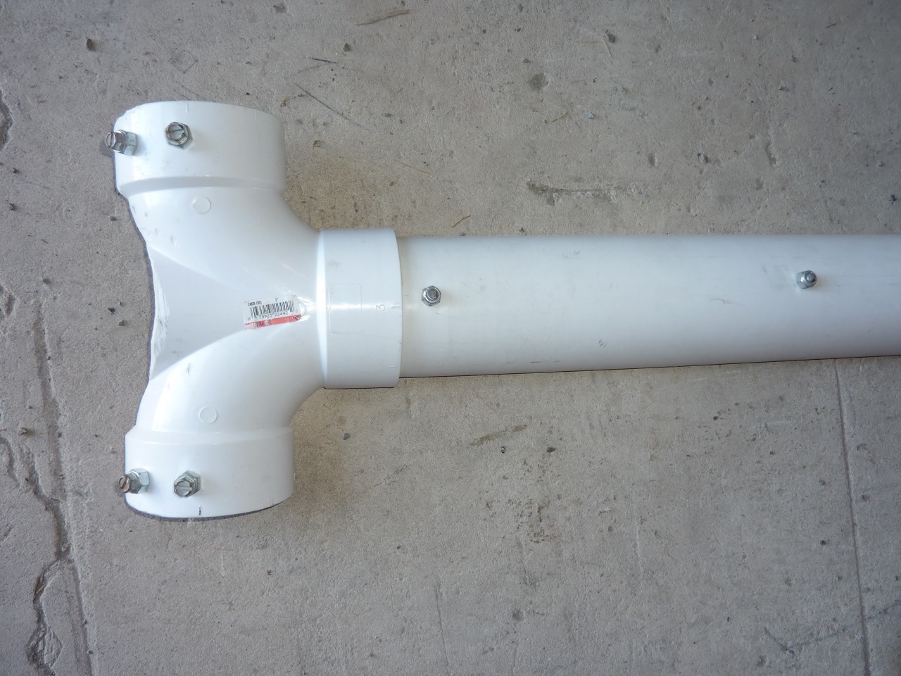

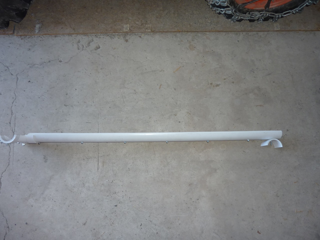

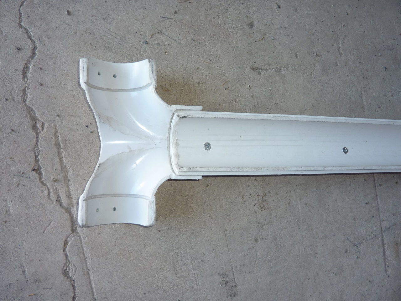

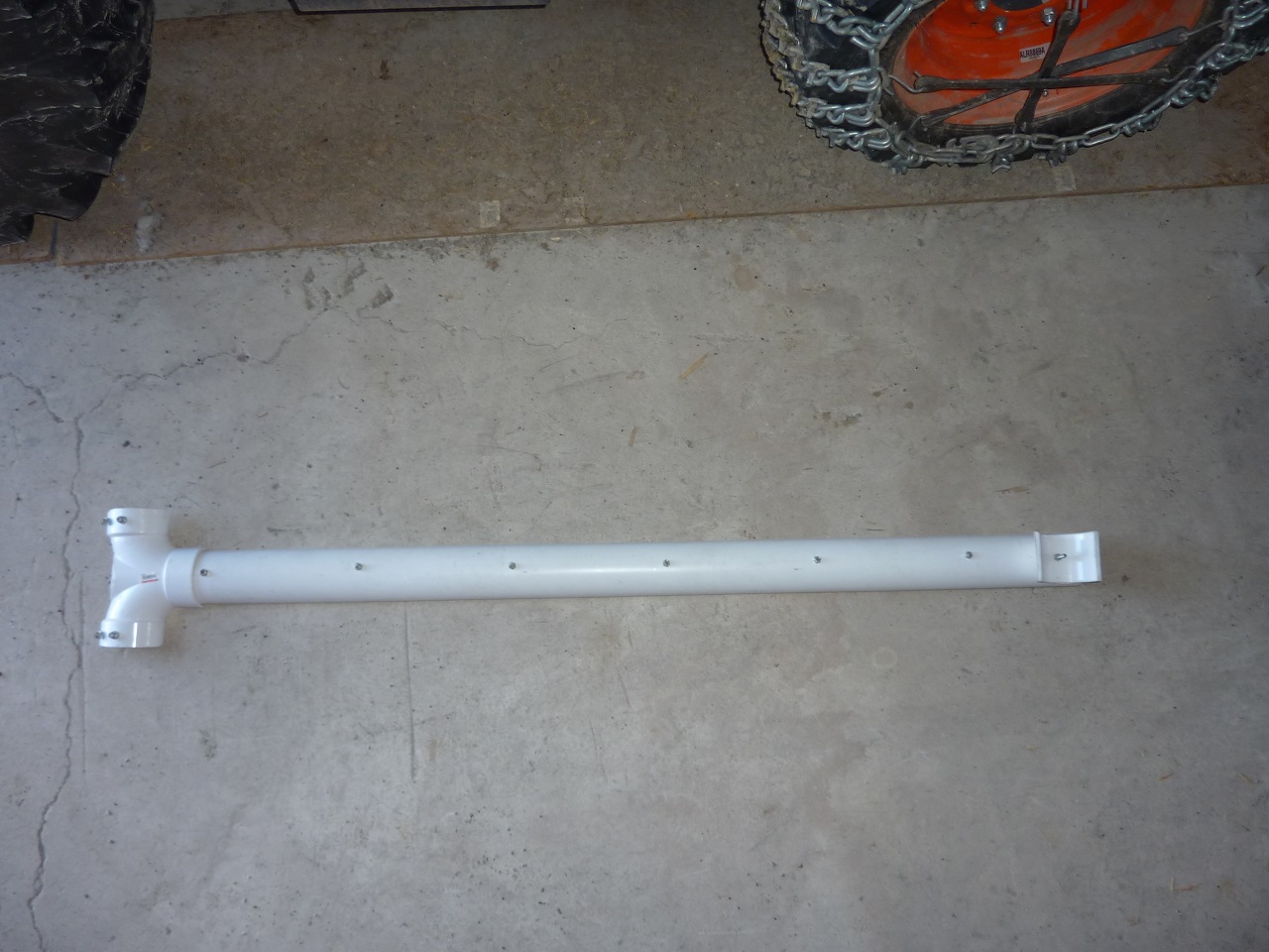

I hear you! It got to the point that lifting the 60 lb Pedego's up onto the PVC slide out rack became too much for me. I looked at similar folding ramps but built this one out of more PVC instead:
Since I don't have to walk the bike up into the bed, this simple PVC ramp works well by rolling the bike up while standing next to it on the ground.
The PVC rack does waste some bed space and I sometimes have to pack gear next to the bikes.
View attachment 77662 View attachment 77663 View attachment 77664 View attachment 77665 View attachment 77666

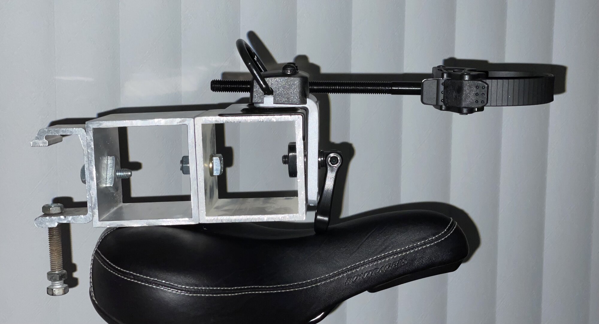

So my first real design exercise is this combo of pieces that will be used to hold the front fork closest to the tailgate by attaching to the truck/topper lip. From the left, the common C clamp used to hold the topper to the truck lip is then bolted to a 3” X 3” square aluminum tube. This is used as a spacer to then allow the Inno Velo Gripper mount to be mounted further out toward the center of the bed and should allow the handlebar to clear the topper. Remember, there will be a total of three support points for each ebike.
More to come.
