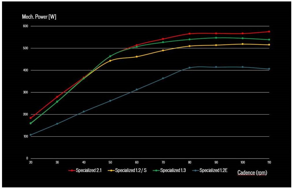

This motor power curve is a couple of years old but it still representative of the peak output of the 1.2e motor vs the 1.3. I haven't found a graph what that shows motor torques for both models, but the peak torque for the 1.3 motor is 90Nm and 50 Nm for the 1.2e.
Thanks Tim. I typed the number wrong, I was concentrating on the E on the end, that E is a lower performance version that provides longer range with the smaller battery. The big power jump is 1.3 vs 1.2 for hills and headwinds.
