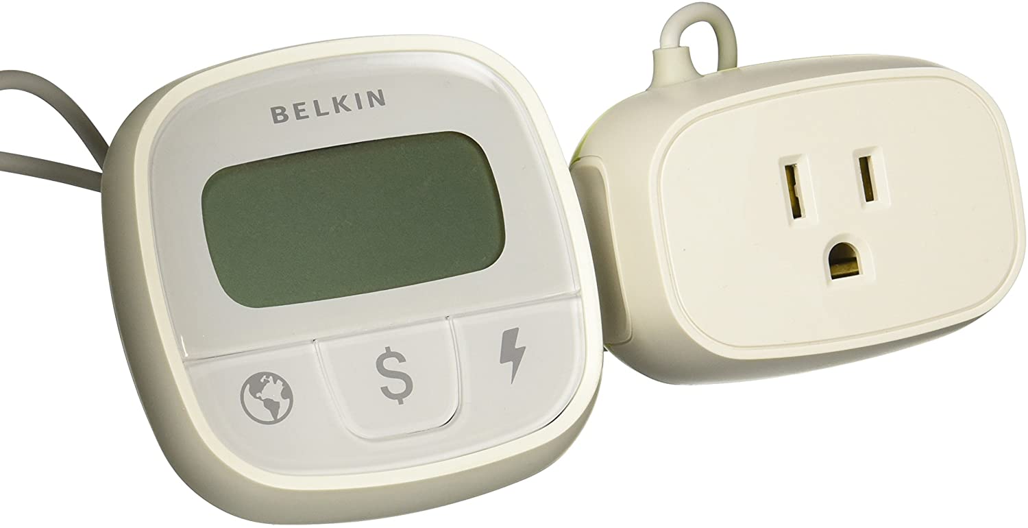

We hear this on occasion for some of our customers living in condo's and in some office buildings situations about the cost of electricity being used. Hearing less now that electric cars are more commonplace.
Costs here are between 8.2 cents per kWh off-peak to 17.1 cents per kWh at peak. So we figured that the average person here in Canada (3 seasons of riding typically for most) would consume less than $20.00 per year at most. We actually lend out our Belkin F7C005Q Conserve Insight Energy Cost Monitor where a customer can enter the cost of electricity (typically plug in the higher number) and this usually puts the problem to rest.
hope this helps,

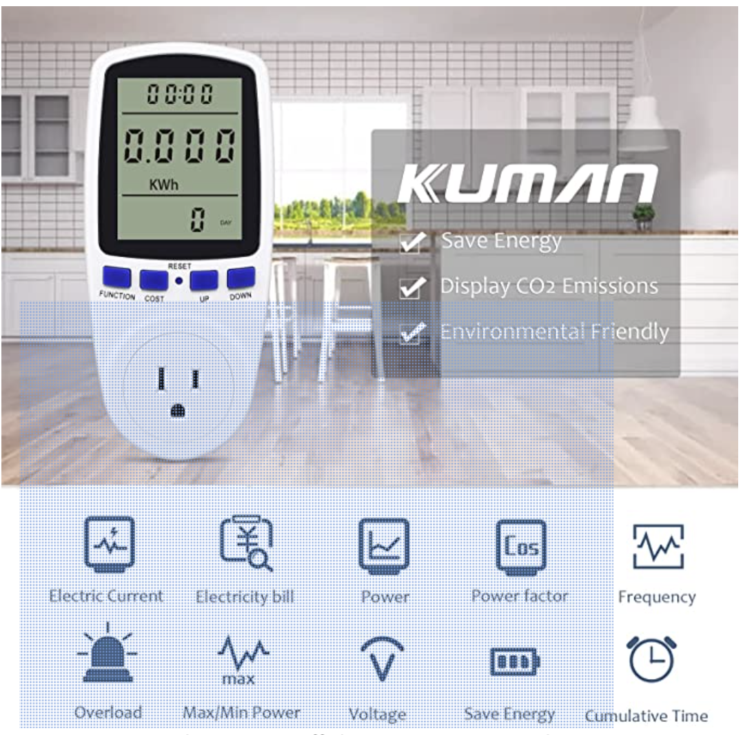

I have this gadget wich calculate about everything I plug in it.
Hope this help
