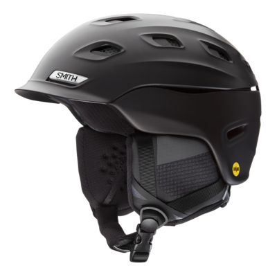

I also concur that skiing and snowboard helmets could be used for ideas for future bike designs. I have a Smith ski helmet that I used for everything from skiing to rescue work (SAR) and snowmobiling, and it was a pretty good all-rounder with impact protection at least as good as most bicycle helmets. Older version of this one, and there are lighter more ventilated analogues in their line.
https://www.sportchek.ca/product/smith-vantage-mips-mens-ski-snowboard-helmet-2020-21-333278635.html?gclid=CjwKCAjwqIiFBhAHEiwANg9szkTqN4v7XMcu1oEl8wqAhgwpsbx8gclCZ37McjiANng1xxpUlKGlBxoCmrgQAvD_BwE&gclsrc=aw.ds#333278635[color]=333278635_01
FGL_333278635_01_a-Smith-Vantage-MIPS-Mens-Ski-Snowboard-Helmet-2020-21-E006759KS55
And looking further at competitive downhill skiing, and they have some nice lightweight models that use very minimal chin bars. The bars are primarily meant to deflect gates and flags away from the face, but do help when you are tumbling or take a big face first dive. POC even makes a break-away version that can be adjusted or tuned to come away at a certain impact level to help absorb those big one time hits and prevent additional injury to the face and neck. This would be quite unobtrusive in daily use, and still allow you to drink and talk freely.
