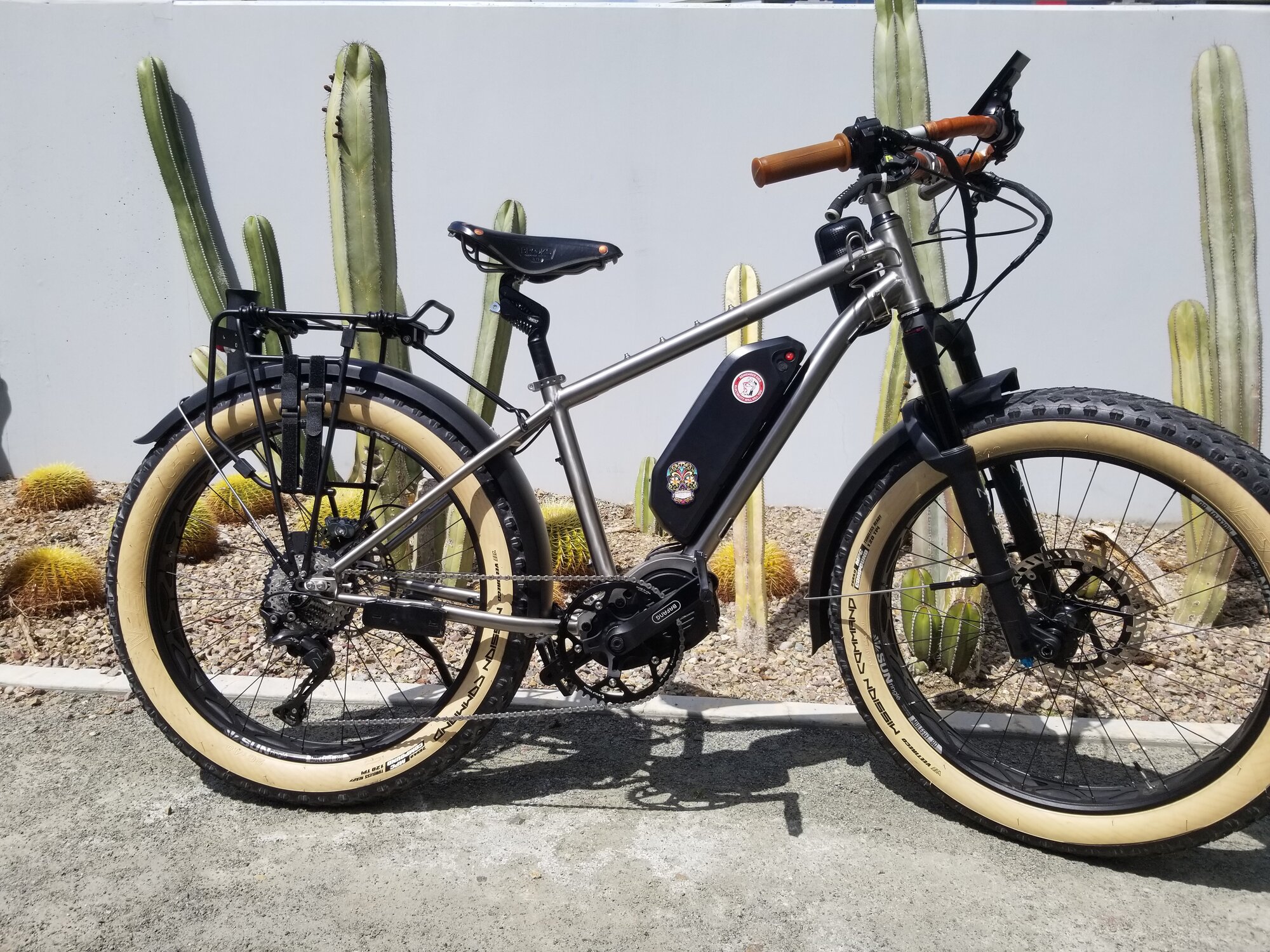

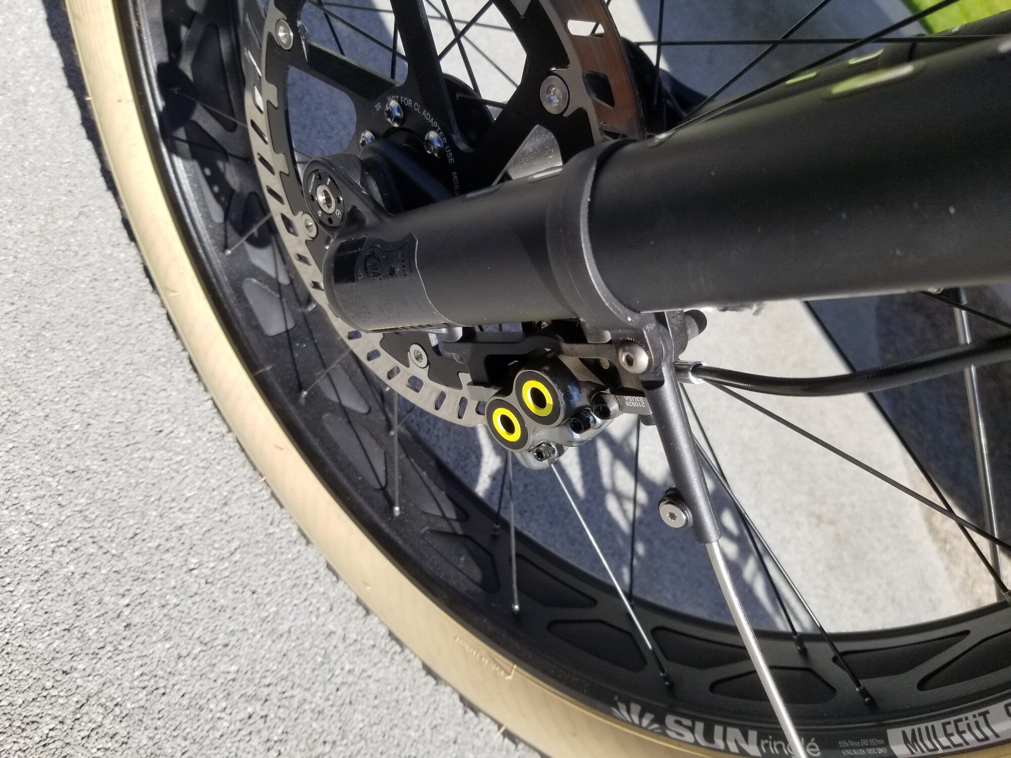

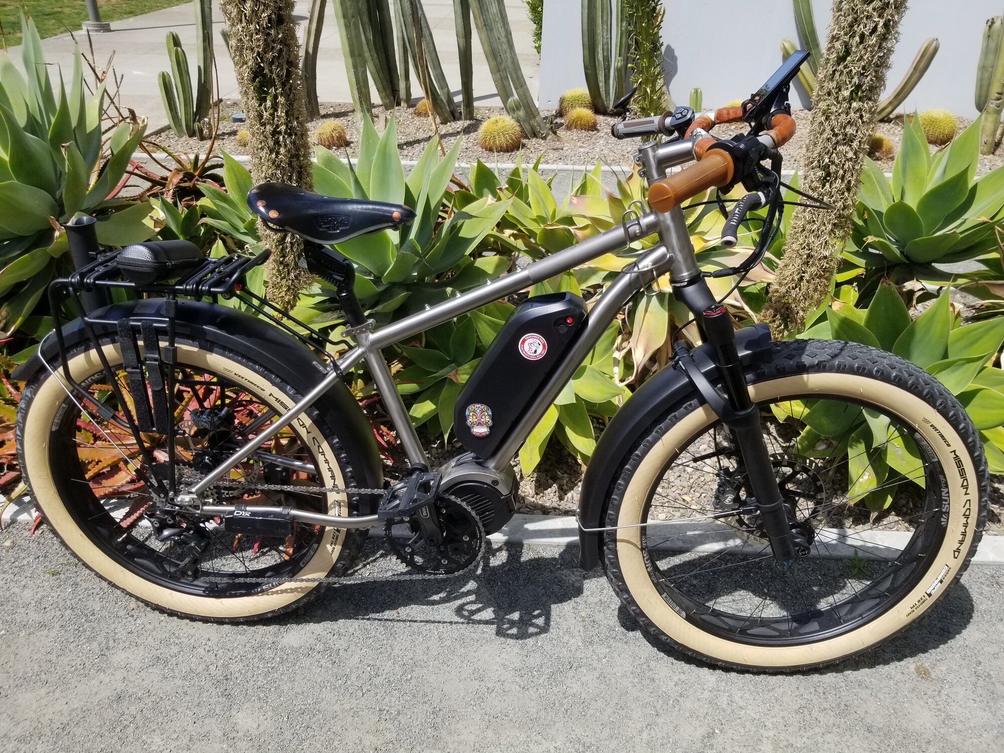

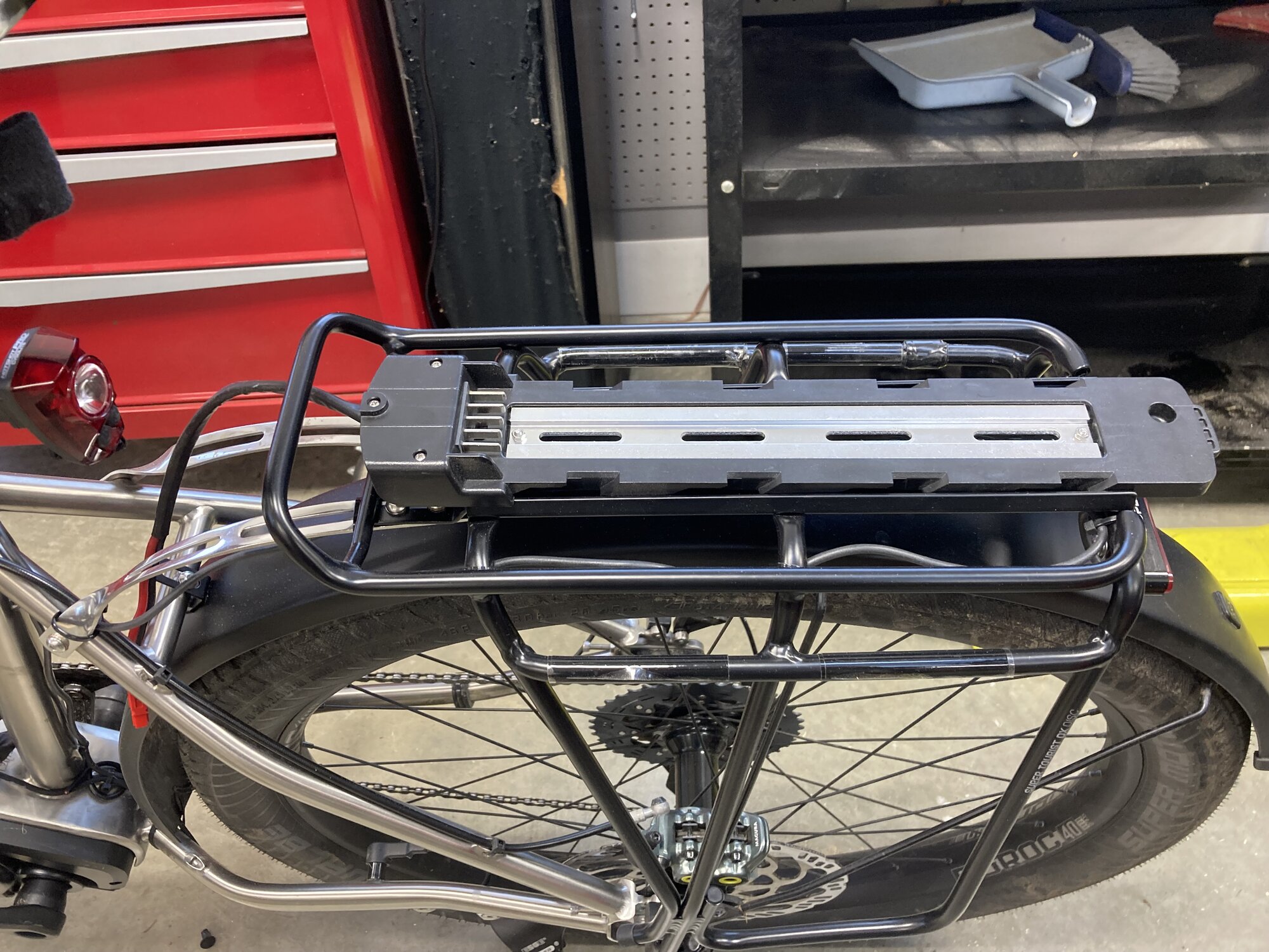

Rains providing time to locate odds and ends and wrestle the Devil in details, so I'm sharing some rough photos.

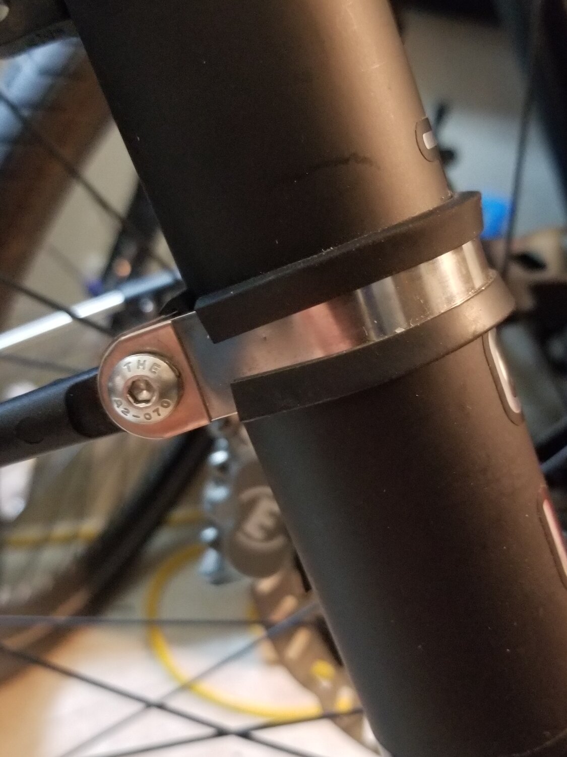

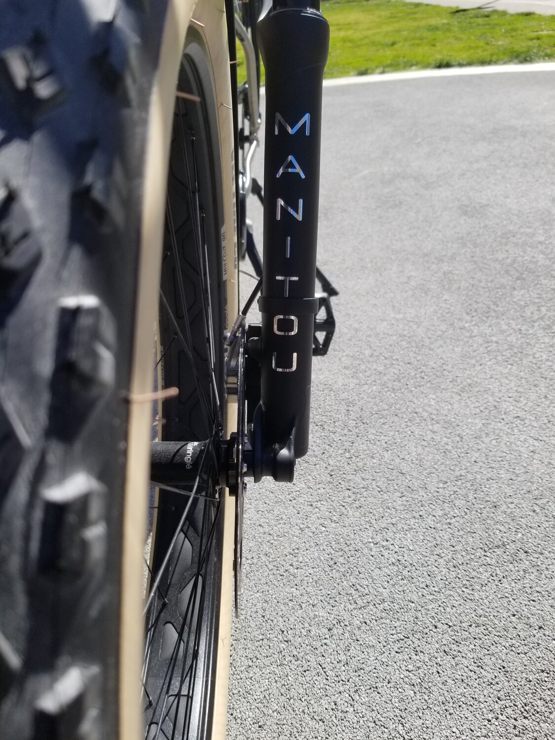

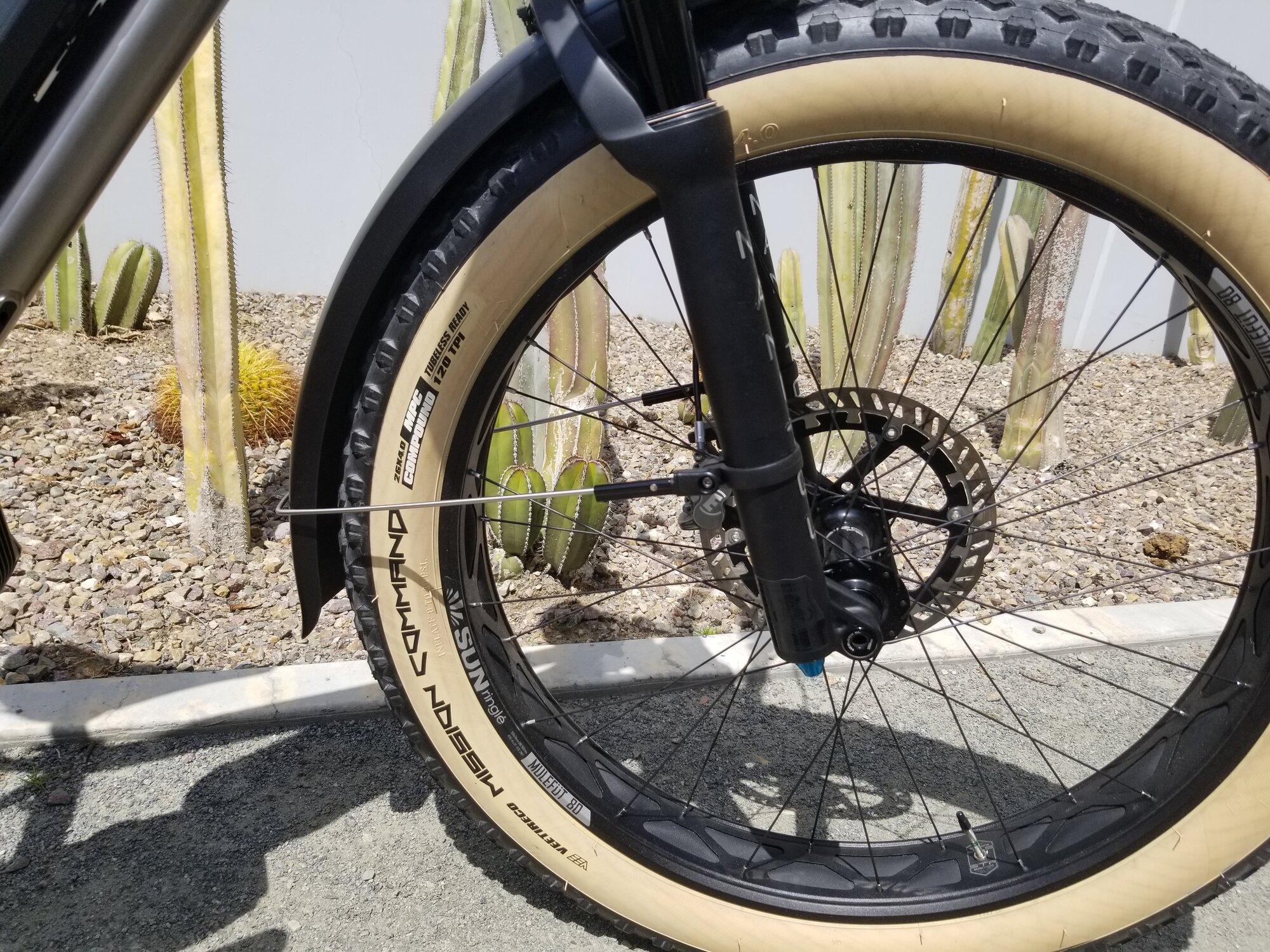

In front, replaced the stock SS and Rubber 'P' clamps w/ SKS stay (plastic) clamps and titanium fasteners.

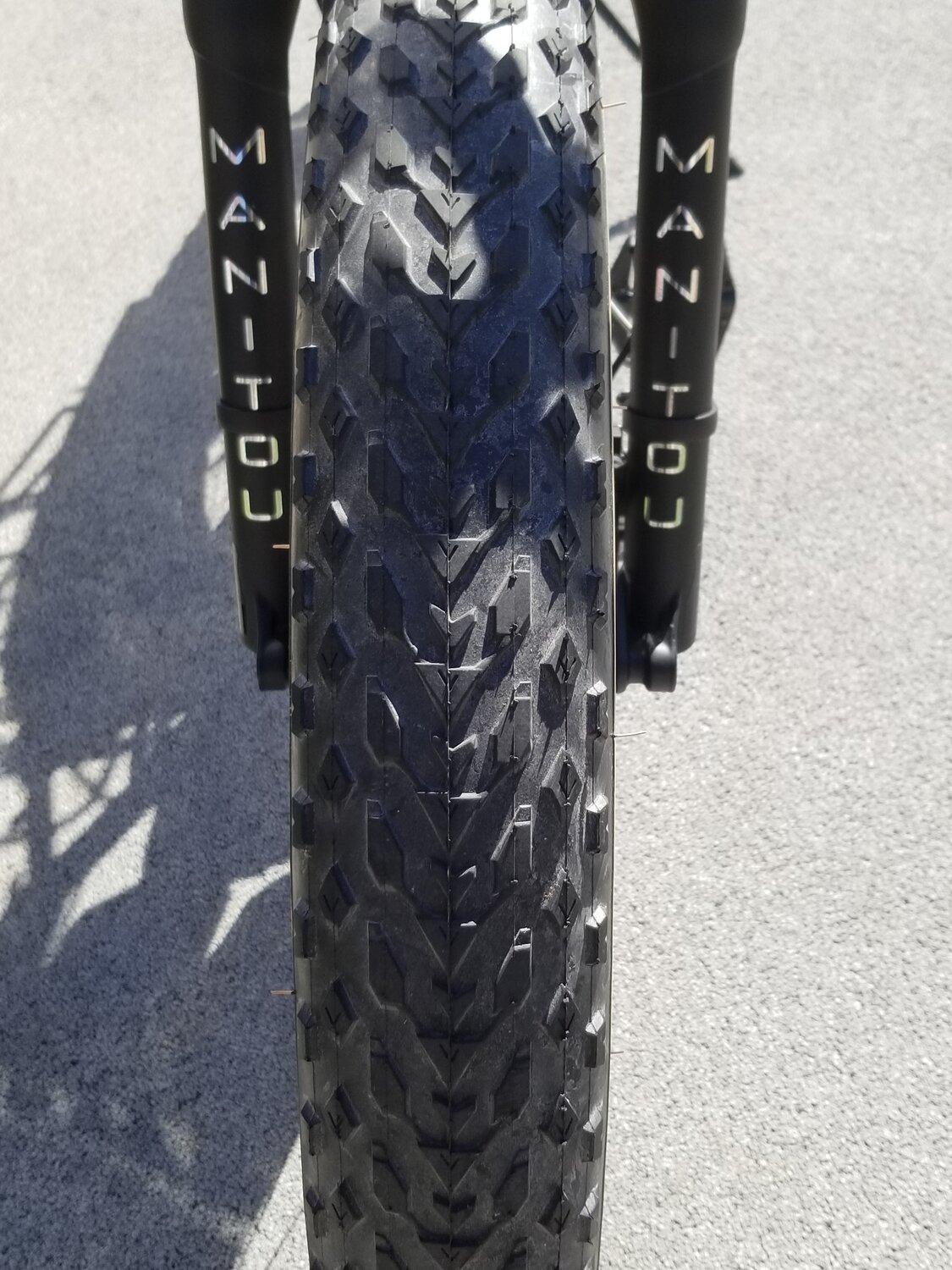

Eliminated 70gms of weight and the 'Manitou' logo (quite elegant with it's 3D colors) is no longer hidden.
Awaiting more Portland Design stay clips for the front. A very nice product - so far. Maybe next I'd have one milled outta a small chunk of alloy - but their plastic interface looks most correct to me.

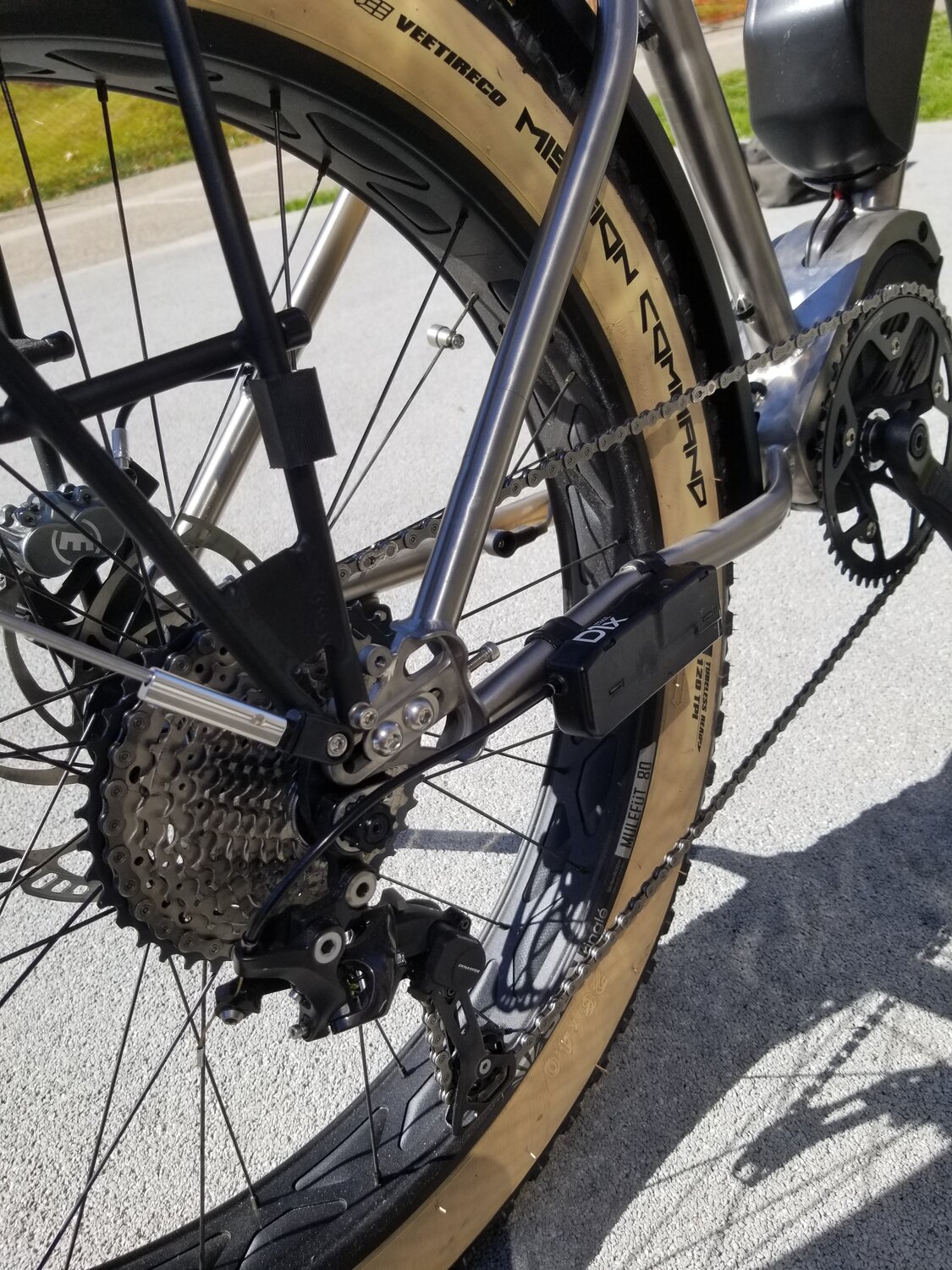

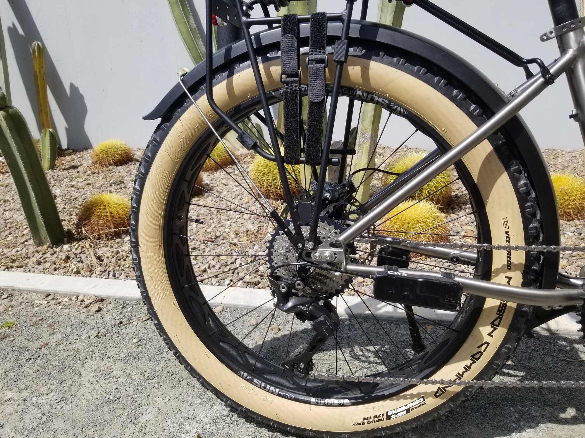

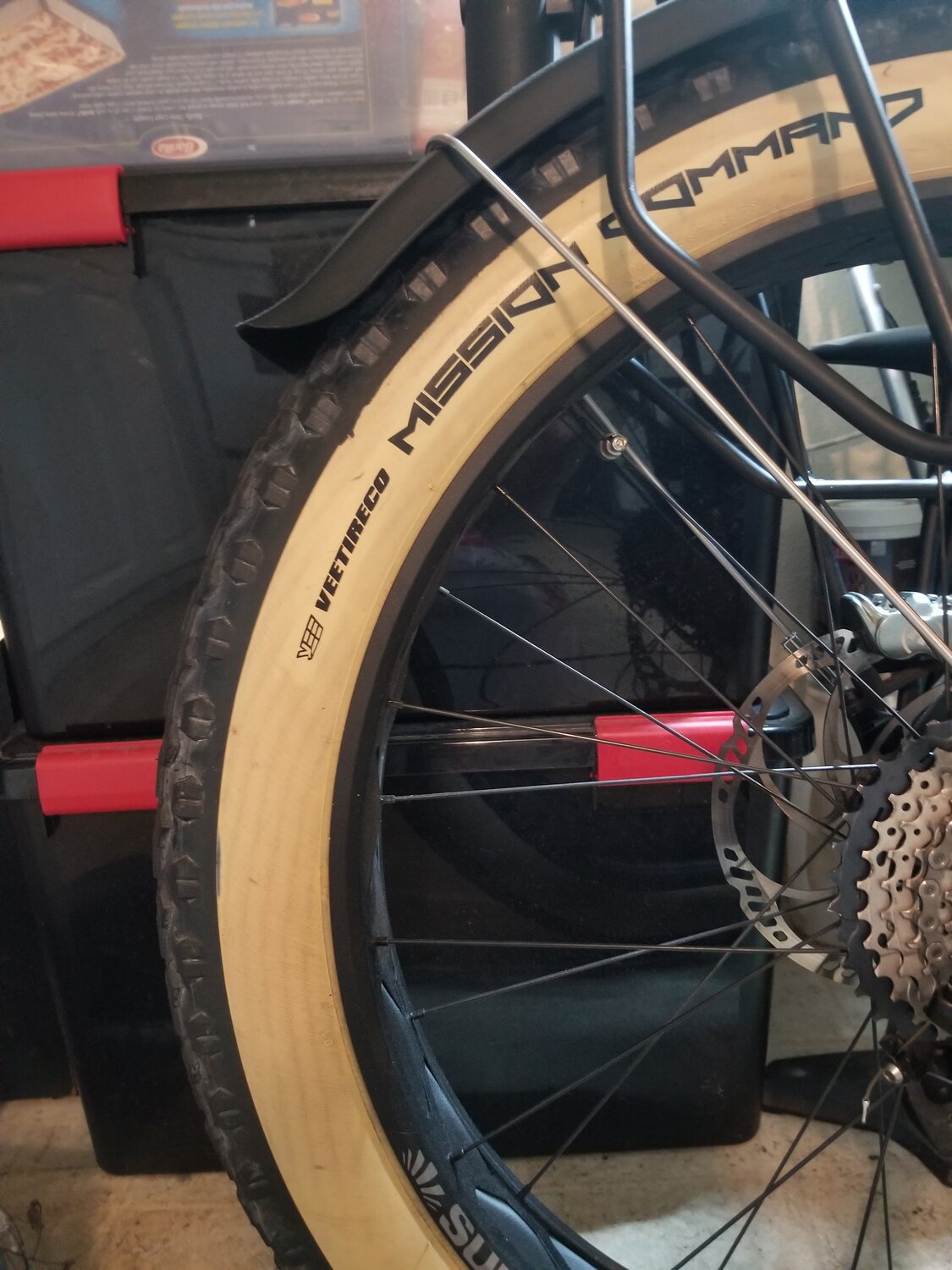

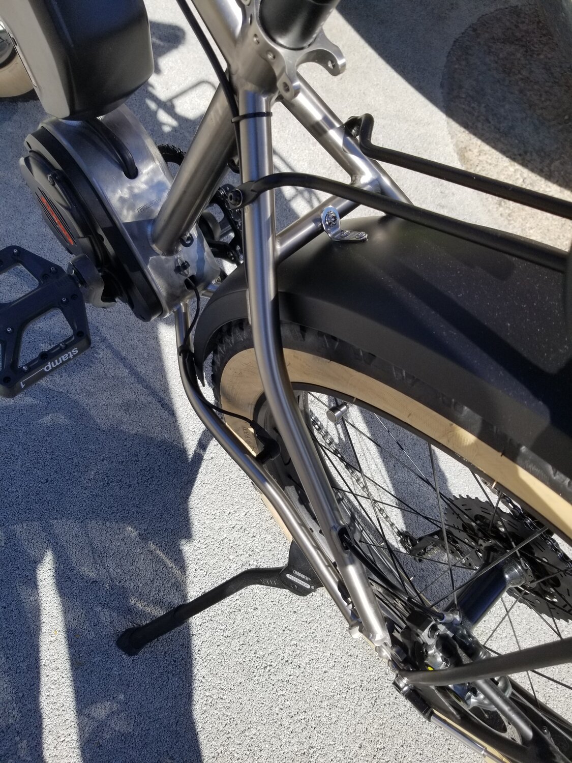

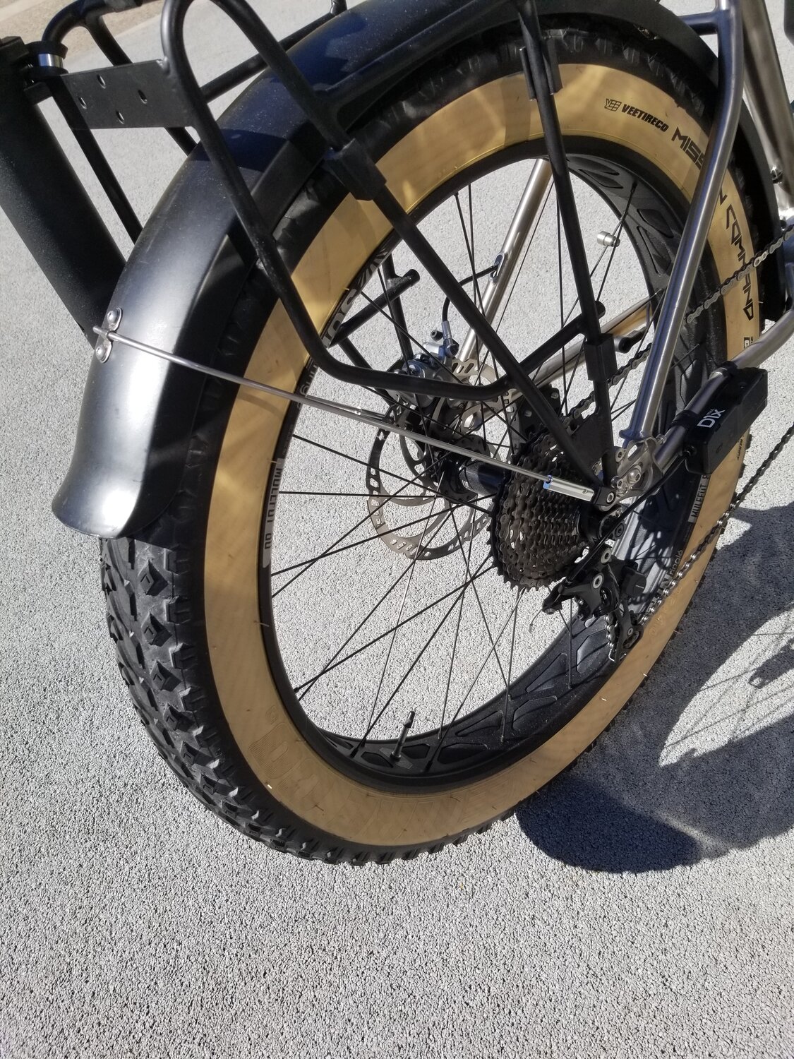

So 'losing it' - from making the same mistake again and again - I hacked 7" off and eliminated the 😱chain cut-out.
On 12mile shake down cruise my chain never touched fender. I have 0.425 (min.) clearance in the largest gear.
While I could cut the area out - even leave a tab at the end to fasten the right side - if there's a reason too, I can't see it.
Eliminated: one SS fender stay (& it's fasteners); the entire Axiom's steel extension bracket assembly; the SKS 'multi-stay' clip & SS fasteners.
I weighed 205gms 😲 more before than after, not including the 7" of SKS plastic I trashed without weighing.

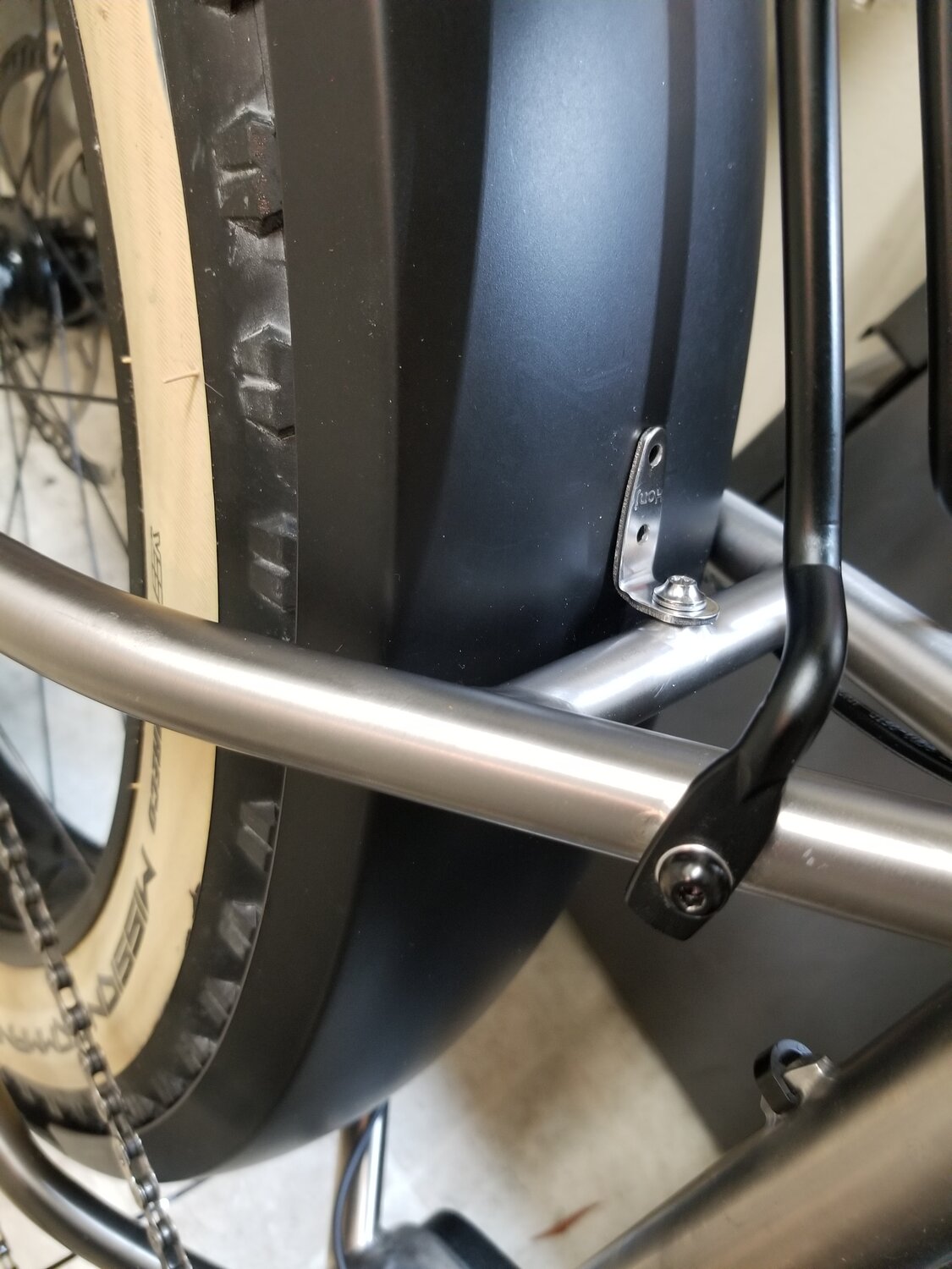

The Portland Design Works alloy safety tabs are light, w/ improved adjustment length.
The screw lock's a better design and they have a bend point for side-to-side angle flex built into the plastic part.
I've ordered a few more to install on the front and have a couple spares on hand. So far I'm impressed. They don't brag their stuff up enough.
For the seat stay bridge fender mount I used a Honjo fastener w/ it's brass backing plate.
It feels (and weighs) like a Snap-On tool. The chrome's deep and it's beautifully crafted, but (1) using washers, the fender bolts are too short for thicker plastic fenders, (2) the nuts supplied reduce clearance, and (3), on the inside, neither the nuts nor washers fit the concave curvature of the plate.
Hey. Maybe 💡tap the plate's holes and dump the nuts ? Such a Loctite fan, what do I know ? One thing's titanium fasteners are 55% steel wt.

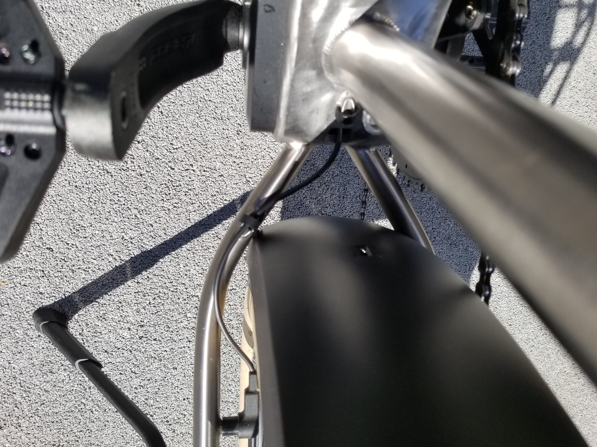

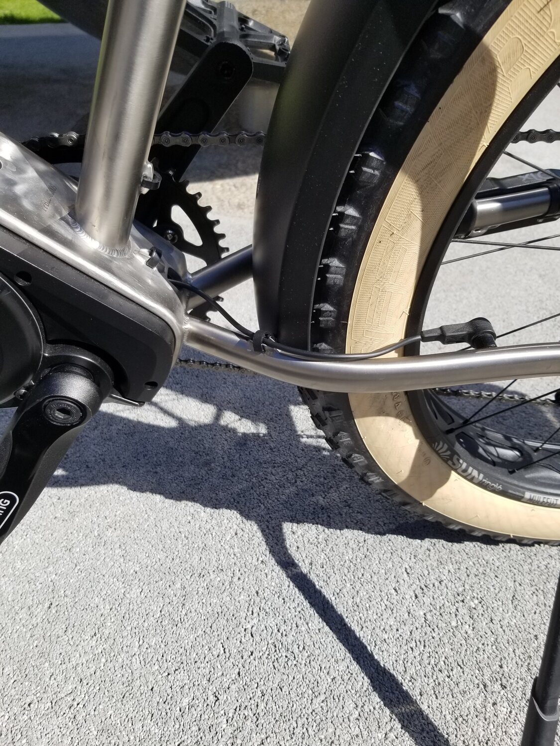

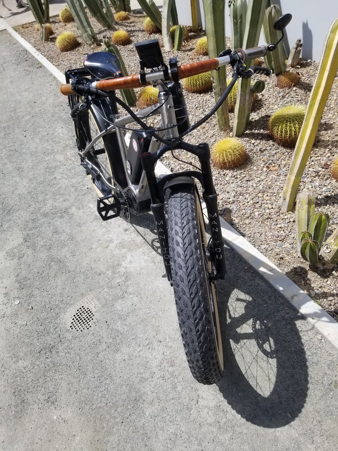

Now, fender is firmly attached to the chain-stay w/ no 'buzz', resonate/ rattles.
By offsetting fender attachment holes at the bottom (virtually invisible), zip-ties can attach at the chain stay's 'braze on' 'cable/ wiring fastener' (innermost) points. WARNING. You try this, better have a geometrical 'minds eye', measuring and visualizing over and over before boring holes. Maybe it's just me. Mia Culpa, I'm new at this, but my fender aligned dead-on; the zips were tightened, the accurately drilled holes were correct and it snugged up tightly without any 'deforming'.
Awaiting 3mm and 5mm silicone (insulation) for fender contact points, to finish the job - no slip/ vibration.
I could get weird and calculate the sonic vibration potential over non-suspended area of ABS; come up with some hard facts - and nobody'd care.
Better pedantic: Harmonic frequencies resonate between (firmly attached) points - and not beyond.
That statement (published and reviewed) accompanies a sum, parameters and (attenuation) limits for alloy ... not for plastic which given the variations in composite reinforcements would be intellectually honest to do so.
Suffice: My rear fenders are quieter than the wires slapping.

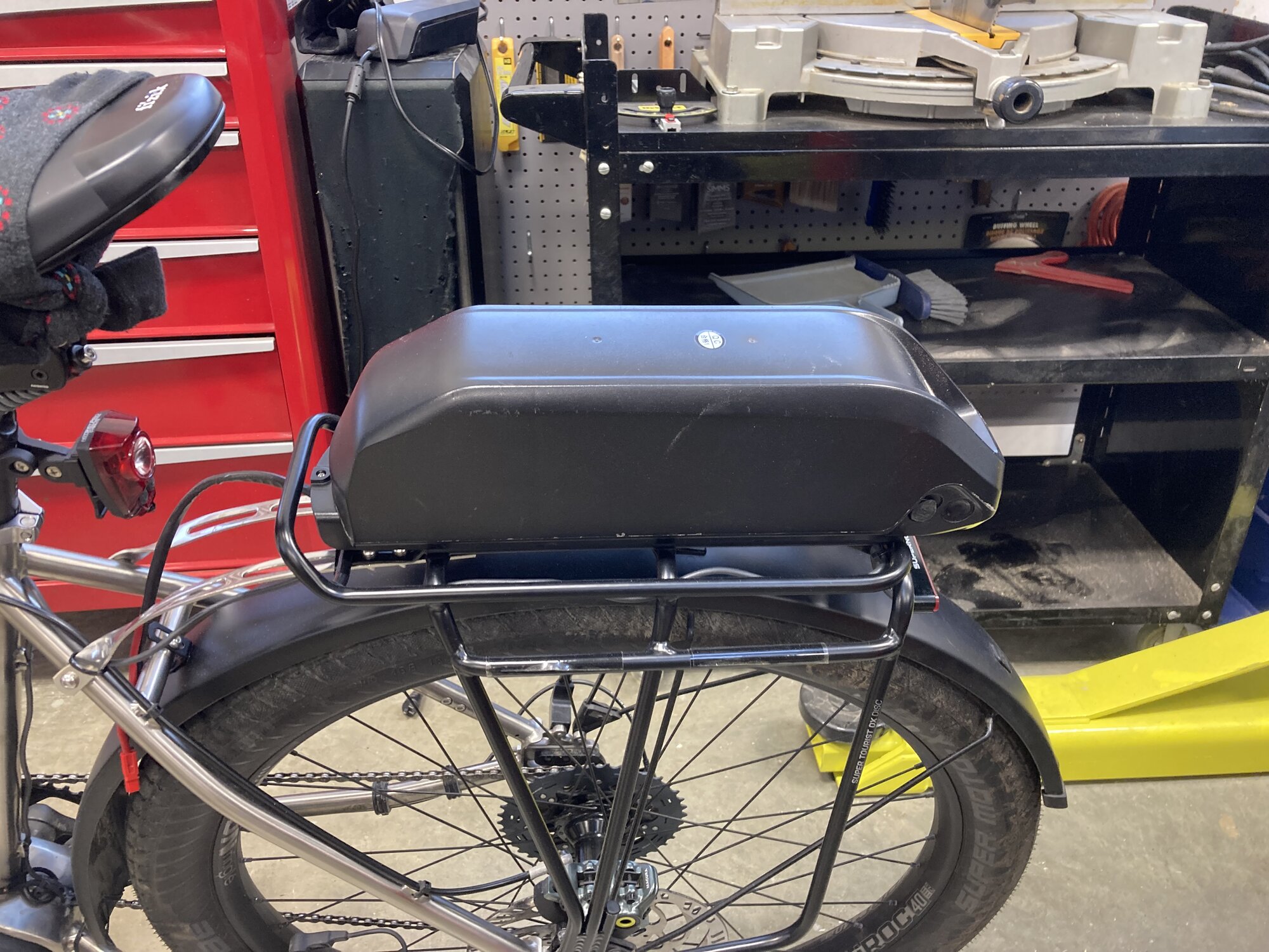

Axiom rack's now moved back/ and lowered about 1" respectively.
Whereas it was 'the last hole on the rack set to the first hole on the frame', it's now 'the first hole on the rack to the last hole on frame'.
Both sides of fender are fully elegantly attached.

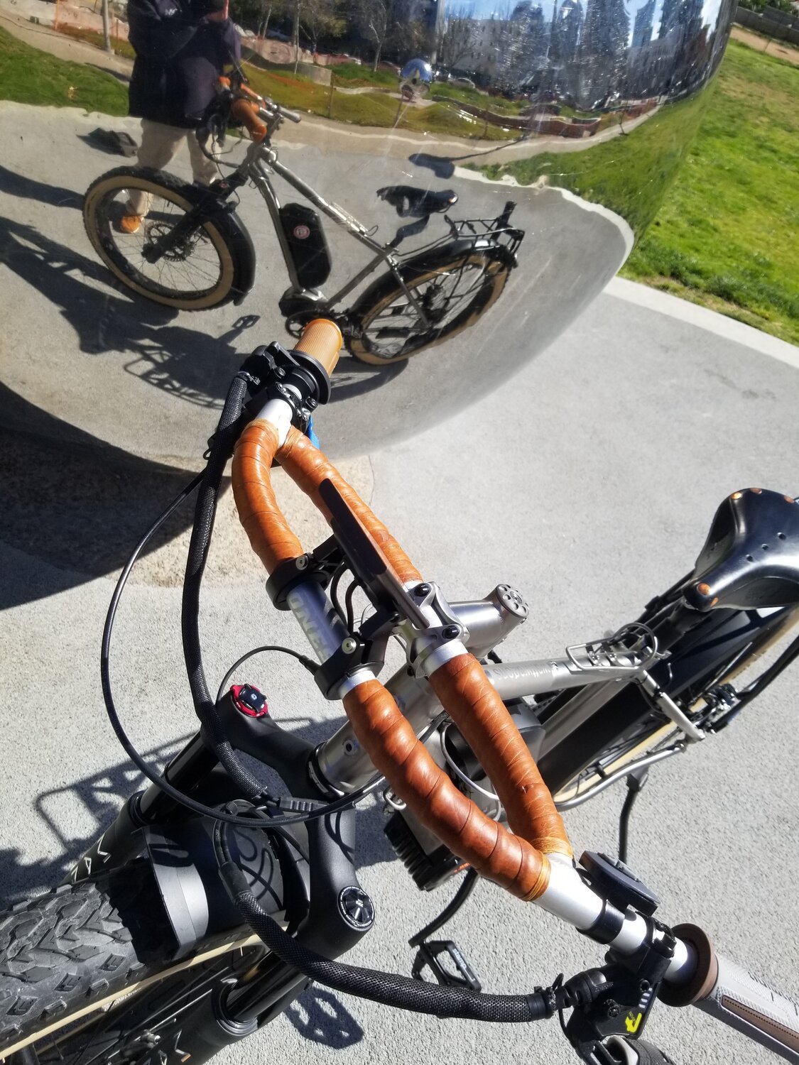

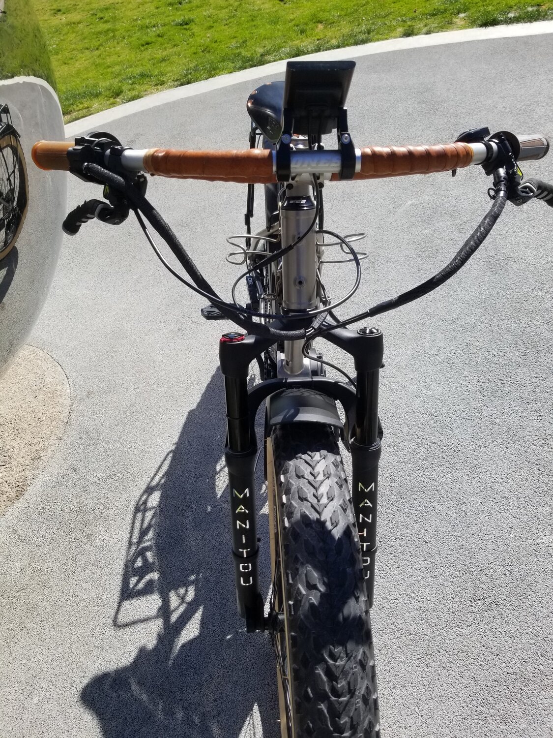

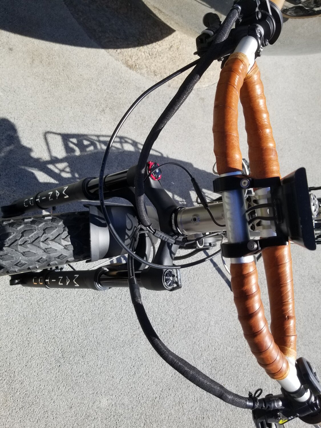

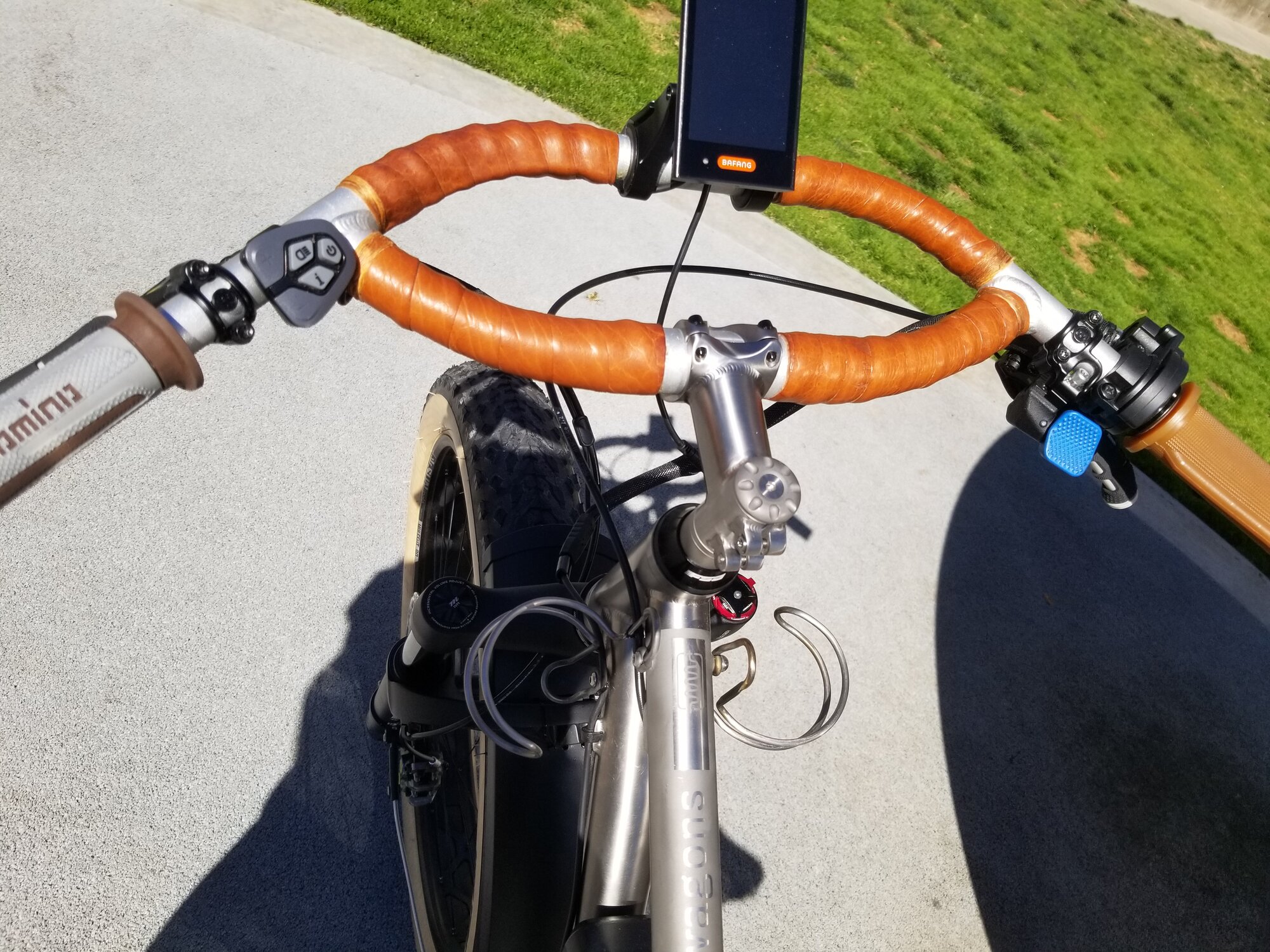

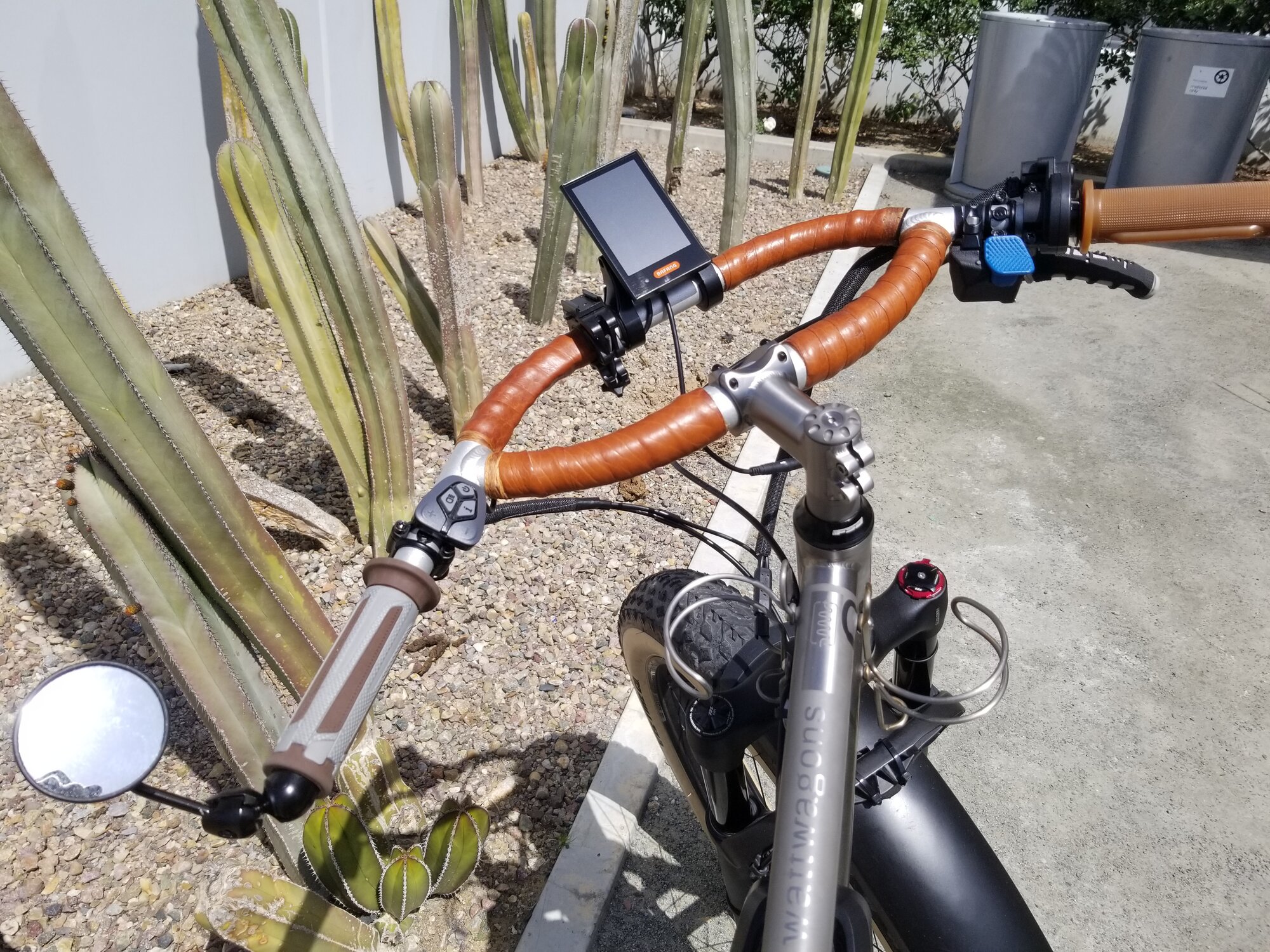

Wrapping Leh's 'Distressed Bison' on the Jones' bar's grip-points.
Still lighter than stock Moloko's - or my choice of ti bars 🤪. I'd recommend self-installing only to those (w/ 'gorilla-grip' hands and) with experience in leatherwork. Seamanship cred, like 'wrapping harpoons' is also a plus !!!
Regardless videos, I cheated using contact cement under the starting wrap points.
I imagine (what this stuff's made for) wrapping bicycle drop bars is much easier. I don't get to use end plugs 😢 and have four sections that need to be tight, to muscle the WW around.
I hid the display switch wires under the left, front wrap - the plan from the outset.
Wiring/ hydraulics' are right where I want them.

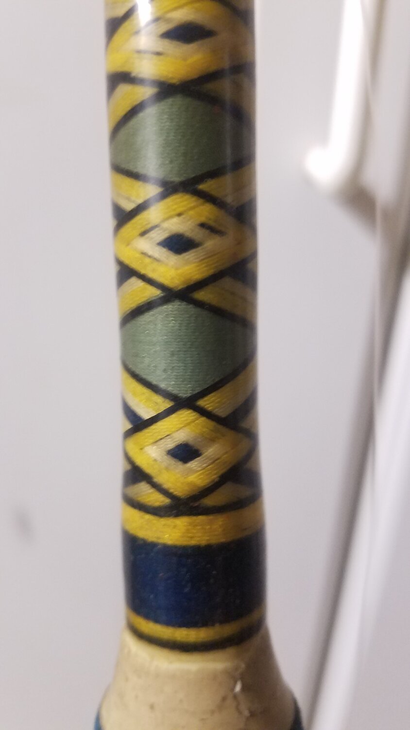

Thanks !! A pursuit that keeps my mind active - it beats Sudoku and is less risk or stressful than derivatives day-trading.
Never imagined the vintage look of Earth-tones on raw metal. I just saw silver/ grey.
(It being October in Boston) WattWagons had 5.5" snow-meats scheduled. I requested a little narrower - sand being my max conditions.
They offered the Gum-walls (from a past build experience) & recommending the look.
Trusting the WattWagons crew - *FN1 - to create with free license, I said 'Yes, why not?'
Some flaws in one side of the distressed Bison Hide, I informed Leh - another fine American Company, down Texas' way.
The proprietor responded they were immediately sending an entire new set.

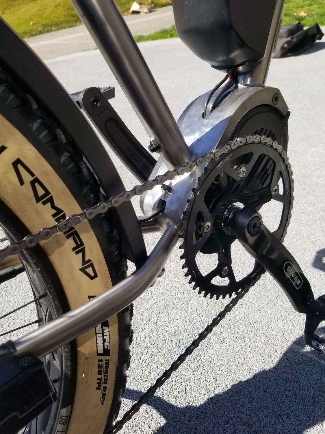

Other improvements contemplated: upgrading to a 52T ring gear. We'll see after the programming cables are in.
A USB output from the battery. I have the micro modules. Where to mount it?
Left side bar-end mirror, probably a 60mm Oberon Streetfighter (w/ lightening holes drilled in the billet and 3/4 of the 'collet's' bulk cut completely off).

Rome, the Q factor is the distance between the two pedals on a bike. On an ebike the closer the pedals are to each other the better.
On my UC Pro the Q factor is huge, with the addition of Bafang Fat bike dished spider and crank arms.
I was using clip-less pedals (Shimano), but the wide Q factor was causing knee and hip pain, so I've gone back to flat pedals, which work just fine.
F&F, I did go with the 48t front ring, because Pushkar advised against going larger. I would have preferred a 50t ring, though. Let us know how the 50t works out for you.
The 50T is awesome. A 52 will be even better and from what I see on other machines, the derailleur angle should still be within limitations using the stock (136 link ???) chain in low (40t) gear, but running a cassette geared bigger than 40t I think would require an additional link set.
Rather than splice one link in, adding a whole new section (completely replacing the present spliced in extension) a link longer.
Drawback, you'll waste a new chain creating the new length extension. Turns into a big plus when your chain wears out and you have enough spare to replace 6 more chains. I'm thinking the chain and DT components are fine - so far, closing on 500miles. Learning curve shifting where there's never a crunch - w/ the Archer - takes focus and practice to perfect. 'Second Nature' shifting ability is elusive.

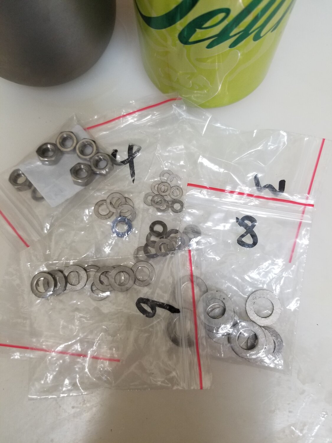

These titanium washers are a must for good seating and corrosion resistance from Electrolysis.
SS washers on Titanium fasteners'll rust and rot out.
Same's true with your nuts. No weak (valance) nuts allowed.
These titanium nuts work for me.
Knowing the size of your bolt's shaft, 'washer' size is easily dialed in.
Size and mass of the nuts is very important. The length and pitch - designating depth and speed of penetration - dictate the thickness required for pounding forces that can get brutal !!! While for more gentle part's banging applications, less mass or depth of insert to the nuts is required.
Hope this helps !!!
Fn'F
Here's one reliable company: reasonably priced Titanium nuts and washers
And this is who I buy my ti washers from. Again very reliable.
Spend a Benjamin, you'll get all you need and spares for days.
Remember, ti washers crush more than steel. So, keep a bit light on torque. Putting a fastener on forever, best there is.

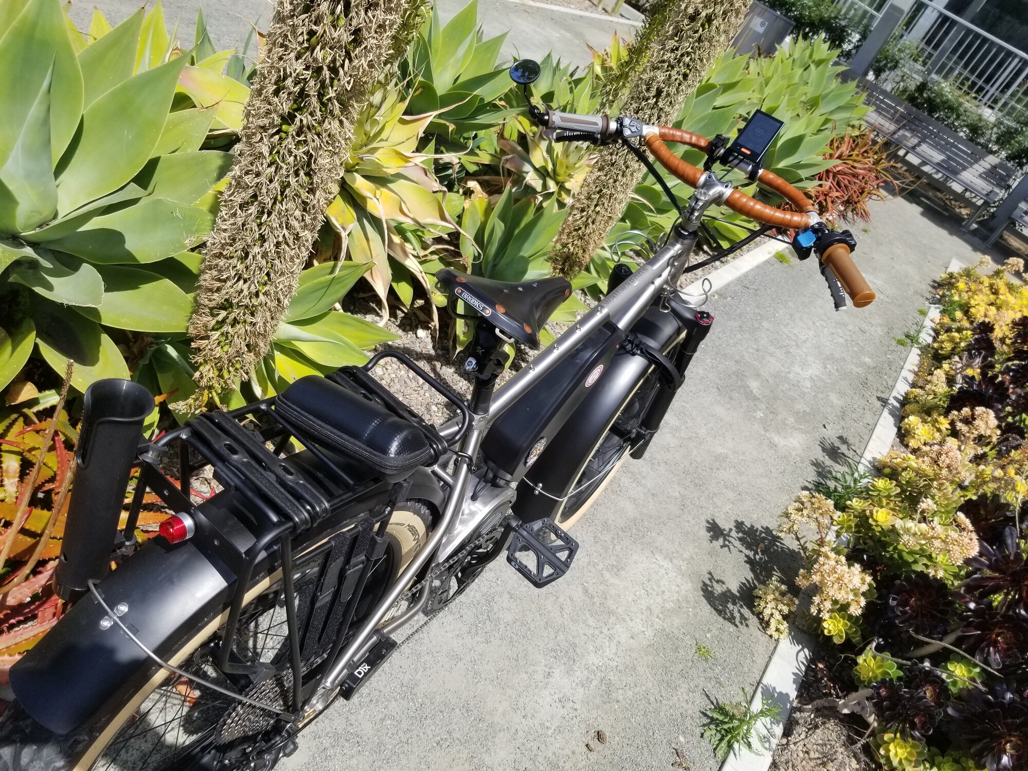

Fenders, rack and stays are now proper. Silicone pads under fittings, zero rattles or vibration. WOW this bike is quiet !!! Alerted me to some 'cable slap' chatter (fixed). Now I only hear the whirring Ultra. I was so fanatical about reaching that quiet place, even my bungies don't slap.
Black alloy PDW clips and reinforced plastic (fork) 'C' fasteners + all ti bolts and washers - atill have a few nuts to replace.
Overriding rules: Lighter than before, always Stronger and Faster has followed. How you like the wire cages now, eh?
A fun Journey building the perfect beast.

Hey Rome, here's the source for titanium nuts and bolts: best price for ti fasteners.
I spend $100 on roughly $1000 of titanium (from European resellers selling the same product).
Just ordered a double up cuz Western (USA included) bloc will soon stop such 'Consumer Level' imports - to keep their businessmen's money rolling in. Thinking ahead; standard sizes; stock up. I'm set.
My next build could well be a 55lb (titanium framed) 1000 -- 1500w, 125n.m. Hub-drive.
My 53lb Alloy, Hub Drive w/ 100n.m. roasting 1000watts is pretty hot. I'm so over hidden batteries.

I ordered without lights and there's a 'snipped' cable at the splitter junction.
View attachment 151819 Haven't tested those (short as hell) leads yet. Not one to bother WW (or anyone) with queries if I can test and find out.
Would be useful to have a USB charging port in my circuit.

* My CT is frontal weight-biased. The center of gravity (slightly abaft of the frame's center, right at the motor base) was neutral using alloy Loop Bars. Just adding Buffalo hide wraps and moving the display out front altered that and actually made my handling at very low speeds a bit better. It's noticeably different to me - likely because of my 140lb weight with bike stripped down to > 62lbs. Average rider's being 180lb x 72lbs. I know the feel of that difference on shopping day. lol
Amazed how small changes make such noticeable differences in the feel, this bike's cockpit feels a bit long to me. Could be my bar ends are a little too high. I note (photos) WW's Moloko's angle is rather a lot.

is that the 48V 17.5Ah battery? Did you get one or two?
I wanted two batteries, but I didn't realize WW was going to mount the second battery on the top tube, which would make it impossible for me to step forward off the pedals, so I ended up taking off the battery and mounting plate.
With my bike/rear rack the mounting plate fits perfectly. It's almost like the rack was made so the mounting plate would fit. I plan, if I end up keeping the bike, to install the mounting plate on the rear rack, so I can carry the extra battery on the rack. It would even be locked in place.
So far I've only had one ride (110km) where I need more than one battery, but I'd like to do more longer rides in the future.
Presently, my Archer shifter is just sitting my bike parts drawer(s). I may put it on the UC Pro this winter.
Show a pic of that rack for me?
