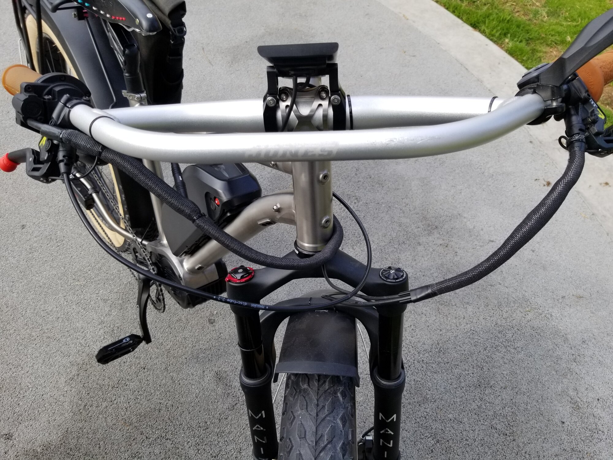

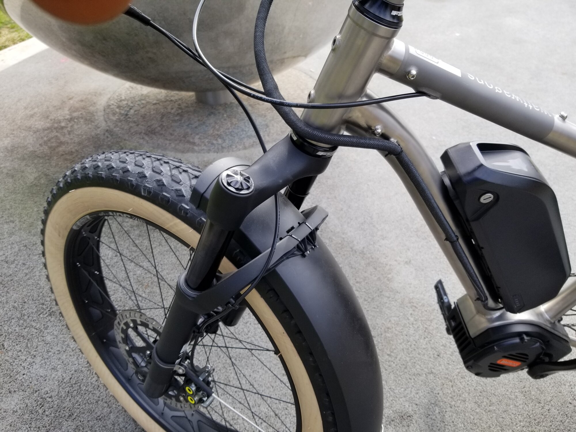

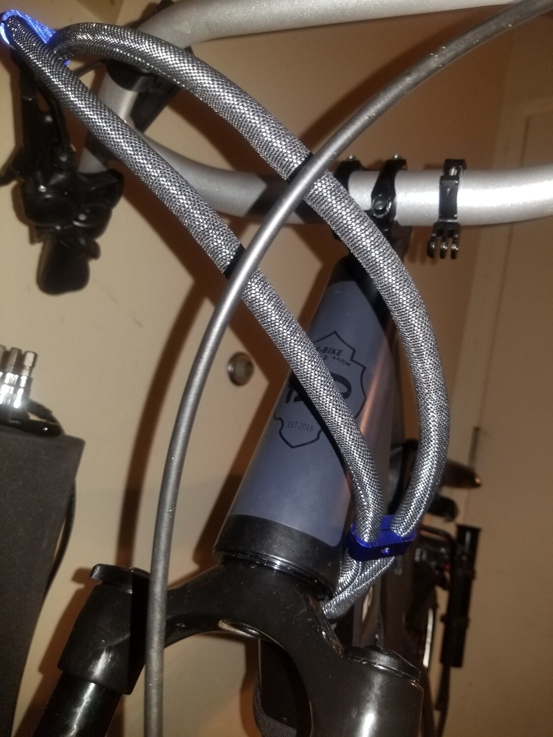

By the way. In my experience, that spiral wrap is terrible stuff that can damage wiring.
The illusion of it 'protecting' often leads hard edges cutting right between the spirals. Like in a frame entry point.
I must say - with some experience - the wiring WW is using is top quality. My other machine is lesser grade and more susceptible to stretching.
Installing and removing spiral is brutal on the wires. A lot of stretch involved as wires wrap around each other when spiral is wound.
But that's not what's the big problem. It's wasted productivity/ time and frustration, repetitively doing, undoing and redoing a manual job.
Spiral is the wrong material. We require split weave. This is my favorite for the task.
has been a favorite of mine for longer than eBikes have. Easy access to wiring, it zips right off and takes a couple minutes to zip back on - perfectly. 20 times in the time it takes to just remove a spiral once. I'm using 3/8's to cover shifter cable, rear brake line and eight 22awg wires.
3/16ths will cover most stuff.
https://www.wirecare.com/interest/a...neral-wire-protection-finishing/f6-woven-wrap

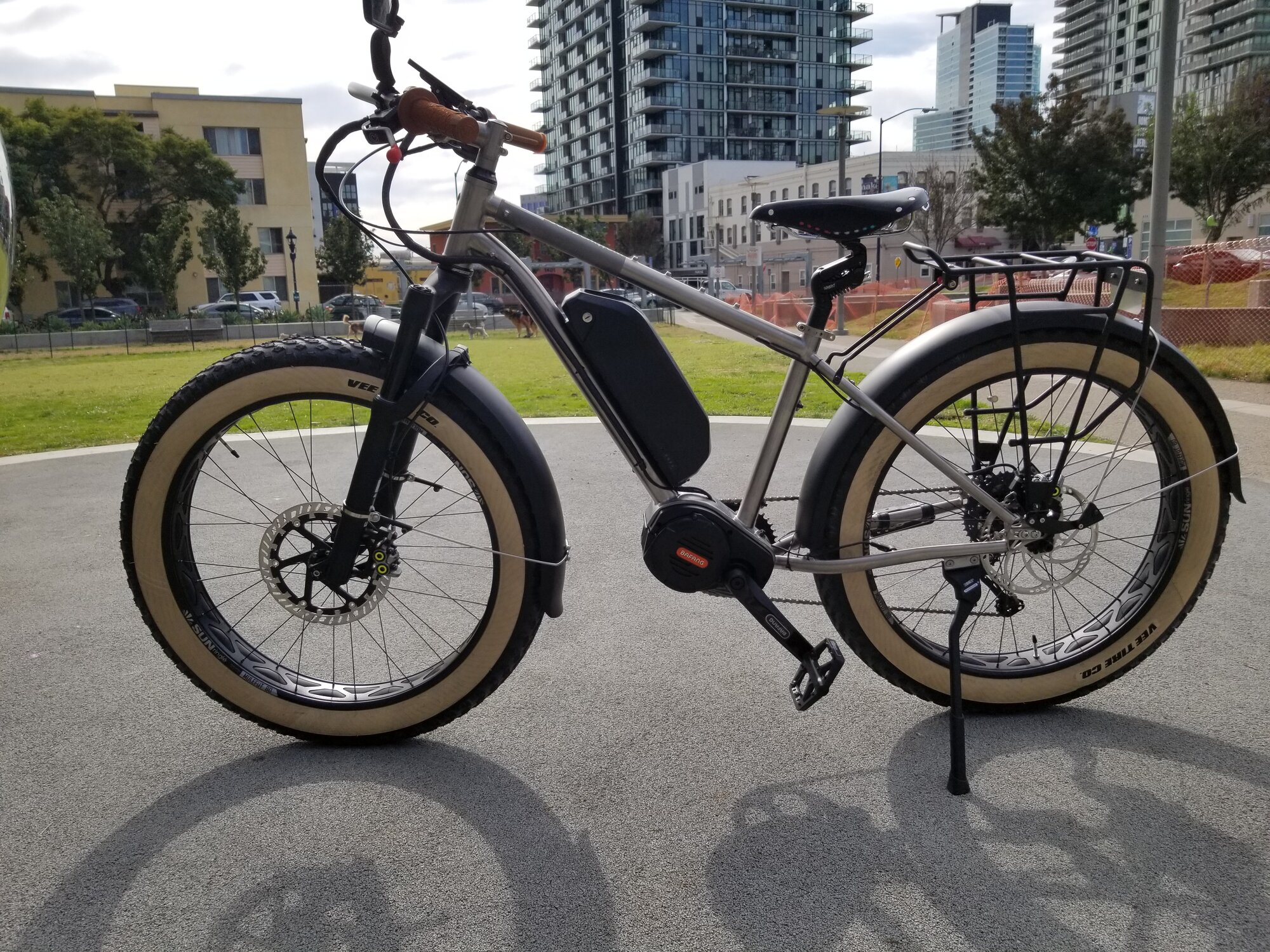

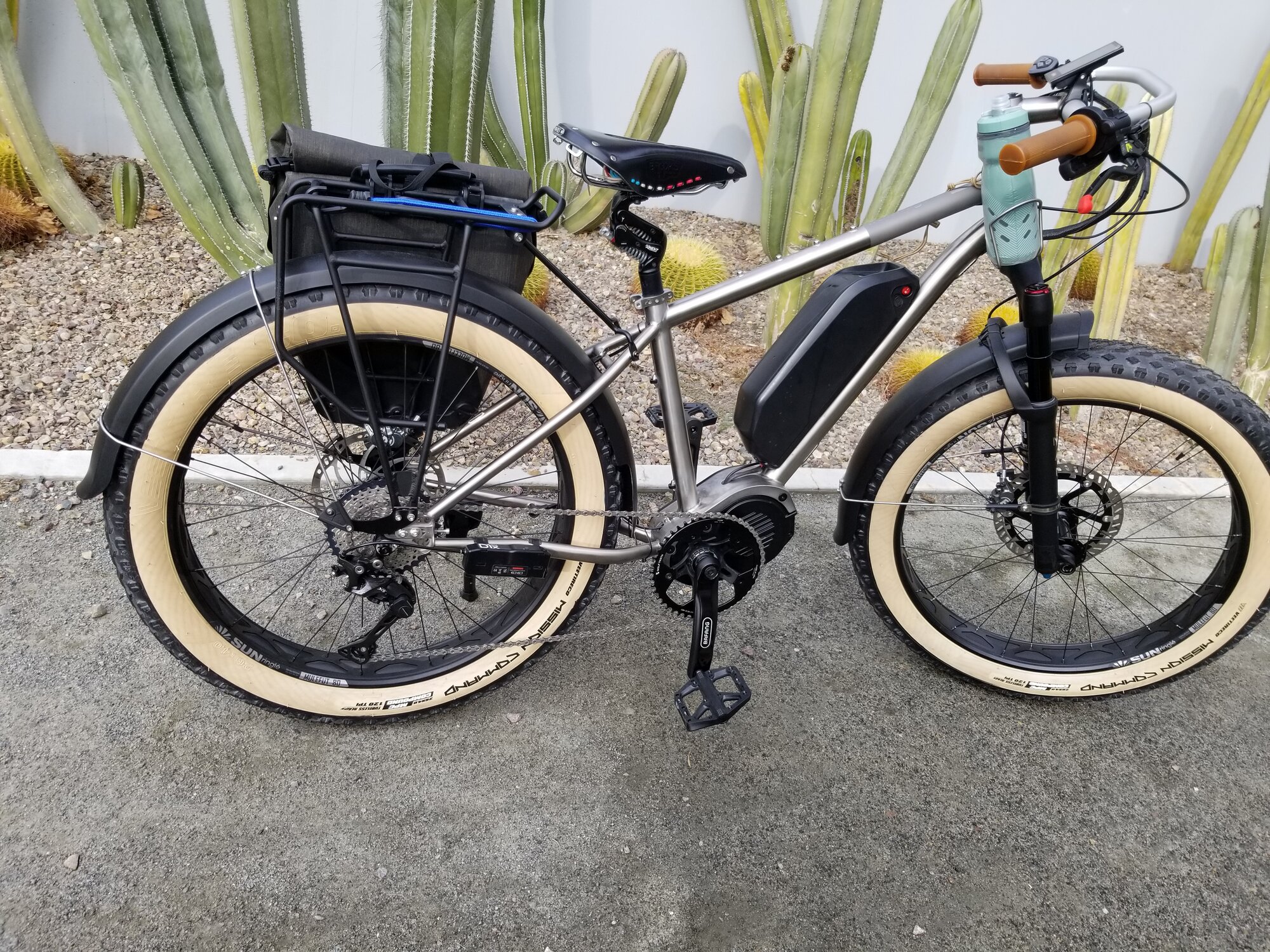

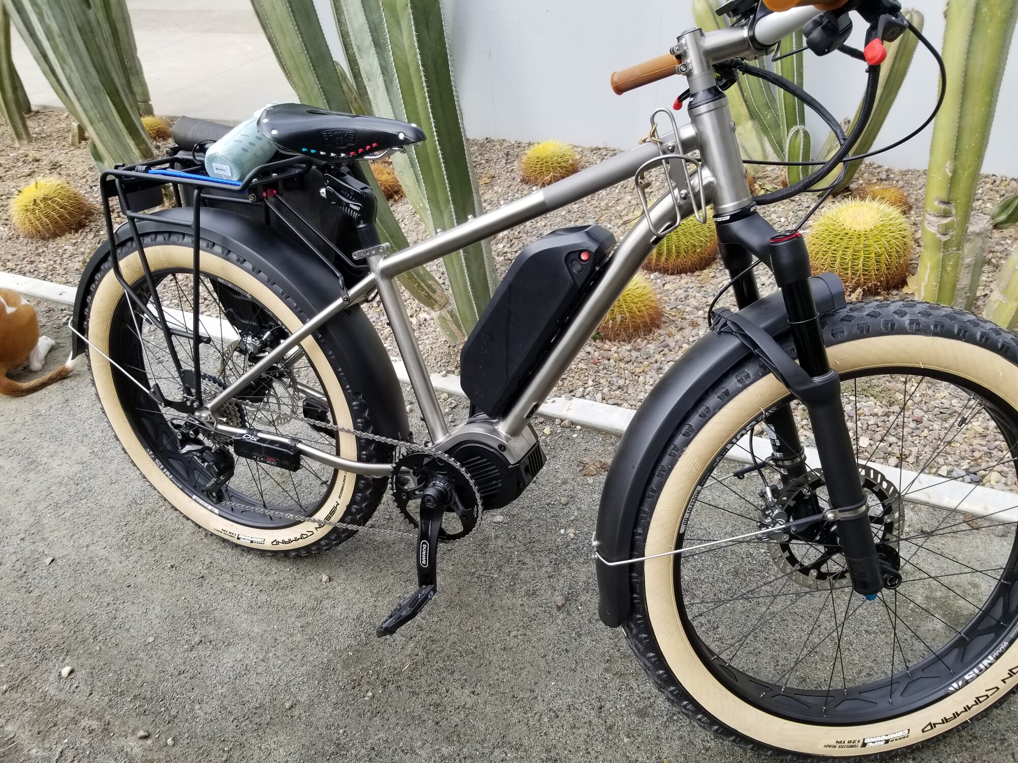

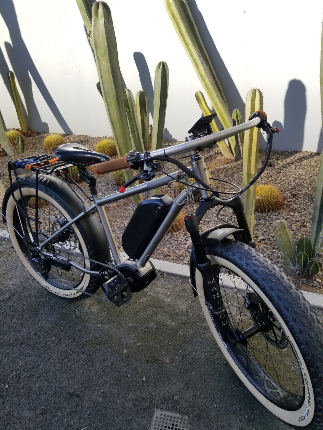

Out for a 10miler. Bike is amazing. I feel like a kid again. Staying in Eco L1. I stand up and crank up a major two-block hill ! Second childhood - no doubt. The most fun and best eBike workout I can remember. Yes, that good.
Transitioning through tight 'S' turns, I feel the tire carcass shift, front and rear - not quite at the same time.
Bike bumps, then locks right in, tracking down the new angle.
Oversteer transition? Weak sidewalls? Are my tires are too low pressure?
I went down to 15lbs to check out the 'comfort effect'. Boing, boing. Getting confused about contrary infor for Vee MC 4.0's.
20lbs seemed hard, but I didn't test on 'slalom course'.

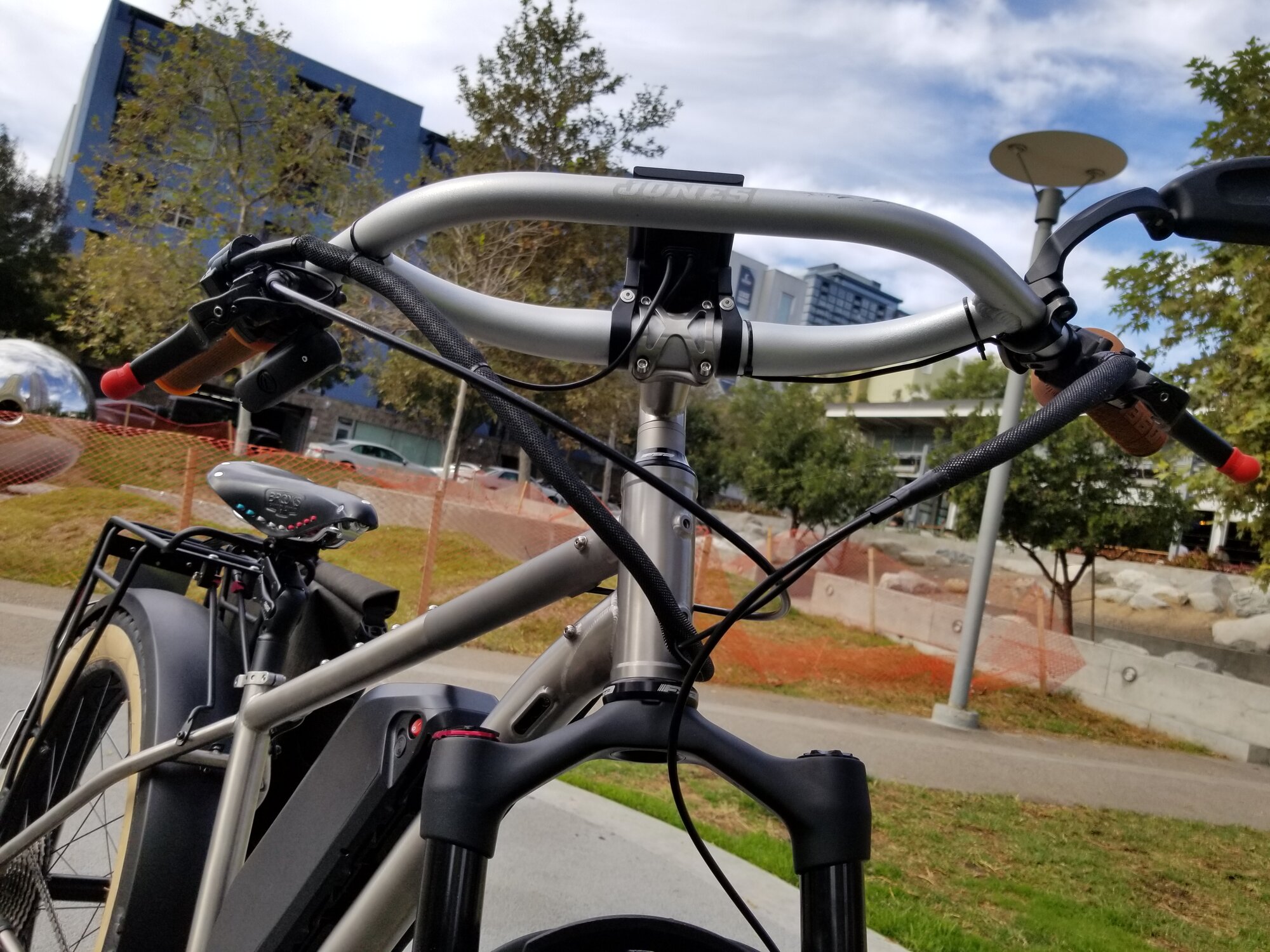

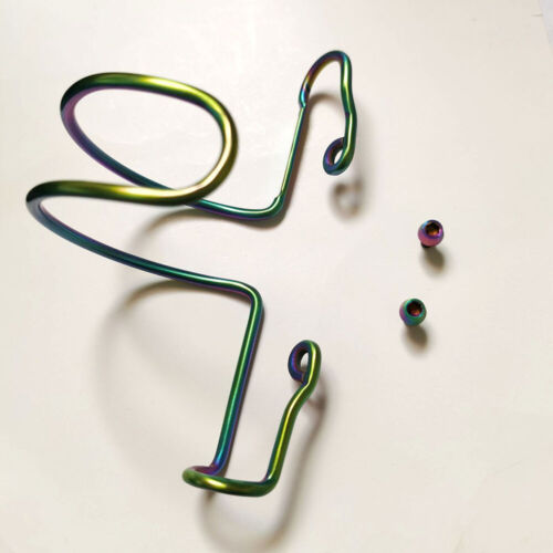

Wiring is fine for the moment. Pretty much finished replacing bolts with ti. titanium Waterbottle Cage.
I have a couple sets in Black and in Rainbow. Also, I'm changing the head set bolts to black.
Anyone know what's up with those two large screw holes in the headtube?
I was mistaken. The shifter placement is off, one notch outboard (since corrected).

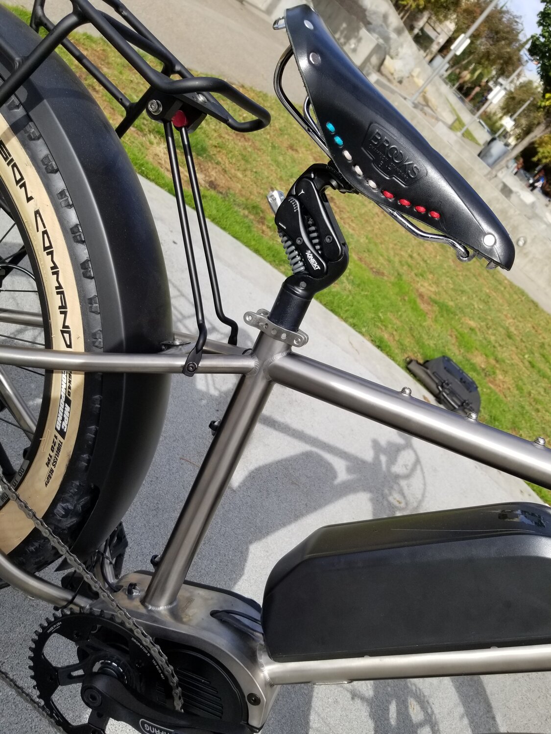

In person, the lines are quite swoopy. Kickstand/ bottom Rack Bracket are still (appropriately) SS bolts.
I'm no fan of that mirror. Need small round type.
I using one of Domino's soft grips on my left, and the Daytona on the throttle.
I installed the adjuster and custom spring-set. KINEKT's dialed in. Ti clamps and small stuff, like black ti bolts on rack extender arms.

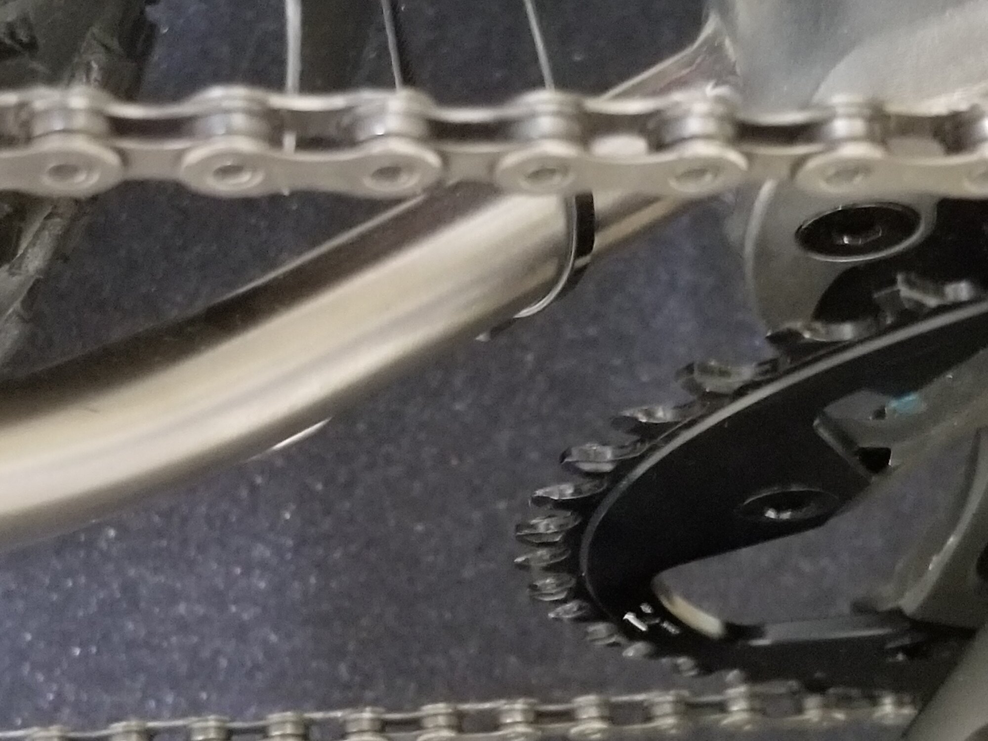

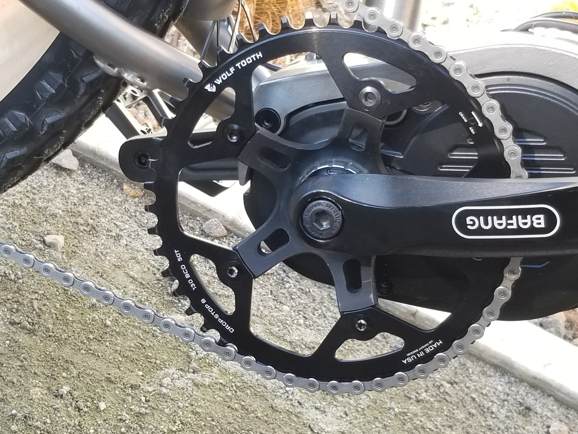

Right now I'm seeking input on changing out the ring gear - from My present 46t, to a 50t - and info on the best chain.
I see it has two connector links - and eight (or 16, depending how you count them) links of chain between them.
If I do require another link (most likely), do I remove the eight and substituting a nine link section? Do I have to buy a new chain ?
It's a Shimano CN HG701. On very close inspection, it appears to already have damage. Not a good sign for durability. My shifts are pretty tight.
I'd prefer to take no chances. KMC; Shimano Dura Ace or Integra ?

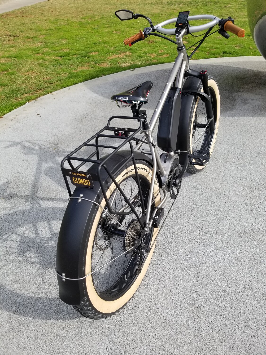

Okay. Yes I'm having fun! I wanted a bike that would push me hard - and I'd like it.

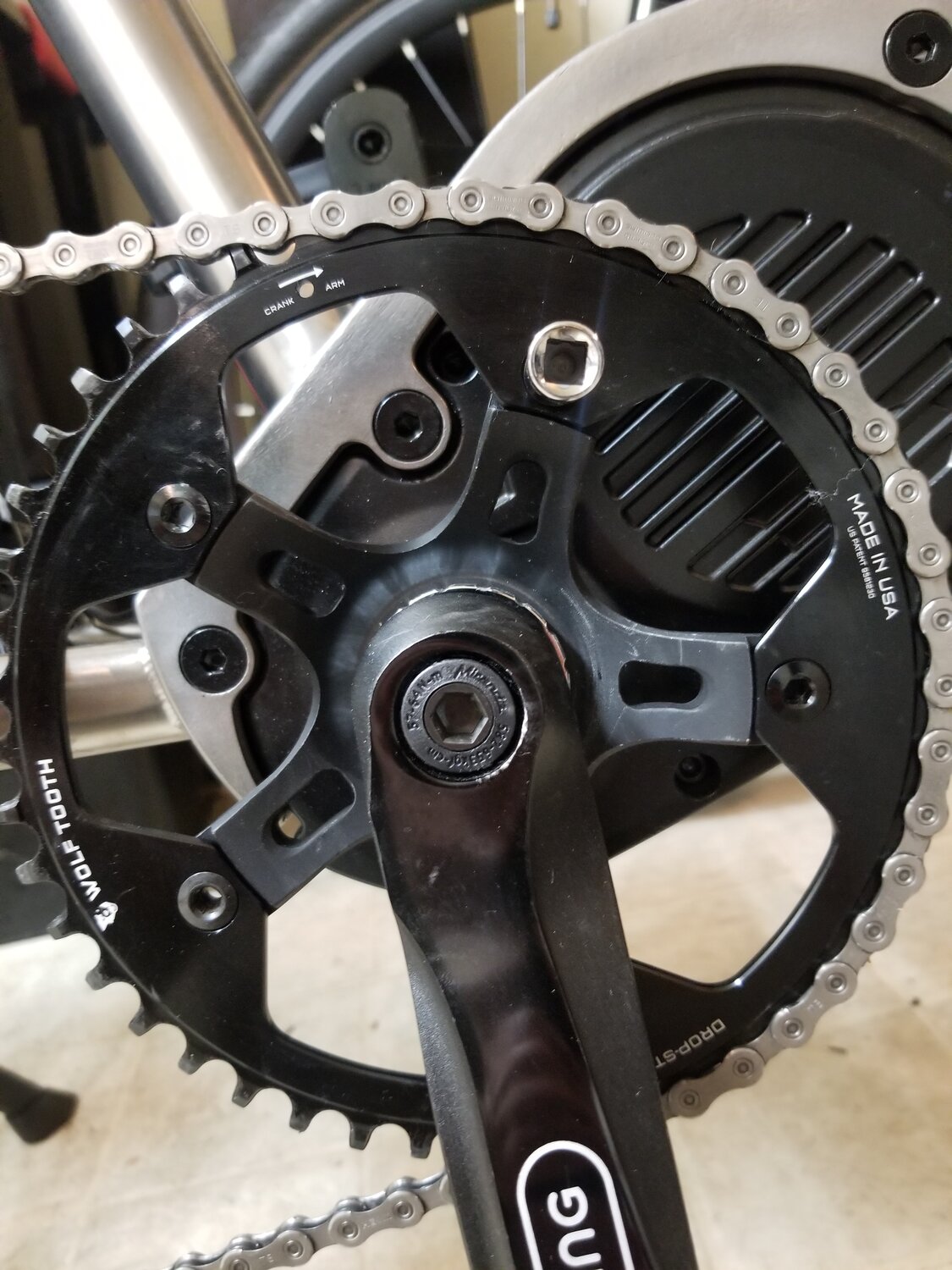

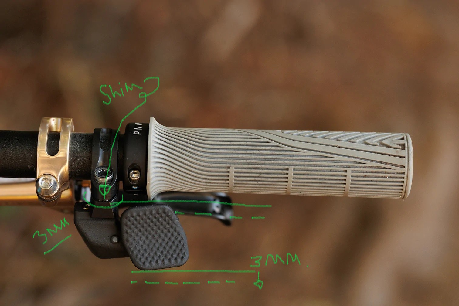

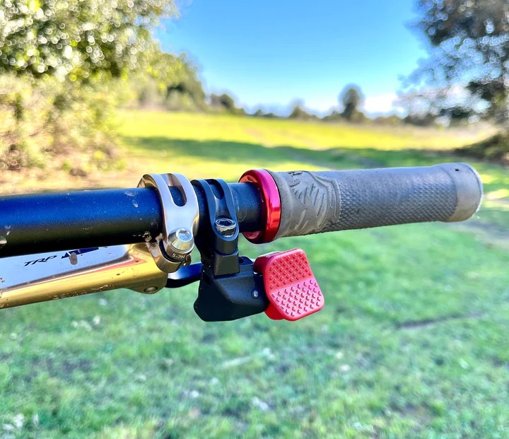

Did you see this? New paddle shifter from Archer Components.
I like it. I wish I could try the shifter and see if it fits. I've been through three matchmakers. The Magura shiftfix is the best I found, meaning it fits 'okay', placement still 1 - 2mm too high.

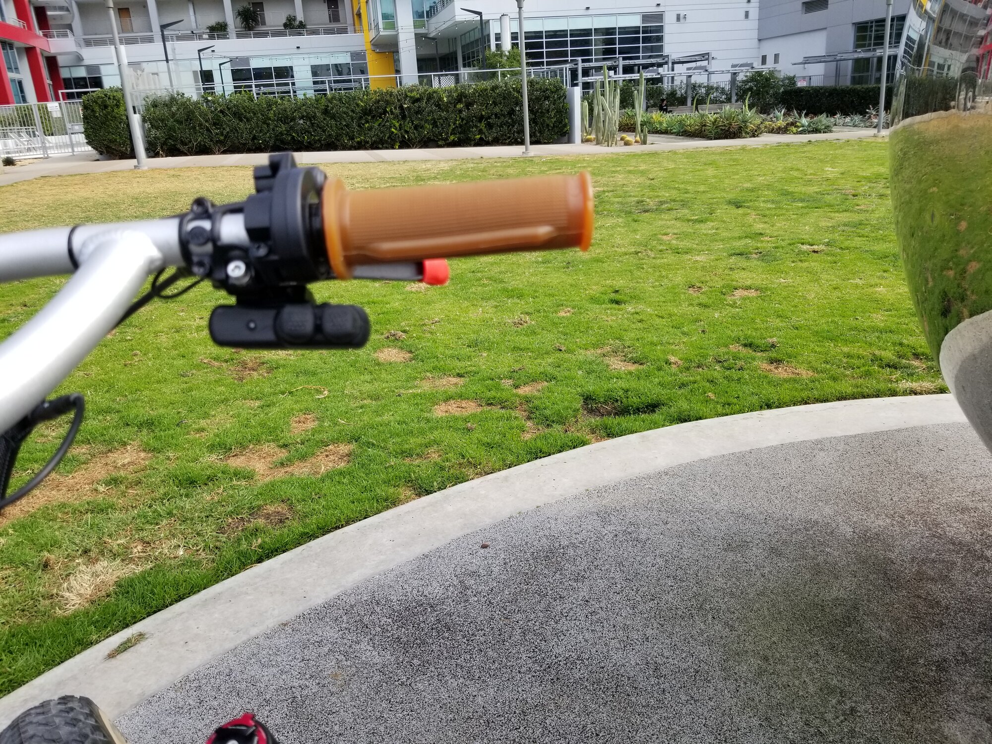

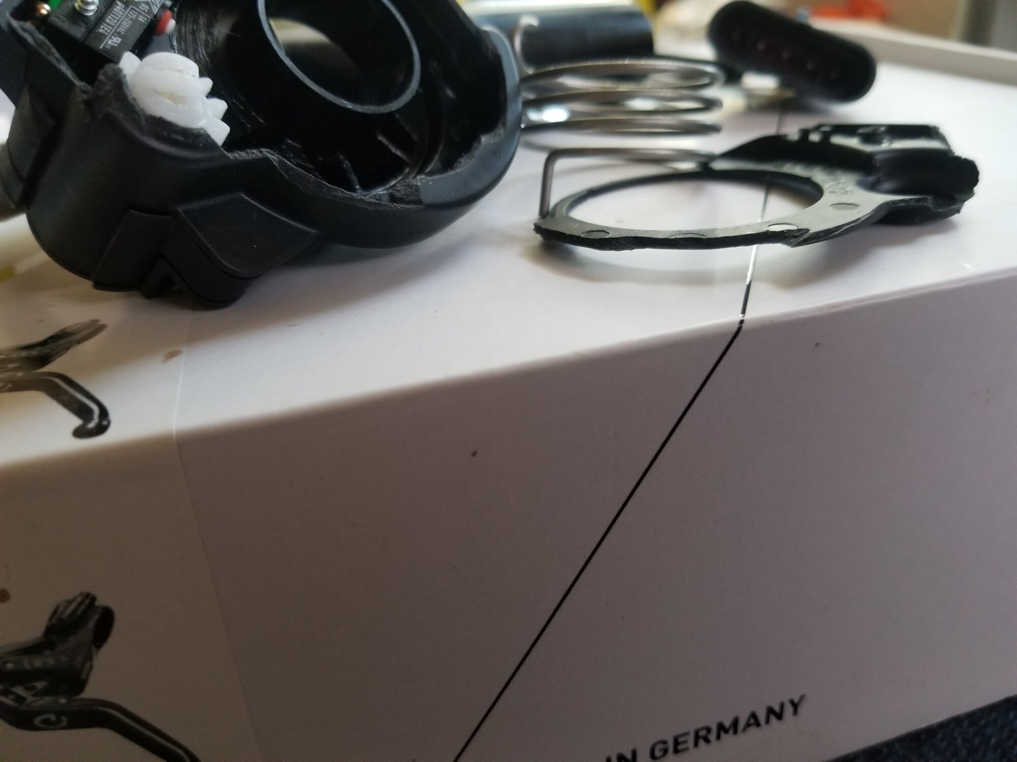

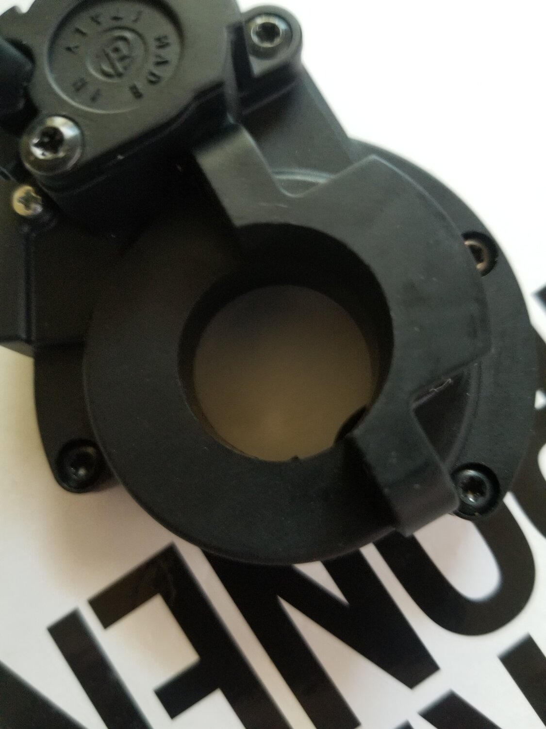

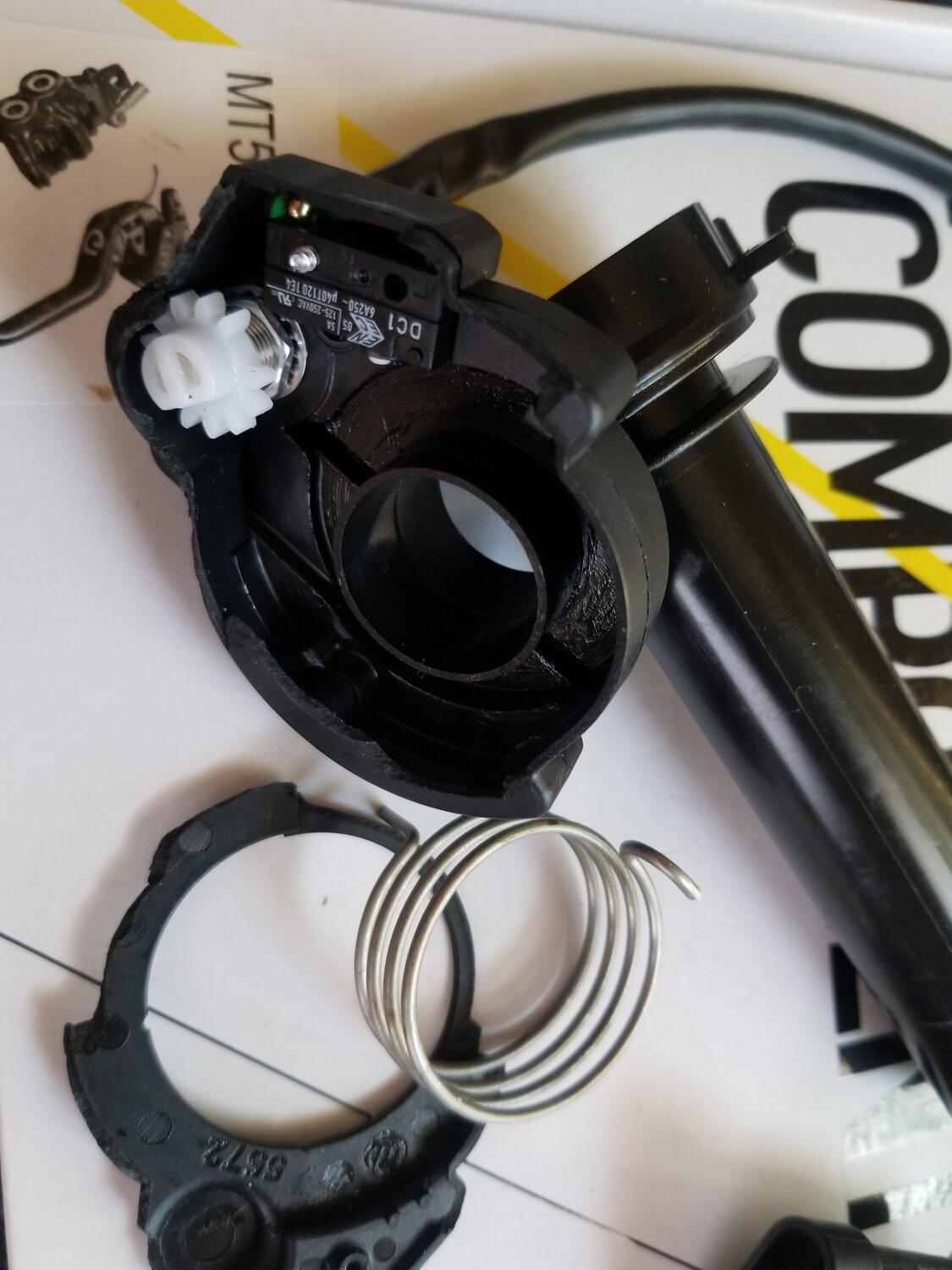

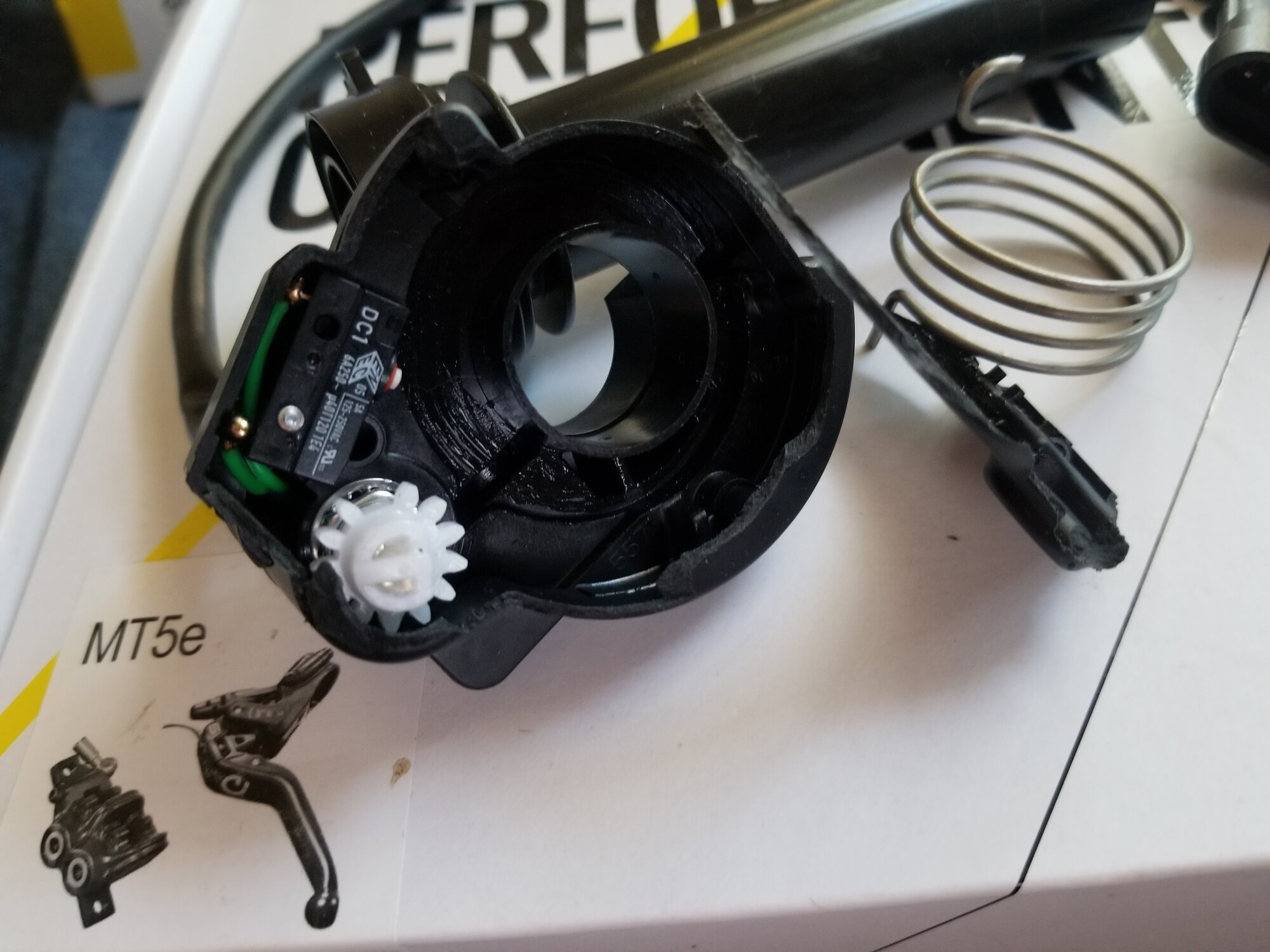

When installing a twist throttle there must be slight clearance between throttle body and any other clamp-on parts.
The pressure (esp if you tightened down the throttle first) of a clamp that's touching increases ever so slightly when you lock it down and it deforms the throttle body - best I can figure. More than once, I violated that rule, fired up the bike and the throttle was 'full on'. I tried hand engaging an disengaging to no avail.
Happened on more than one brand throttle and soon as I took the pressure off the body, throttle worked normally.
No idea if it would be a problem with the Domino.
Having the broken Domino, apart and seeing everything in there), much of the body is extraneous; useless housing; bumps cast into the body. If it was for 'more strength, they failed because the plastic is too thin in other areas.
Albeit the 'flying battery' may have hit it (possibly cracked it) the whole front blew out. My thumbnail will dig right into the thin plastic.
I won't go into the engineering fails, but if Domino really wants a place in the eBike market, I suggest they (1) completely redesign that housing for a slimmer fit (2) use a thinner cut off switch, and (3) eliminating all 'outer ring' bolt through areas (using a slotted, twist-lock interface instead, to join the two halves) - where it can be mounted with wires up, or down and fit as many matchmakers/ shifters as possible - dump all the humps and use the ONE screw next to the gear housing on the side where the wires exit (last photo, left retaining screw).
Destructive testing reveals a lot. The casting of the one half that sheared is thinner (1.2mm thick) than the other (1.5 -1.8mm thick), larger half.
Contacted Domino about a new plate. Could happen. If not I've got some cool spare parts. lol
Thanks for the alert. If the 20% sale stays on for another week, may have to buy one.
I'm a sucker for downsized components and the more I look at it, the better it look.

Went out of an 8miler night ride this eve.
Cold tires were no problem in my slalom test. No collapse of sidewall noted now. I must be a couple pounds light of air for warmer tires.
Came home beat. Beyond pumped, noodle legs.

Perhaps you can tell me why replacing the 46t with a 50t ring (both being 'WolfTooth Drop-Stop B 130BCD') would cause a problem ?
My understanding is (given the frame/ tire clearance)...
... even if I didn't add any links, at worst it'd be the largest cassette cog (the 40t) that'd be unable to access as the derailleur stretched too tight, not #11.
Am I missing something important?
Second question: Which (I believe you said, (edit) or was it Scrambler?) KMC (was your choice) chain would you run for this application?
My chain is 67 half links -134 links total - with 10 half links - 20 links - separated by quick-links).
My assumption's I need a 138 link chain. I read the KMC 138e is too thick to shift into 11t.
Got any suggestions?

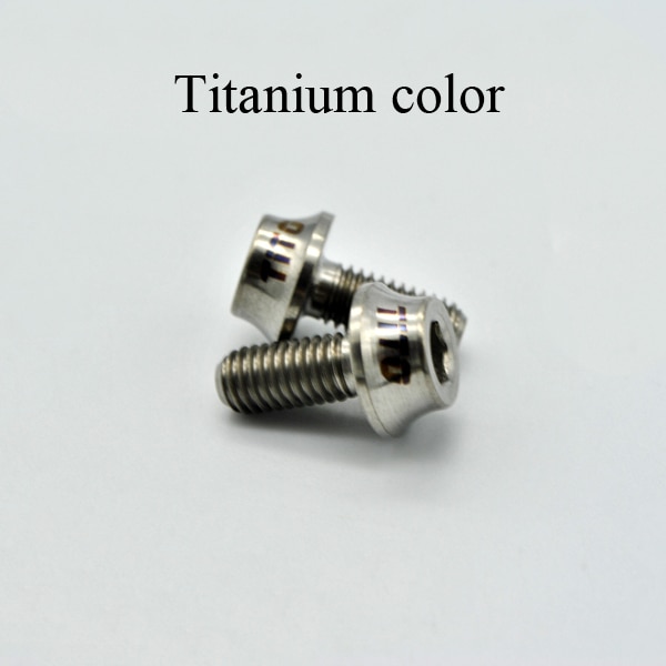

I got Titanium bolts from Acer Racing it's in the bag. I'm gonna cut it open with my Strider after a couple Russian martini.
I should not have to remove wheels to change out rotor bolts.
Be sure and use loctite. I use the 242 (24200) Blue. Say's it's 'High Temp' - 300f - and thinking 'Rotor's get hot', that worried me - until I checked and the 542 Brown Magura uses has the same 300f rating.
Looking into bicycle disc brakes temps, it came out that 'hot' means 180f. Huh?
But, but, but - those glowing rotors? Yes, nice visuals, but the brake fluid would be boiling off if the rotor was glowing. lol.
That may not be for mad-dogging down-hill on a 65lb 'bicycle', but 300f is a long way from 180f - and the MDR P rotors by design, separate the contact area from the body of the disc creating a heat sink. You judge it.
542 Brown's for hydraulics, pipes and fittings - not fasteners.
Why all the Magura rotor bolts I've seen come with 542 Brown on the threads, I just can's say.
Brown's supposed to be assembled immediately, not cured-dry on a bolt and assembled some other day. Yet the Magura rotor bolts come with Brown coated bolts, fully cured some time in the past ?
To 'glue' a bolt and nut together requires the loctite to dry while in contact with both parts. lol.
Brown get's quite brittle, so upon delayed assembly, the threads will just crunch it off and it'll leave some residue in between.
That's not how loctite works. lol.
The Blue, you can wait several hours after application to a fastener to install. But Brown fully cures in 6 minutes to 6 hours, depending on the fastener materials. For steel, it's 15 minutes.
My solution's to do-it-myself.
At the other spectrum end, I use Finish Line Ti Prep anti-seize for bottle cage, clamps - most stuff.
If you're installing ti on steel or alloy (likely since most washers are steel or alloy), it works well - and prevents electrolysis corrosion.
Don't believe Acer's hype.
By weight, ti is stronger than SS, but for the same volume, Ti is not as strong as higher end SS.
Pound for pound, alloyed titanium is the strongest metal on earth.
The frame on Gumbo is pretty massive. A 1.75" downtube. I wish I had all the 'schedule' data

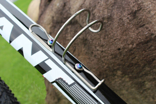

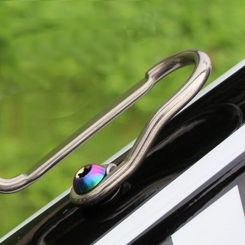

Tito also use Gr5 6AL/4V Titanium
6pcs-TiTo-M5x12mm-Bicycle-Bike-Titanium-Ti-Water-Bottle-Cage bolts.jpg_640x640.jpg
Like these sweet bottle cage bolts @ $1.36 ea.

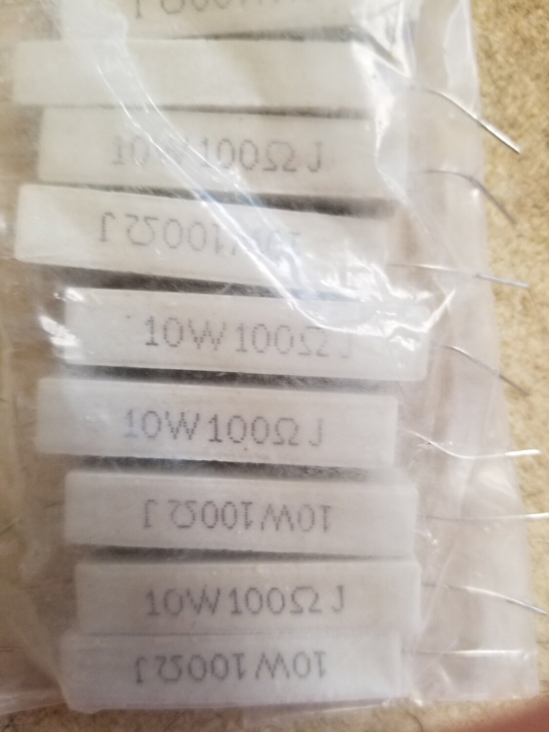

Lot's of good stuff penciled in for December. The 100ohm resistors are in and the 470's'll be here tomorrow, so my throttle experiment's about to get interesting. My object's wider control of the power, not subverting the firmware and increasing access over 90nm - which it does anyway in Sports mode, I assure you.

These ones in the bag are for Da Bull.
They not shiny it's more satin. Yes they are expensive but gives me peace of mind.
Very Nice stuff. I prefer 'satin', 'bead-blasted' or 'raw'.
The Blue LT comes in a Red bottle. Just get 'Loctite 242' - no color confusion. The liquid's Blue.

I wonder if the paddle colors are interchangeable?
It appears to use the same bar-mount, so the Magura plate I have should work for me (and my throttle. lol)
If not, I created a 3mm shim - that can be filed a bit and be 2mm.
BTW. The stock placement looks like a real Pain In The Thumb Knuckle.
The compromise/ trade-off between brake lever placement and shifter fails dismally.
It'd need 'reach-around' levers for the paddles to be correct - for me.
I dumped the 'extra' clamp for 'brake faceplate'/ mixmatch/ matchmaker types, but not impressed with WolfTooths.
Magura's works better - for Magura levers, one'd hope so, right?
Again, thanks for the tip,
Fn'F

Replacing Gumbo's 46T was an eye-opener. The derailleur wasn't over-tensioned by a 50T, so I switched; went through the gears several times (cool I can tilt the bike on the kickstand); seemed fine; hit the road and stopped in at LBS for him to check out. First question was 'so, what's wrong'? A: Nothing. I didn't lengthen the chain, but it works great.
After going through the adjustments and running through the shifting several times, he agreed 'it works great'.
27miles later (I'm at 50.4V), my verdict is: The 50t (w/ 11 x 40) is a perfect match.
Shifts are faster, noticeably improved. I can double-click the Archer and smoothly shift two gears in L2.
11t is the tricky cog to be on before power starts yanking the chain.
Soon, WW will have our programming cables and (if the parameter's are available), I'll stretch the input latency to 1/3 turn. Now: 1/4 turn of ring = just engaging the 3rd of 3 teeth on 11t cog, and 3 teeth on the 12t.
A longer pause might be helpful. Then: 1/3 turn = just engaging the 4th of 4 teeth on 11t cog, and completely engaged with 4 teeth on the 12t
