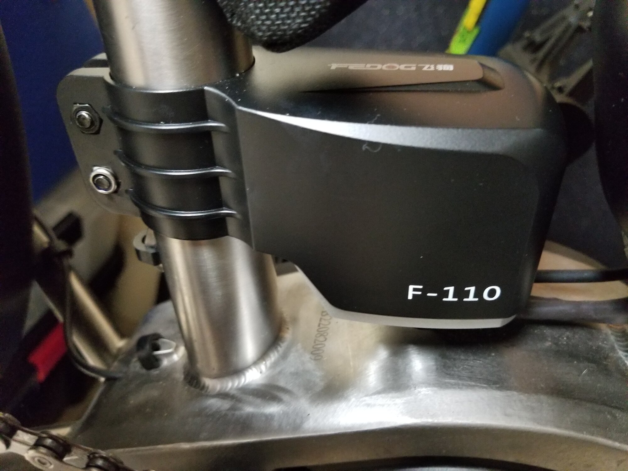

I went with that horn and the alarm function works great. As anticipated it weighs too much.

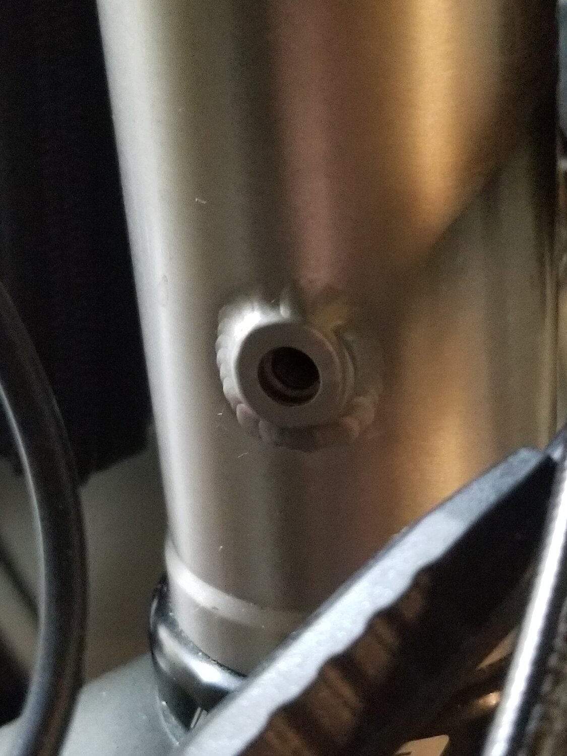

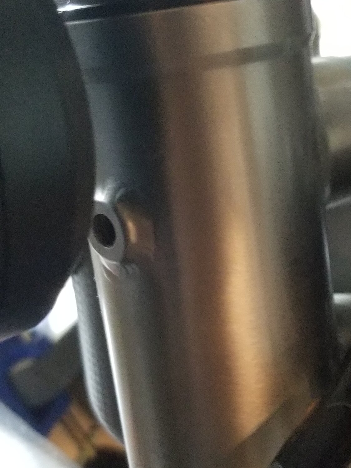

The bracket is heavy and ugly. Hey, they tried. My plan all along has been to to mount in the head-badge port, preferably using a short flat-headed bolt drilled thorough the horn's rear casing and a nut in between.
But is that hole even threaded ??? Is it for a Riv-nut ?
I lit it up and magnified and I see threads in there.
The (way overbuilt) bracket's gotta go. It's close to 1/3 of the weight.
I don't want my horn turning into my bottles either.
Since I can't get info from the frame maker, it may come down to asking an LBS, WW - and I hate asking stupid questions 🤪 when I'm not going to be buying anything probably Ace Hardware and I can buy a bolt.
Problem solved: A (whatever pitch) 3/8" flat-head w/ nut and a hole drilled in the back plate. If I like it I might even remove the anodizing, turn it silverish again.
The horn's loud and the alarm is perfect. I can hear it 200 yards away, wind blowing away from me, so a cheap, lightweight cable-lock prevents problems. Fishing, I don't need distractions and cabling to a bush or immobilized the wheels reduces my chances of opportunistic theft to about zero.

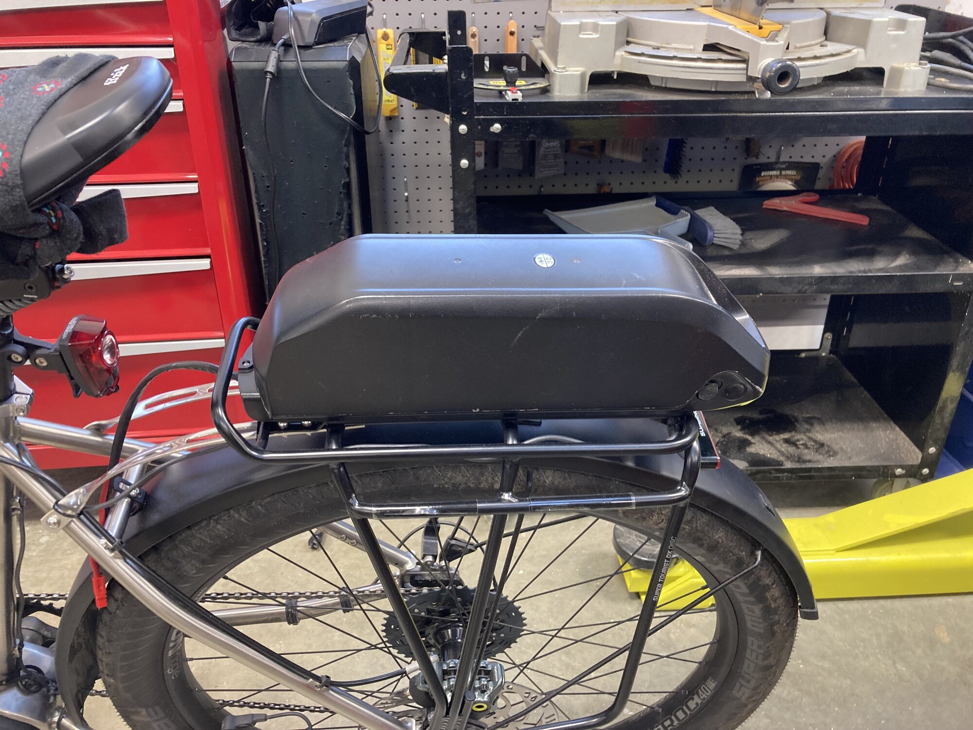

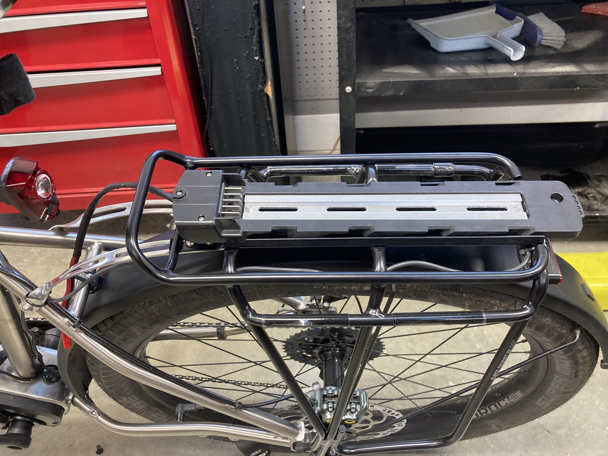

Here's how I'd mount the battery holder on the rack.
That's such a cool set-up.

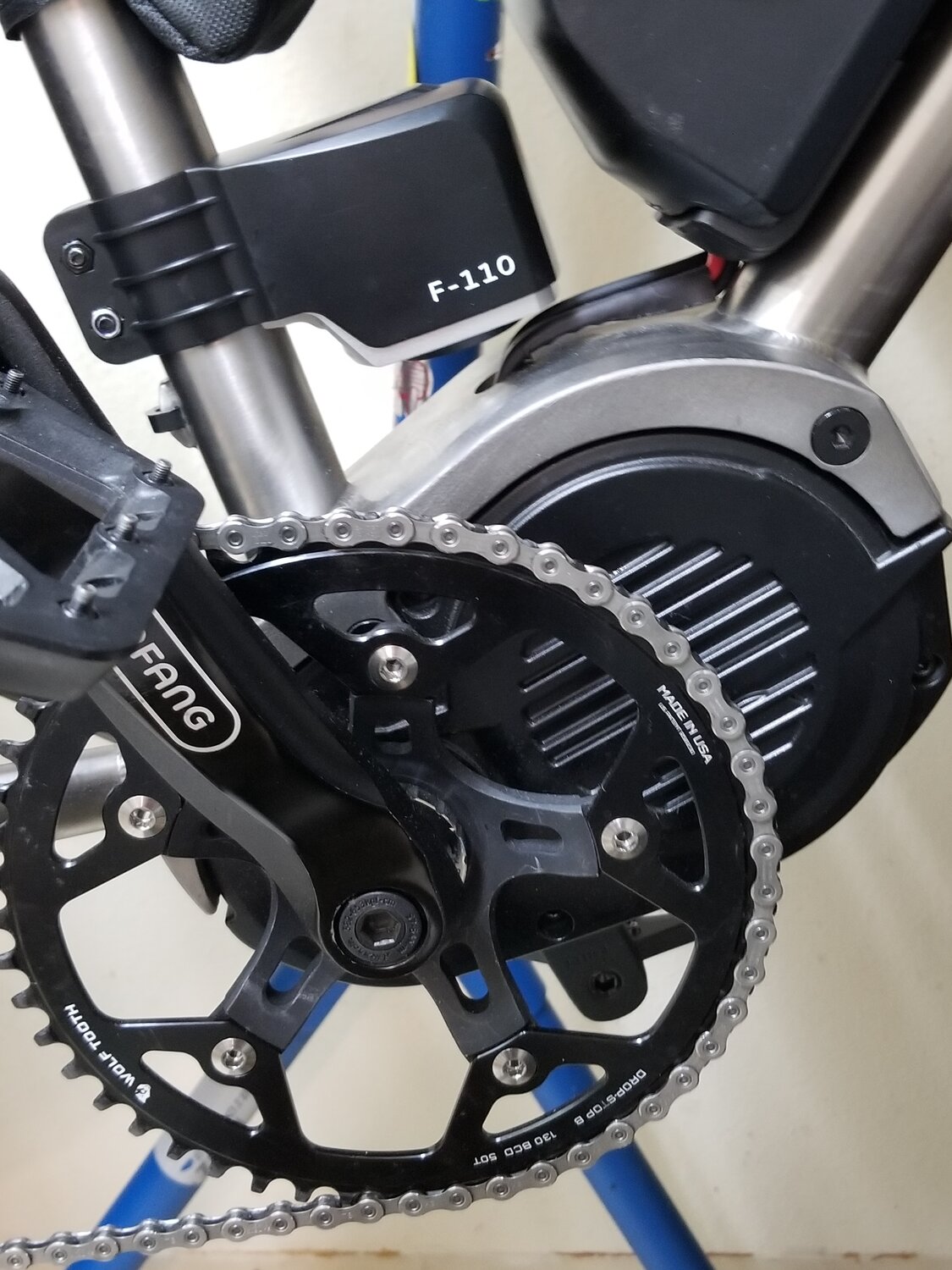

Done a few miles since last posts. Found the big cog on cassette acting oddly.
Raised on the park stand, run through the gears. Sure enough, 11 is off. It chatters every few teeth.

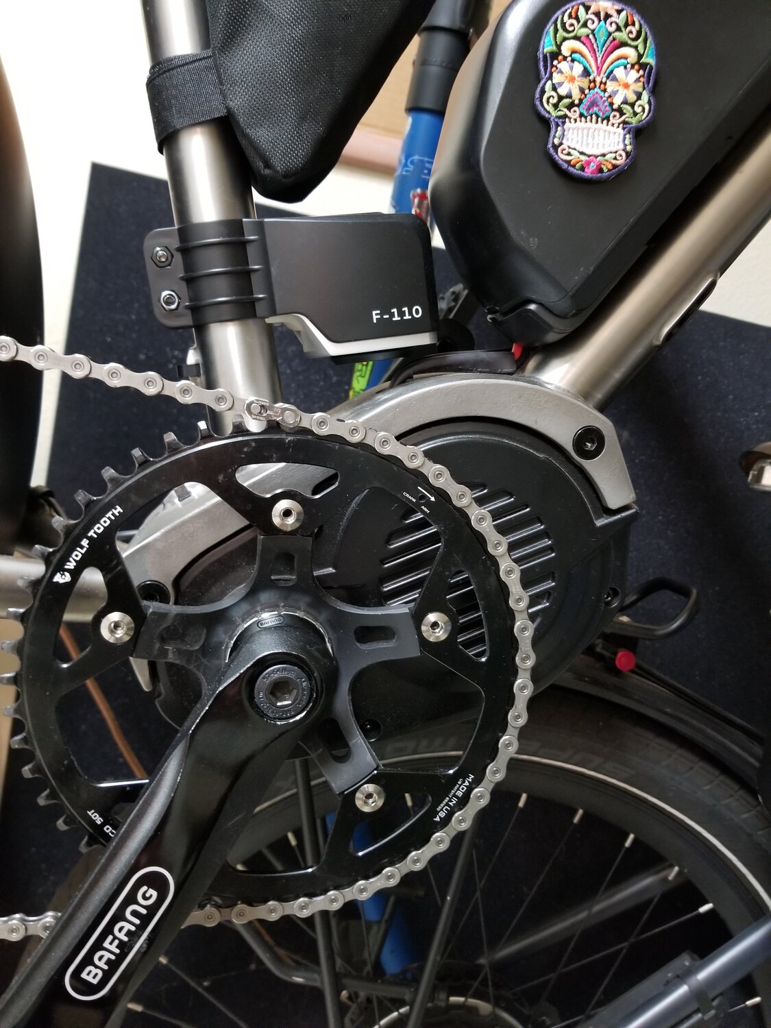

Hmmmm, it was perfect - before I went from 46T to 50T Ring Gear. So thinking how this might affect you, it comes to mind that a larger Ring might solve your issue on the little cogs?
Going 46T to a 50T definitely moved my bias well off the larger gears.
It also implies that the longer the chain, the more bias towards the big cogs, and vice versa.

There's a new alarm from that same company I've posted before. It's 1/2 the weight, attaches to most seat-posts and frame tubes, has a strobe light underneath and loud.
I set the sensitivity (simple, right from the remote) and yes indeed, it's perfect. Bump bike CHIRP CHIRP. Do it again it CHIRPS for 30 seconds and resets. Three levels of CHIRP volume/ Sensitivity. Set the correct amount of hell to get your attention in 5 seconds.

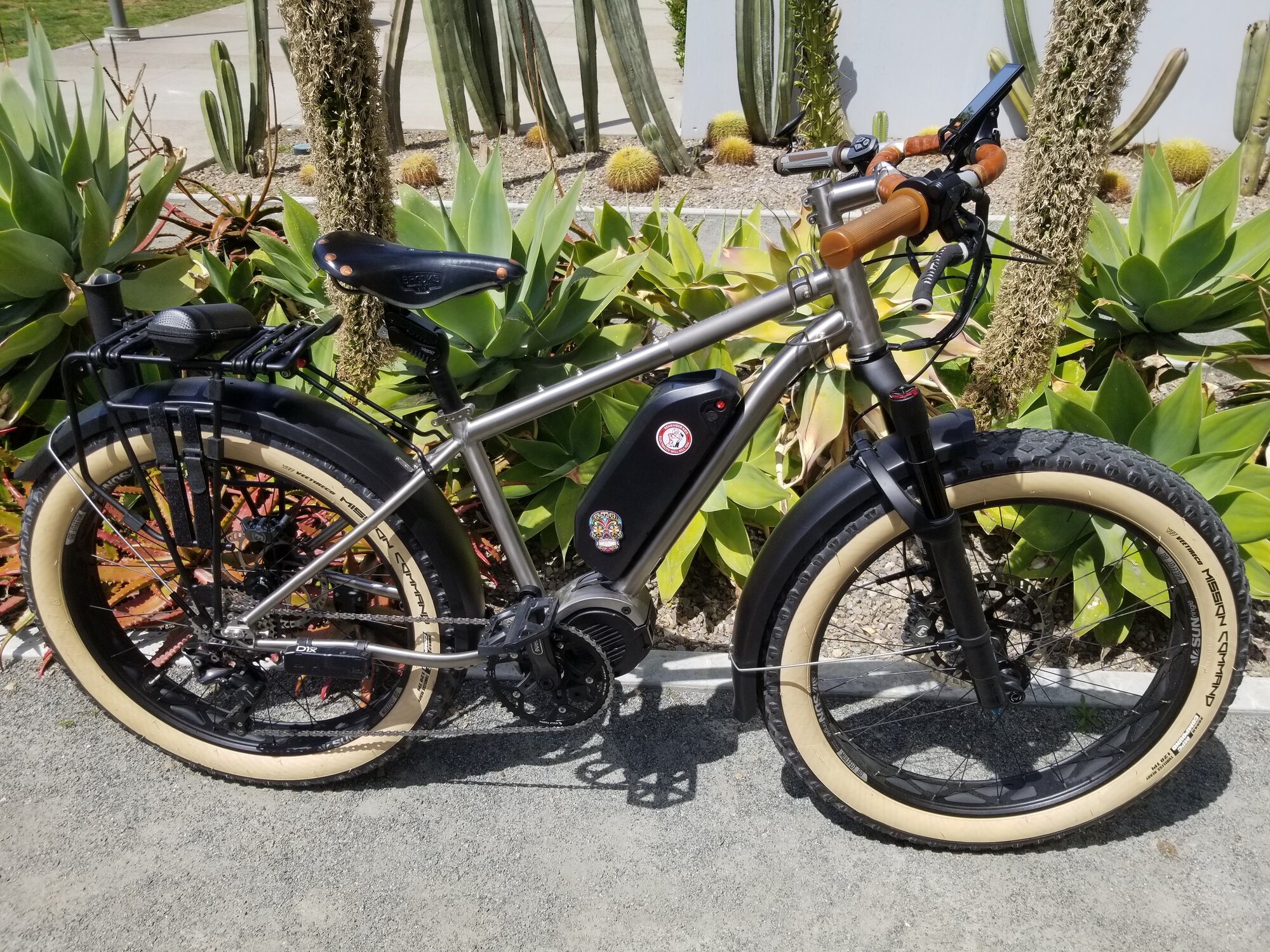

I still never cease to be amazed by this bike.
My one complaint's the machine leaves little room for a Mark III dream. Improvements are incremental, largely whimsical/ aesthetic preferences.
My chain's just getting some stretch. Perhaps riders with short chain longevity are affected by other factors, or I've a rare stroke of luck.
I like the Shimano drivetrain. Yes, Mia Culpa, how I wanted belt drive and still do. An IGH was a nod to that, not vice versa.
Looks awesome in the back of the truck or booted and suited in dress uniform and on the road in the Cali Sun.
Still haven't mastered precisely tuning that beastly Mastodon fork - rather, I should say developed the expertise to take complete advantage of it's vast capabilities. Hit nasty street terrain, holes, ruts at 20mph - I'm 'damn that was crazy' super-glad for that fork.
Get home and it's only used 25% of it's travel ??? I've managed to get a hit where I used 80%. Intense.
Well worth it's weight.

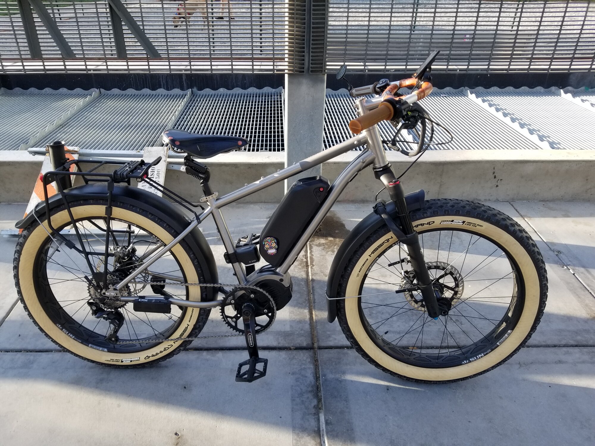

I'm now running 26" tires/wheels. The goal was to bring the top tube hight down for a more comfortable standover. The top tube is just over 3/4" lower. I was hoping for a bit more, but I'll take what I can get.
I went with a set of Nextie carbon wheels and Continental eRuban tires.
Overall, I'm happy with the results.
What I'm not happy with is the power output. A while back I used the Archon X1 programming tool and did some minor changes. I haven't ridden the bike much since the changes, but today I had the chance to wind the bike out and go through the power levels.
I was surprised to find that no matter how hard/fast I pedalled or what power level the bike was in I couldn't get the motor to produce more than 720W.
I basically followed Pushkar's video, but I suspect I did something wrong. Time to reprogram again.

I hooked it up with Magura MTe's, the best fork it'll take, Kinekt XR - even a Domino Twist Throttle. lol - on a $1700.00 Bike. It'll do for the Winter while I stroke Gumbo.
My problem's those 4.0 🥾brogans Gumbo wears have me so spoiled that "2.7's feel like jackhammers.
I'd no idea fat tires felt this way. Running 16 - 18lbs, in tight cornering at speed, nubs rumble but no roll or sudden effects - even slaloming.
Go down to 12lbs, mushy, some roll-under in turns, but super bouncy suspension effect over rough terrain.
I may have WW build me a 4.8 wheelset.

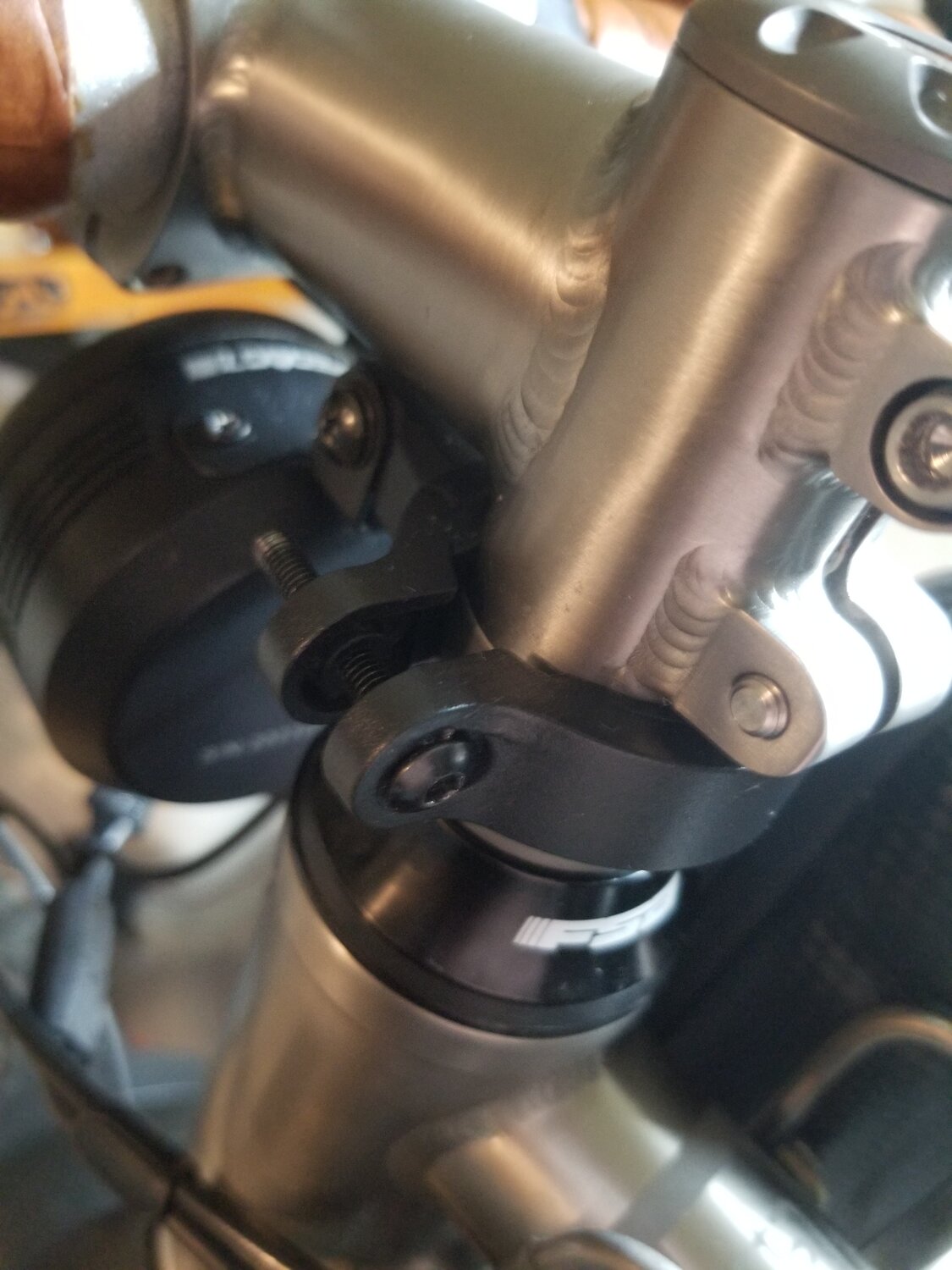

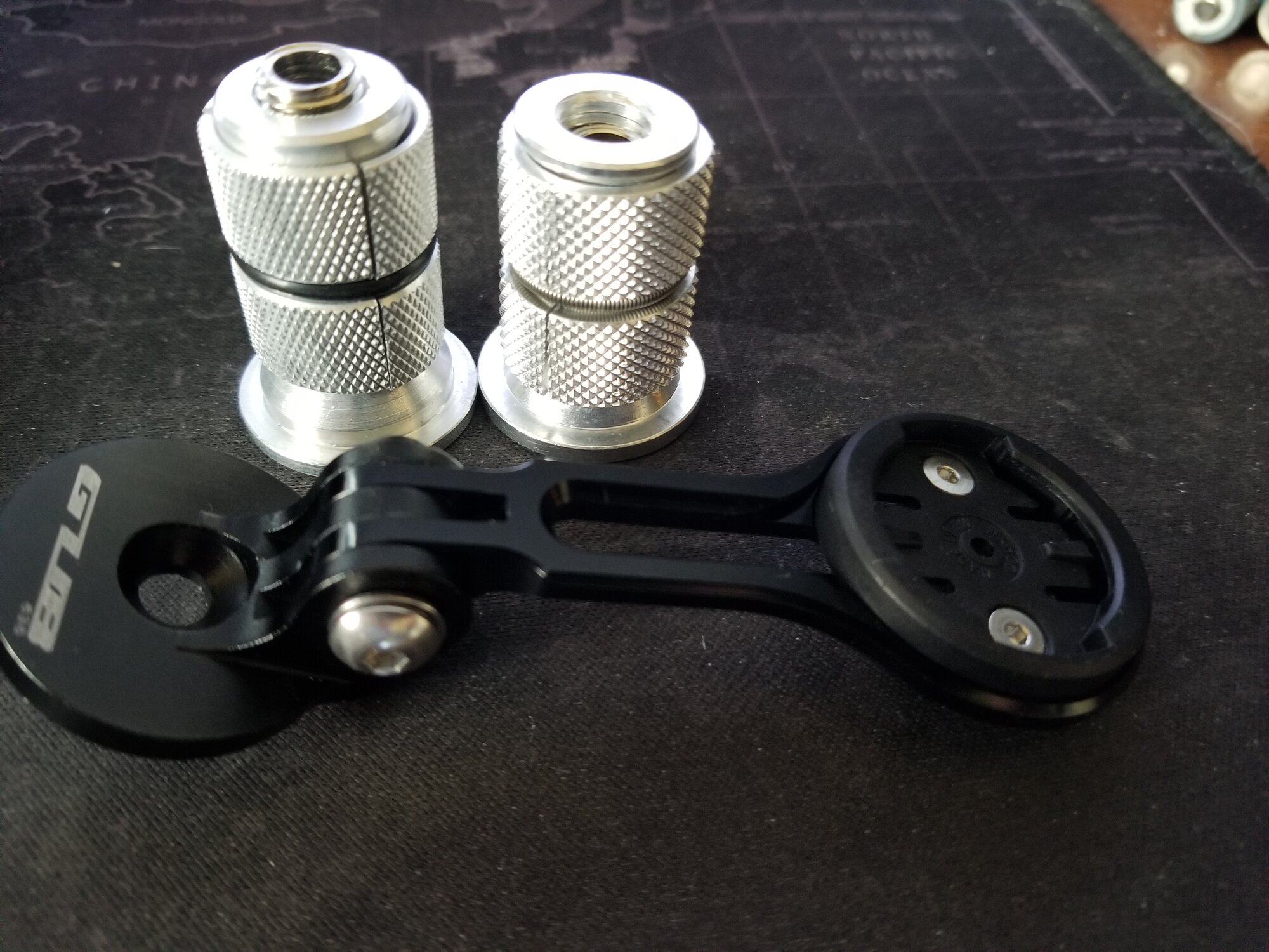

The silicone holder I now have, grips my Galaxy and has a Garmin fitting on the backside.
A requisite for a holder is that it can be positioned in Portrait, or Landscape mode.
I have a whole box full of various Garmin bar-gripping holders and such, but zero tolerance for clutter on my bars.
The only spot that mounts right - for me - is off the head cap, but that needs to be moved forward from dead center where it fits perfectly and can be seen in a downward glance. If I have to move my head to see the screen, it it's a fail. After many fails and a lot of tries, I found a few nice parts.
These expanding plugs have different grain grip areas and allow any top cap - unlike others.
Also, one has a rubber O-ring for a clamp (okay), the other a metal spring (great).
I'll be using the one with the coarser grain (on the right), I switched to the metal spring - in combination with that alloy GUB cap and extender, which also has a GoPro fitting under the Garmin.

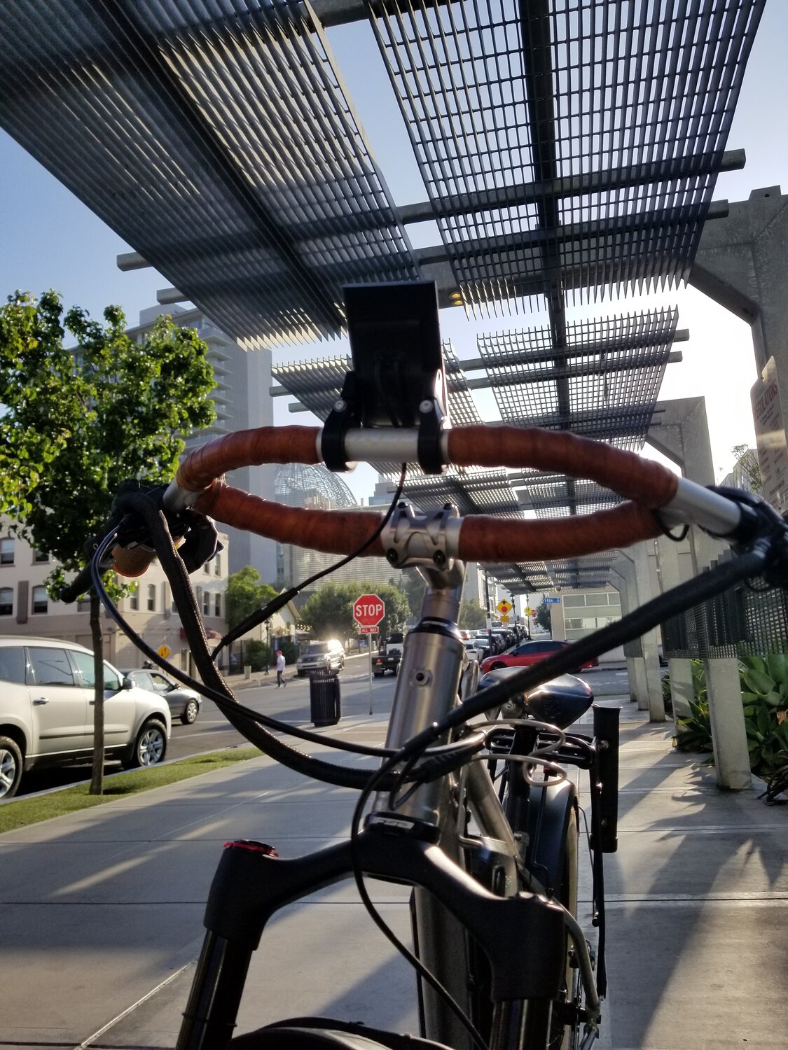

Jones' Bars are solid as a rock, roomy with long, straight runs. The Bison hide on surfaces where I really grab was planned a year before. Initial install w/ contact cement and treated with Mink oil does the trick.

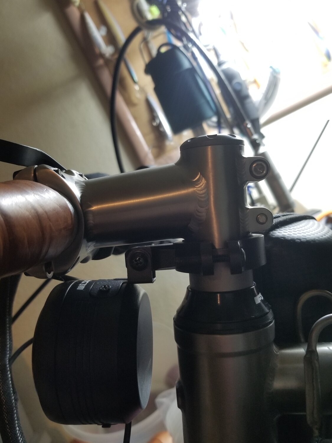

Plan is, Winter comes I'll change that spindly ti road-bike stem to a blockier alloy type.
Chopping 20mm off the the fork's top end is also on my shortlist.

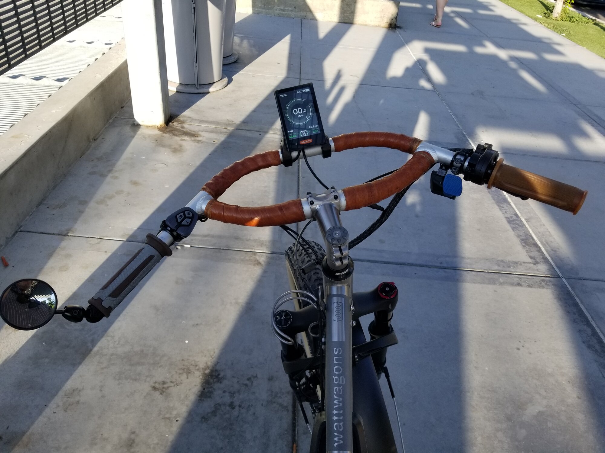

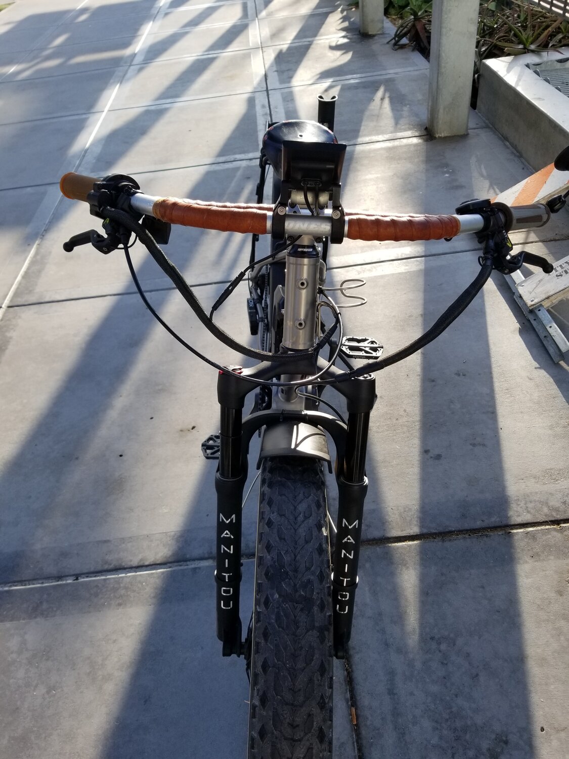

Paul, how do you find the sweep-back on the Jones handlebar? I'm asking because I really like that handlebar, but I've read that the sweep-back is a bit too much and it puts a rider's hands/wrists at an uncomfortable position on longer rides.
Since I've owned JB loops, I see other owners and always ask them the same question. Yesterday, a guy about 260, on a Trek asked me 'are those Jones'? Then I realized he had a set of the black non-butted - which look thinner. Same story. He loved them. He was running 710 x 2.5's.
I hear/ read of rumors that some dislike the sweep angle.
While physiology varies, I've shown this technique to several folks - which often demonstrated their bars were certainly stressing their wrists - sometimes a lot.
I close my eyes, reach out front and make a natural grip with my hands - roughly the width and distance I'll be grabbing. Open my eyes and my grip shows the angle. That's '0' (neutral).
Rocking my wrist side-to-side from that position I can assess how my stressed my wrist will feel at various angles.
The angle is most natural when the first knuckle is most forward, in a straight line from elbow to knuckle.
The further the arm extends, some inward rotation of the wrist is required to stay at '0' point. The opposite is true with more inward positions - outward rotation is normal.
Try it. Eyes closed, fully extend arm without turning your wrist. Now try it with wrist twisting inward.
Sight tricks me into conditioned response. The feeling in the joints is a more trustworthy guide.
The JB's require a longer stem than other bars or your control point is moved aft - dangerously so.
Risk of tucking the wheel become very real. That's BMX style. I posted links that show the major cause of BMX accidents are wheel tuck. Having been there I brook no dissent. My grips must be at (perfect), or slightly forward (slightly slower control) of the stem.
The stock Salsa stem is 60mm. JB's require 75mm (min) - 80mm (max).
I can't speak to real distance riding, but company vids show riders in a semi-road bike position grip as part of the design.
I can tell you this. Trying to find a used pair there's very few available and always at high prices. Like your Archer.
If the JB's have a drawback I haven't found it.
