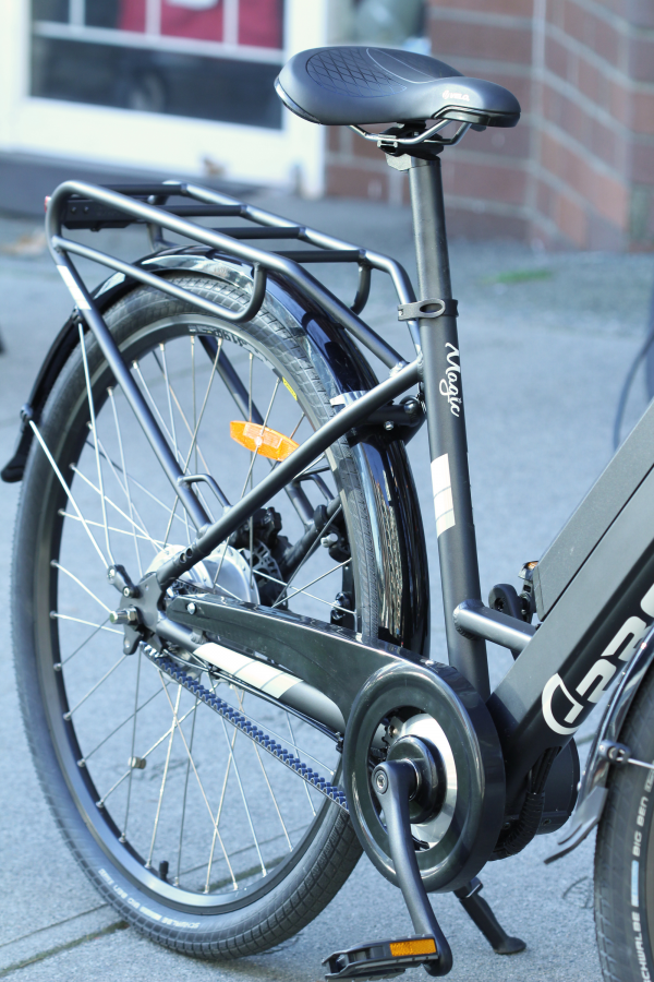

Question, would the rear chain stays on this bike be considered "elevated chain stays", in other words, I notice there are no cut-outs to pass the belt through in the event it was necessary to change the belt.

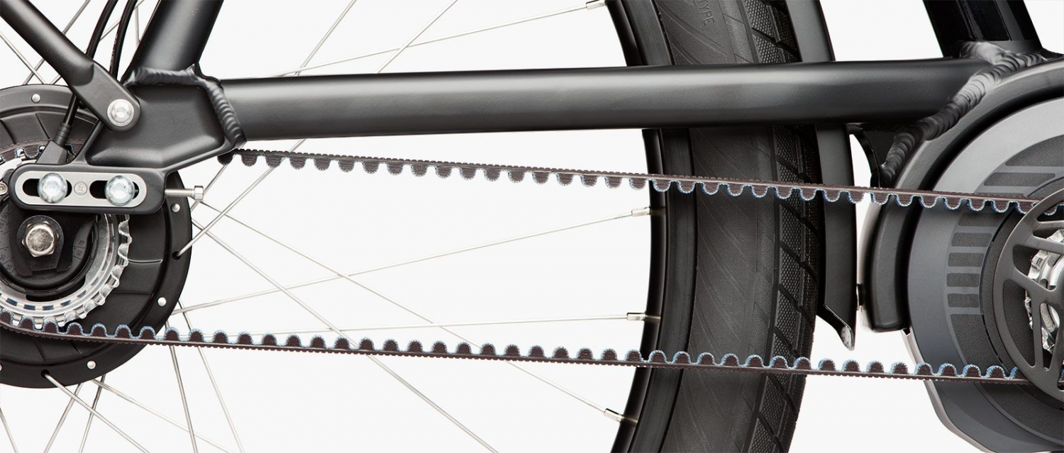

The chain stays look elevated to me so the belt could fit below the chain stay. I hope I'm explaining myself correctly. I was watching a video review of an R&M bike and they had what they called elevated chain stays and it made chainging the belt look easy.

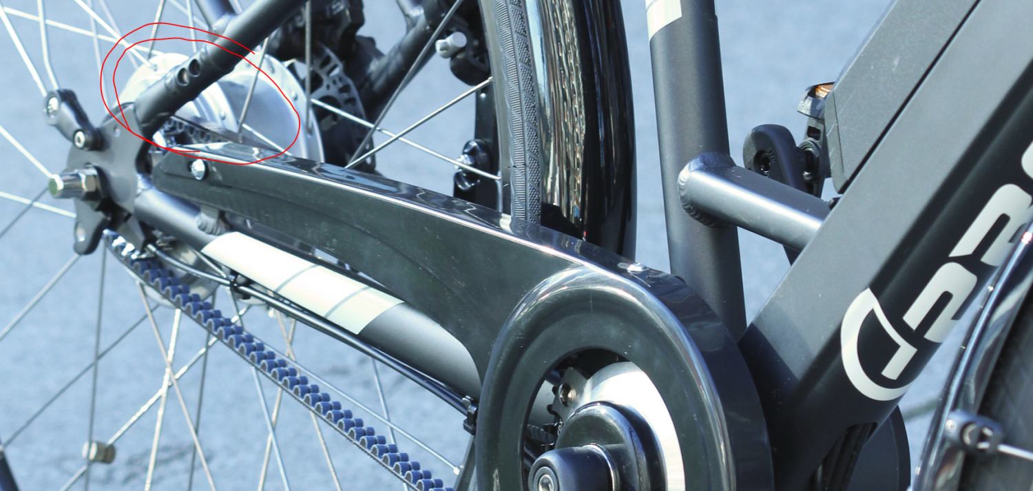

I have an eProdigy Magic Pro with a mid drive, belt, and Alfine8 and to change the belt I have to remove a piece of the frame. This is just a curiosity question, it make no difference to me although it might if I had a flat.
This is an elevated chainstay on a R&M charger.
Your eProdigy Magic Pro does not have an elevated chainstay but rather a split in the tubing. I have marked it in red in this picture. This split allows you to pass the belt thru. It is important that this should not be loosened because it would compromise the structural rigidity if it is loosened and could lead to crash or other unfortunate situation.
So, in short, for a belt drive to work, one has to have some opening either by using elevated chainstay or a split in the tubing.
