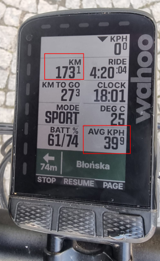

My Wahoo ELEMNT Roam v2 went bananas after the latest firmware update, WC35-16242.
  • First, the unit looked as if it was bricked. I resuscitated it by pressing the main switch and the bottom right button for 15 seconds. After the Wahoo logo appeared on the screen, I had to press the main switch shortly to make the device work.
  • The device has charging issues by USB-C. It has really started charging from a powerbank only but not from regular USB-C PD chargers.
  • When connected to a Specialized Turbo e-bike, the Wahoo reports exactly double distance ridden. The reported speed is also far too high.
I tested the issue on a Vado SL and Vado 6.0, and can see Guru has the identical problem with his Bolt v2.
I recommend that any Specialized/Wahoo user make a documented report to Wahoo Fitness, so the manufacturer becomes aware of the issue.
The described issue does not occur when the ELEMNT is not connected to an e-bike.

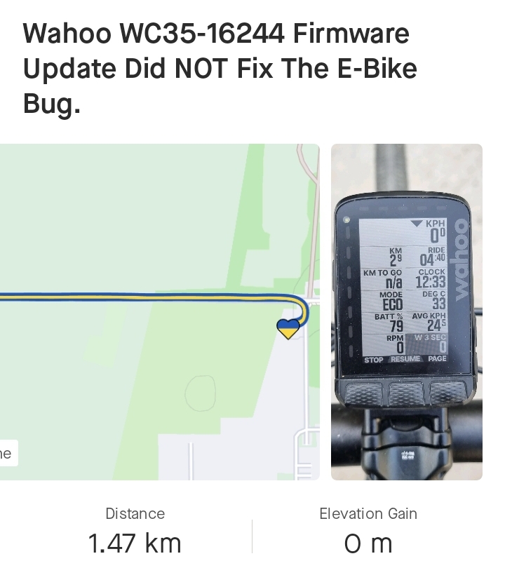

Sorry for the typo in my last post! Just sent an update request to wahoo tech support, my question was:
Is it possible to rollback the firmware on my device to the last known good which was ELEMNT ROAM WC35-16138 - 27 June, 2023?
I will post the response if and when I get a response.
The update caused me many problems on my first ride last Monday but it worked perfectly on my ride on Thursday, I will see how it goes tomorrow if our crazy winds calm down...
I have the Bolt V2 and my version is WA49-16244
I hope you guys get a fix soon!
EDIT : The problems I had were with version 16242 on my Monday ride, but it worked fine on my Thursday ride! 16244 update was just applied today so I will see how that goes tomorrow if I get out!

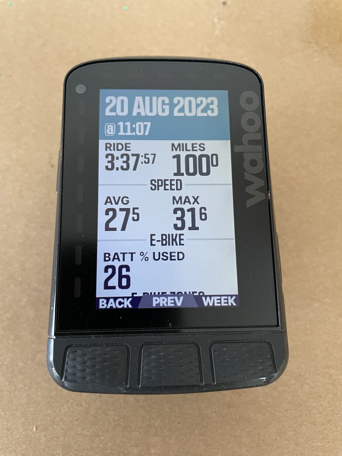

RabH - This weekend I re synced my Creo to the Wahoo Roam v2, just to see if this would fix the false distance readings…
Unfortunately the same problem - I only completed 51.5 miles and my average speed was not 27.5 mph, the Batt % used was correct at 26%
