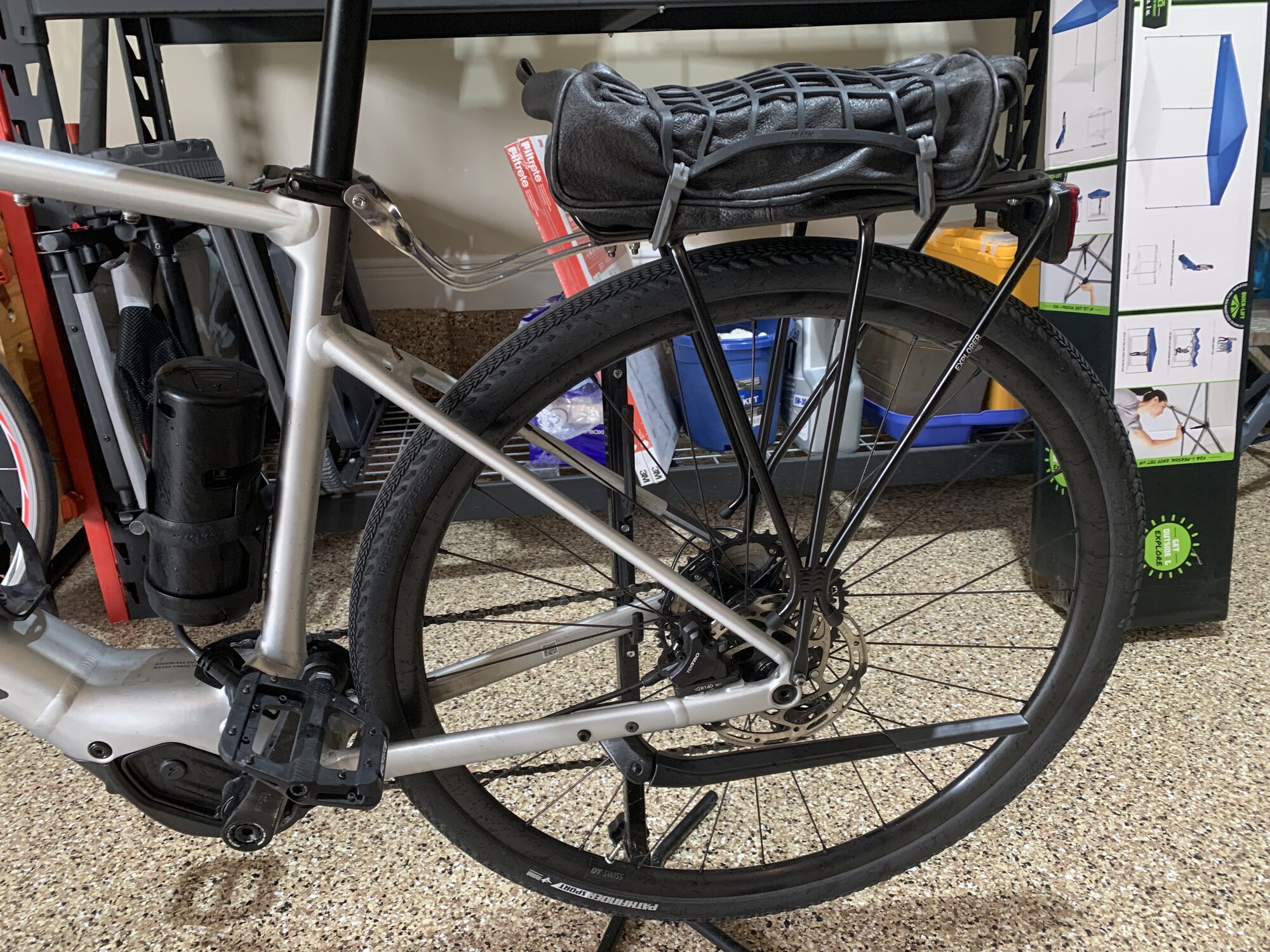

My wife wanted a rack but not fenders on her vado SL. I purchased the exact Vado SL rack (lighter than the VADO rack) from Mikes Bikes and it mounted quickly using the 4 metric screw attachment points (same thread screw as water bottle holder). I made a quick aluminum 1/8" x 1/2" home depot strip to hold the rack level. It is rock solid. The rack is very strong putting all the weight down on the stay. And the aluminum piece you make just keeps the rack from pivoting back or forward. She loves it! see pics I would have painted it black but she said she likes the way it looks.
She keeps a trunk on the rack all the time, and I mounted it in April, and here in July it's been trouble free and rock solid. We ride a lot.
Several specialized dealers said there's no way to mount the rack without the fenders, and they dislike that it appears the rack puts a load on the fenders. But really the rack is super strong and just would use the fenders (or your home made strip) to keep the rack from rotating away from it's correct load bearing position.

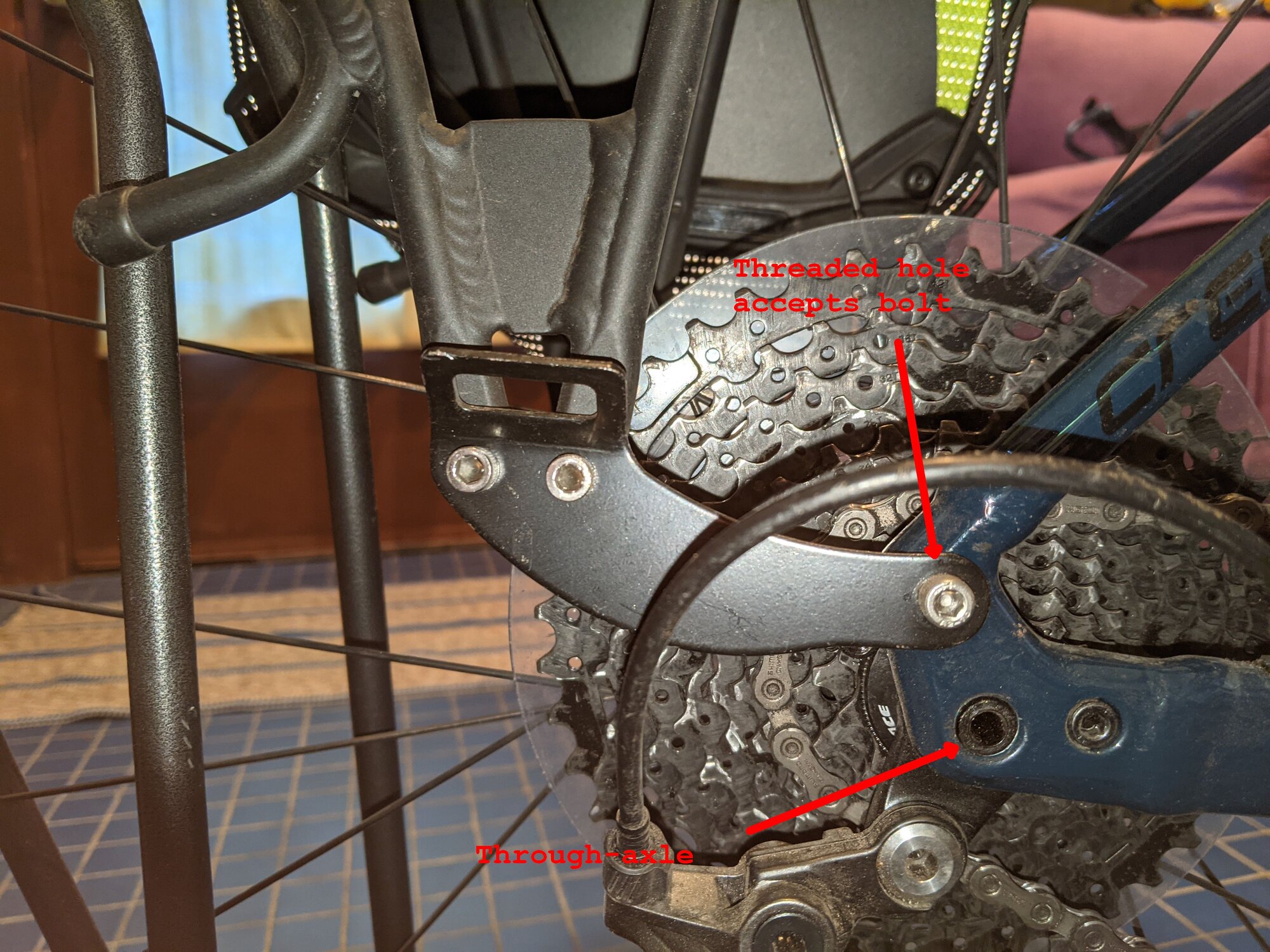

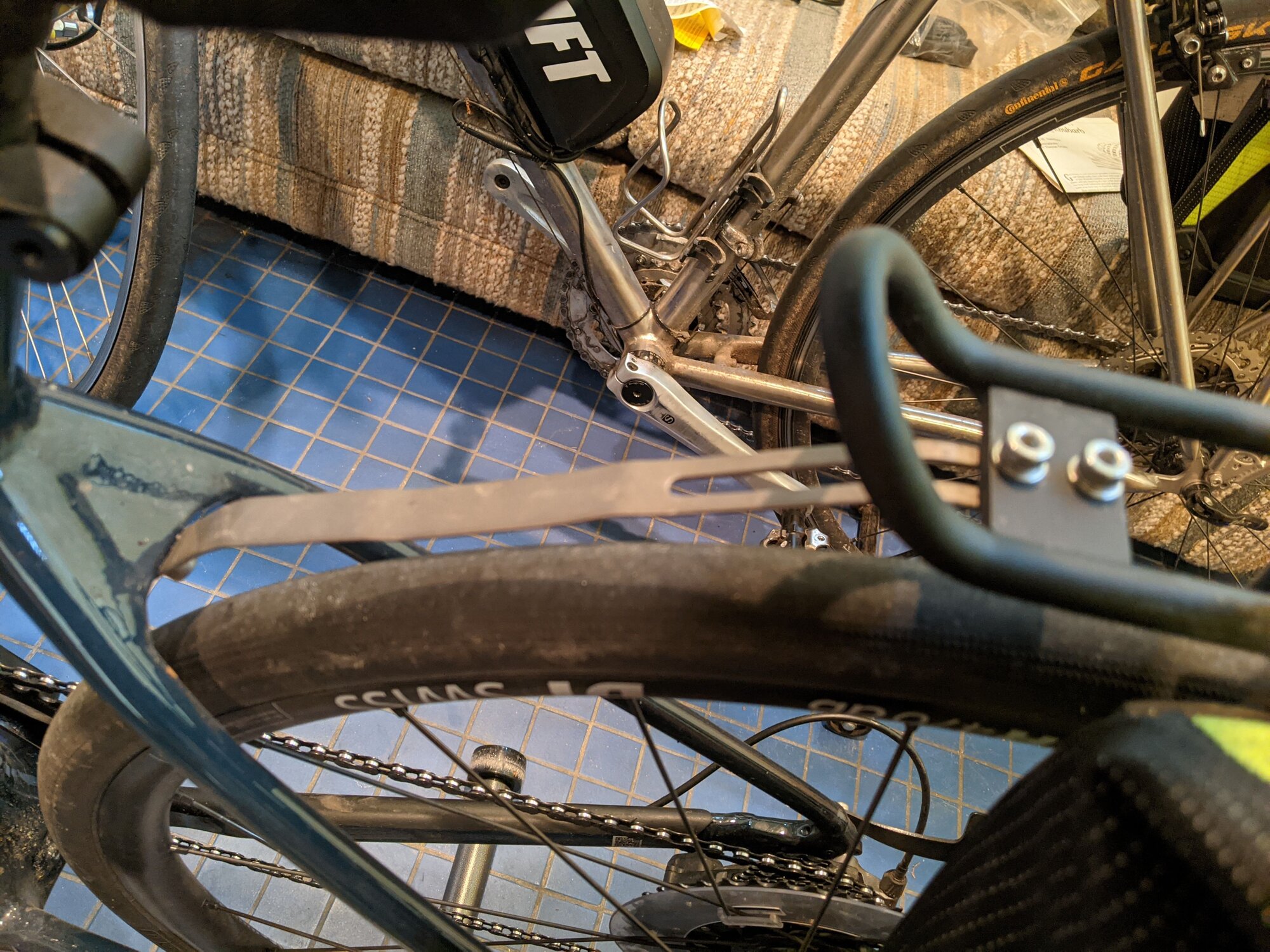

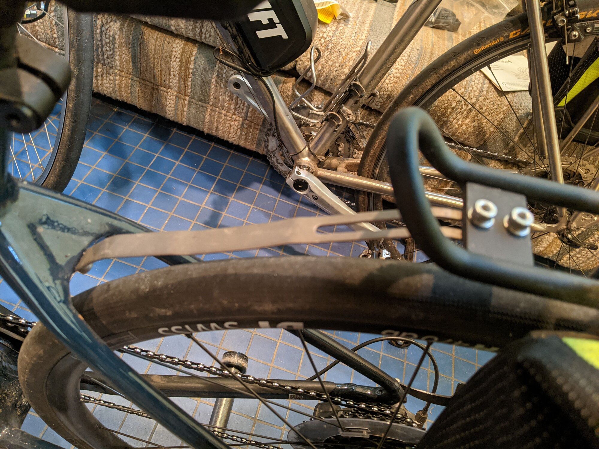

My Aluminum Creo with bike rack with a "connector" much like your installed by my bike shop. I believe this rack came with that metal piece. I am still considering painting it black!

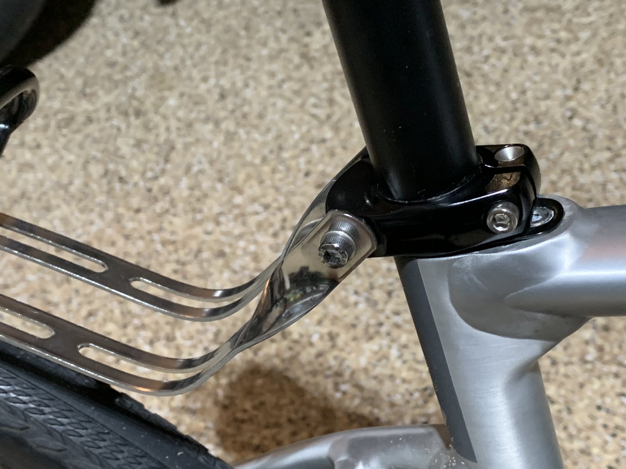

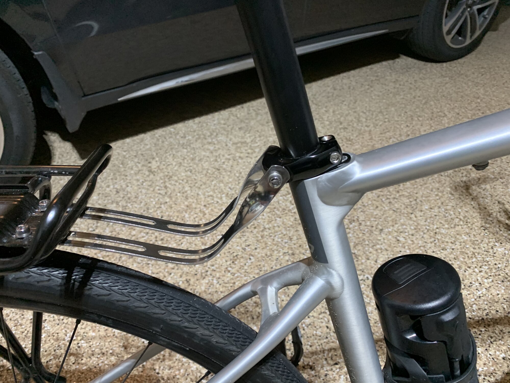

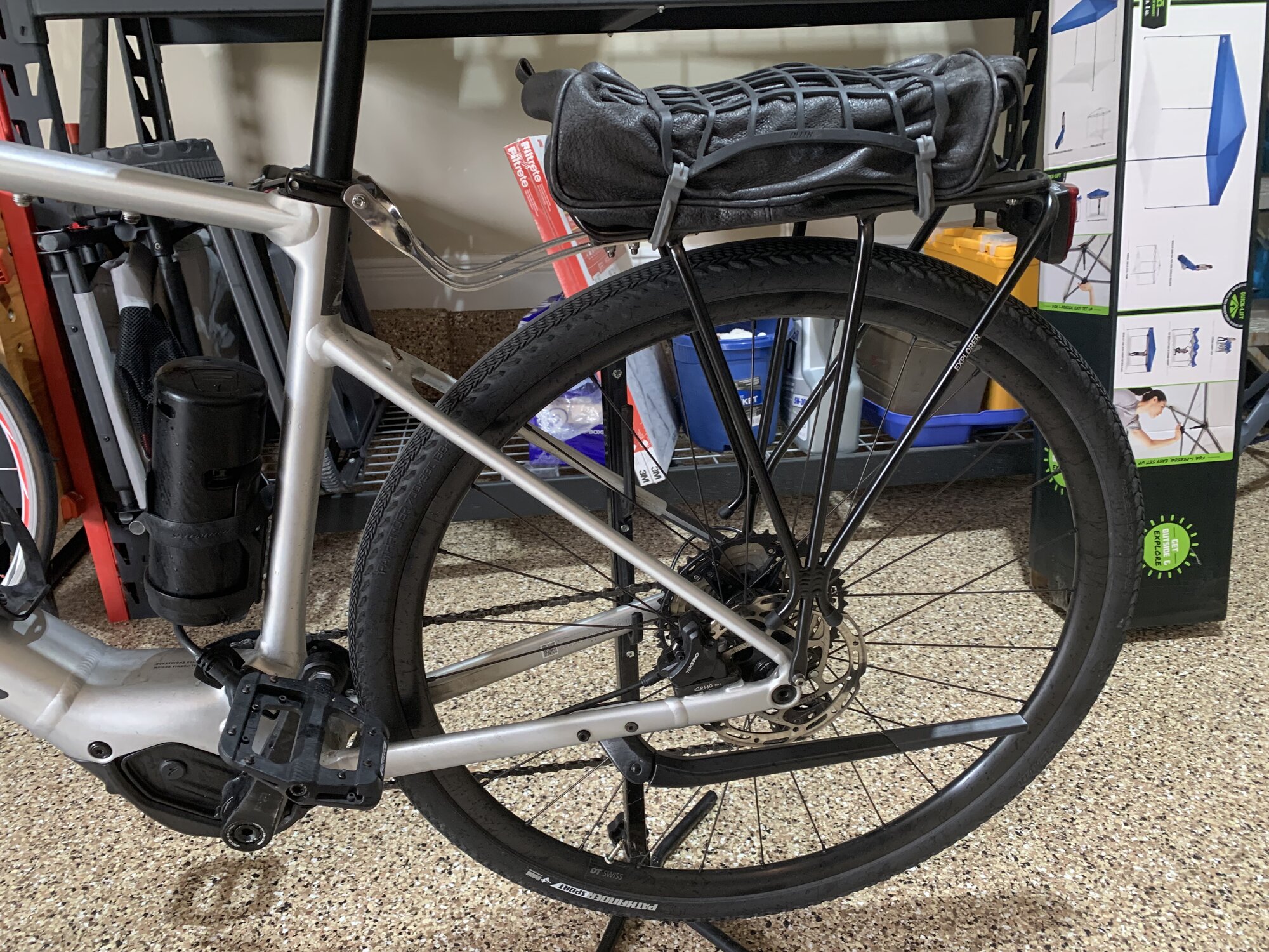

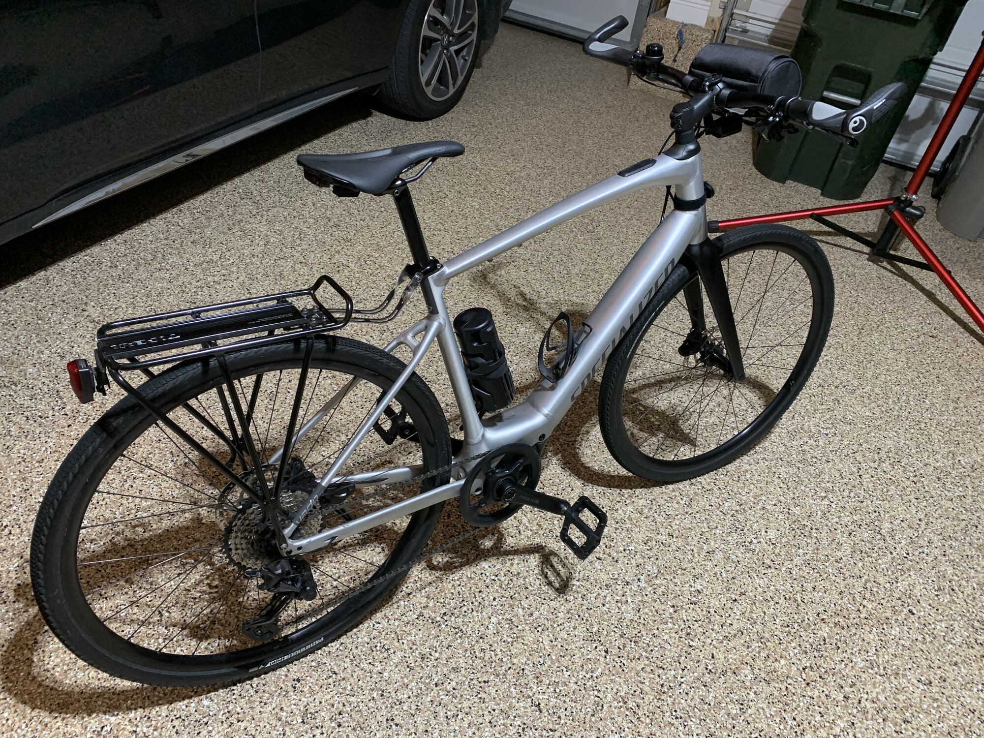

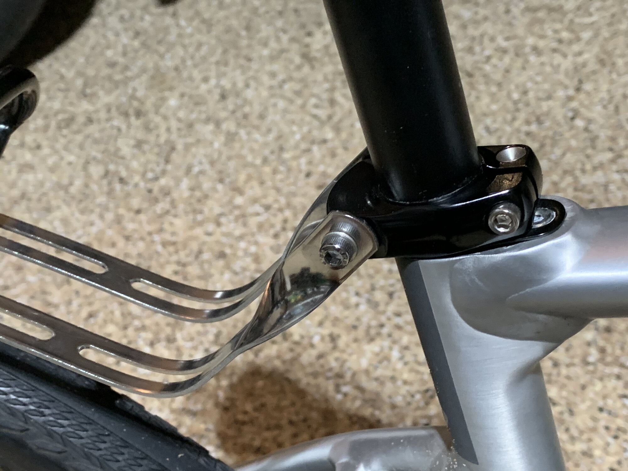

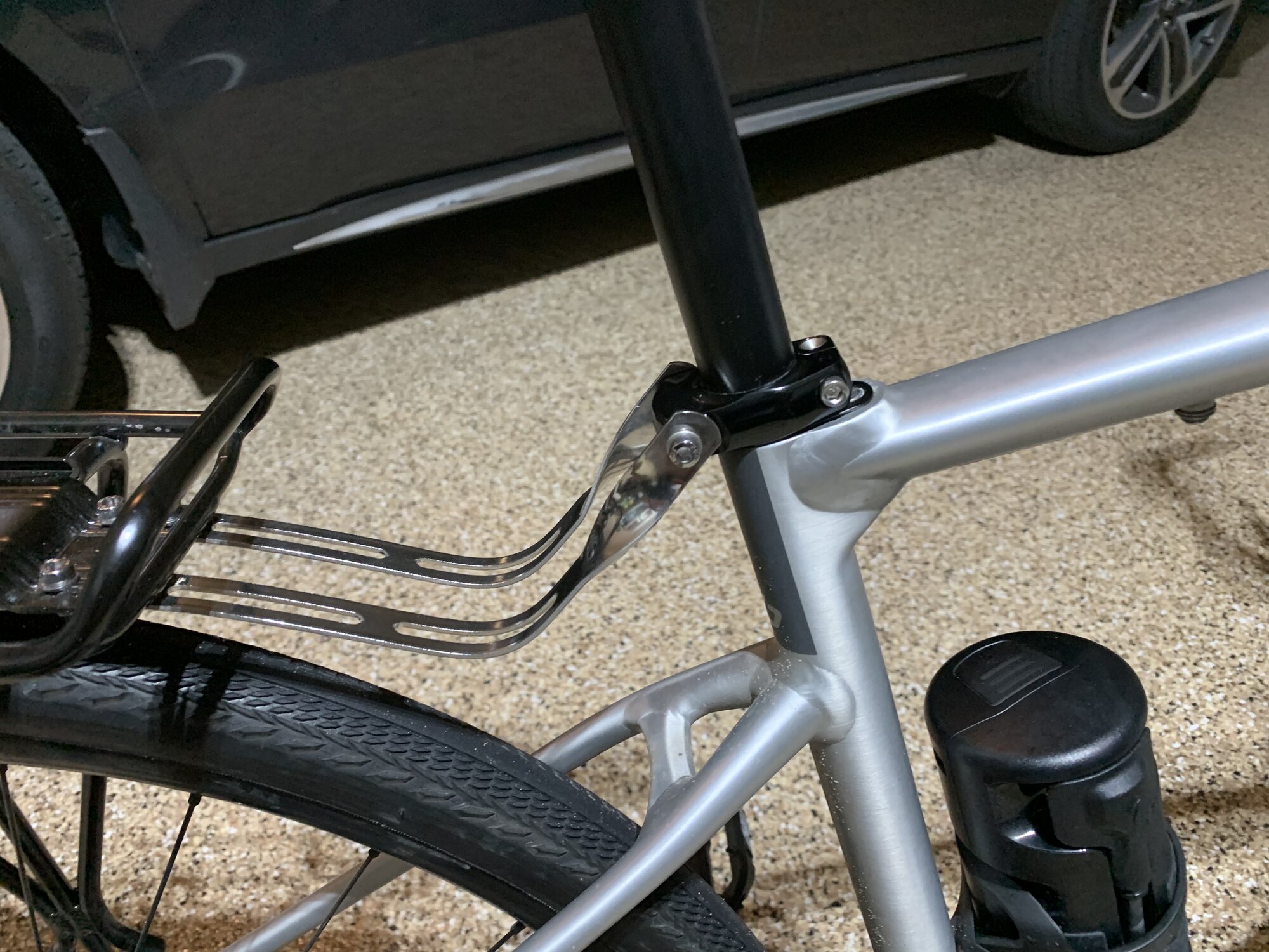

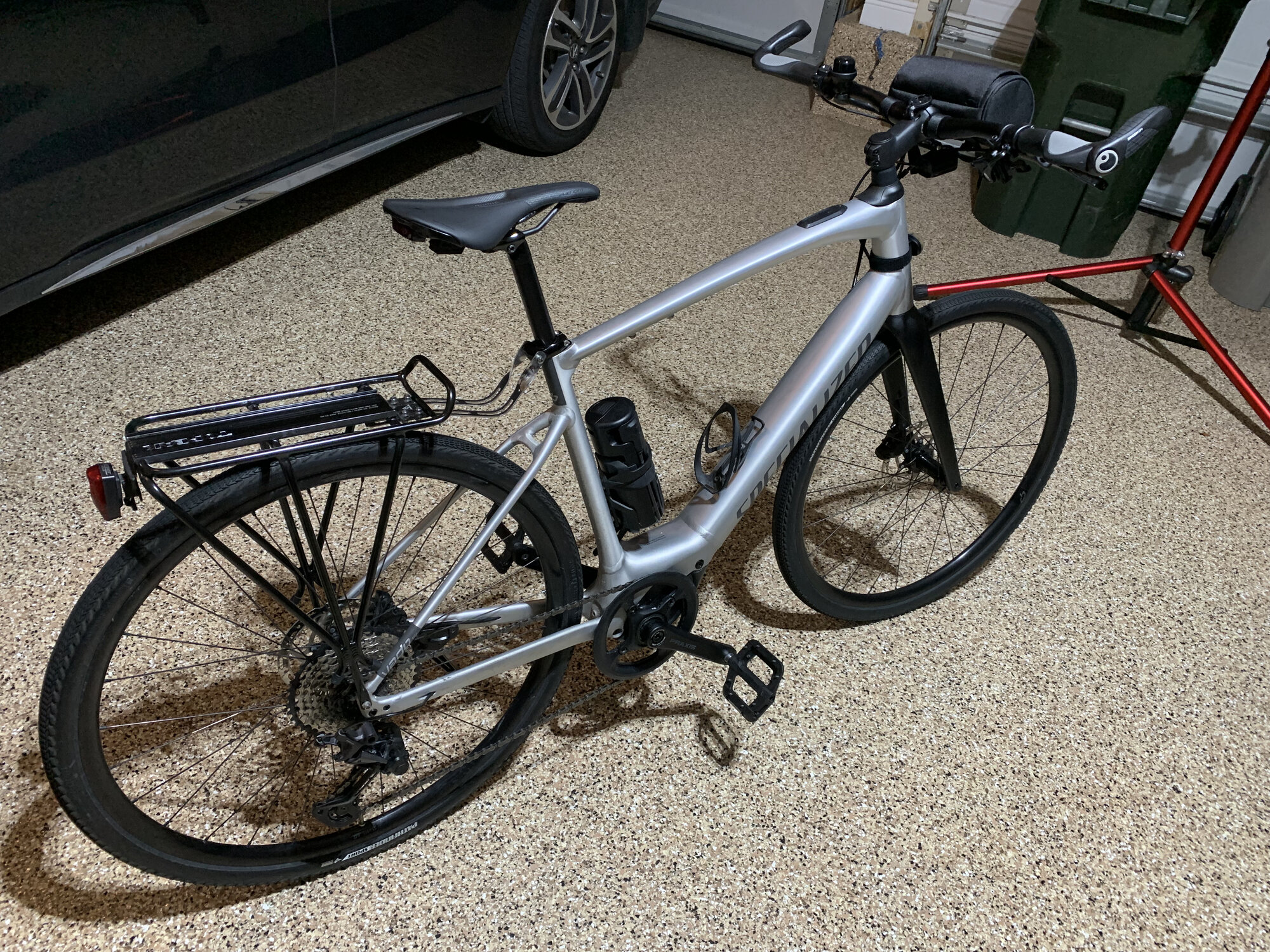

Salsa makes a seat post adapter that facilitates adding a rack to a Vado SL 5. My LBS had a Topeak Explorer in stock.
Here are some pictures:
View attachment 94087View attachment 94088View attachment 94089View attachment 94090

Which rack did you choose? This setup looks the most appropriate for the Vado SL sans fenders.

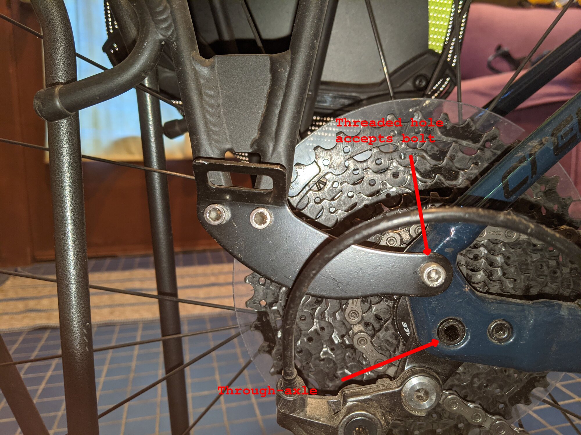

Some narrow rack that the lbs had. I've got a pannier (or two depending on need) hanging - you can see it in my avatar picture. I'll see if there's a label. One of the limitations on fitting a rack to the Creo, at least, was that some of the rack models we looked at would have needed to be removed in order to unscrew the rear through-axle. The connector at the hub area would have been too wide/thick and the through-axle with the sham "quick release lever" would not be able to turn. And now having had a second flat on the rear wheel, removing a rack to remove the wheel would have been a total pain in the butt! While I have not replaced the Specialized through-axle, I have purchased replacements that only use an allen head so there'd be no interference with another type of rack.
I don't know if the "silver" strut was part of the rack package or something my shop whipped up. It has been working fine so far since March and 1,500 miles - roads but with less than perfect pavement.
Aha, the rack is an Axiom: https://www.greggscycles.com/product/axiom-streamliner-road-dlx-rack-184735-1.htm
It appears that it came with the strut. Out of stock at my shop.

Ah, I'm just now seeing the lower mounts are designed for quick release bikes... so that one doesn't work for me. Thanks for responding though!
