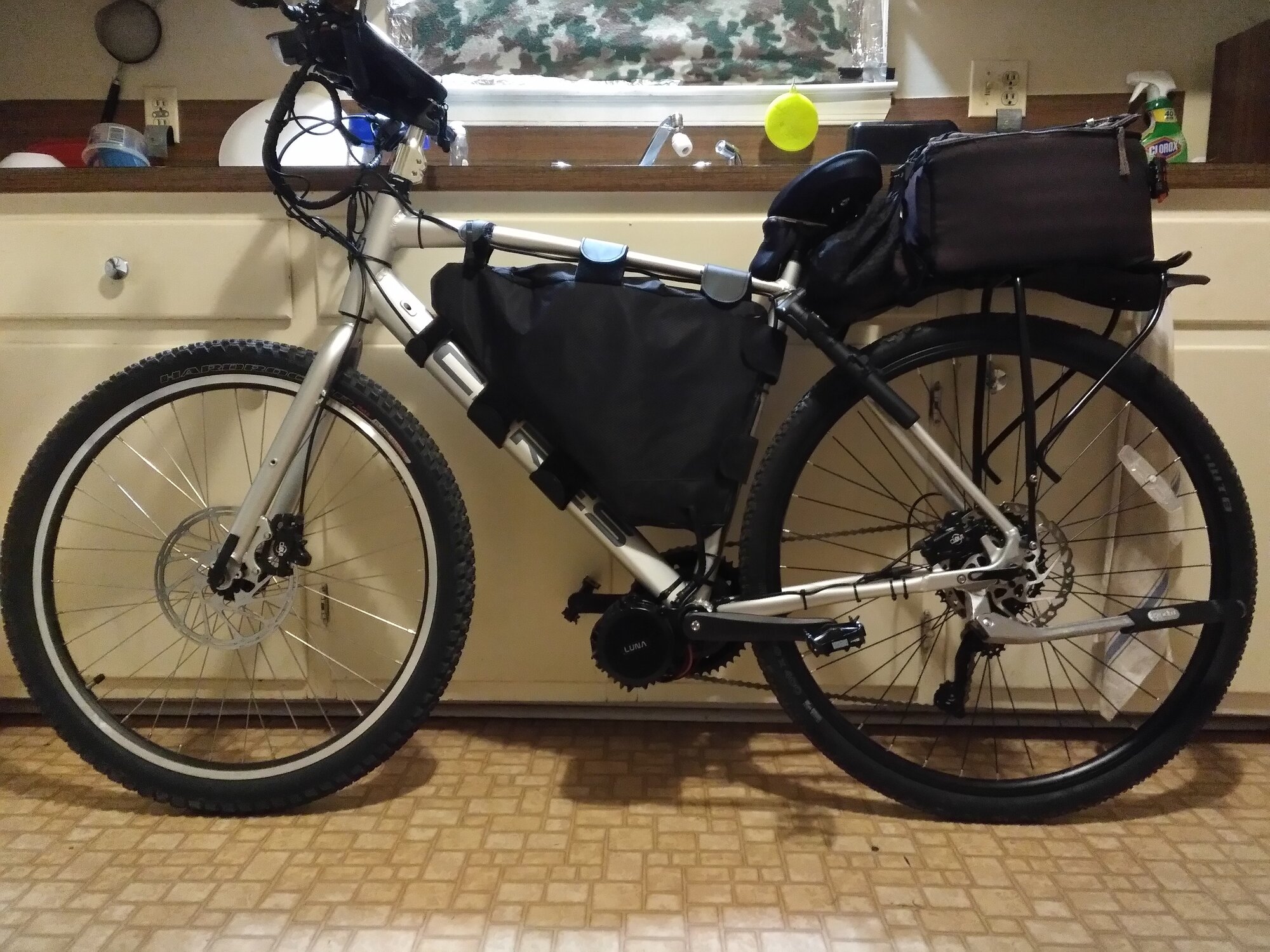

rode the lunacycle bbshd off road programed for 21 miles today, from 57.5v down to 48v
could have prolly gotten another few miles out of it i guess. the power was nuts man lol
Lunacycle BBSHD 1600W with added Ludicris V2 controller.
Added the eggrider V2 display to be able to set deeper parameters.
60v 45ah battery seems to do pretty well so far cant wait til spring gets here! :)
This thing is a torque monster. Have the settings based upon others settings and amended a bit to get more range than power, but damn, this thing is nutty torquey!
