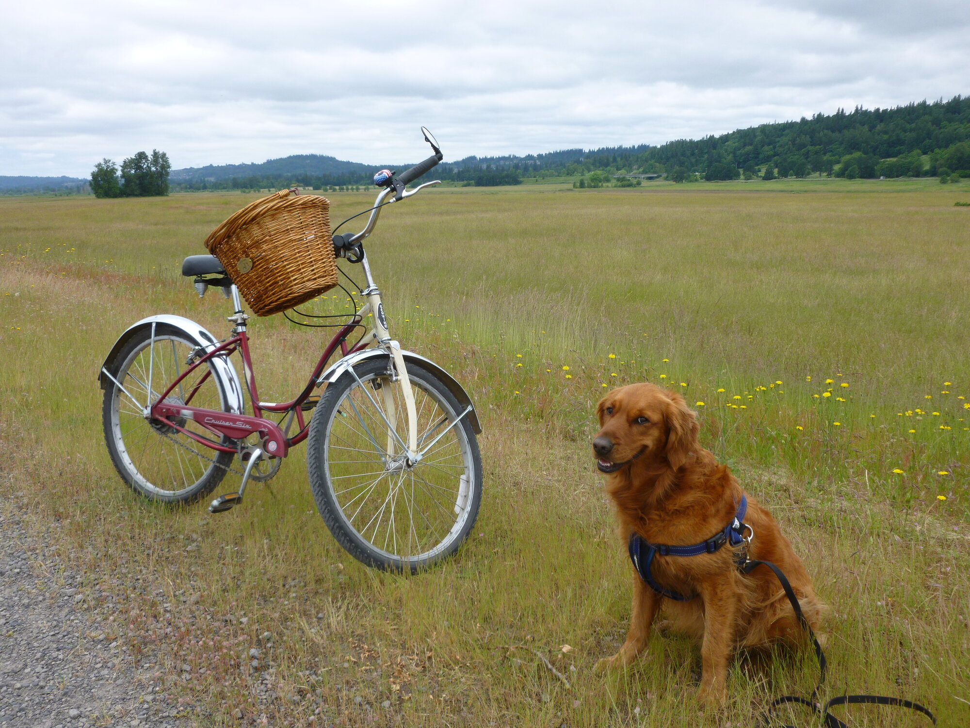

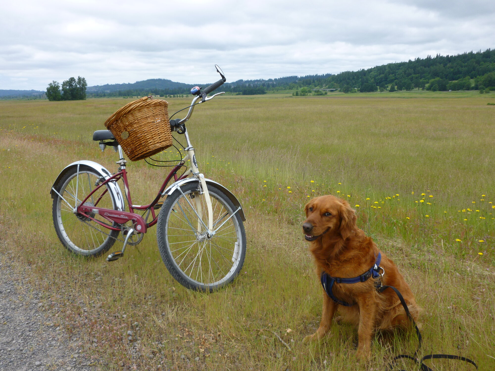

Before it broke I liked it so much that I laced a N360 version into my wife's Schwinn cruiser bike. That was several years ago but it still works fine, has a wider range and weighs less (but is still heavy). Because my wife no longer can ride that bike I put the wheel in my bike that had the N171 along with a TSDZ2. The combination was excellent and on a very hilly ride I was able to keep up with a more fit rider who was on my Yamaha powered gravel bike. Here is a picture from when I had the tongsheng on that bike with the n360.
Several years but not that many miles. I bought that bike mostly to ride along with my wife when she was riding her Schwinn Cruiser 6. Super comfortable bike though.

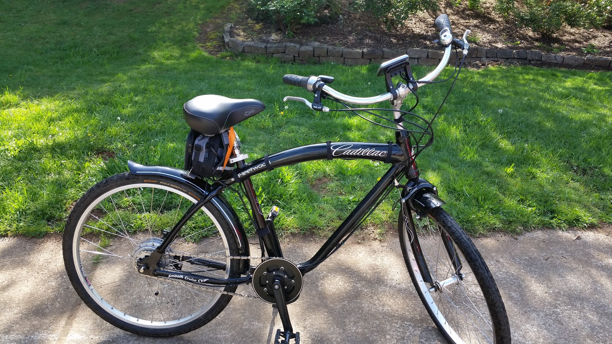

FWIW it didn't develop an oil leak, for some unknown reason the axle became loose. I did ride it on very hilly routes and because it did so well on steep grades I even took it "off road" on some extremely steep hills where I was standing and pedaling hard (with rear wheel spin) to make it up. Maybe, like any random product failure, it was a fluke.
Good memories having fun with that bike. Here it is in '14 carrying our new puppy at that time. Bike now sitting in a shed.

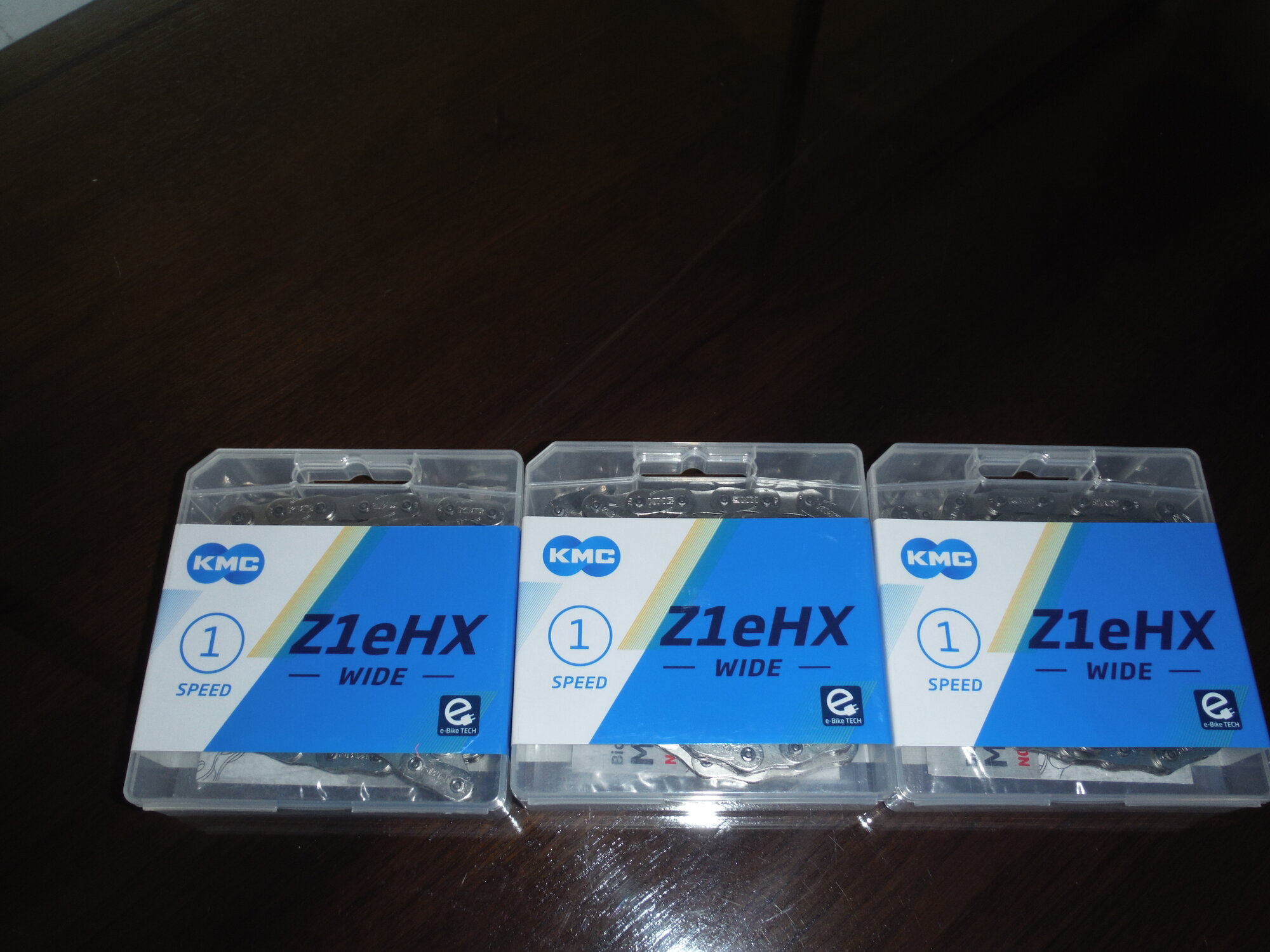

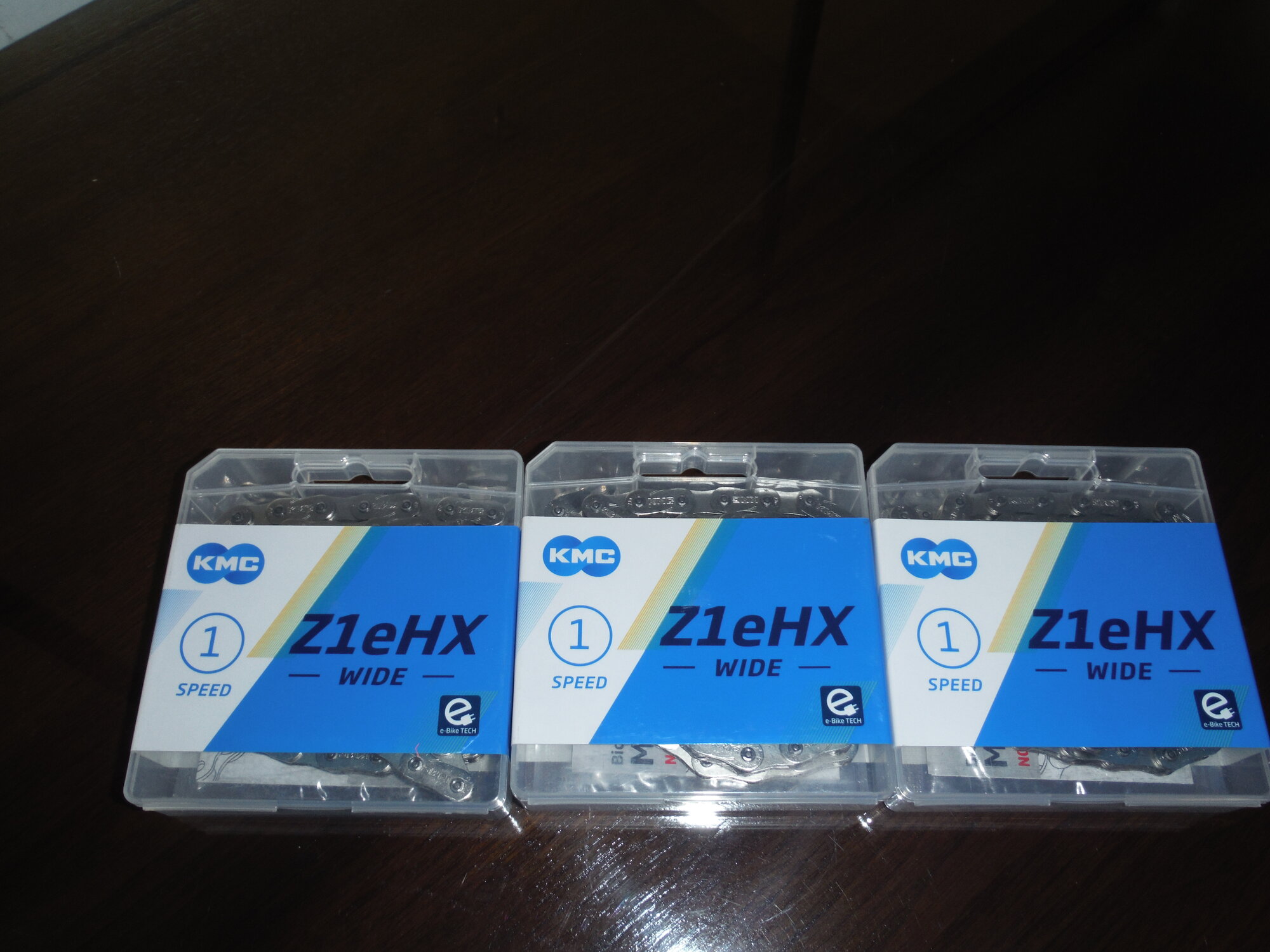

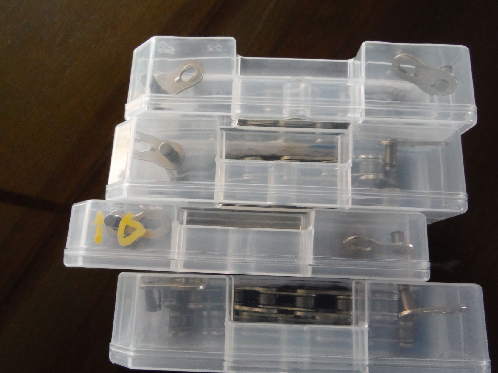

Those new single speed e-chains came in today. They look good. Notice in the second photo the pin length in the image second from the bottom compared to the quick link third from the bottom. The second from the bottom is a ten-speed chain. These new ones are much beefier. See the width of the side plates. One of these chains we be ideal for when that Nevinci arrives

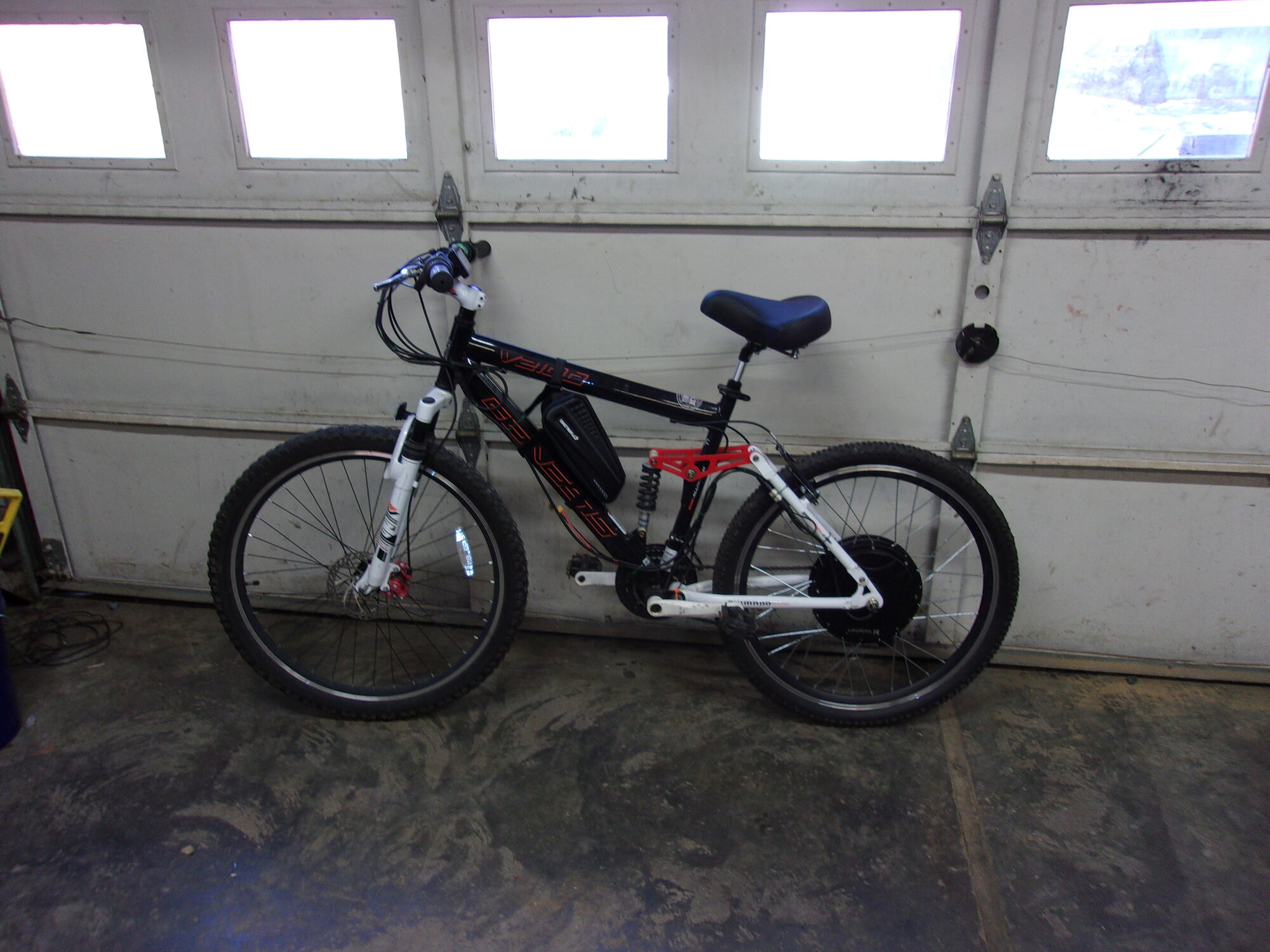

Tried to send this yesterday with another, this 1500 watt build works rather well
thanks! I’m very weak in chain knowledge. Where are wide and narrow used. I don’t understand the two different applications. My Pure needs a chain and my new single speed MAC 10T does too.

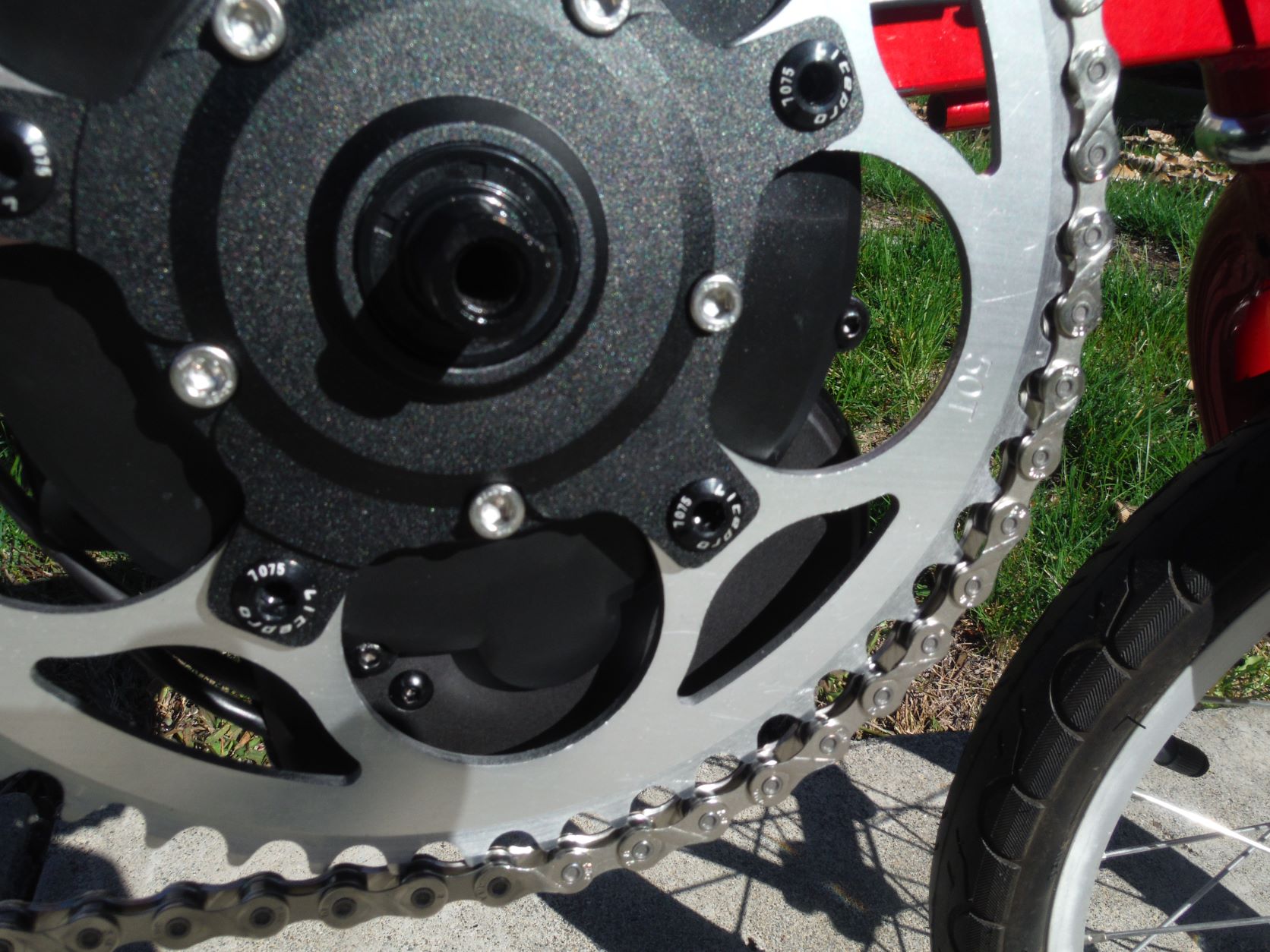

@tomjasz, If cassettes of gears are all the same width, then to create more sprockets they each need to be narrower with thinner metal, more closely spaced. That makes them less robust. An eight speed has wider cogs and a wider chain than a twelve speed. Width increases contact area. Imagine getting stepped on by a stiletto heel verses the heal of a running shoe. The running shoe is better. Single speed chains, as used on a Pure three speed, also have a greater distance between the links. Here is a photo of a single speed chainring with an eight speed chain. If you view the bottom of the chainring you will see a gap. They are not cross compatible. My expensive SRAM Eagle eleven speed lasted three weeks. I yanked it and installed a generic nine speed which is much more robust and parts are less expensive.
