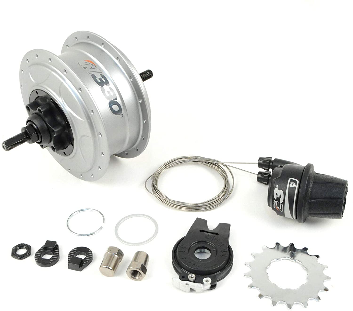

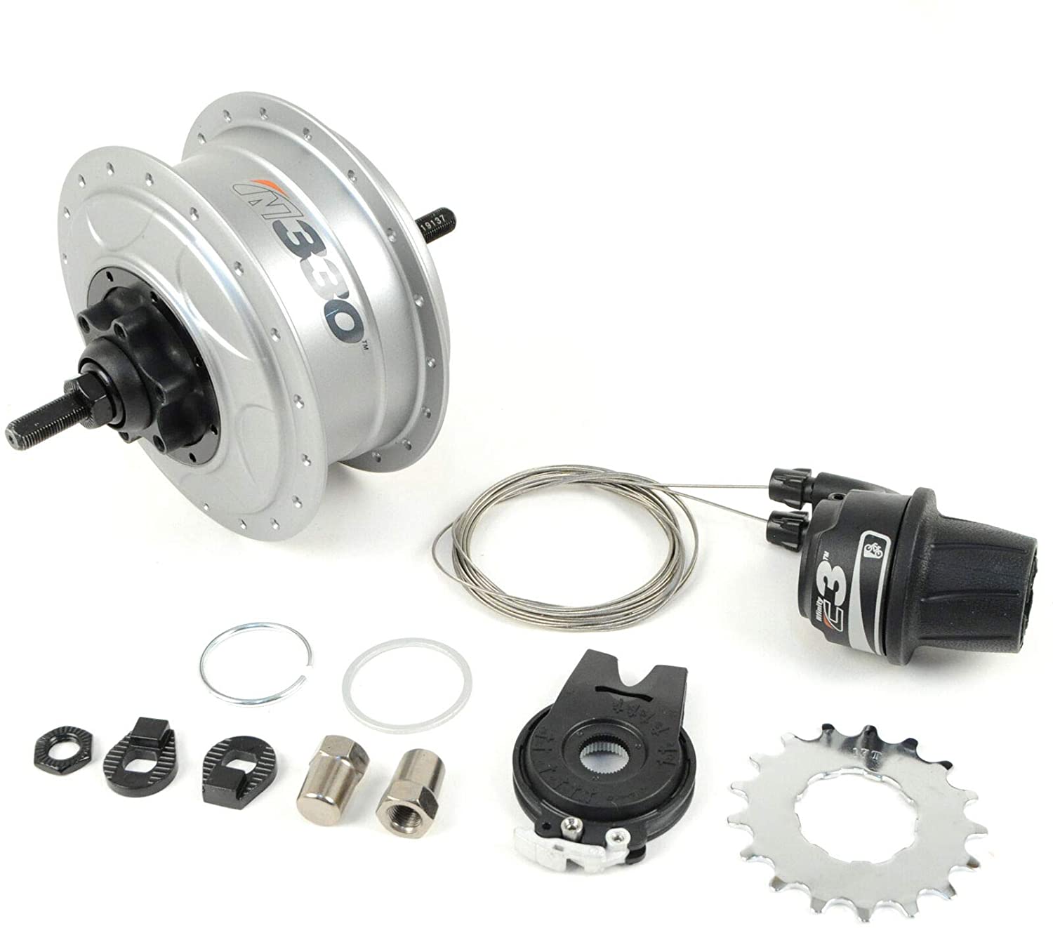

Good article. Thank you. I just saw a Nuvinci N380 kit for $199. That sounds like a bargain. You still need to lace it. Or a bike shop will cut the spokes and lace it into the old rim.

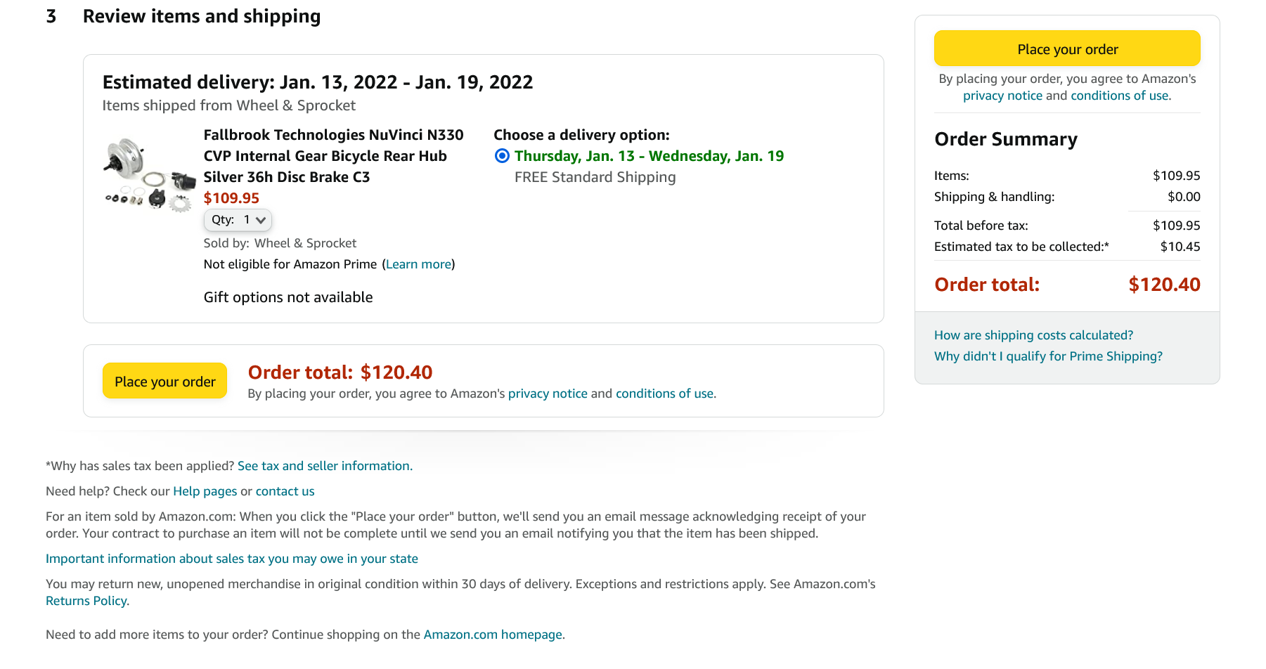

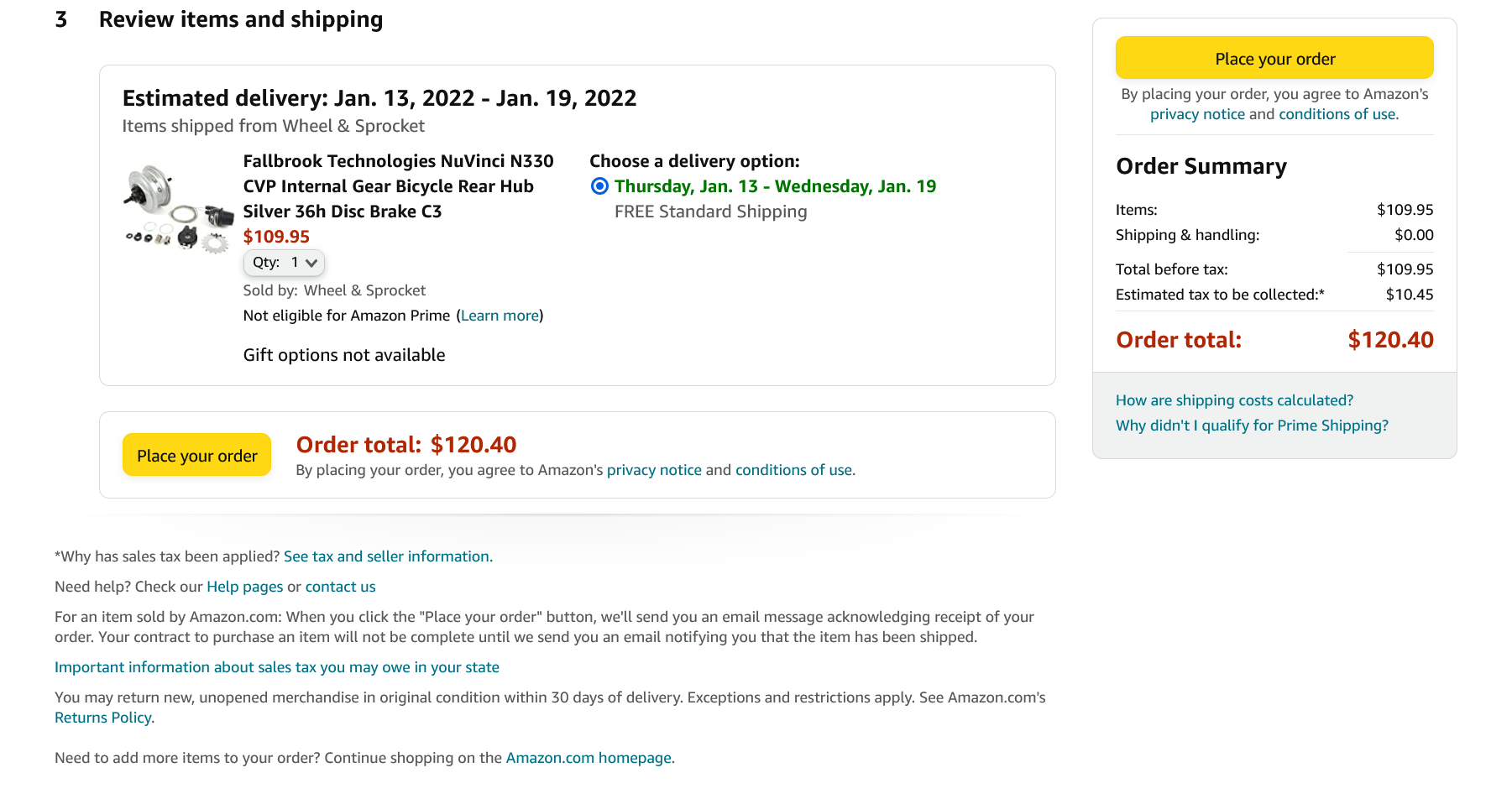

I found a Nuvinci N380 kit for $109. 135 OLD, Disc. Someone screwed up on their pricing. It is on Amazon right now. I just don't have a bike to put it on this week.

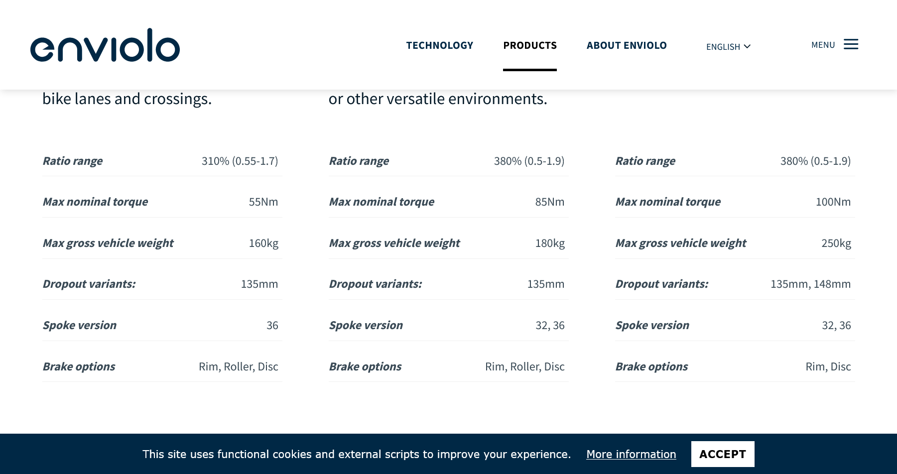

I wonder if a Nuvinci is available to fit a 170mm fat e bike frame?
They only go to 148mm. You would need to take it in by 11mm on each side, 7% each, .43 of an inch. You also would need a press. I have one and mostly use it for expansions of about 5mm. Al alloy is not good to bend around much.
