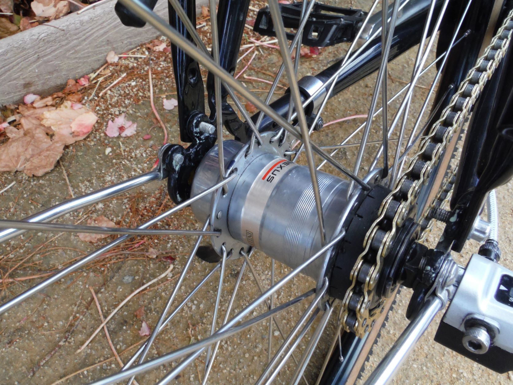

The limiting factor is the three speed. The heavy duty five speed for cargo bikes will not hold up to an HD. It is designed for Euro builds of motor plus rider. https://www.sturmey-archer.com/en/products/detail/rx-rk5. The three speed in the forest, pulling a deer with the HD will disintegrate. Those dropouts should also be reinforced. I dealt with a cracked dropout this week.

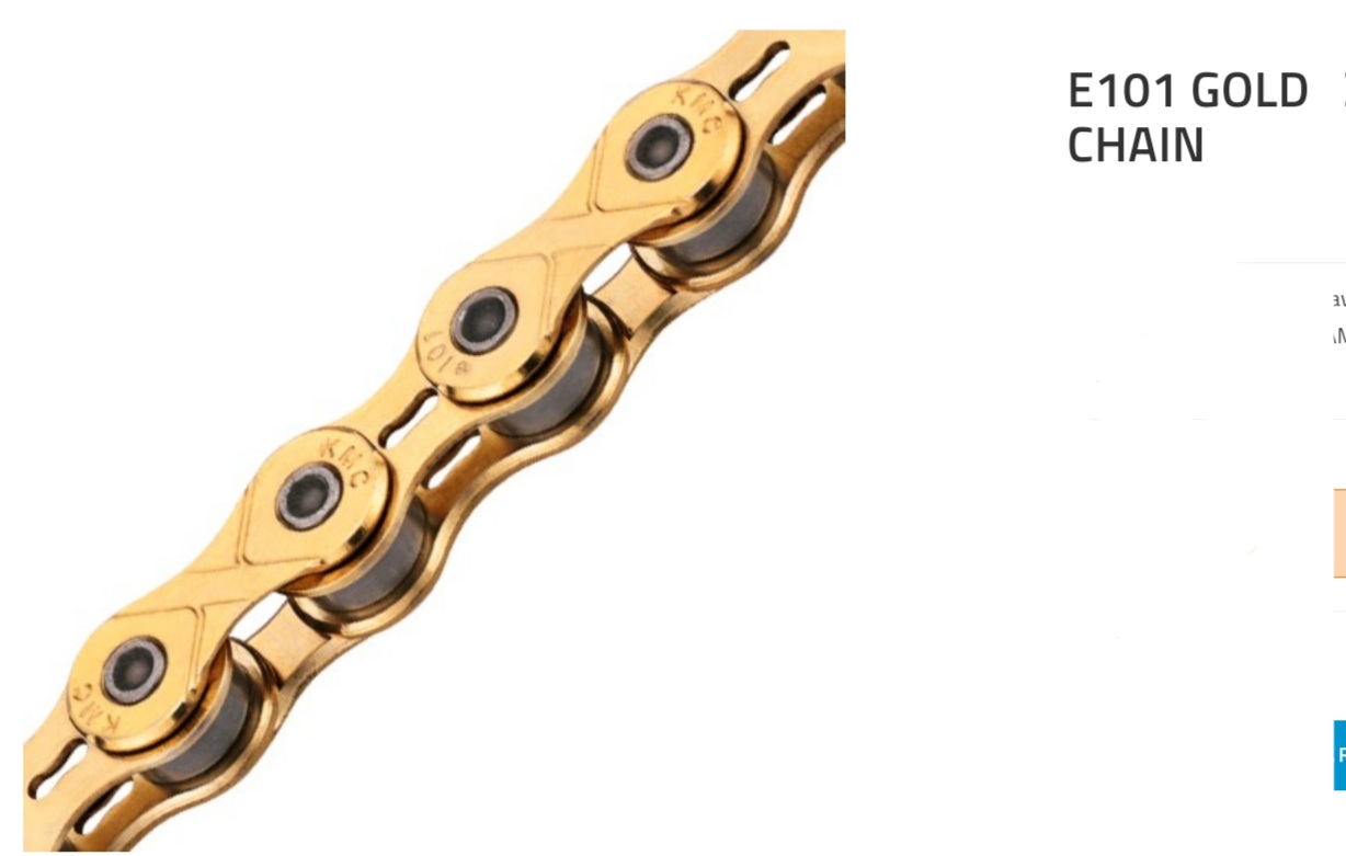

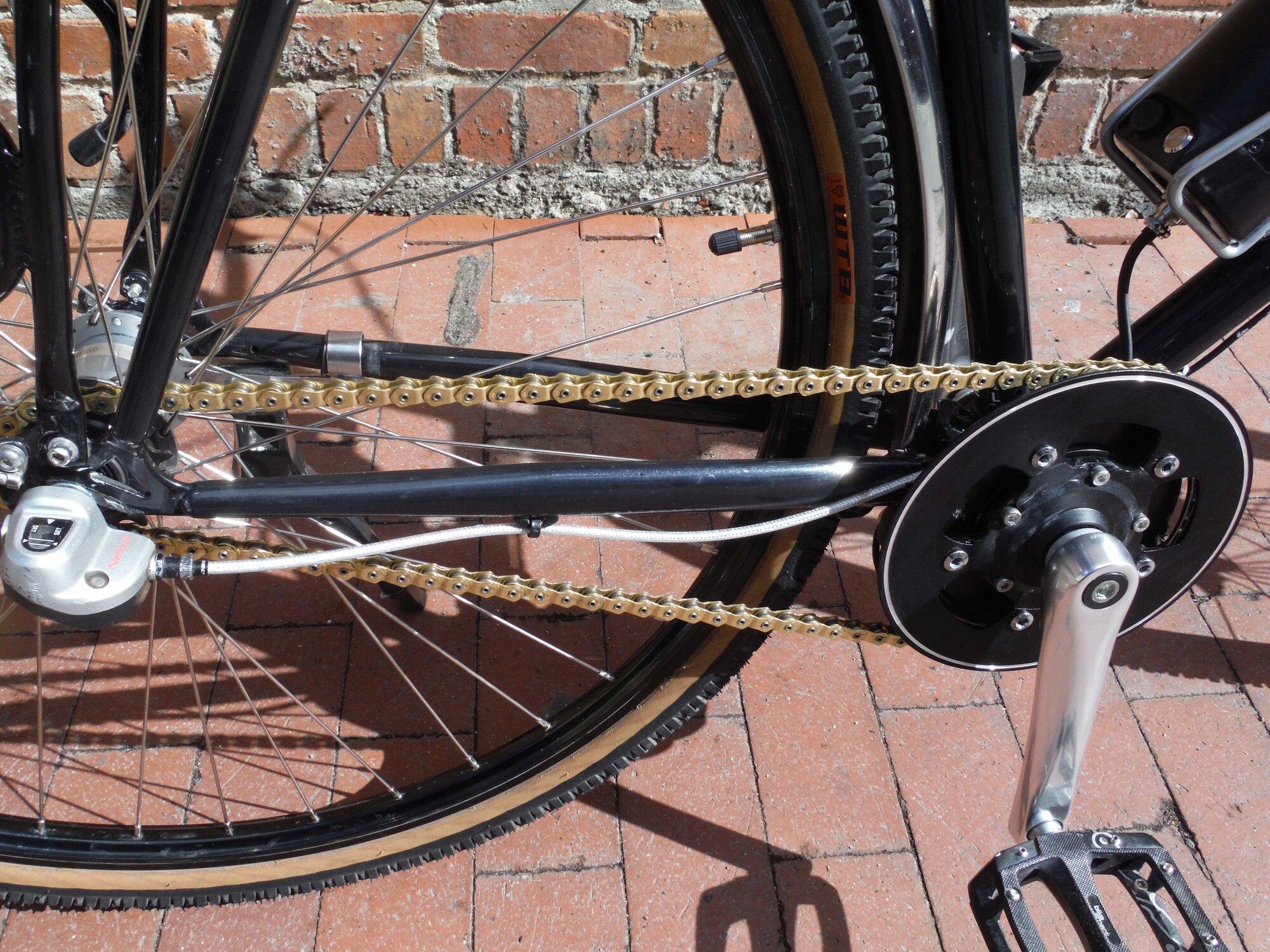

By the second time you swap out a rear cog, it is no big deal. I use 16-T on most builds. 20 for elderly in the hills and I always keep a cog selection because as you said, they are inexpensive. Check out this new chain! I am having three shipped for $54 including tax. They will be delivered on this Tuesday.

This article claims the three speed SA IGH, specifically the second gear of the SA 3sp, is stronger than any of the other common and affordable multi speed IGHs, due to the construction :
