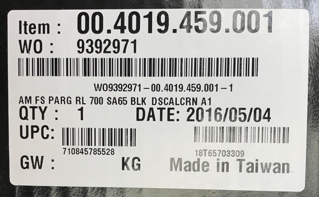

I decided to upgrade the Deore components to XT. I think the only additional change will be to add a 40 or 42 Sprocket in the rear.
Here is the list of my current upgrades.
FRAME SET
  • Front suspension Rock Shox - Paragon Gold

This is a bit old. I noticed on your Trek XM700+ you installed a Rock Shok Paragon Gold . I'm very interested in your thoughts
and opinion about the change from the Trek factory 'front suspension' . I have a an XM700+ that I ride on paved trails exclusively and would seriously
consider Paragon Gold if it will help with typical paved trail joint bumps and ripples from poor paving done years ago. Some of the 'joint bumps' are brutal.
By the way, like you I have a Body Float seat post...Wow, is it great. the best.
Thanks,
John
I notice the difference for sure. I also added a remote lockout, but to be honest I've never needed it.
jeff
Jeff,
Thanks for your reply about your Paragon Gold Rock Shox. Did installing change the way your Trek XM700+ handles and do you know
if doing the install voids the Trek 2 year warrantee ?
