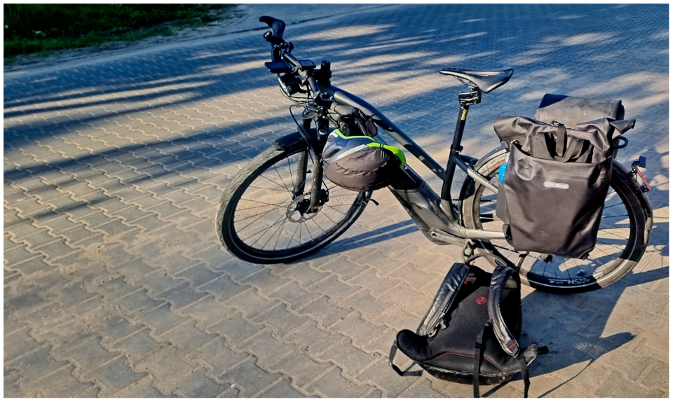

  • Fenders and racks? I'd say Specialized equips their e-bikes with quality fenders and racks, again, for the intended purpose. Moreover. Specialized rear fender, rack and tail-light are nicely integrated. I have no issue to carry heavy grocery shopping on either of those racks. Were I going on a randonneur?...

On racks, until you've used a decent double-decker rack like a Tubus Cosmo you don't know what you are missing. Because you can mount the panniers low or high you have a lot more control over the center of gravity and the stability and rideability of your bike while carrying a load. And when you mount the panniers low you can easily strap (or unstrap) stuff from the top of the rack without struggling with the panniers. Honestly very hard to go back to the generic no-name racks most bikes come with after you've used one. And that Tubus rack will easily outlast your bike. I can easily make similar criticisms about most stock front racks, with the added observation that a lot of them are unsafe even if very lightly loaded. And I've lost count of how many beefy-looking stock front racks on bikes have a chintzy 3kg weight limit.
