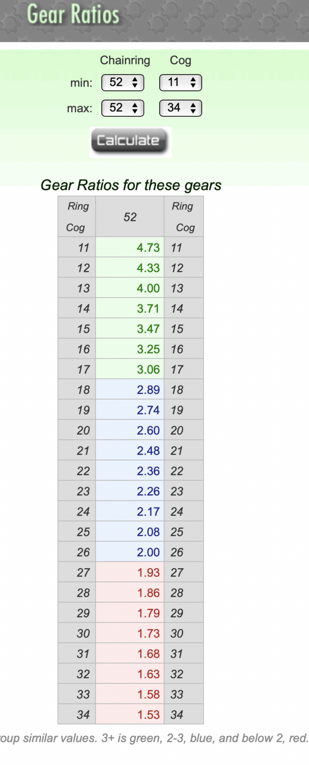

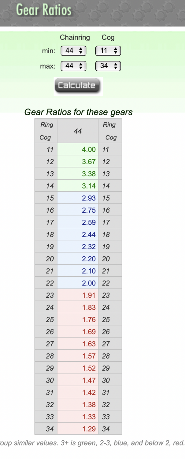

I installed the Wolf Tooth 52t 130BCD chainring on the outside of the spider and moved the chainring guart to the inside so I could reuse the existing bolts and also to align the chain better with 6-7 cogs where I will spend most of the time cruising. I already like the lower cadence. By comparing gear ratios I found online https://www.bikecalc.com/speed_at_cadence, gear 9 (11t) on 44t chainring is now gear 8 (13t) on the 52t. Gear 6 (17t) is now gear 5 (20t). Gear 1, 52t is marginally higher than the old gear 2 on 44t. I see about a full one gear change across the board. The old chain was too short so I used the largest cog to chainring method to size the chain. It's time to log some miles and try a few short moderate hills to see how it climbs.

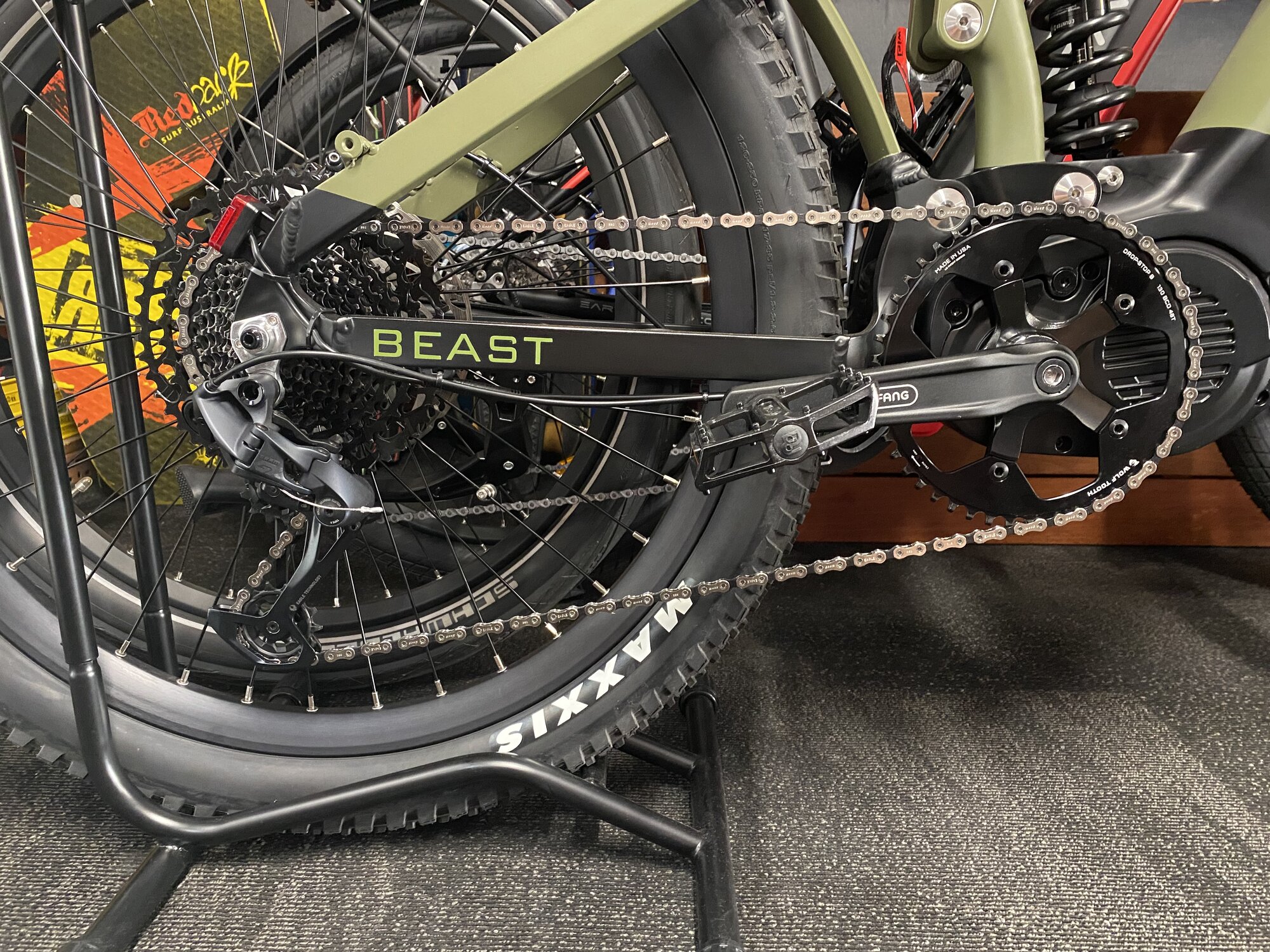

I upsized the chainring to a WT 48T on my Ultra powered Frey over a year ago with lengthened chain. Removed the chain guide in the process and never had a problem with the chain dropping. I did buy the WT chainring bolts, but snapped one when torquing, so just reverted to the stock bolts which are heavier duty.

I replaced the front chainring on my Luna Apollo. Since that came with a Wolf Tooth narrow-wide, that's what I stuck with. Clearance with the frame restricted how big I could go. Years and thousands of miles later not a single chainring related problem.

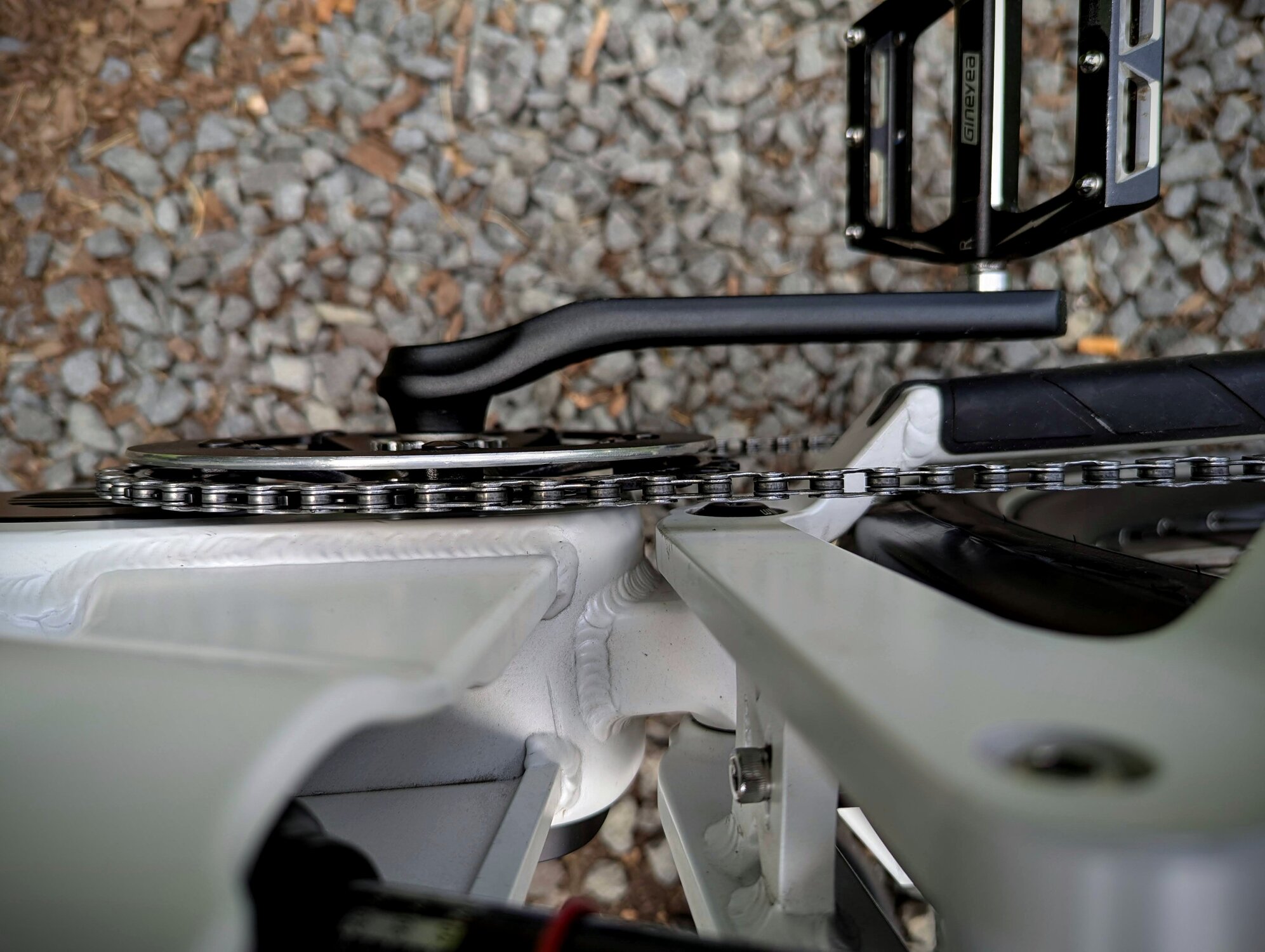

The Ultra mtb spider doesn't have enough offset to mount an inside guard.

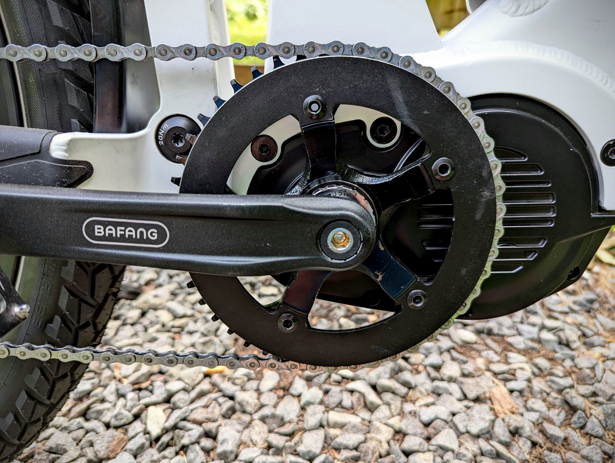

Did a bunch of work on my bike today... New wheels, tubes, tires, chain, tensioner and yes a chainring. The test 46t went right on and I reinstalled the 40t guard so the bolts didn't protrude the nut on the backside leaving the threads exposed to damage. My luck I'd bash one on a rock making it a bitch to remove.
Fyi.. The spider, chainring and guard are all about 4mm each in thickness with the spider sandwich'd in the middle.
Went for a 25mi ride afterwards and I like it. Moved me a gear down making my lower gears more usable and my highest gear almost impossible to spin out... all still feeing easy to pedal without extra motor input. I'm curious to see if my average wh/mi changes.
