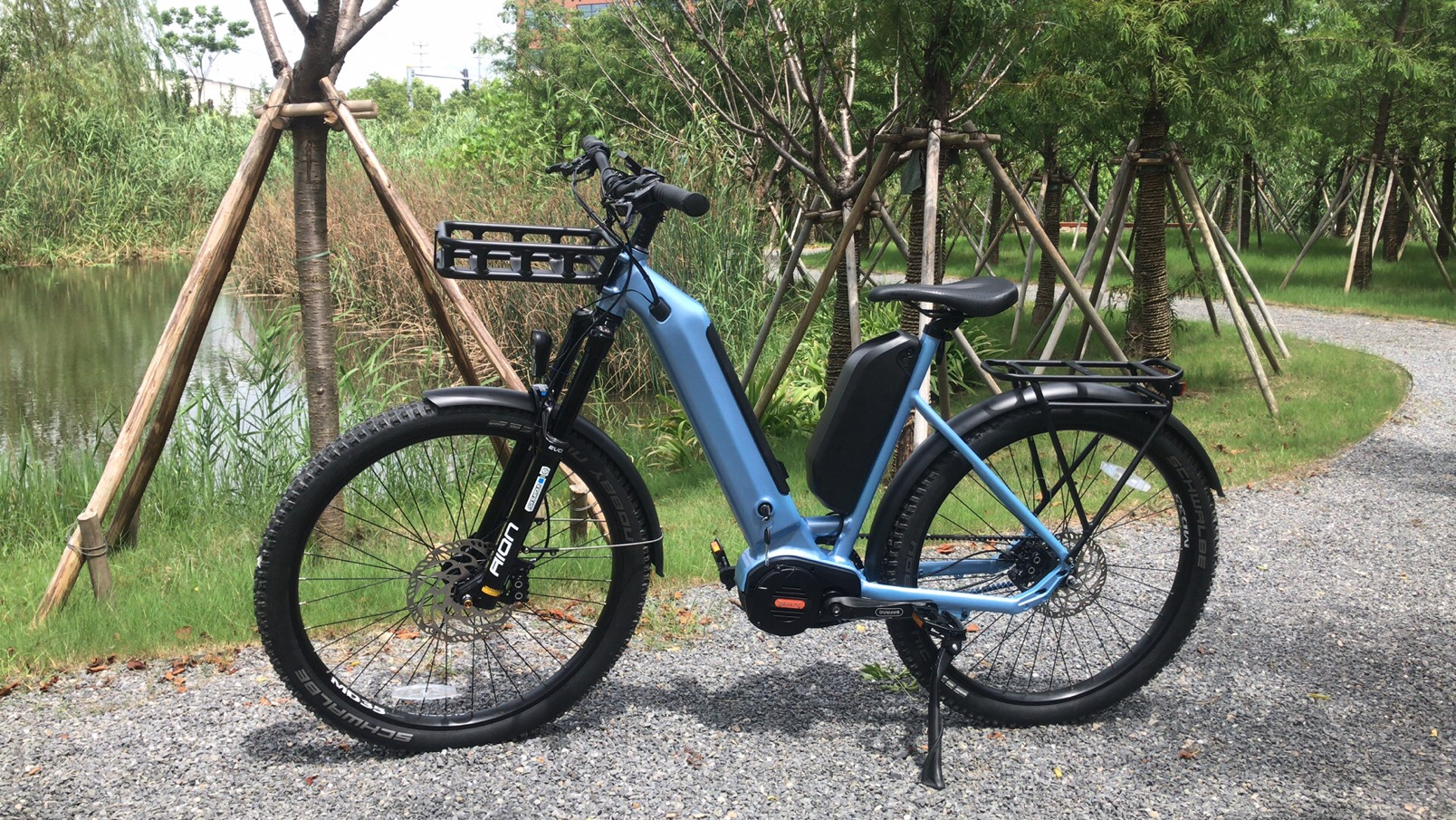

UC Pro Diamond frame prototype build pics. Painting / Decal / lights etc will be done in Boston.

Looking very nice Pushkar. It looks like you did a good job of cable management too.
On a side note I even like this color.
Looks too close to the FLX without nice contouring on the beams. Looks like the FLX was used as the basis for the design, then the ascetic elements rolled back to reduce costs. ...or... NOT
Looks ok though.
Looks ok though.
1. You are right - we are sharing the same downtube as FLX, and a lot of other bikes (the new biktrix, etc). This is done to ensure that batteries are available longer term and you are not tied to a single vendor (in this case WW).
2. Our geometry is substantially different from FLX.
3. Nice contouring any bike is great - but having a "straight line" is not feasible with multiple bike sizes that the US Pro is available in.
4. Straight line contour is also hard to do if we have to do dual batteries (the triangle needs to be bigger) - which is what UC Pro does, and FLX doesnt.
5. I posted somewhere else - we ran the FLX geometry (among others) through differnt modeling scenarios and we found cases where some of those frames may have critical structural failure points. These frame also have a load limit of 225/ 250lbs. Our bikes are built for 300+lbs and in our modeling have far fewer critical structural points. We are using substantially different amount of material.
5. We also have the same load limit on our step-though frame. That is a form factor that is not available on the FLX.
Yes, you are absolutely right that our downtube is common (by design). IMO would say that the downtube precisely where both bikes start to diverge pretty substantially.

also... as a tall guy, I’m excited there is a sizing option for us 6’4-6’9-ers. This sets WW apart for sure!
This is just the frame test build. We will assemble and paint in Boston.
Nice looking so far Pushkar.. Is the frame test a standardized process or company specific ?.. i.e. What you are comfortable putting a warranty on and name behind. Thanks
Great question
1. The frame passes EN / ASTM tests.
2. We test for load ( cargo) - so heavier seat tube, and headtubes + better quality welding.
In general typical frame welding that you notice on regular bikes will cost around $40-$70 / frame (typical). Ours is double welding + smoothening. So our welding costs are double of that number, broadly speaking, ignoring frame style (step through or diamond).
Essentially we are building a cargo bike in a commuter geometry and style for all intents and purposes. ;)
