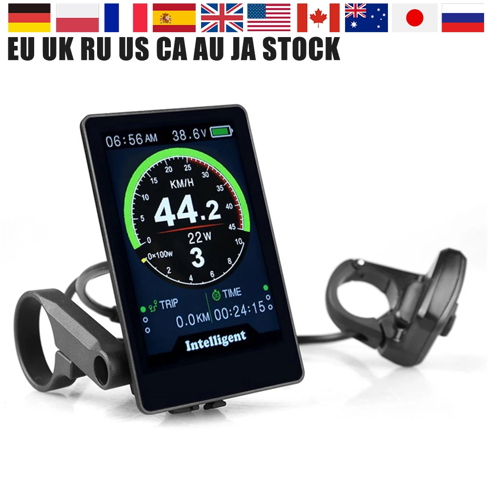

860c imo has the most functionality and the best visibility in bright sunlight

Just for clarification... There are 2 so called 860c displays out now. A New one that sometimes does not have the P prefix in its description.
I was referring to the older 860c

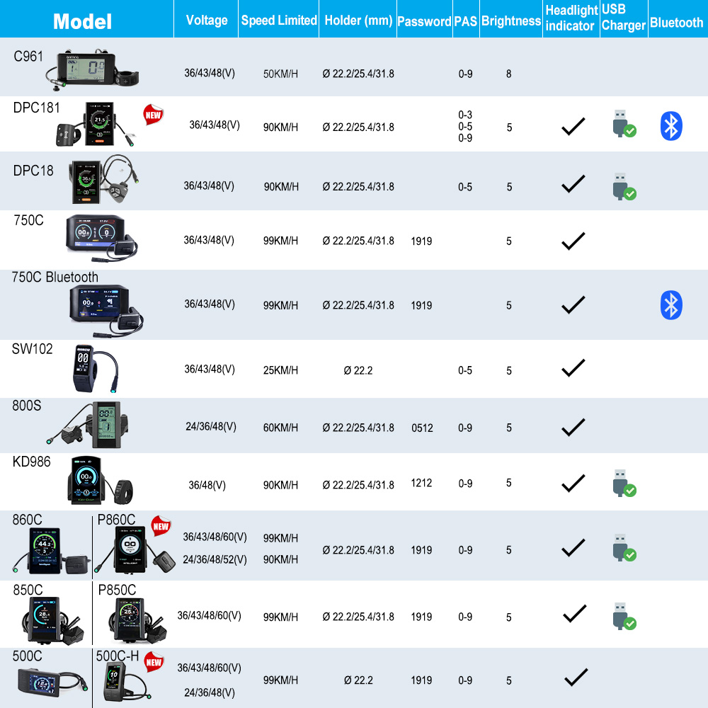

Then there's these...
https://www.aliexpress.com/item/32857206665.html?spm=a2g0o.detail.1000060.1.3f1d7f7et4EGnF&gps-id=pcDetailBottomMoreThisSeller&scm=1007.13339.274681.0&scm_id=1007.13339.274681.0&scm-url=1007.13339.274681.0&pvid=c771fac1-7cd9-4f85-99ca-78fb6a299fbd&_t=gps-id:pcDetailBottomMoreThisSeller,scm-url:1007.13339.274681.0,pvid:c771fac1-7cd9-4f85-99ca-78fb6a299fbd,tpp_buckets:668#2846#8113#1998&pdp_ext_f=%7B%22sku_id%22%3A%2212000016670719444%22%2C%22sceneId%22%3A%223339%22%7D&pdp_pi=-1%3B46.03%3B-1%3B-1%40salePrice%3BUSD%3Brecommend-recommend
Do your homework as not all have all options like being able to select 3 - 5 - 9 PAS settings

The question I have is,
my original Display (DPC-18) has 5 Eco and 5 sport settings,
the DPC-181 display has 0-3, 0-5, 0-9 settings and Blue tooth (what ever that is ?)
Would the DPC -181 display settings be the same as the OEM display,
and is this (181 display Uart programable, I must have USB and thumb throttle, headlight connections, out of all the above listed displays,
there is only 4 that would work for me.

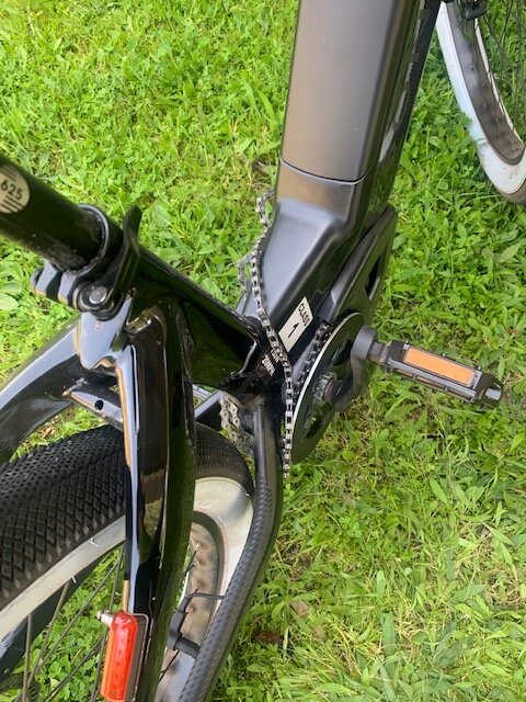

Do be carful. My buddy is out in the boonies at this moment waiting for AAA to pick him up. He has a broken chain on his kilowatt bike with a throttle. It has standard programing. This is his second chain and cassette. Today he will get his third. The first set lasted one month. He is 300 pounds and uses his throttle on major climbs. He put a class 1 sticker on it because to him it is a first class bike at 1000 Watts.

My buddy is not mechanically inclined and does not apply lube or check the wear. The quick link was the weak link while down shifting under load. He heard clicking when it loosened but did not stop. Now it is jammed behind the chainring and against the frame. It takes force to do that.

Those guys are using quality cogs. Tourney freewheel on this Sondors is made from soft cheese it is what wore the chain as the space between teeth grew. This is where he was riding. For a 360 use Google Maps and put in 1000 Wilson Hill Rd. Petaluma. Street view.
