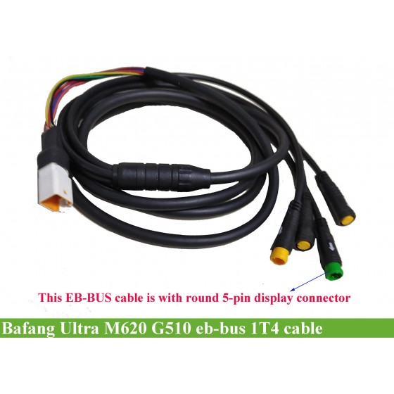

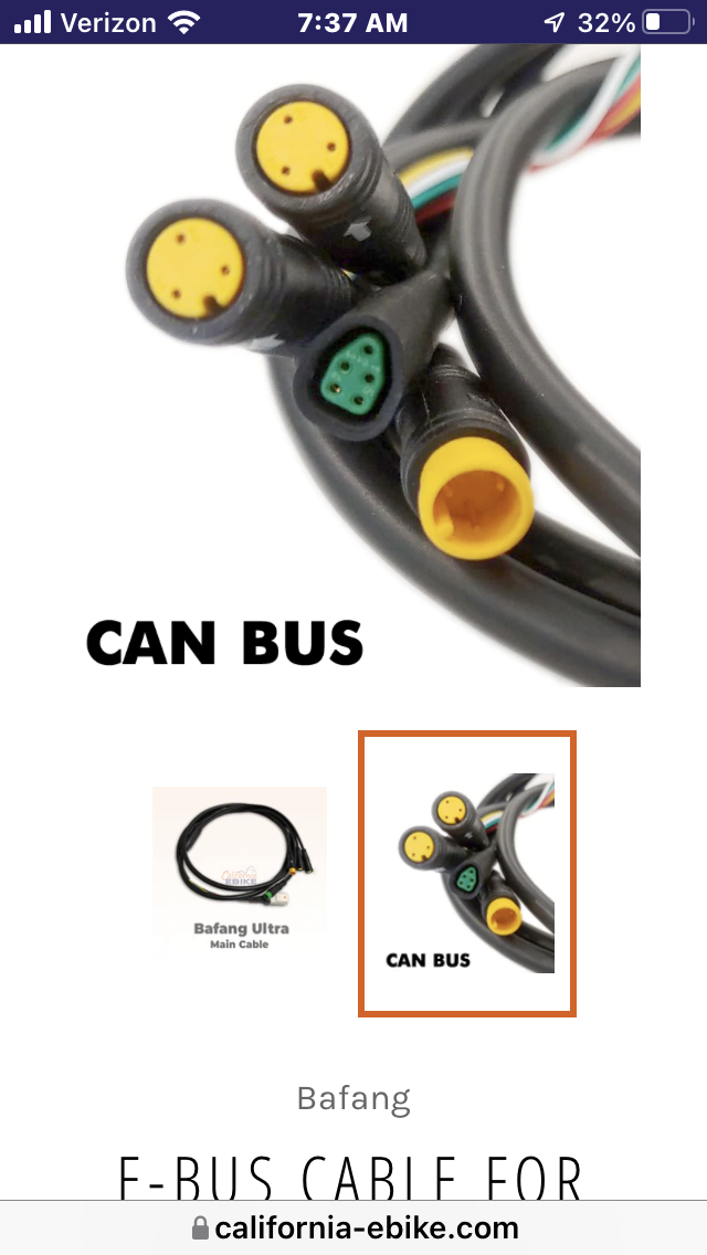

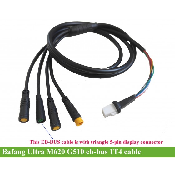

Possible that they just changed the male/female orientation? Note the motor end.
Take a look here.
Hint: use the desktop version of your browser on a mobile device
View attachment 119001View attachment 119002
There we are. I don't know how much easier we're gonna get
Mxer, Thanks for the photo's,
There is the "U" 1.5 in the top line, so it might be a Uart motor.
It is hard to tell, from the other photo's,
but, I think the motor attachment plug is also a female,
and there is a round Green colored 5 pin plug (display connection) shown also,
which indicates a Uart motor..

And there is a difference to those 2 cables, one is a male and the other is an female, I am talking about the motor attachment ends etc, (get your minds outa the gutter).

The motor (controller) plugs directly in to the white 8 pin connector on those cables... So basically you are looking at the opposite mating end and can determine from there.
