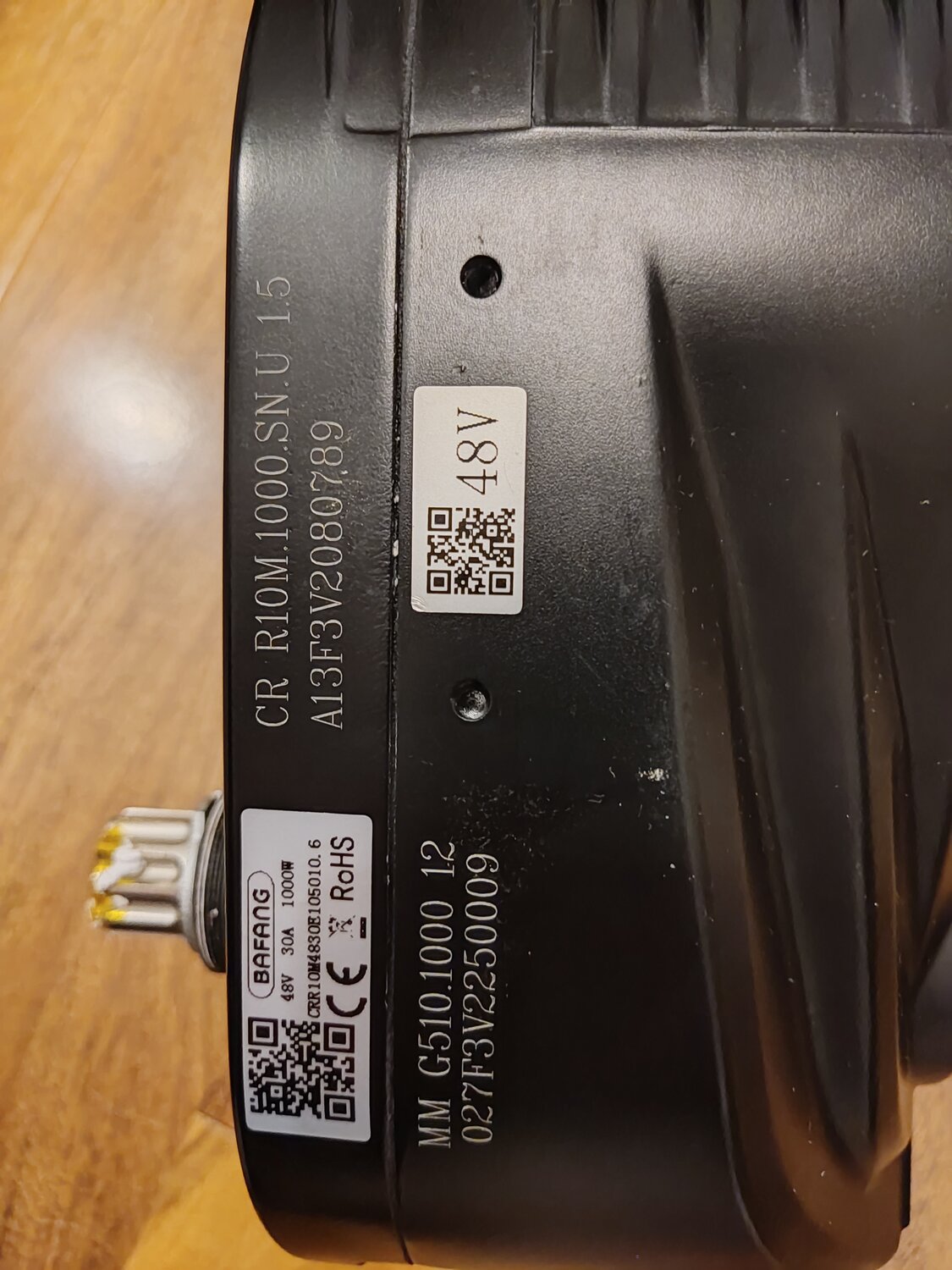

I have some numbers from a very small sampling of M620 & G510 motors,
I was hoping for about 6-7 of the Canbus same models, 750/1000W
then I can see if the numbering follows thru and make a SWAG etc.
Thanks,
Don
As an update to the above post/info,
Now that I have a small sampling of info on the above,
so far I am 100% correct in that you can ID a Canbus/Uart motors & controllers,
from the info blocks stamped on the bottom of the motors/controllers
and other info about these parts, for the M620/G510 motors.
If you think, I am wrong,
post a clear photo of the spec's block from the bottom of the motor/controller
and I'll tell you what protocol you have for the 750/1000w motors etc.
DO NOT post or tell me what you think it is.............I'll reply with my info,
then you can reply.
Tia,
Don

The G620/M510 motors can be id with the serial numbers on the motor and controller cases and via the connection plug types on the motor,
as supplied via the OEM.
On the bottom of the motor where all the info numbers, the UART and CAN are marked in a little code.
