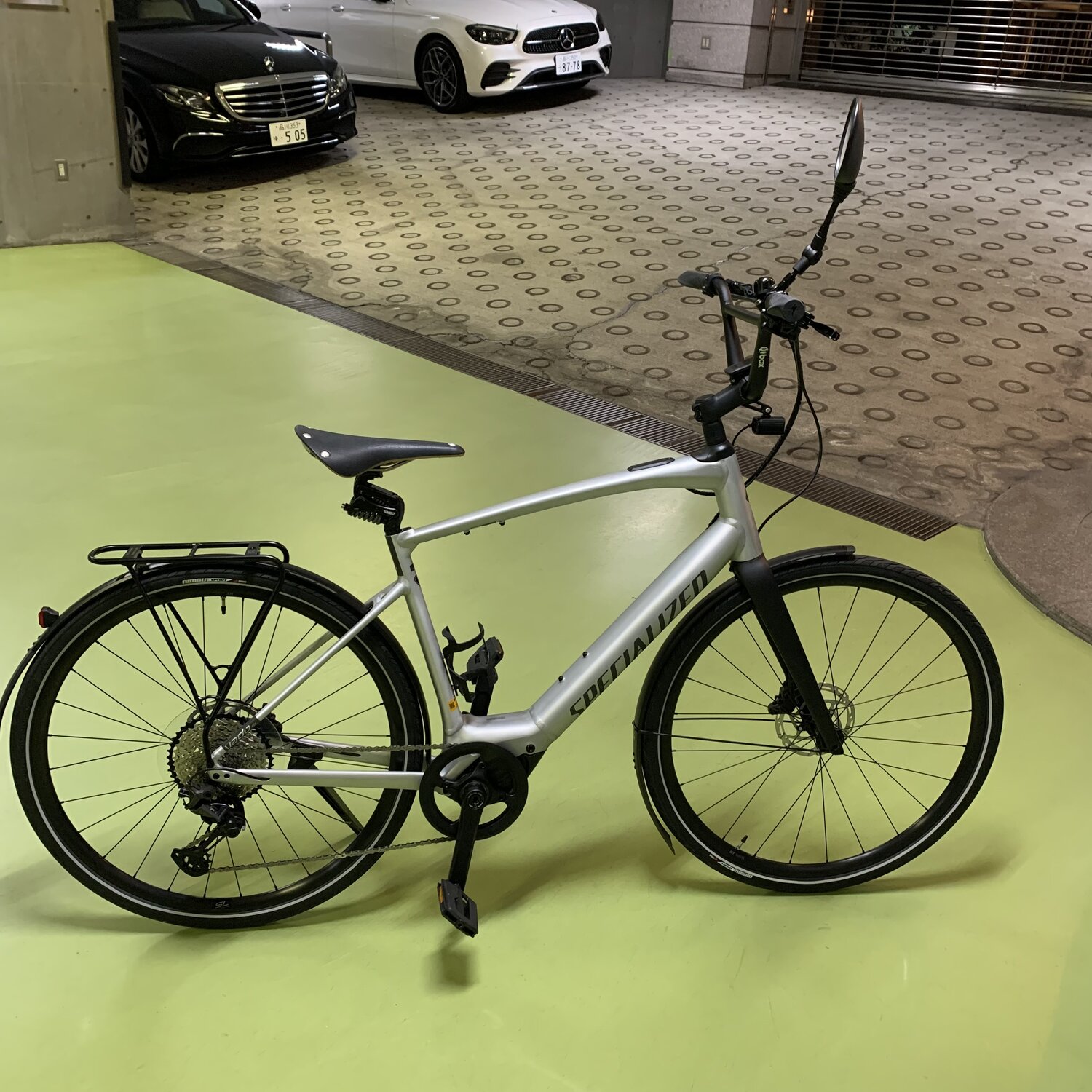

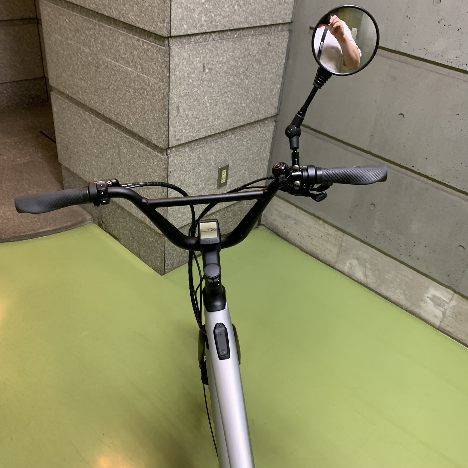

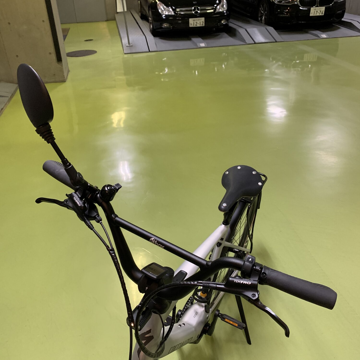

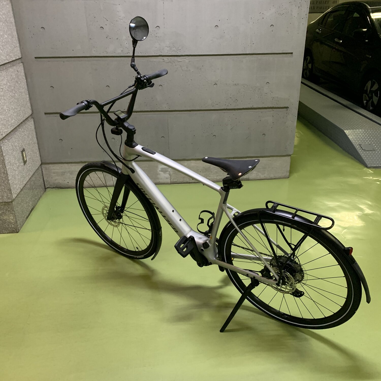

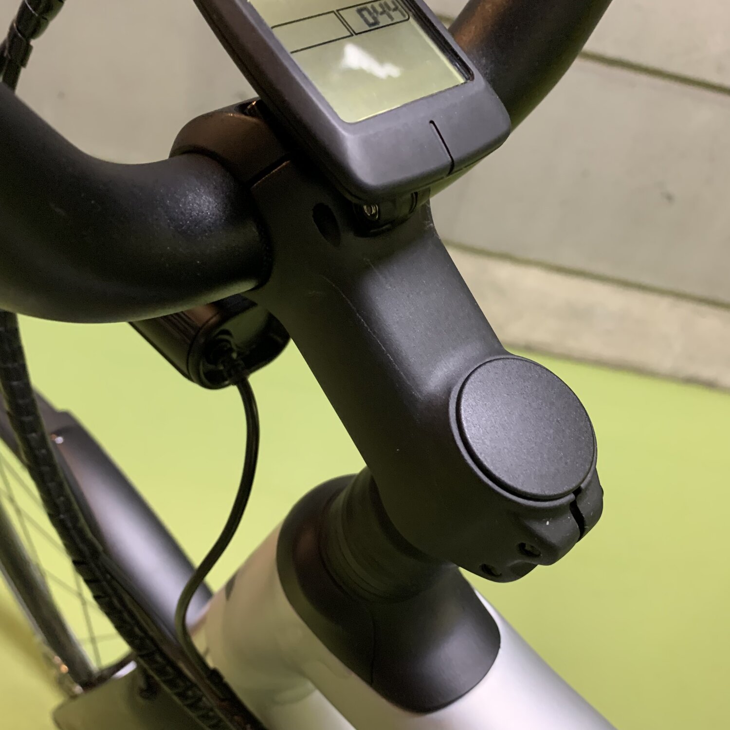

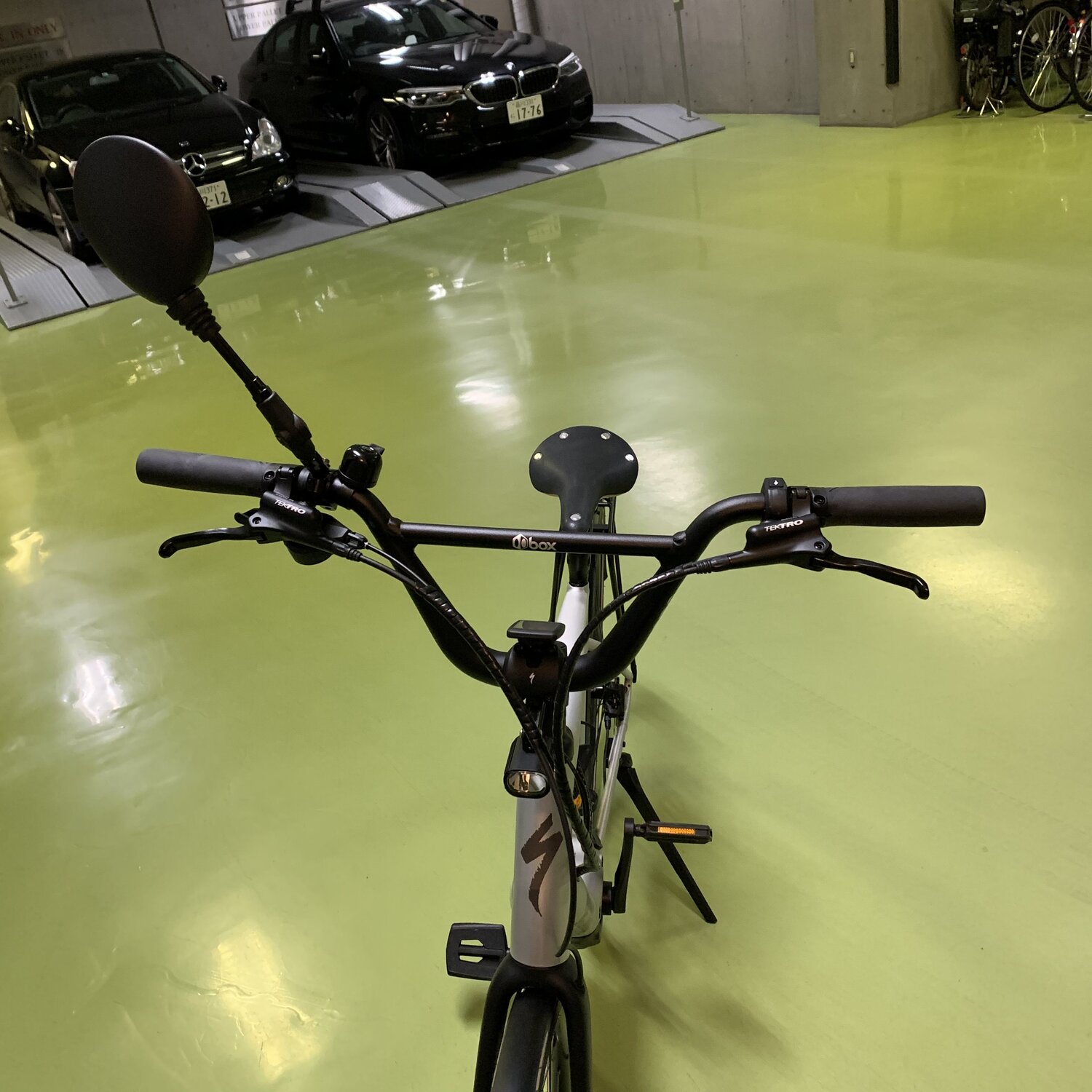

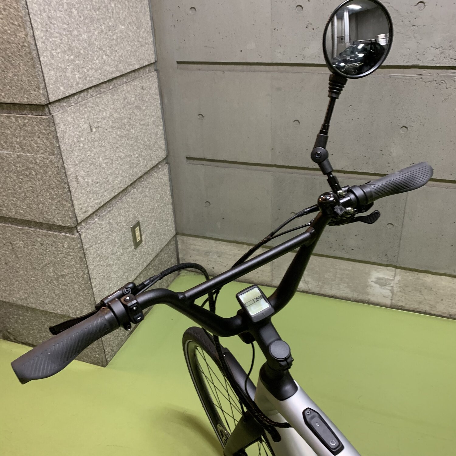

@GuruUno - Your certainly welcome to give it a ride if you’re ever in Tokyo! In the meantime here’s the pics :
The mirror was meant for a 1980s Honda Cub, but it’s been repurposed 😀
