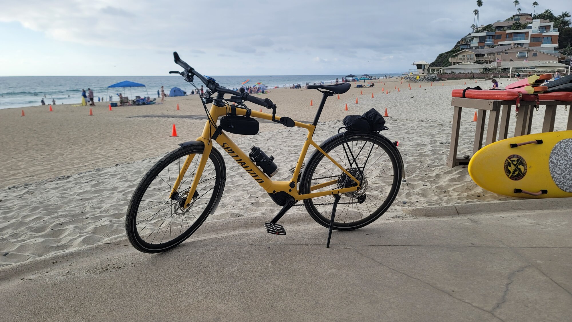

View attachment 182333View attachment 182334
Rode the brand-new SL home the long way: 21 mi over several key test hills and along the coast with 1,243 ft of elevation gain on grades up to 10% per RideWithGPS.
Used ~60% ECO, ~20% SPORT, ~20% off, and no TURBO. Most hills conquered in ECO alone. Average rider power ~120W. Battery remaining 54%.
So the many yay-sayers were right all along: The SL will clearly get me around my usual terrain just fine — no, way better than fine — with acceptable exertion, knee loads, and battery range.
A few initial impressions relating to things you guys helped with...
1. What a sweet ride, inside and out! Much more powerful than expected, the low weight is a joy, and the responsiveness, agility, and rolling resistance are just what I'd hoped for.
2. Impressed with the Specialized app so far. Between the app on my phone on the bars and the customizable TCU pages, no need for a separate bike computer for the foreseeable future. Speed, cadence, rider power, and distance are visible at a glance, and that's really all I need in the saddle. Plus, easy to transfer rides directly into RideWithGPS for gradient display.
3. @Prairie Dog , the standard QuadLock out-front mount works fine pointing forward. Phone battery drain was quite acceptable for 21 mi, even with the screen always on.
4. The ordered suspension seat post didn't get installed, and I didn't miss it on this shakedown ride on generally nice pavement.
5. The LBS jumped the gun on replacing the stock 44t chainring with a Wolf Tooth 40t (above). Lost the chain guard in the process, but now that the 40t's in place, it feels like a keeper.
6. We'll see what's sore tomorrow, but fit, position, and saddle seem pretty good so far. Palms and wrists complained a bit after 15 mi or so, but they're used to a more upright posture. I see Ergon grips in my future.
7. Getting enough onboard storage without a full-size trunk bag will be a challenge, but this small ALMSTHRE frame bag with no TCU or boss interference will be part of the solution.

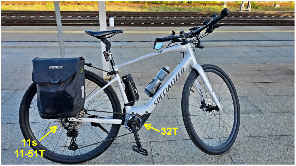

Jason, just for your information: I was trying 32, 36, 42 and 44T chainrings on a Vado SL as well as 36, 42, 44 and 48T ones on a Vado 6.0. No issues. The only limiting factor is the maximum chainring size.
You may ask Specialized how come a Levo SL comes with a 32T chainring with no adverse effects :)
