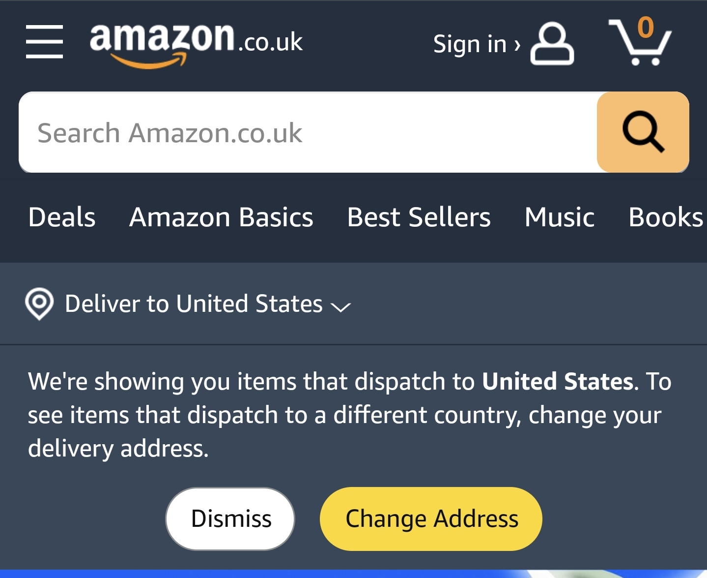

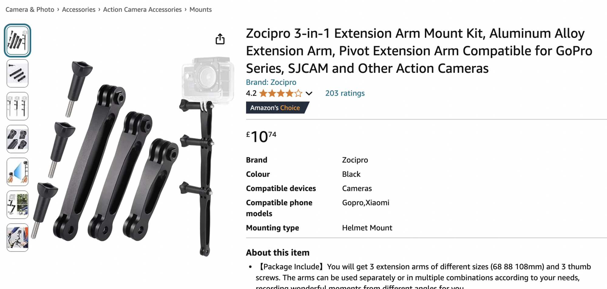

Something cheap and cheerful from Amazon or eBay I think ... almost certainly this one: https://www.amazon.co.uk/gp/product/B09KV89XYR
Many thanks!Something cheap and cheerful from Amazon or eBay I think ... almost certainly this one: https://www.amazon.co.uk/gp/product/B09KV89XYR
