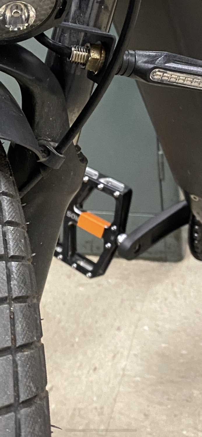

Hey Jeremy, I used reflective tape around the middle bar. I figure some of it may be visible through the holes or at another spot in the pedals while you are pedaling.

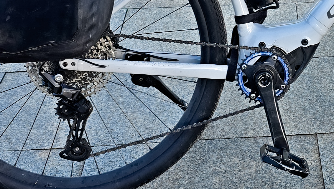

Thanks! Your encouragement and shared experiences had a lot to do with the final result here — both on the SL itself and on the lowered gearing. The 40t was my first guess based on experience with my hub-drive on local hills, and it's working out perfectly.

An oft-repeated argument for mid-drive motors is that they "take advantage" of the bike's gears. How this actually happens is seldom stated, but the usual implication is that the gears are somehow amplifying the motor torque delivered to the rear wheel.
Problem is, this can only happen when the selected gear's an underdrive (cassette cog larger than chainring). In fact, most ebikes are sold with no underdrive gears or a 1:1 at best, mid-drives included. (I look at a lot of ebike specs with gearing in mind. The Vado SL and Creo 2 are notable exceptions.)
Without modification, all available gears on an ebike are typically overdrives (cog smaller than chainring). And overdrives reduce the motor torque delivered to the drive wheel. No way around this without an internally geared hub.
As @mschwett taught me, the entity actually "taking advantage" of the gears on a mid-drive is the rider trying to keep cadence in the motor's sweet spot for efficiency and torque.
And I'd wager (1) that most mid-drive riders don't know that that's their job, and (2) that few watch their cadence or even know their motor's optimal cadence range.
