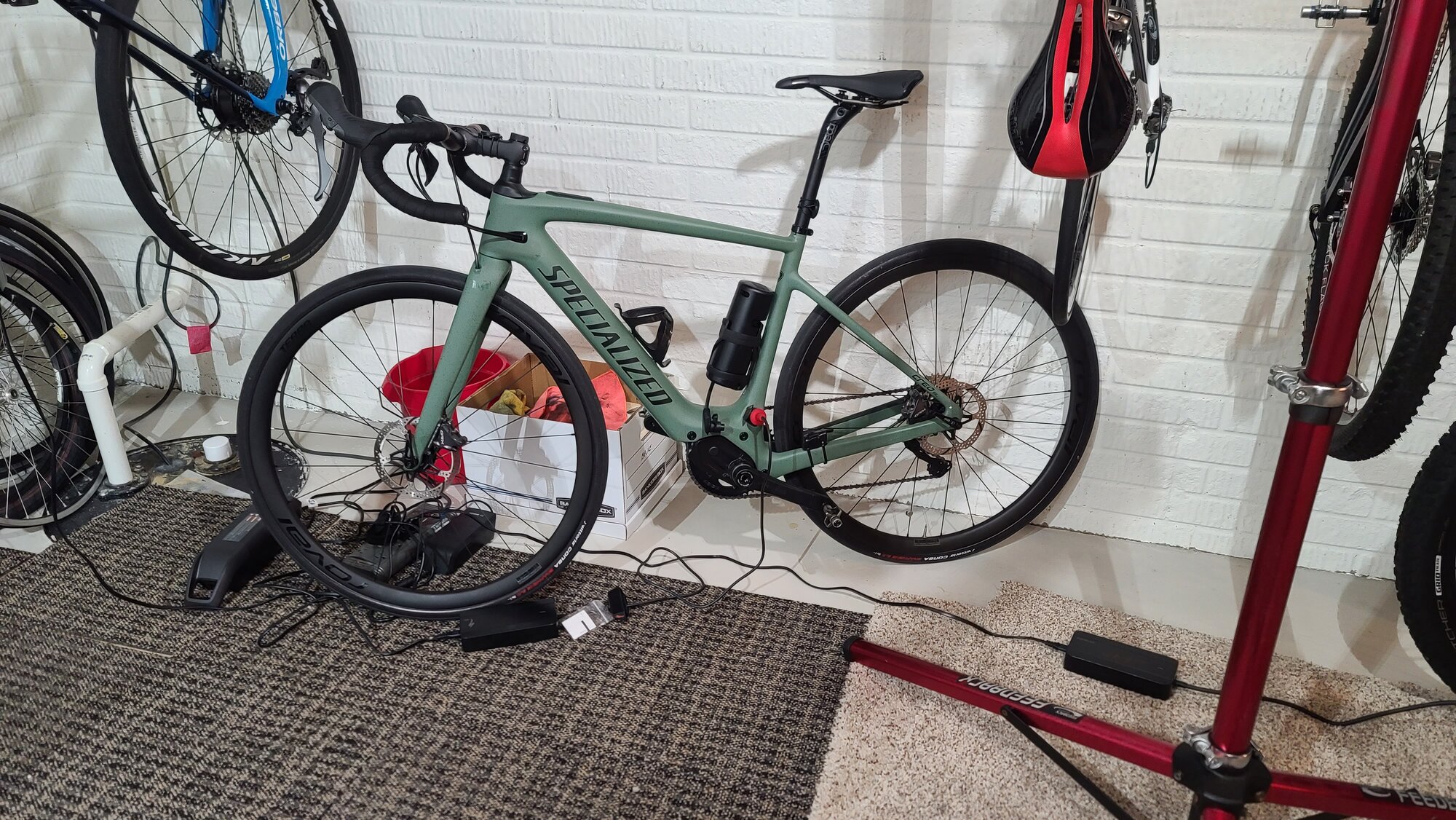

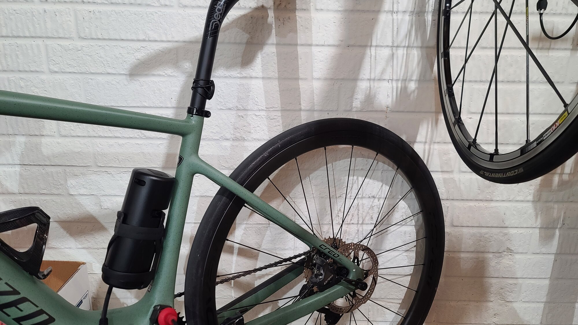

Made a few changes on mine, got rid of the dropper, new wheels with road tires 32mm I think, a 11-32 rear cassette and a range extender.
If you ever start hearing a clicking noise when cranking away let me know. I have a fix.

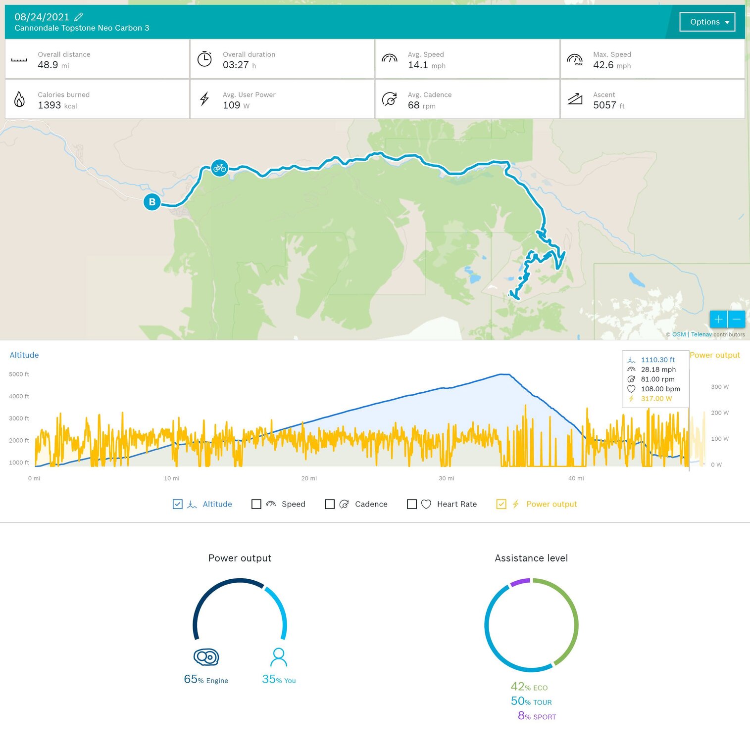

I have the Cannondale Topstone Neo Carbon 3 and did a 48 mile 5,000 mountain route with a good buddy a while back. The Cannondale has 47mm WTB Tires, tubeless, Bosch gen 4 speed motor with 500 watt battery (plus a fully rigged spare with cover). My friend rode his Creo Expert and frankly, I could pull away from him with ease at any grade. He is a former road pro road racer, ten years my junior and fit as a fiddle. I used all of one battery and needed the second one to go the final 4 miles. He has the bottle range extender and used his main battery and half of the extender. At the end of the ride he was slightly envious of my extra torque and battery range, but still very happy with his bike.

Your ride looks amazing, what a treat! Funny, I had the Cannondale Neo in my final 3 of candidates (and I have a lefty Bad Boy 2 urban bike in my stable, so, I’m well familiar and a fan of their bikes). If I were to be doing only gravel I would have probably landed on the Neo. I hear what ur saying about the Creo not having the oomph of the Neo, that was my suspicion as well. I just got back fr my debut ride, only one big climb (Paris Mtn near Greenville), little more than two mile duration, averaging 8% grade, max gr prob 15%. My Creo cruised this climb, not really breaking a sweat, so I don’t think Western NC (even with the slightly bigger grades) will be daunting. Altho, I’m more or less resigning myself to go bigger than my stock 38mm tires, given the roads I’ll be on are a mix of gravel & asphalt.
For your area, given the bikes I did some deep dives on, the Neo sounds superb. By the way, based on ur friend’s background, I’d love to hear his impression of the bike (Creo) if he’s so inclined. I’m guessing he’s pushing the upper bounds of this bike.

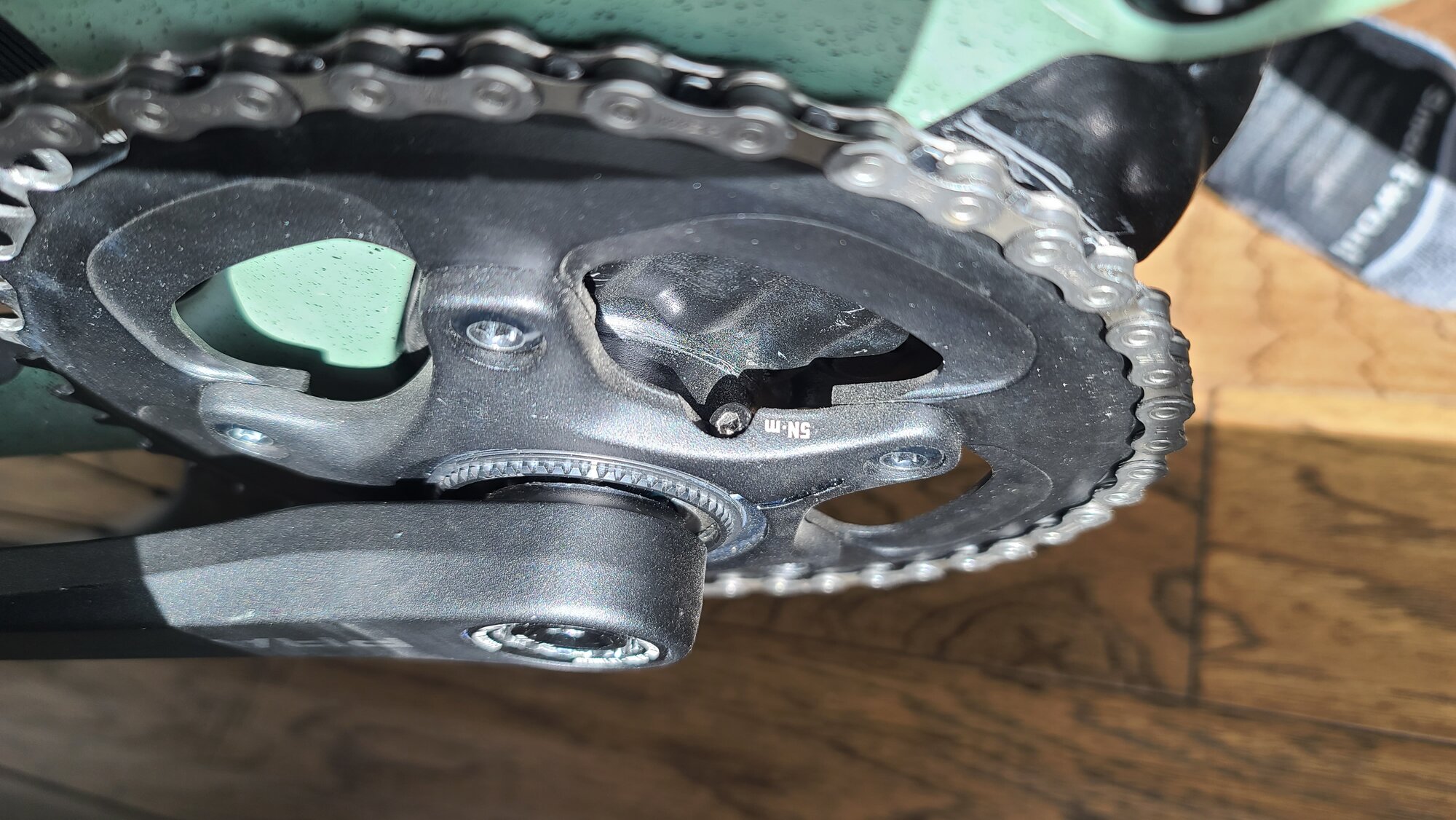

I am a recent owner of a Creo Comp Carbon, and on my first extended ride I had.a clicking I could hear and feel from the engine/BB area. It was concerning me on a new bike, but it went away after about 10 miles. Would love to hear what you found to be the cause.
I get some kind of noise or feeling when pedaling my Creo. But not all the time. it just happens and if I pause pedaling, and then restart, it is as though I have the motor, crank or whatever go back into its appropriate "whatever" and the noise/feeling goes away. I might have to do this once to twice until the "problem" clears. If I pause again, it might or might not return. I guess it just depends on what is out of whack and if it goes back into rhythm???? Usually stop pedaling and a brief coast and resume pedaling will do it.

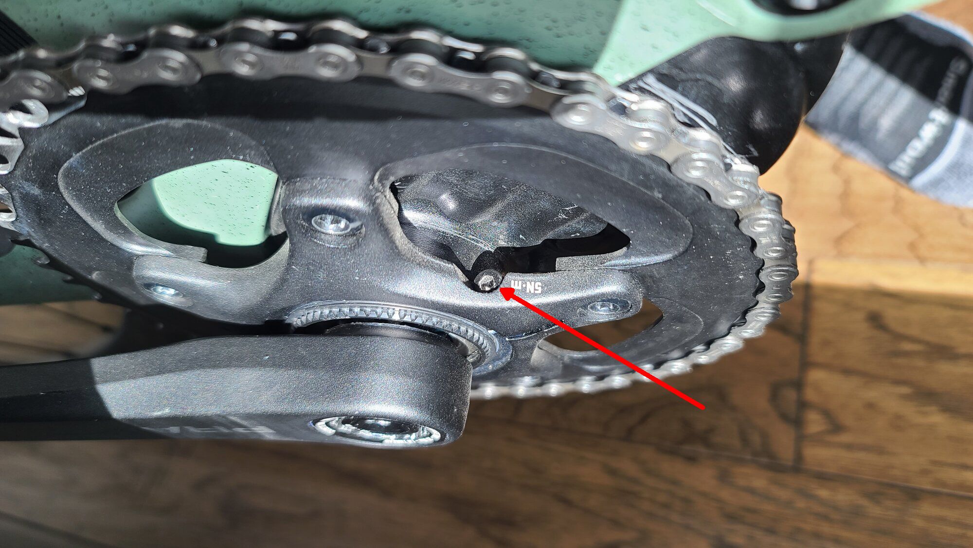

They replaced the motor on mine and the sound came back after a 100 miles or so. I finally traced it to the spline being loose on the chainring to BB connection. you could actually giggle the chain ring. I retourqed the little pinch bolt and it went away. I plan to take it off this winter, clean and put waterproff grease on it and retourqe it.
Showing my mechanical skills or NOT.
What is the "little pinch bolt"? Is it that little bolt showing through the notch in your attachment?
