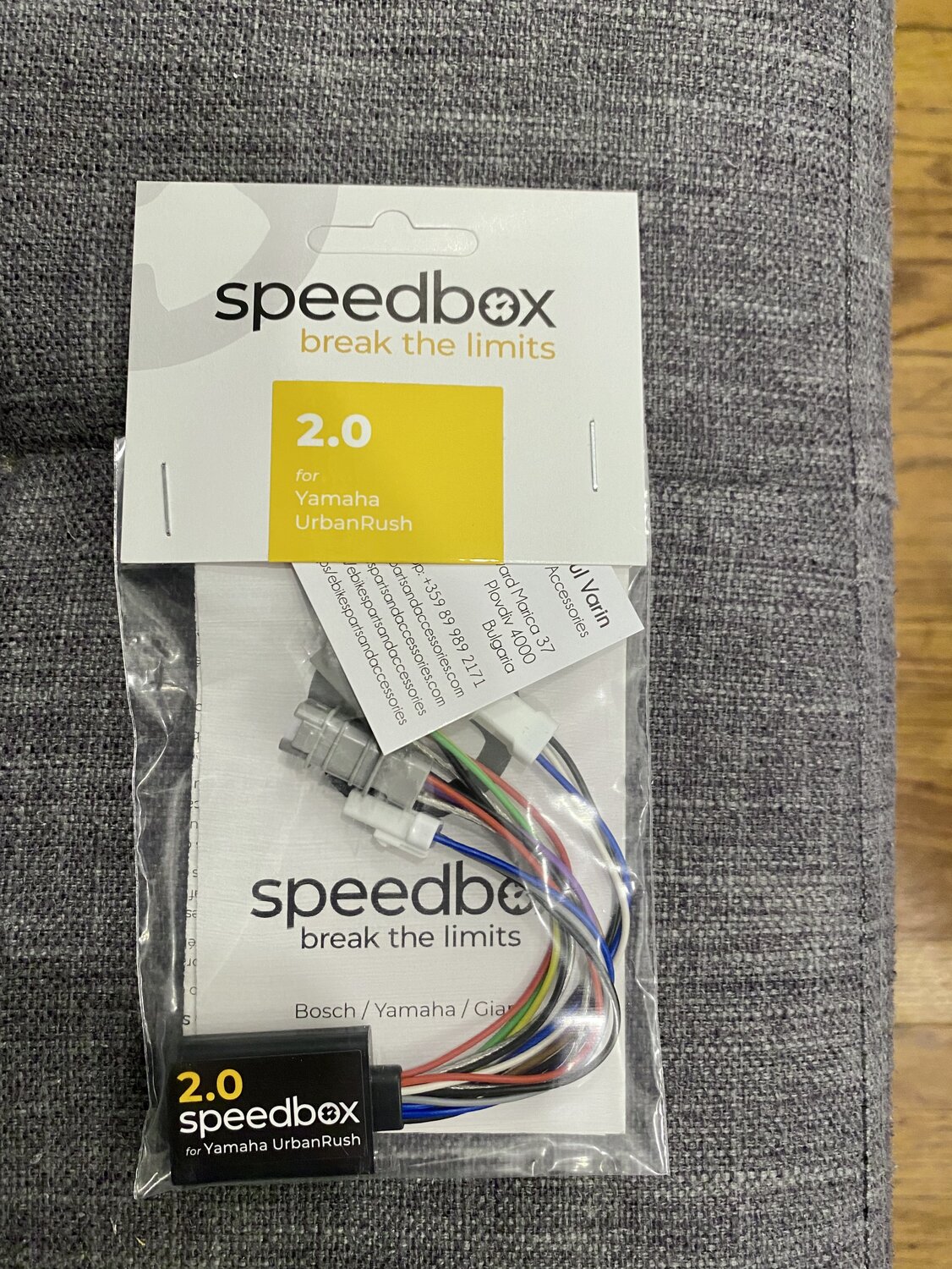

I don't know what was the situation in 2020 but now it seems that they have a product capable of derestricting Urban Rush. Here's a link: https://www.speedbox-tuning.com/p/speedbox-2-0-for-yamaha-urbanrush

Bought it for my 2019 Urban Rush. It should be delivered within a few weeks. I'll update this thread when I get a chance to play with it. The thing that scares me a bit is that it is still labeled "2.0 speedbox for Yamaha Branded Bikes". That's the exact same text that was on the incompatible speedbox 2.0 that I purchased previously. Although every site that is selling it states that it's only for the Urban Rush. I guess I'll find out.

I just got it in the mail today. It looks promising because instead of it being labeled “for Yamaha branded bikes”, it says this:
Well any luck installing? I can see it has the “old” style connectors, certainly wouldn’t work on my Yammy. Good luck 🤞
I can confirm that the connectors are the correct since the SpeedBox 2.0 "for Yamaha branded ebikes" is exactly the same. Unfortunately it threw an error code that was likely related to the in-hub speed sensor. Who knows...maybe it was my case that raised that not all the programming is the same for the Cross Core, Cross Connect, Urban Rush and Wabash.

Success! Did the install today and took the bike up to 38MPH and was still getting motor assist. I was only able to do a 5 mile loop before the kids woke up from nap time but it felt good. I’m really hoping I don’t get an error in the next few rides!
