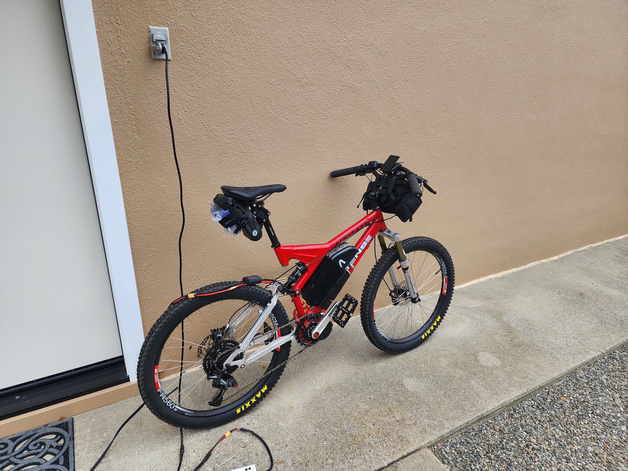

Right at 60 psi on my 26x2.5 emtb. I actually use this bike as an around-town sort of short-errand bike. Also on my 29er which is 29x2.3 and 60 psi on the back tire riding it on dirt roads.
No flats on the 26er yet so jury's out, but I have had it work fine on the 29er for goatheads. These bikes are both tubeless.

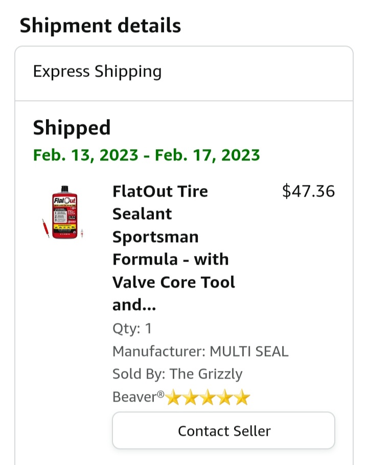

I couldn't find Flatout anywhere in Canada, and they don't have it at my local Home Depot.
I had to have it shipped from the USA through Amazon.
It cost me $47

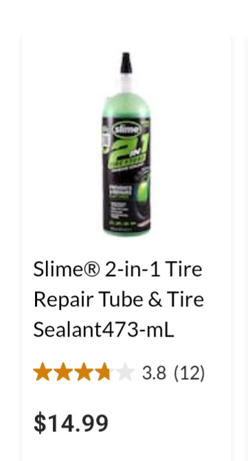

I actually already had the Slime but hadn't put it in my tires yet.
It was only $15 at my local Canadian Tire.
Thanks again @m@Robertson for your advice and pointing me in the right direction.

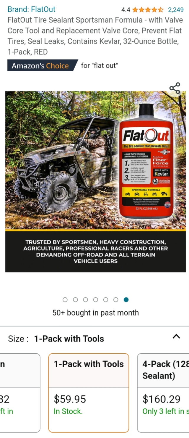

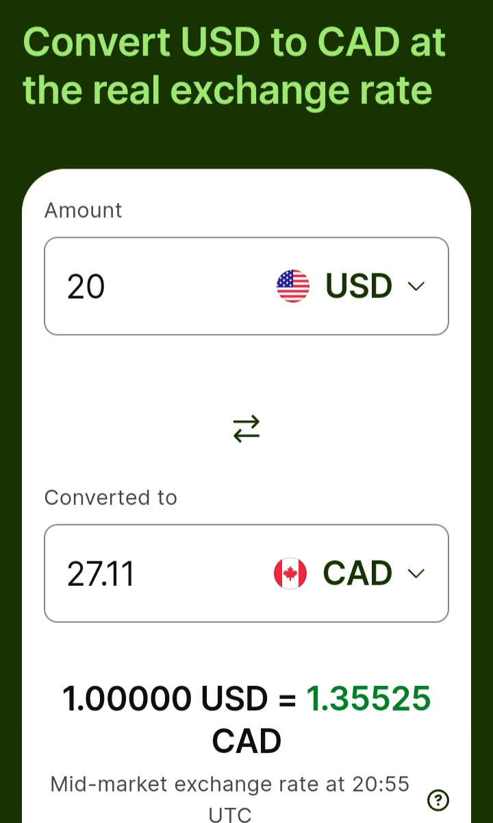

Wow. At least those are Canadian dollars. 0.75:1 exchange rate so not as much to us who live south of the border as it seems. Amazon wants US$19.45 for the identical product here.
