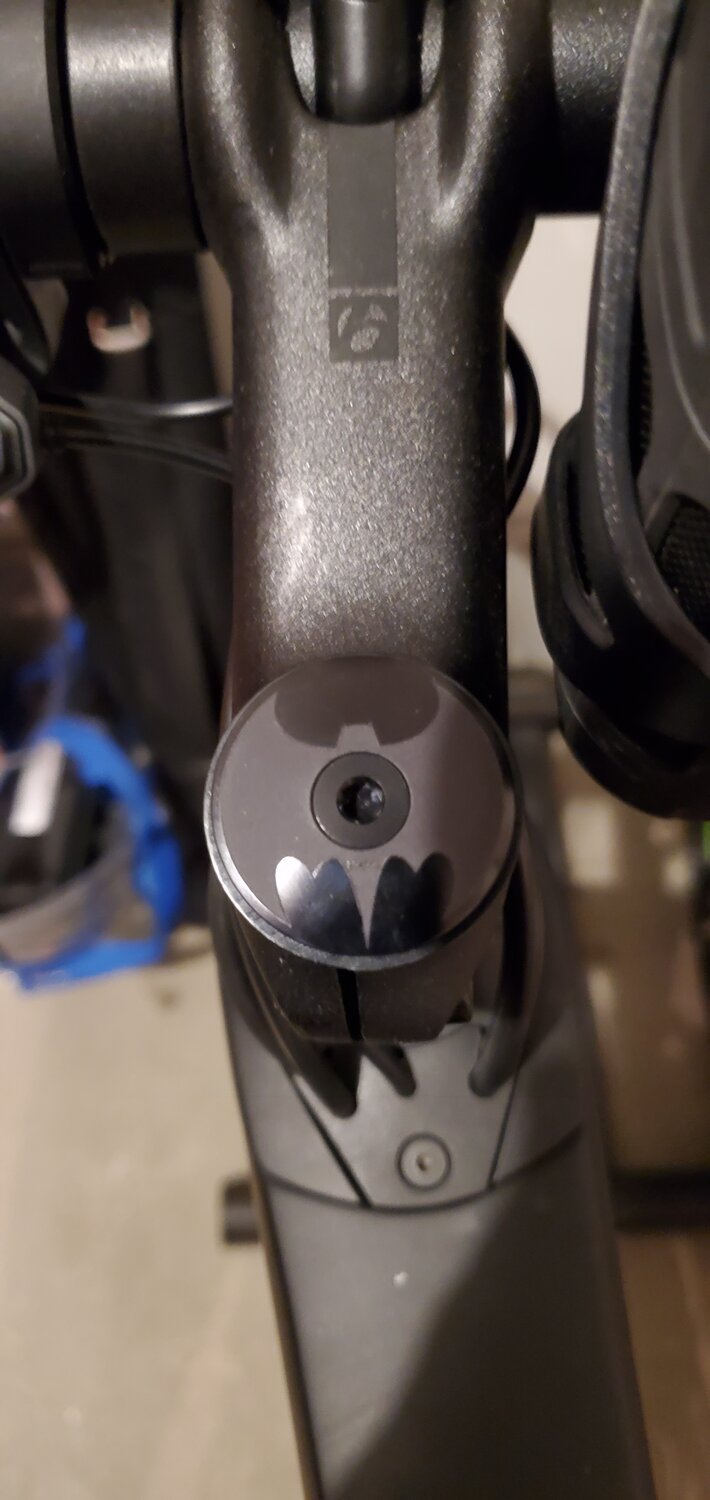

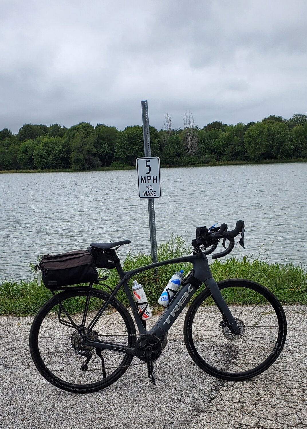

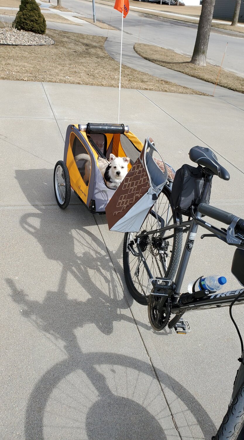

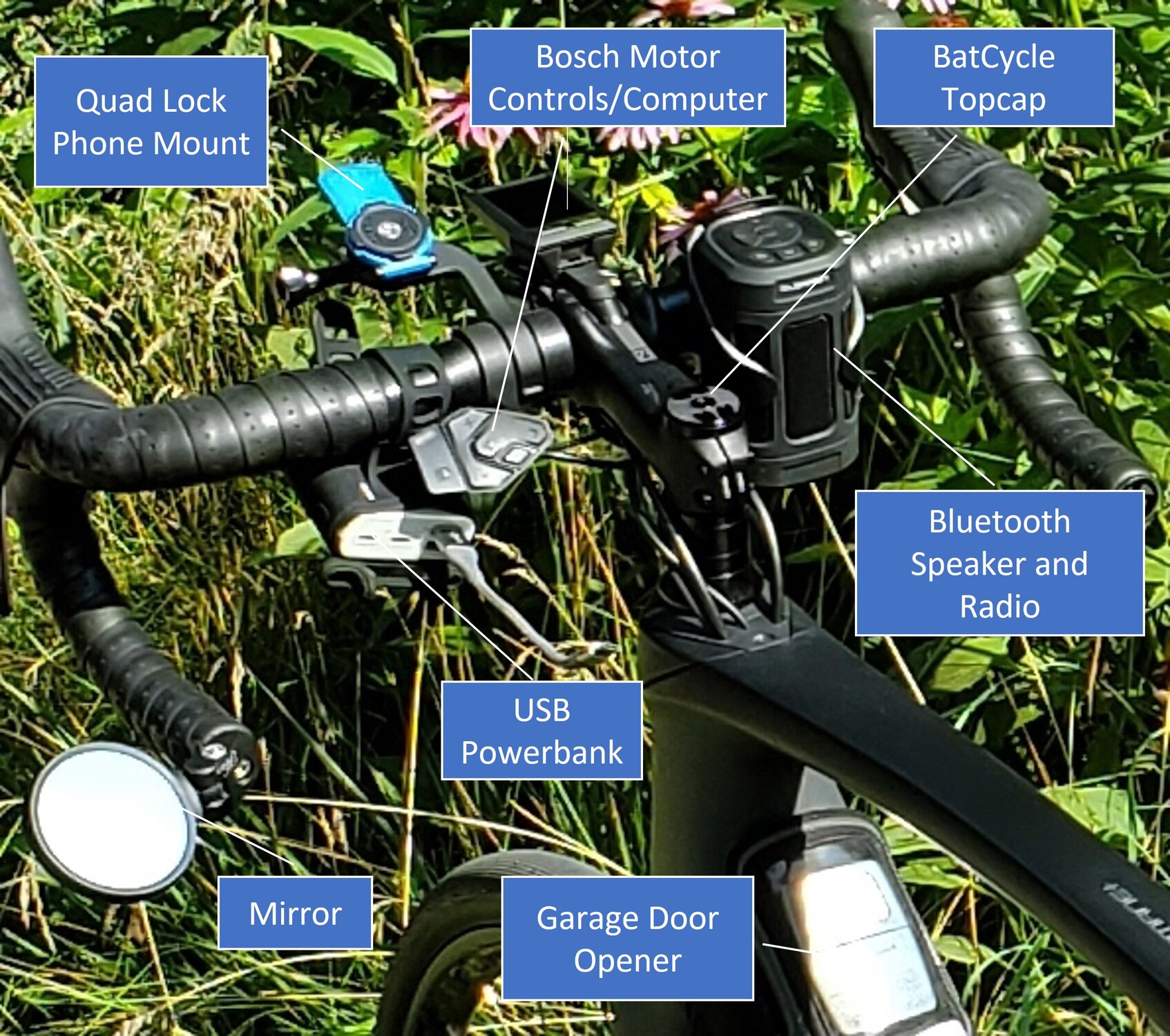

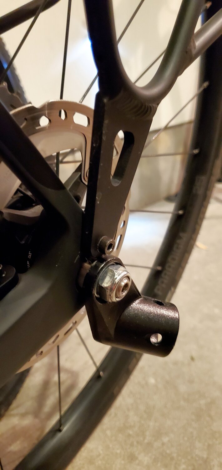

I just ran across your review here of the Domane+ HP. I must have bought my 2021 Domane+ HP about the same time. I have always been a Trek fan and own three acoustic Treks that I have ridden. I ride between 800 and 1500 miles each year mostly on roads and some Rails to Trails. I also tried out Giant, Cannondale and Specialized as well as Trek e-bikes when I started shopping. Many things motivated that but top of list was the fact that I was about to spend $5-10k on a bike and I wanted a reputable brand (vs. the onslaught of me-too Chinese e-bikes flooding the market) and I wanted a brick and mortar shop to go to when my skills were exceeded.
I would echo every word you have said about the stability and strength of the +HP. I am 6'1" and 200 lbs so I need a substantial bike. That brings me to my current purchase. I am also 70 and retired now, so it is probably my last bike (wink-wink), so I decided to open the budget for it and get an ebike. That would help me level the hills out a bit but still allow me to get exercise. I had previously purchased an ebike for my wife, so I knew a little bit about them but the real e-bike craze had not yet hit so the choices were slim. I bought her a Class 2 hub motor ebike with an external battery that she calls her “cloud” and she loves riding it. I spent $2500 for that. I researched what size I would need at my current weight and height and inseam measurement – I would need a 56-58cm (or L or XL).
Then I researched available e-bikes. I wanted an ebike that did not look like an ebike, had a strong mid-mounted motor (versus a rear hub motor) and a battery that was integrated with the frame (versus external) and would last most of my longer rides (50-70 miles). I also wanted down bars like my original road bike and wanted the bike to be as light weight as possible (hard for an e-bike) and have disc brakes and a good gearing range and the ability to do gravel if needed. E-bikes come in 3 classes. Class 1 bikes have a max assisted speed of 20 mph but have no throttle. It assists based on monitoring your cadence. Class 2 also has a max assisted speed of 20 mph but also adds a throttle which is good for infrequent riders who have a hard time getting the bike started. Class 3 has a 28 mph assist speed and no throttle. All make you work; you still get great exercise, but you will just be able to go further than on an acoustic bike.
I opted for class 3. I settled in on several brands. Specialized, Trek, Giant, and Cannondale. There were others but they were mostly crowd funded or obscure foreign brands. These were all brands I knew I could go to local shops and test drive. As I have said, I am brand loyal to Trek, but researching online I fell in love with the new Specialized ebike the Turbo Creo SL Comp E5. It was $5000 and at the top of my budget but it was sexy, did not look like an ebike and had some cool tech in it with a new German built motor. I also looked at the Cannondale Super Six EVO Neo 3 which came in at $4500. Giant had one at $4500. The Road E+ Pro sported a Yamaha built motor that was well tested.
Finally, I had been looking at an acoustic bike upgrade for a couple of years to a Trek Domane carbon bike and noticed that they had an ebike version called the Domane+ that ranged from $5300 to $7500 depending on features. Above my budget but I put it on my list because I have other Trek bikes and love them. I then went about finding the bikes nearby so I could test drive them all plus I rode some that I didn’t think of. I found the Creo underpowered in comparison although light-weight, the Giant and Cannondale heavy so I settled in on a 58cm Trek Domane+ HP all carbon bike with a Bosch Class 3 mid-mounted motor, 100-mile range with a 500-w integrated battery and capacity to add a range extender battery for another 50 miles.
It is fit with an 8-speed Shimano GRX setup and it has wider gravel ready tires but is mostly a road bike. It weighs only about 36 lbs. so noticeably light for an ebike. It has integrated suspension in both the front fork and seat post. An integrated front and rear light system and onboard computer make it fun to track my rides. I spent $7000 for it and bought it online direct from the manufacturer and had it sent to the local Trek dealer to assemble, adjust, and deliver it to me for free. I got it in a week and was riding. The dealer threw in some free items and I have someone to take it to for service now. Since I got it home I have added a special axle that allows me to pull a trailer with my dog in it, clip-in pedals so I can get that advantage and a back rack that I can put a trunk on to carry provisions for long rides and paniers if necessary.
The one thing I have found troublesome about the proprietary nature of a bike like this is the fact that changing anything is often a bit of a challenge. I changed the seat-post to make the geometry a better fit for my frame. That was $250 but was an easy and effective swap. I found recently that a switch to different brake disks wouldn't work as the speed sensor is imbedded in the real disk. I have also been looking to replace the saddle to a Selle SMP+ but the integrated rear light (which is great) connects to the back of the Bontrager saddle and there seems to be no choices here. I have also had a problem with the kickstand rubber piece falling apart that I had to find my own solution to repair.
I would be interested if anyone has located a source for upgrades on this bike. Again, thanks for the review it was spot-on.
