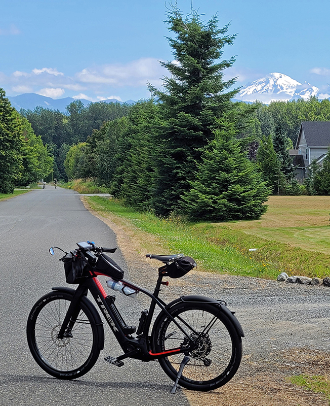

Is that the stock kickstand ?
No, the stock kickstand sits at to shallow an angle and makes the bike very tippy when resting on it. A slight shove forward and the kickstand collapses and the bike crashes. That one has a more forward leaning angle and is far more stable.

What make and model is the kickstand you installed?
