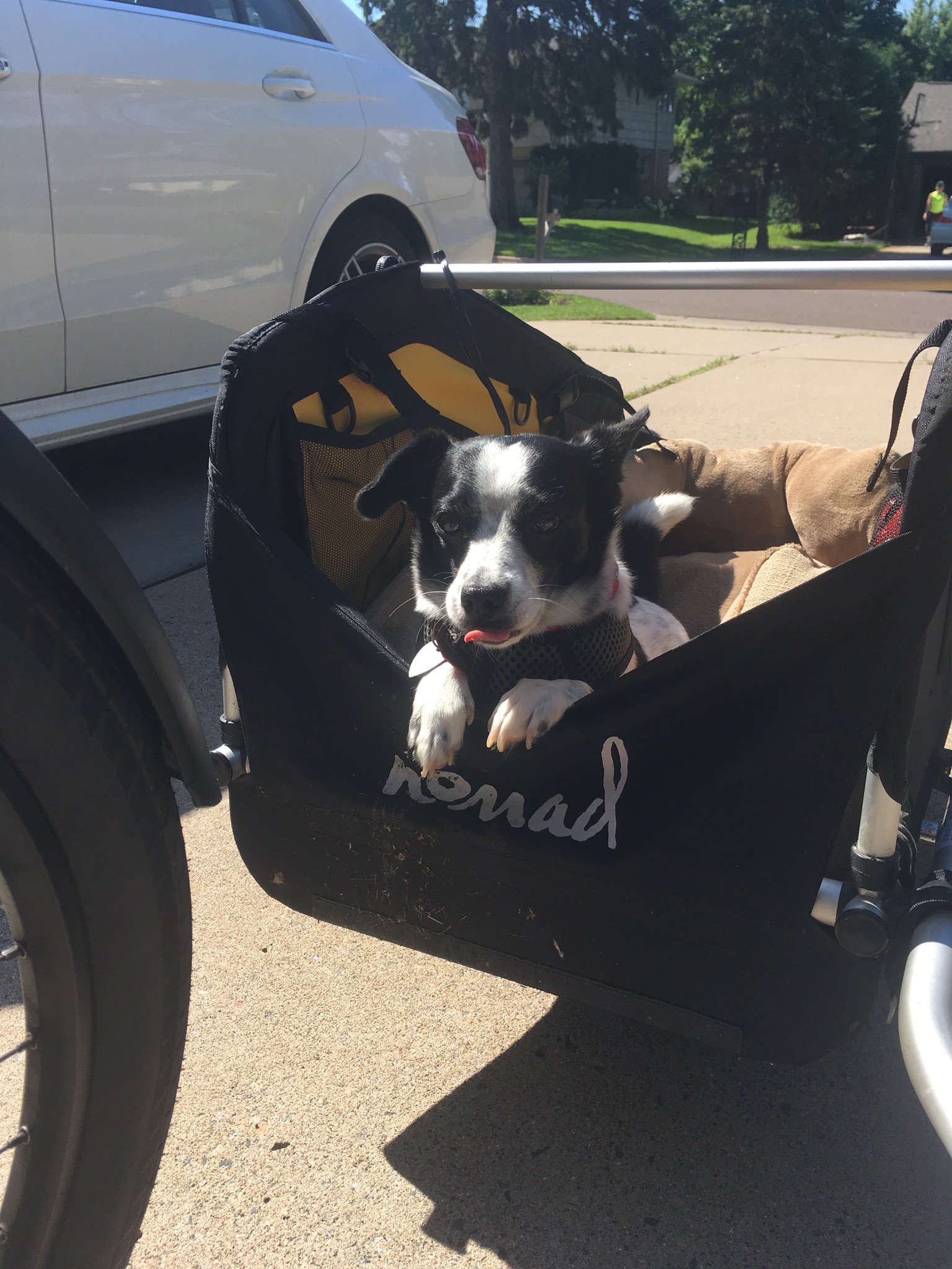

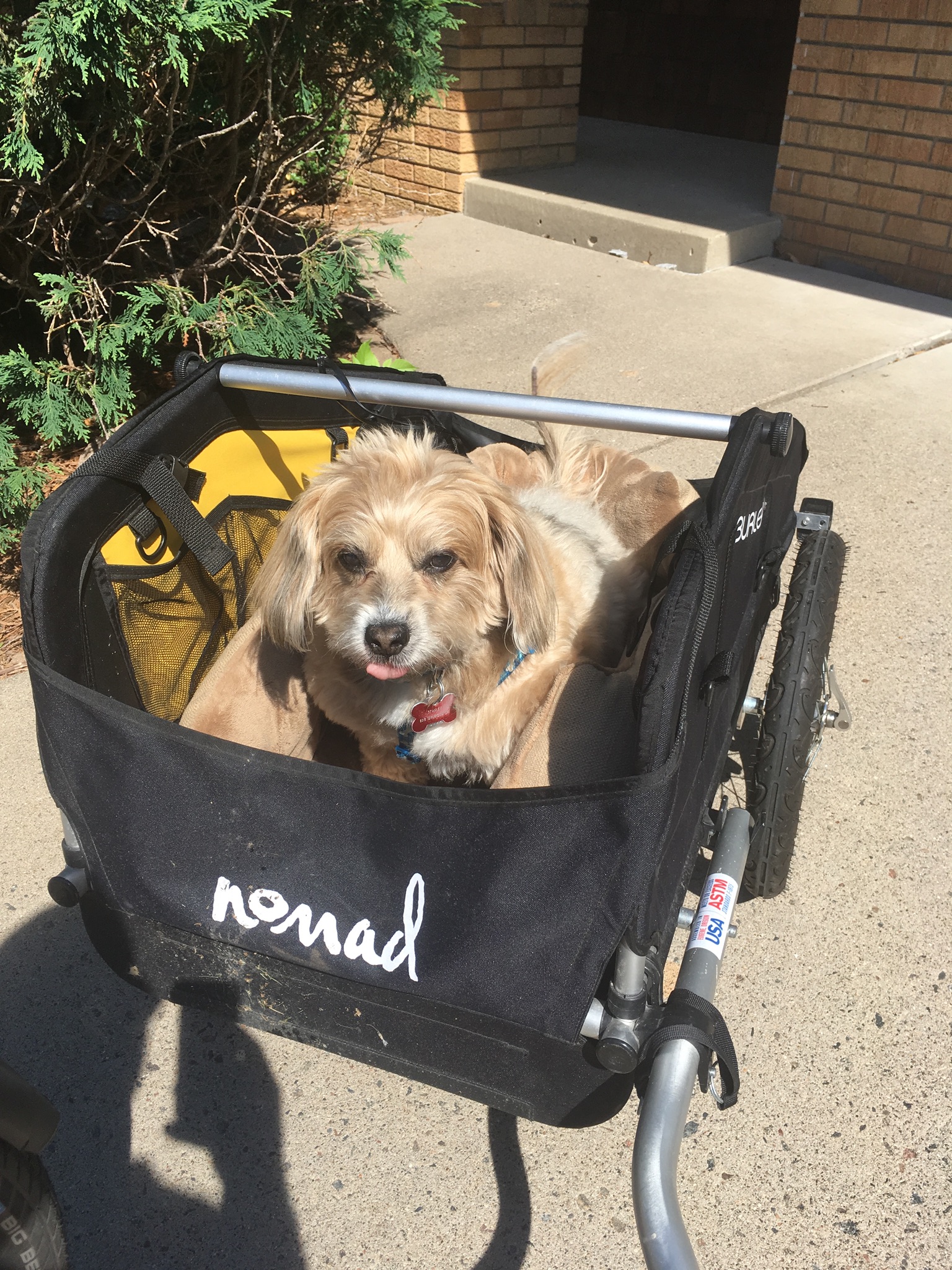

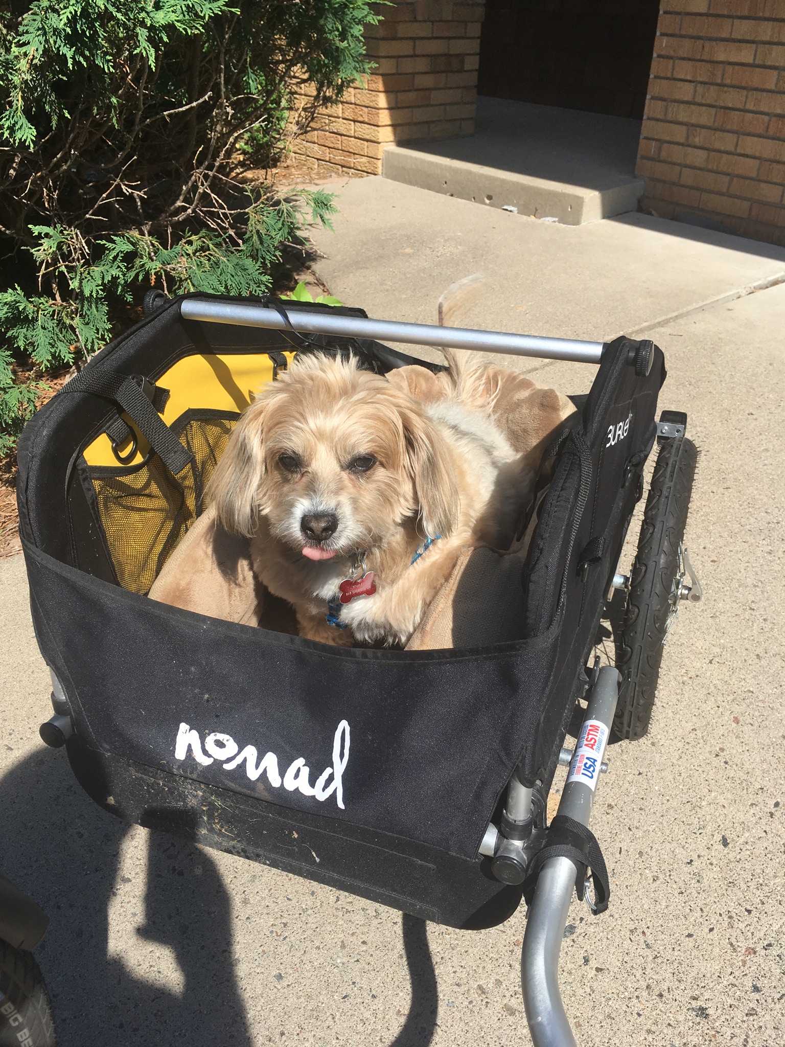

This afternoon I mounted the trailer bracket kit to the back of the ST2.
Zero directions are included with the kit. However, it is fairly straightforward to mount the plates. If you've never removed the back wheel I'd encourage you to do so when you have some time. If you're beside the road with a flat it's not the best time to learn how it all comes apart.
Remove the through axle. Pull the power plug from the middle of the hub and slide the wheel out. Shift to the smallest gear just like a regular wheel removal. Remove a couple of bolts where the new screws and bolts will attach the plates. Used some of the online pix I found to line up the plates - they are different from each other. Torqued all the bolts and put the rear wheel back in.
See the pictures below.
