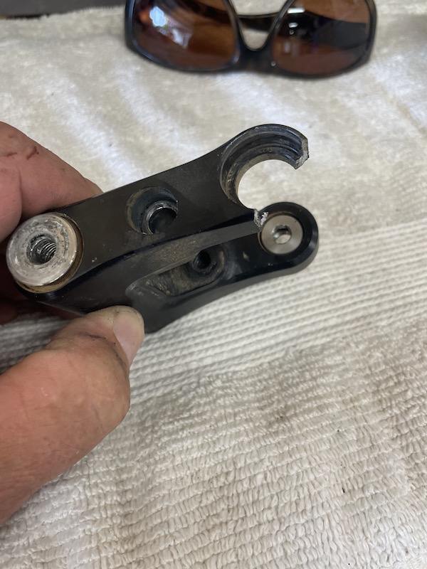

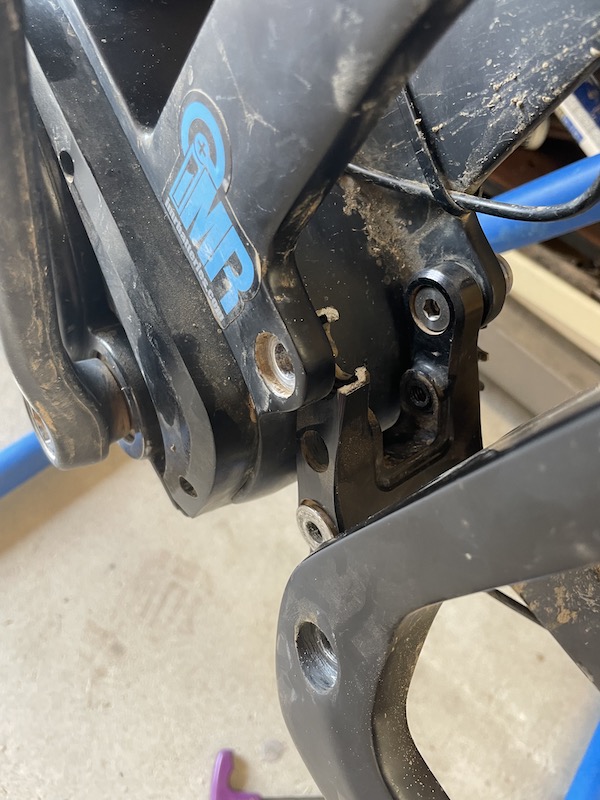

Everything was going fine until one particular climbing section and I felt something weird going on in the rear end so at the top I dismounted and visually checked the back end. Nothing stuck in the derailer and the chainline looked fine so I got back on and took off again. right away something felt really off so I got off and checked everything again. This is what I find.
Actually the other side was the one missing the bolt and this side had the bolt and bearing still there securing nada.
So this pivot attaches to the front lower rear triangle and lower frame support as well as the bottom rear shock mount support. So not a very important piece to fail right?

Im guessing that the drive side bolt backed out and left the other side to absorb the full support and any flex that occurred just snapped off the piece in question.
